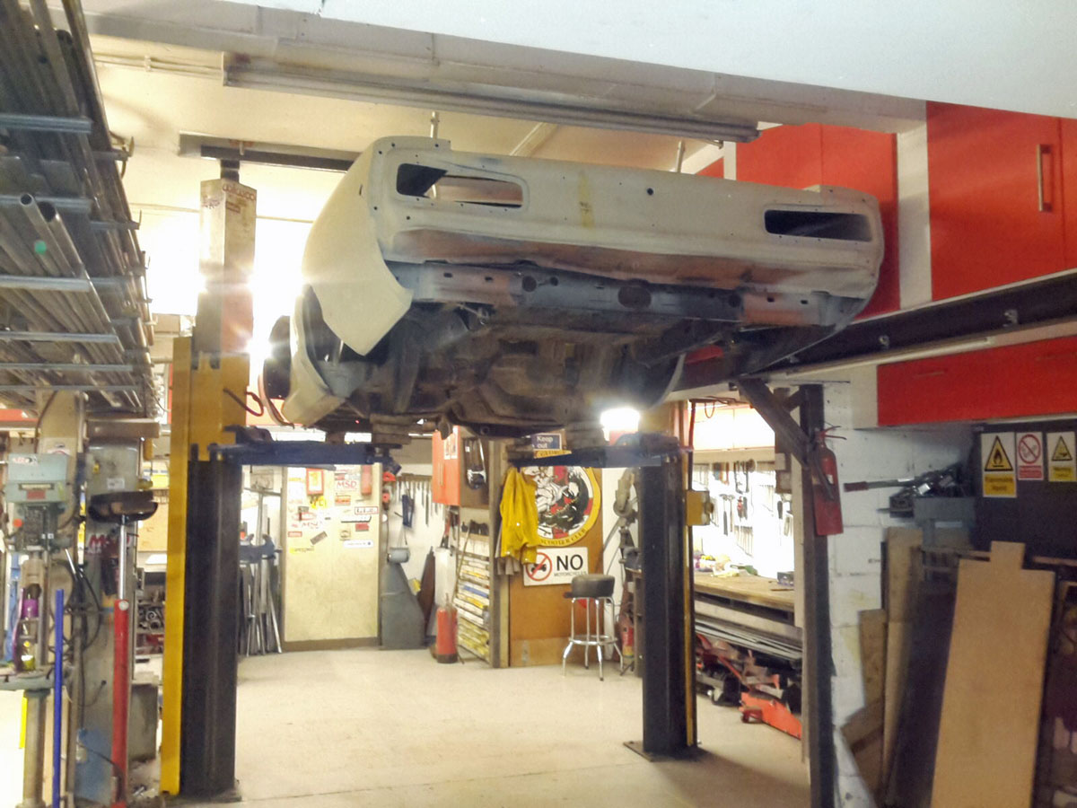

      have started a pro touring build here in the uk.thought you may like to see some pics

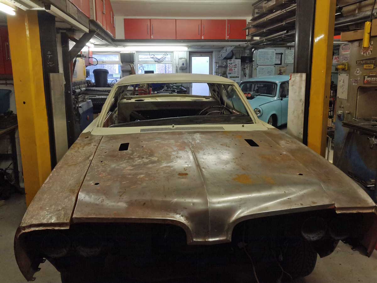

      car was rough to start with.its been to a body shop to have a new roof put on
      car sits quite high

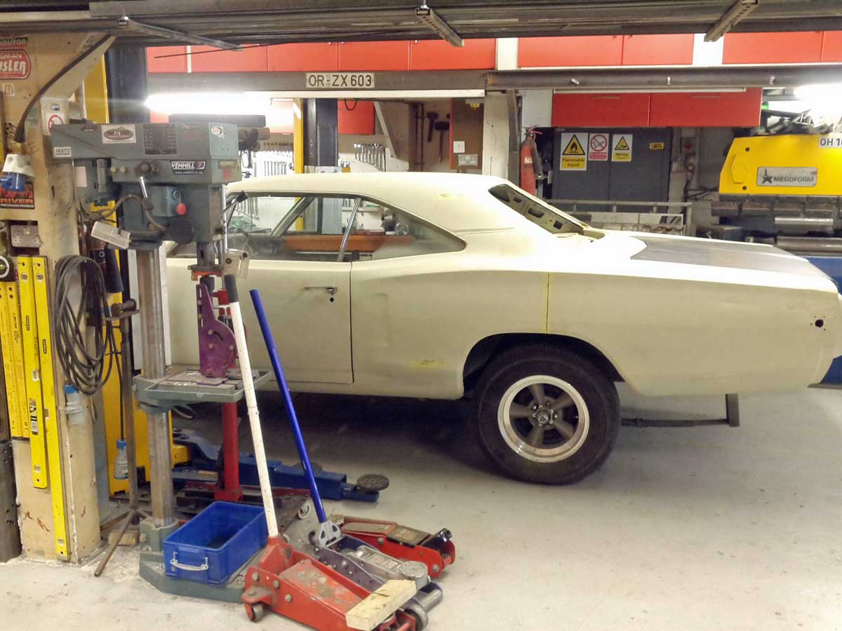

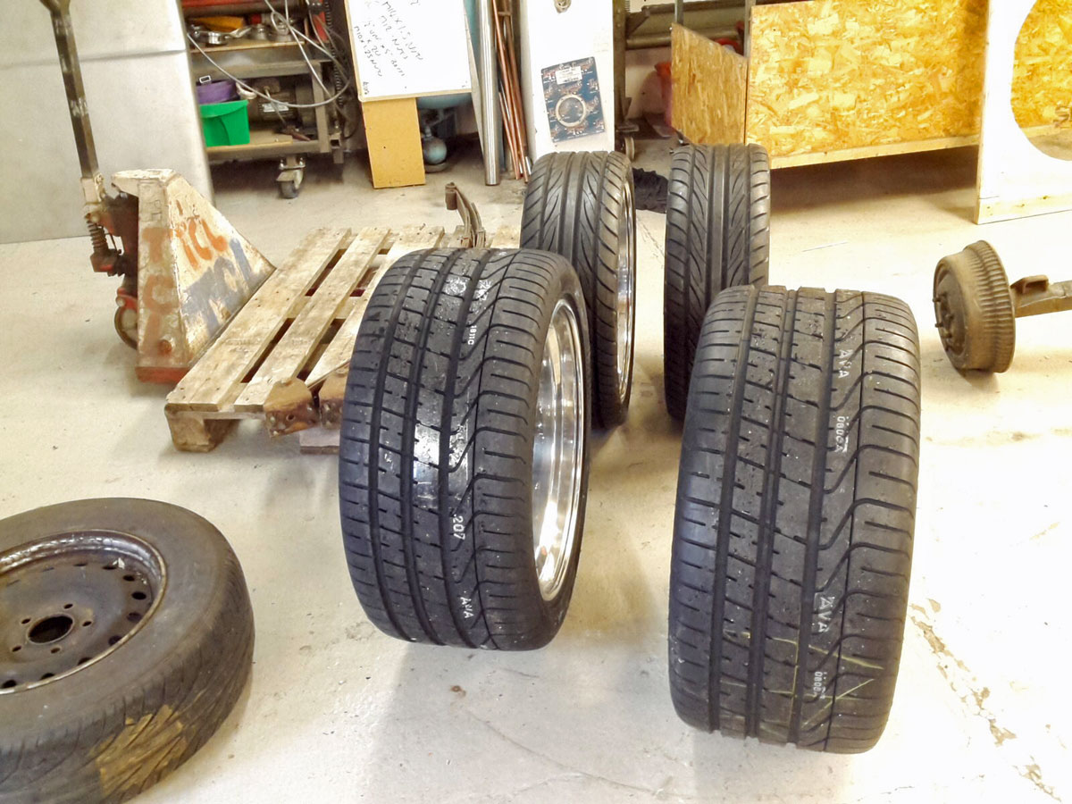

      wheels are made in the uk.fronts are 20 x 7 and rears are 20 x 10

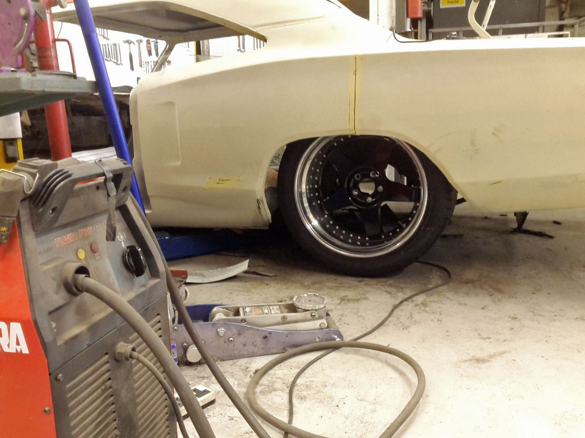

      had a play around to get ride height

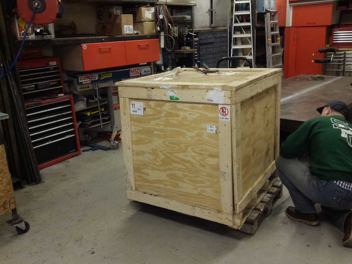

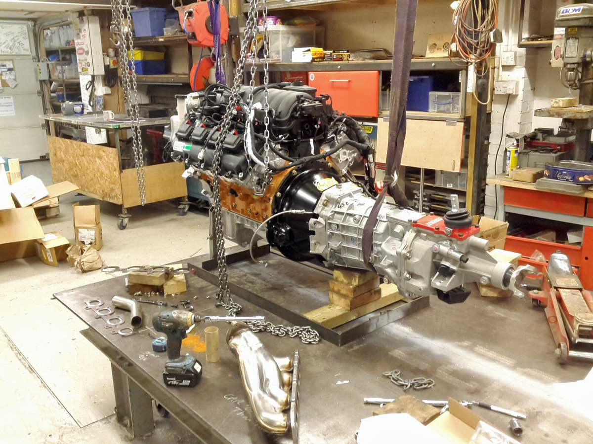

      had some goodies come in from the states
      6.4 hemi
      and a tremec 6 speed

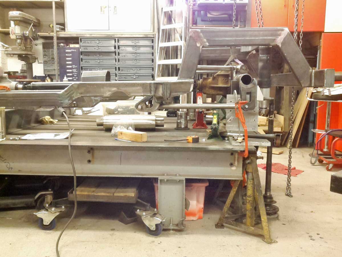

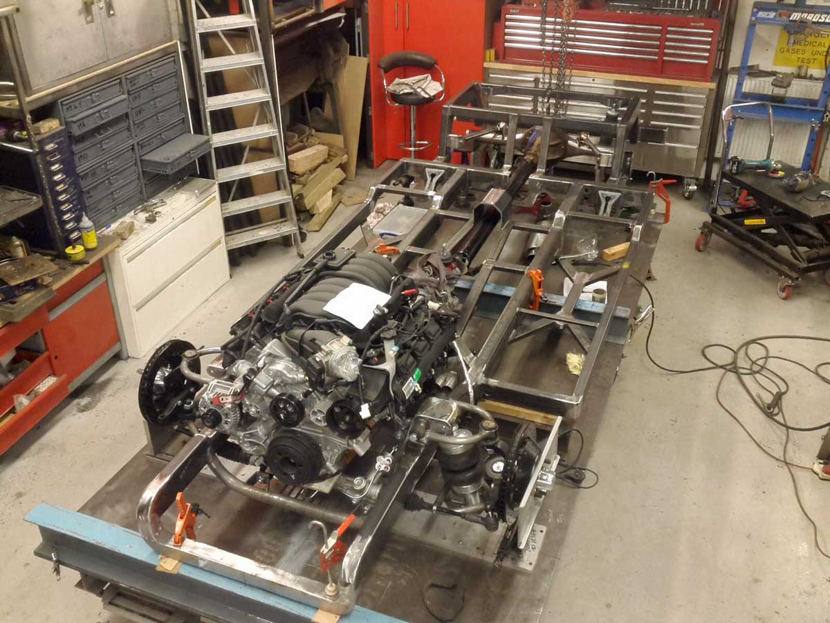

      This is having a full chassis put under,so the front end is one off

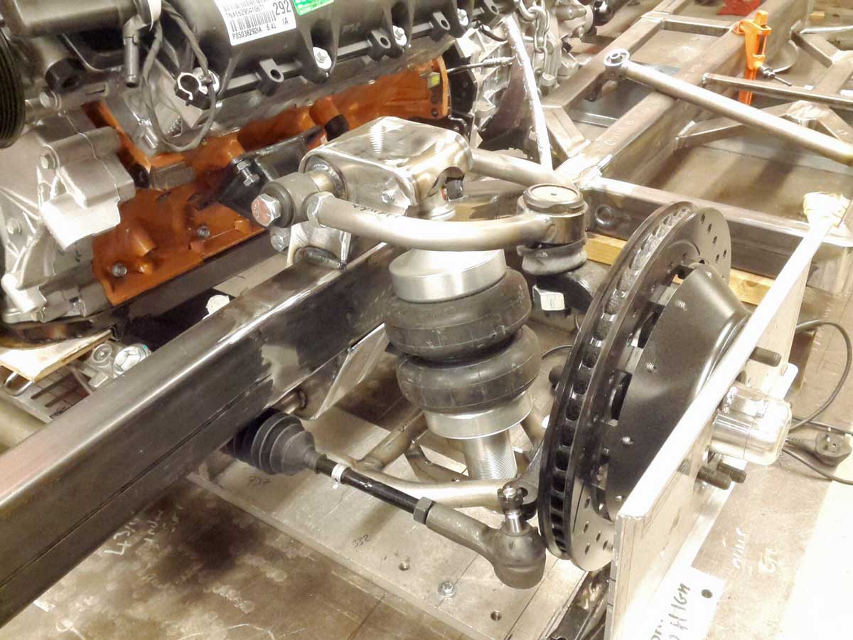

      Jan 2016
      22

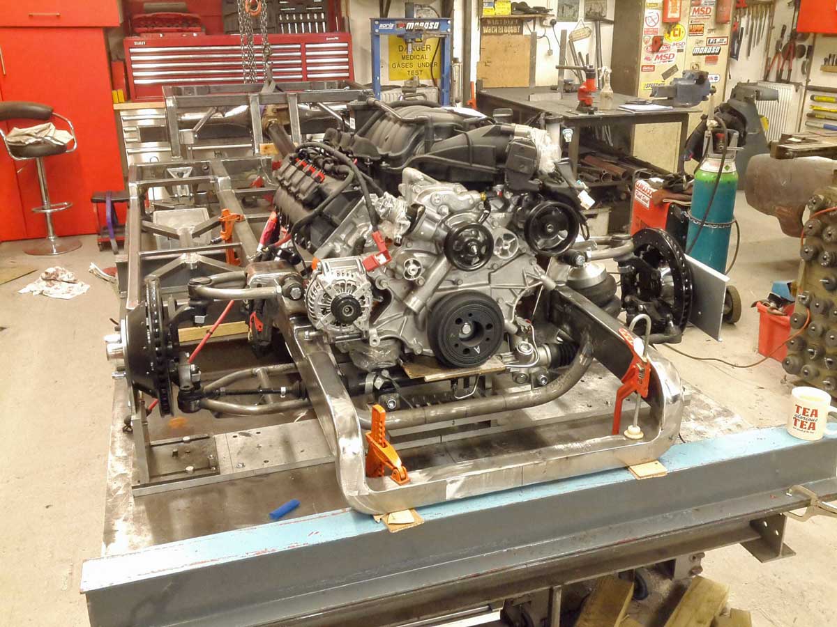

      for the front end were using wilwwod pro spindles,discs and calipers
      used a ford thunderbird rack,and made my own control arms

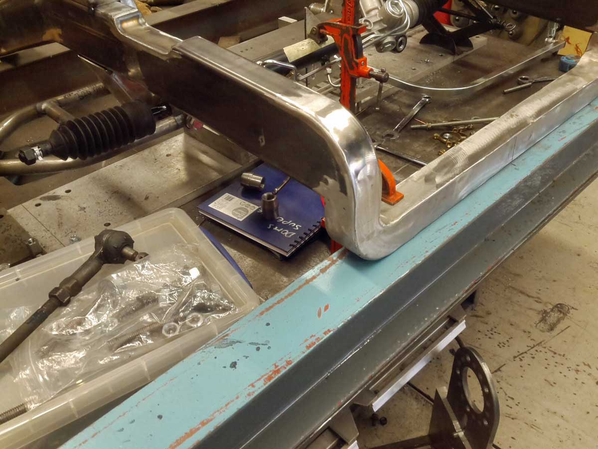

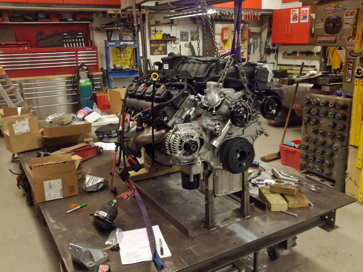

      the centre section of the front clip is only temporary,and will be replaced with tube work that will cradle the sump.
      didn't realise until the crate was opened,that this was a front sumped engine.had to order in a middle sump from the states.thats one of the downsides to building in the uk.certain parts needed,usually takes one to two weeks, to get here

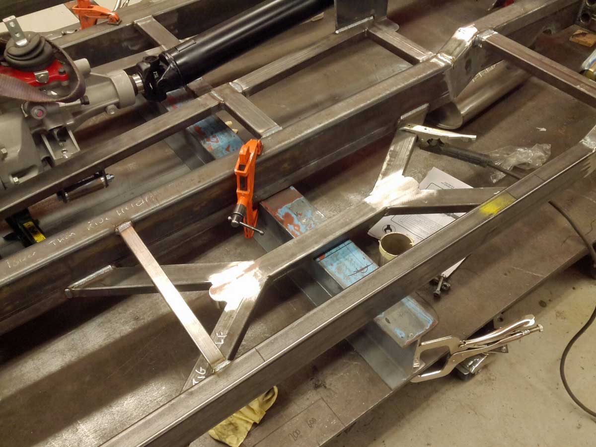

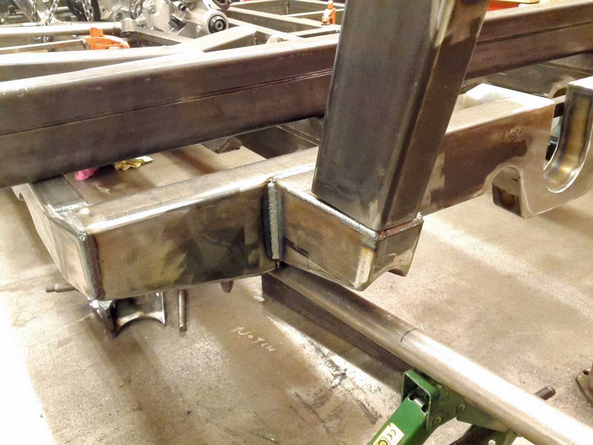

      Jan 2016
      22
      Dec 2015
      198
      Beautiful chassis work. Don't see that too often on Mopars.
