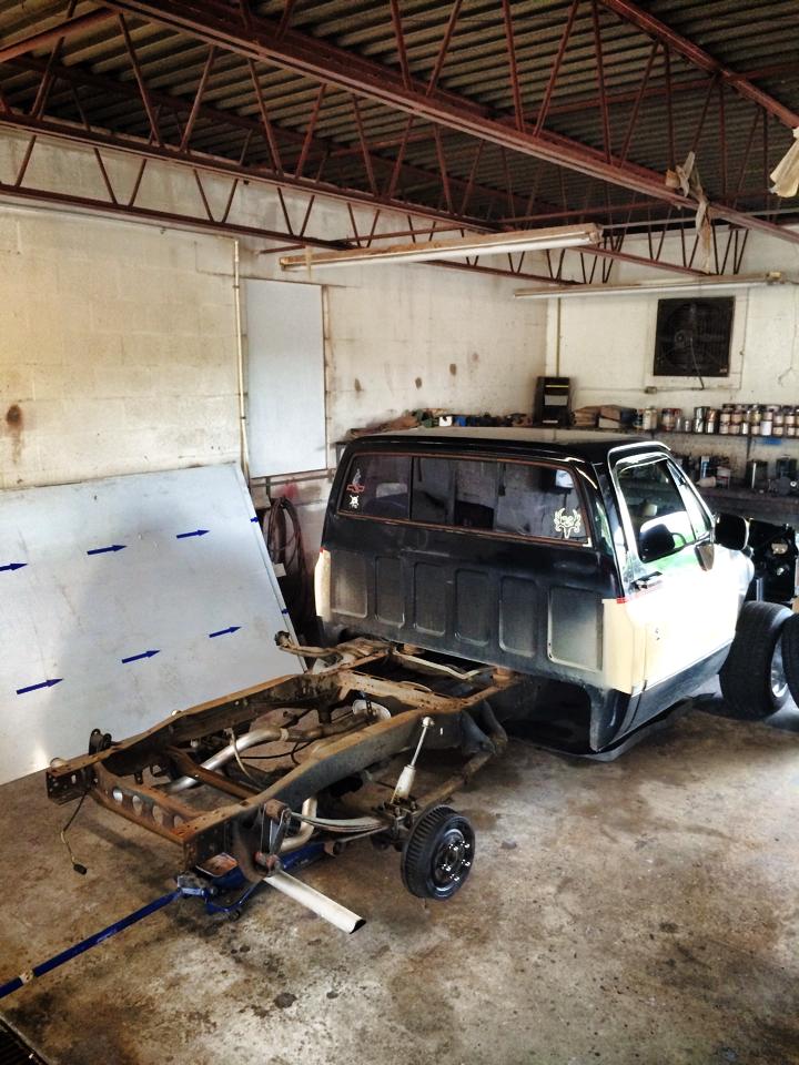

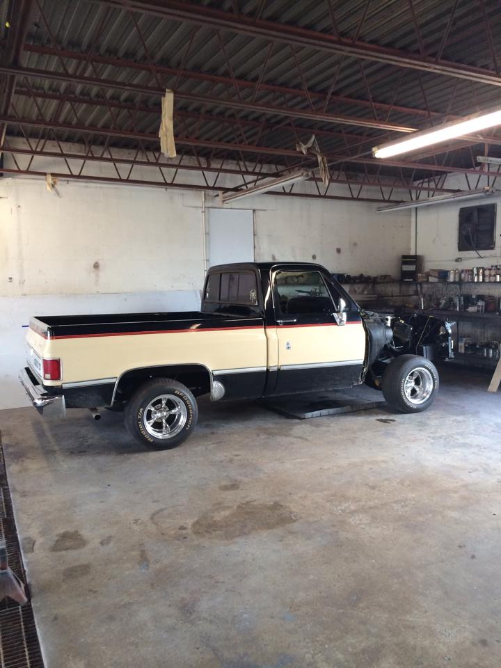

      As it stands now the truck: Is in a million pieces but has turned the corner to assembling it again instead of tearing it apart and soon I will have a full rolling chassis and then I will start the body work.

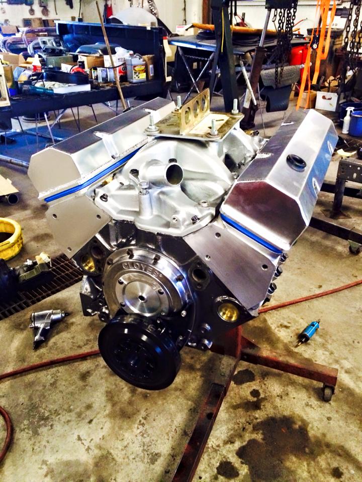

      - 350 bored 40 over- now a 357, full hydraulic roller set-up, aluminum heads, 10.5:1 compression, just tons of goodies inside. Just ask if you want to know more.

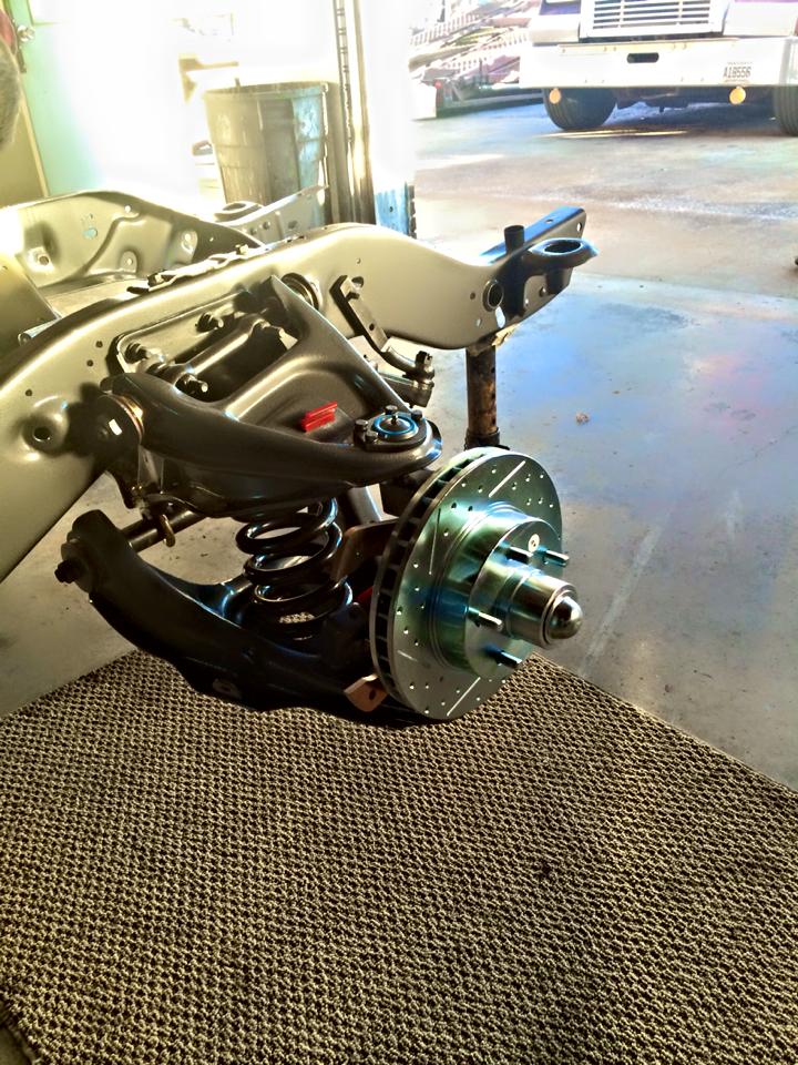

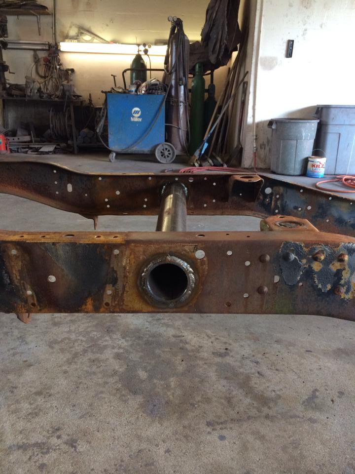

      -New to me/ the truck frame that I had a very good family friend of ours put on his frame rack and check it for laser straightness then cut and put tubes through frame like modern pick-ups/ cars.

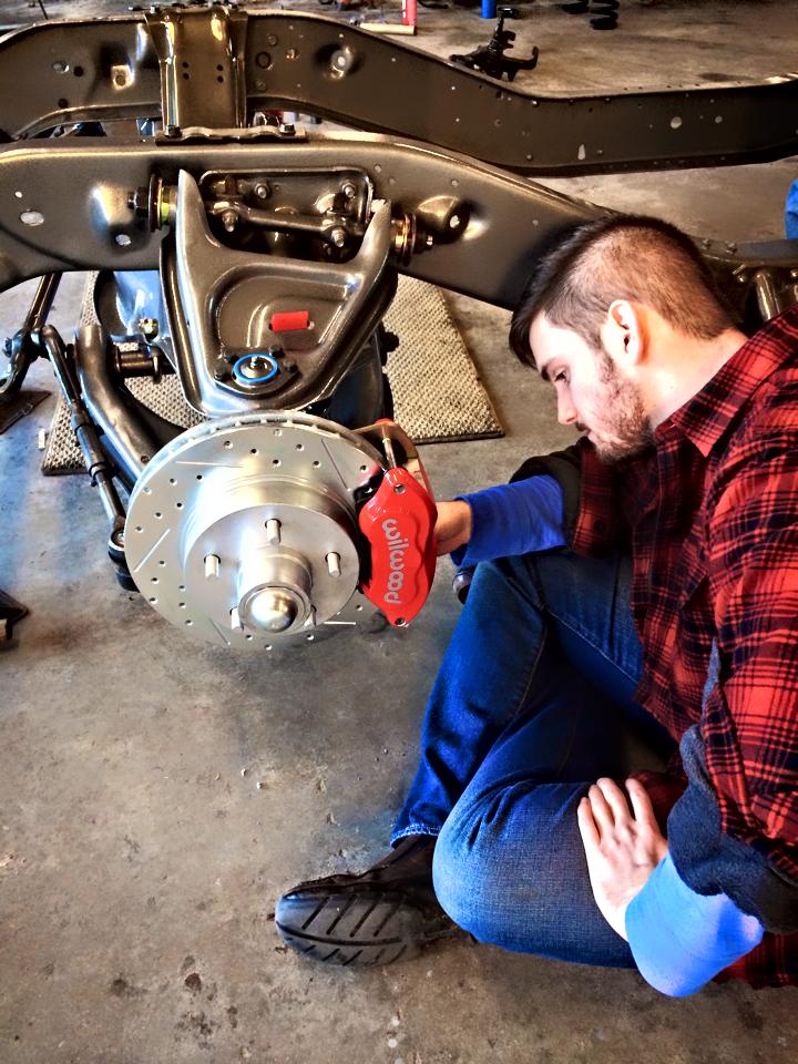

      -BAER Rotors with Wilwood calipers up front
      -Eibach 2 inch drop pro touring truck spring, progressive rate spring
      -CPP 2 inch drop spindles/ 1 inch narrowing spindles to help tuck the big front tires
      -Caster mods made to the lower control arm cross shaft/ and soon to come bump steer mod
      -5&1/4 rear drop by moving the leaf spring brackets up the frame and modifying them, Detroit spring- spring liners, polyurethane bushing. (eventually going to a No Limit Engineering 4-link)

      Just deal with the leaf springs for now- I know lots of auto cross events have been run with cars/ trucks and leafs and while not ideal/ what I wanted money is restricting my budget and time since I need to be getting this things back on the road and out of my shop. ( it is monopolizing a lot of room) Soon enough it will be getting that 4 link from Rob at No Limit.

      UPDATE: Progress has been slow but parts have been ordered and are steadily piling up which is the good news. This includes new ignition pieces for the MSD, new torque converter built by precision, new to me set of original GM doors with no rust/ body work, interior pieces, Primer, sealer, Paint, & Clearcoat, and lots of others random stuff.
      Bad news is that my engine that I just re-cammed, put lifters and valve springs in is in bad shape in other areas. I suspected I might have some metal that had gotten into my main and rod bearing due to a previous rocker arm failure although not a bad one. I decided that since I am not in state to work on the truck through the week and in a effort to speed progress I farmed out some additional engine work to my local machine shop who does a great job watching out for me.
      And for peace of mind I wanted them to look at the bearing and replace them if needed along with checking my piston to valve clearance with this new cam, set the lash on the cam being it uses a roller button to locate it, and just do an overall eval. Well long story short I have had to replace pistons, rings, all the bearing, polish the crank, new gaskets, and reassemble. There goes a chunk of change unfortunately!! But... Its done now and a trip to the dyno is scheduled to tune the motor and make sure all is well before we set it between the frame rails. Ill update again once this is done!

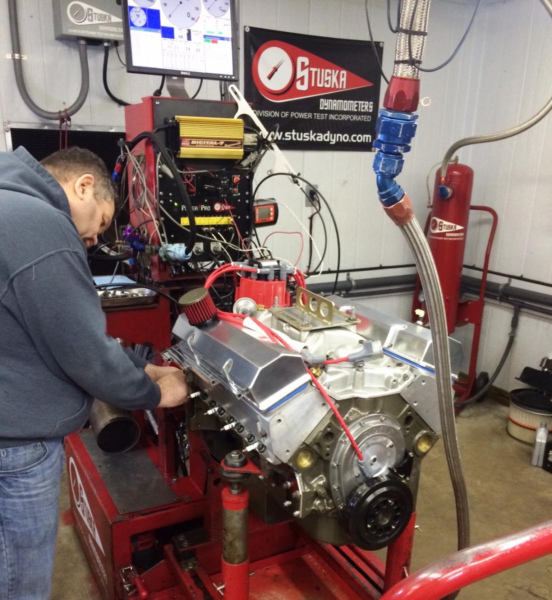

      Yes I finally have an update with some progress!! We went down to Paris TN on Saturday to Dyno Tune Engineering to strap the engine on the dyno and get her all tuned out and ready to go. My buddy and I were in a mad dash from Friday afternoon after work until literally 30 minutes until out appointment time at the dyno to finish up a bunch of loose ends with the engine so it could actually run. I will forever hate building my own spark plug wires and taking the time to make them look worth a crap!..but I digress we had a great time, then engine did PHENOMINAL and the guys from the shop were really good guys and did a great job. Saturday was definitely a highlight day for me as we loaded the motor up to go back home knowing it is in good order and ready to be set into the frame. I snagged a couple pictures and videos while I was there at there and will upload the videos as soon as I get them imported from the camera and edited down to a reasonable time. Also to add to the progress I got my radiator support in primer and sealed on Sunday and now it just needs to be scuffed and painted. PROGRESS MADE!!!

      So I should probably pose this question in the open discussion forum but the engine we built walks the line of needing race gas and I am looking for a solution to my problem. Obviously I could change the head gaskets to a thicker set but I do not want to lose power or efficiency. The engine at 28 degrees timing it made its best power strangely and I may could back it down 1 more degree but it does not like 91 pump gas. 93 octane pump gas is hard to find in my area and it still doesn't like 93 all that well. For the dyno we ran a mixture of 91 and 113 to make it happy and not chug or diesel when we shut it down. So my question is what are some of you doing- what solutions have you found that work? Aviation fuel mixture with pump gas? Race fuel mixed with pump gas? Make your own race fuel using toluene? Im looking for the best and cheapest solution to this problem because I do want to cruise around in the truck some bit on the weekends without having to run straight race fuel that costs 10 bucks or more per gallon.

      Thanks for the kind words Lance, and yea the compression ration is right at 10.5:1 on aluminum heads and I was thinking I could squeak by on pump gas as many others do but for some reason it doesn't like 91 or 93 pump gas. I believe I
      can dial the timing back another degree and help it out. It actually made its best power at 28 degrees but we never tried 27 degrees but Im thinking just that small adjustment and 93 octane might get me by but we will see on down the road
      lol If all else fails I will just buy aviation fuel and mix it with 93. And I am right there with you on the black and Tan colors and Brown and Tans, I was initially going to paint it back factory but honestly I hate keeping up with black paint even
