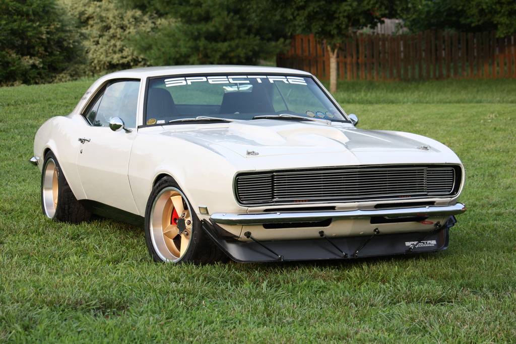

      without a mini tub the car is limited to 275 wide tires, a 9.5 inch wide with a 5.5 backspace.....you can run any rear suspension to fit the 275 tires
      here is my car with 275 tires front and rear just for reference

      Thanks for the info Rod. car is beautiful btw. did you have to do anything special to the front for that wide of a tire? I have been tossing around the idea of running all 4 tires the same size instead of staggering them but wasn't sure how well it would be for regular day to day driving. but I do like the way that looks on your car

      I used an off the shelf Tru-turn kit from ridetech, it allows the 275 tire up front also on the same 9.5inch rims with 5.5 backspace

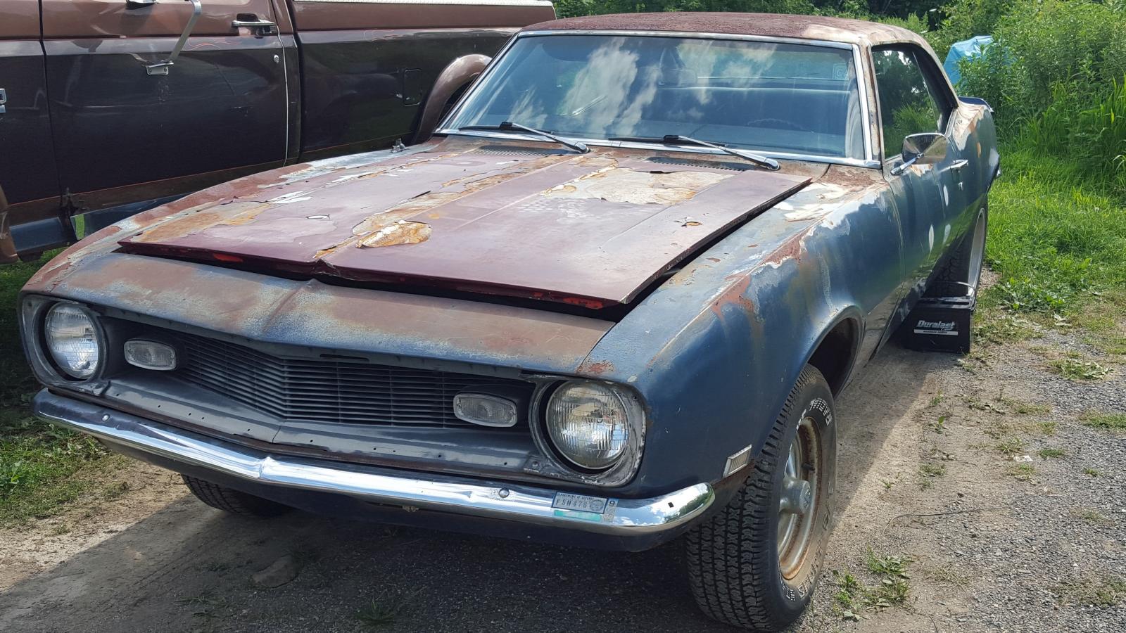

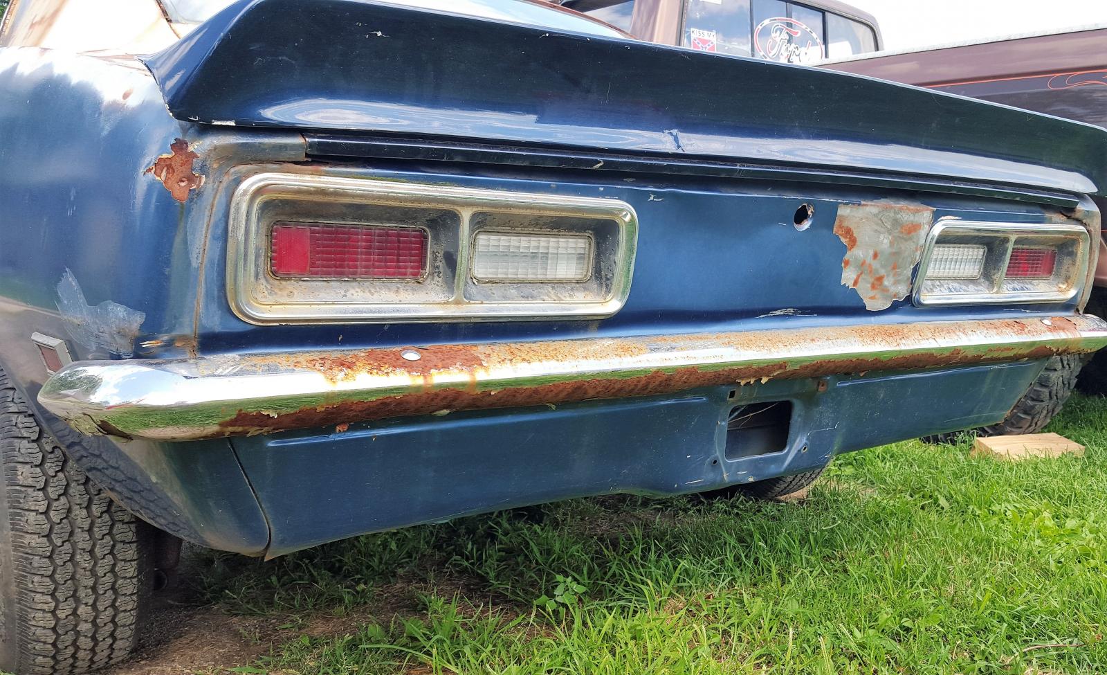

      heres some pictures of the project with no name lol

      great starter!!! its going to be good fun!! the rear spoiler looks funny....its from a 69 camaro there a little wider in the panels than a 67-68 and they hang off like that!!
      haha thanks rod. and yea its a 69 spoiler. came with the car. its in really nice shape so ill probably sell it.

      just cut it ...remove some of the middle and fiberglass it back together...you could even try and do a cool notch or something in the center...

      Sean I'm probabley gonna end up selling it as I did look to try doing what Rod had suggested but if I cut it then I will mess up the mounting holes. it has some scratches on it and one spot where the paint flaked off but nothing to serious. I do have to redo a few of the screws as I was able to thread them out. not a hard fix.
