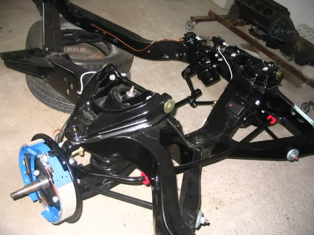

      Riviera frames are way different:
      See how the spring pocket and shock mount causes the cross shaft to have a __/-----\__ shape to it?

      Yes, it's an X-frame but the front suspension is closer to the 65-70 Impala with a single lower arm and a brake reaction rod.

      About the only thing the Buicks share with the Chevy is the fact it's an X-frame, even the rear suspension is completely different. My 61 LeSabre has a factory 3-link and panhard bar, the upper link is even adjustable to some degree.
