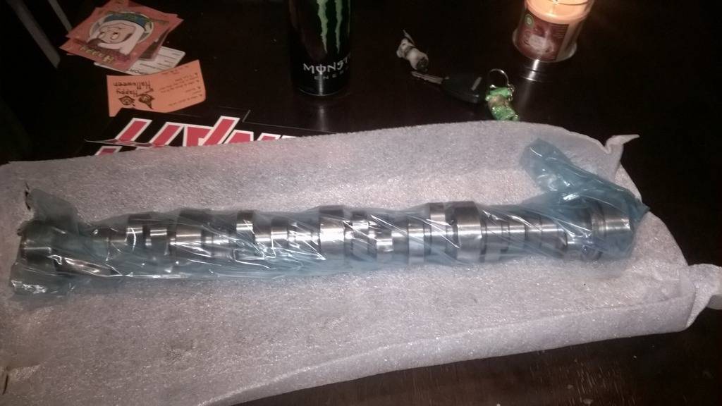

      Cam from RCR.

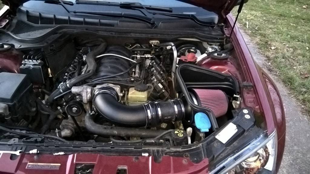

      Little more of an update for today. My new intake came in to replace the Vararam. I couldn't use that one due to the raised throttle body position on the TVS. I forgot to get a "before" shot but here's what it looks like afterwards.

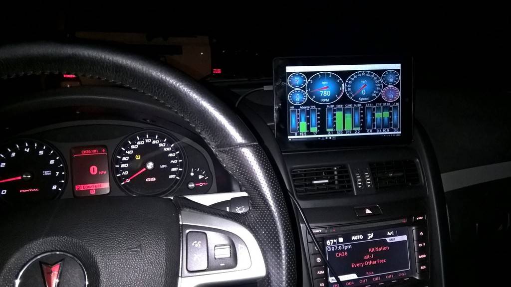

      Also started a bit of a gauge interface project. I didn't feel like it was a good investment to but Aeroforce scan gauges, the wideband sensor kit and a custom gauge pod. Adding all those parts up it was going to cost ~$700 bucks. Definitely more money than I want to put into it. I did a bit of research and I found that a Windows 10 tablet will run HP Tuners. Since I already have the HP Tuners Pro interface I can just use a wideband sensor kit and put the leads into the 0-5v ports on the HP Tuners device. I made a trip to Best Buy and found a Insignia Windows 10 8.9 inch tablet as an open box special for $79 dollars. The software downloaded just fine and after finding a Radioshack that had a micro usb to usb adapter, it came right up. I have a mount on order from Amazon that should fit the location that I want to put it.
