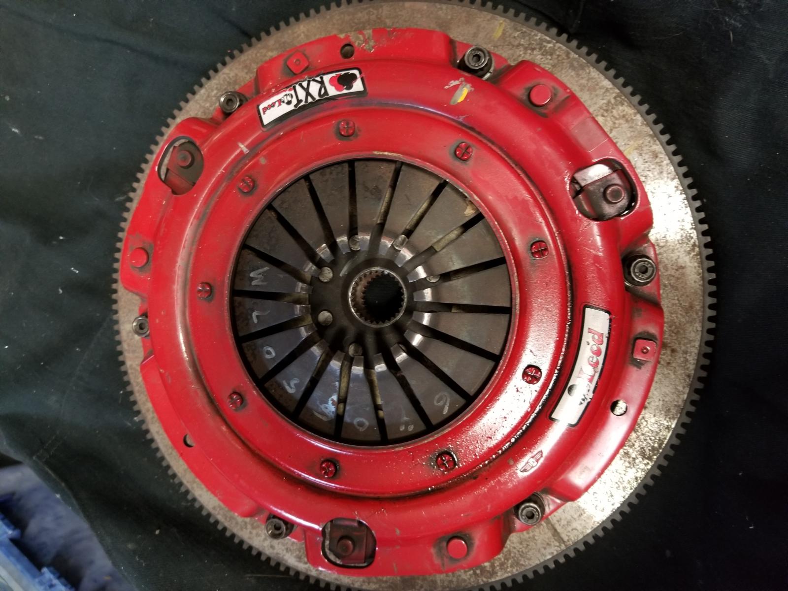

    10. #130
      Mar 2013
      Boynton Beach, Florida
      200
      bellhousing and McLeod RXT clutch installed. Had to notch the seat brace in the floor to make room for the F-body shifter cover. I believe that I will be making a new transmission crossmember, couldn't see a desent way to modify the old cross member, besides, with it not modified, I can re sell the old one.

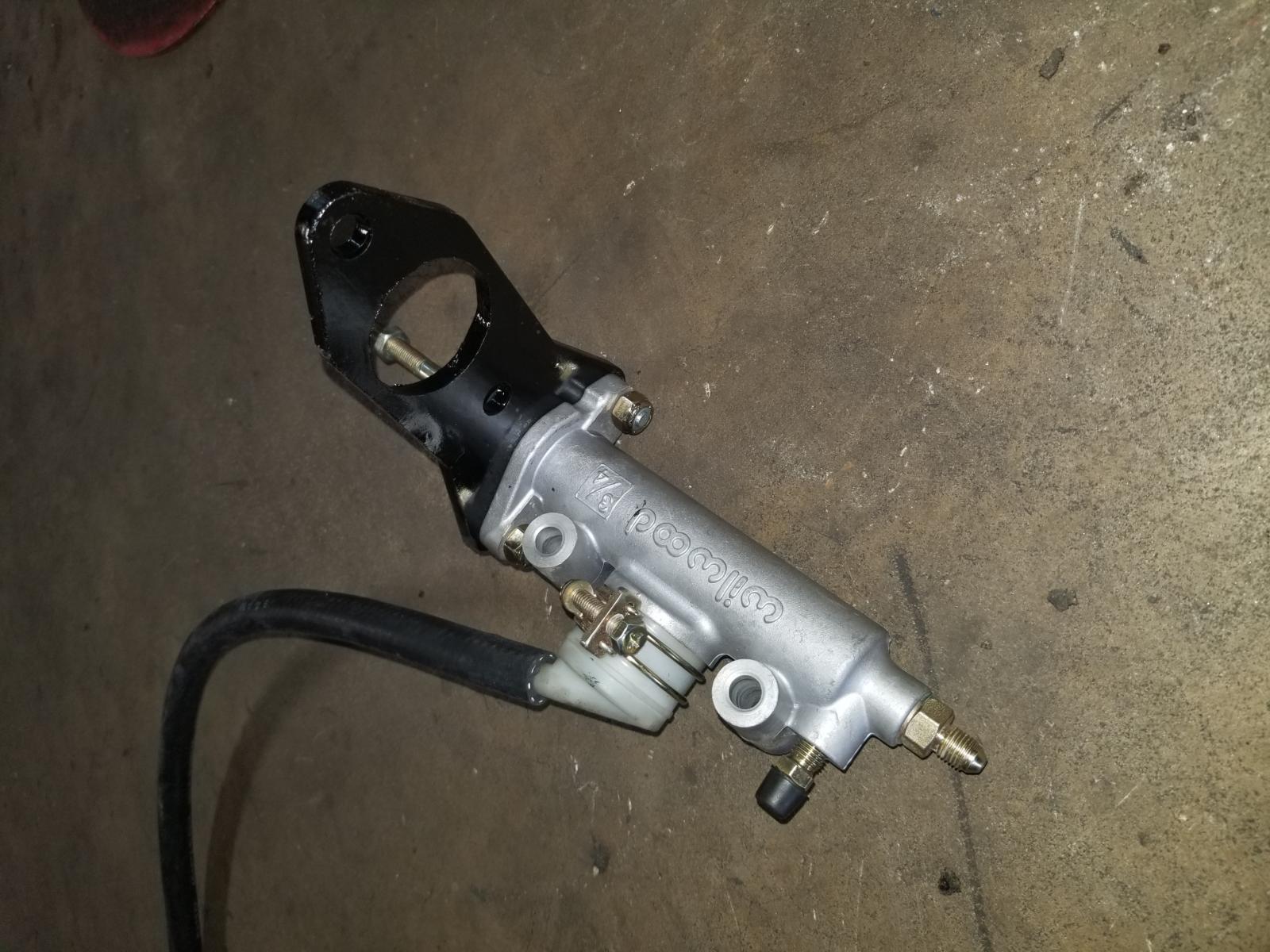

      clutch master
      I;m using a Wilwood master cylinder, and a mount bracket I designed and had cut out for me. It will sit in between the brake master cylinder and the brake mount, which will locate the clutch master. A new push rod and hiem and it will connect to the original 1950 Chevrolet pedal assembly. Driveshaft will have to be shortened by 1", and fab a new cross member.

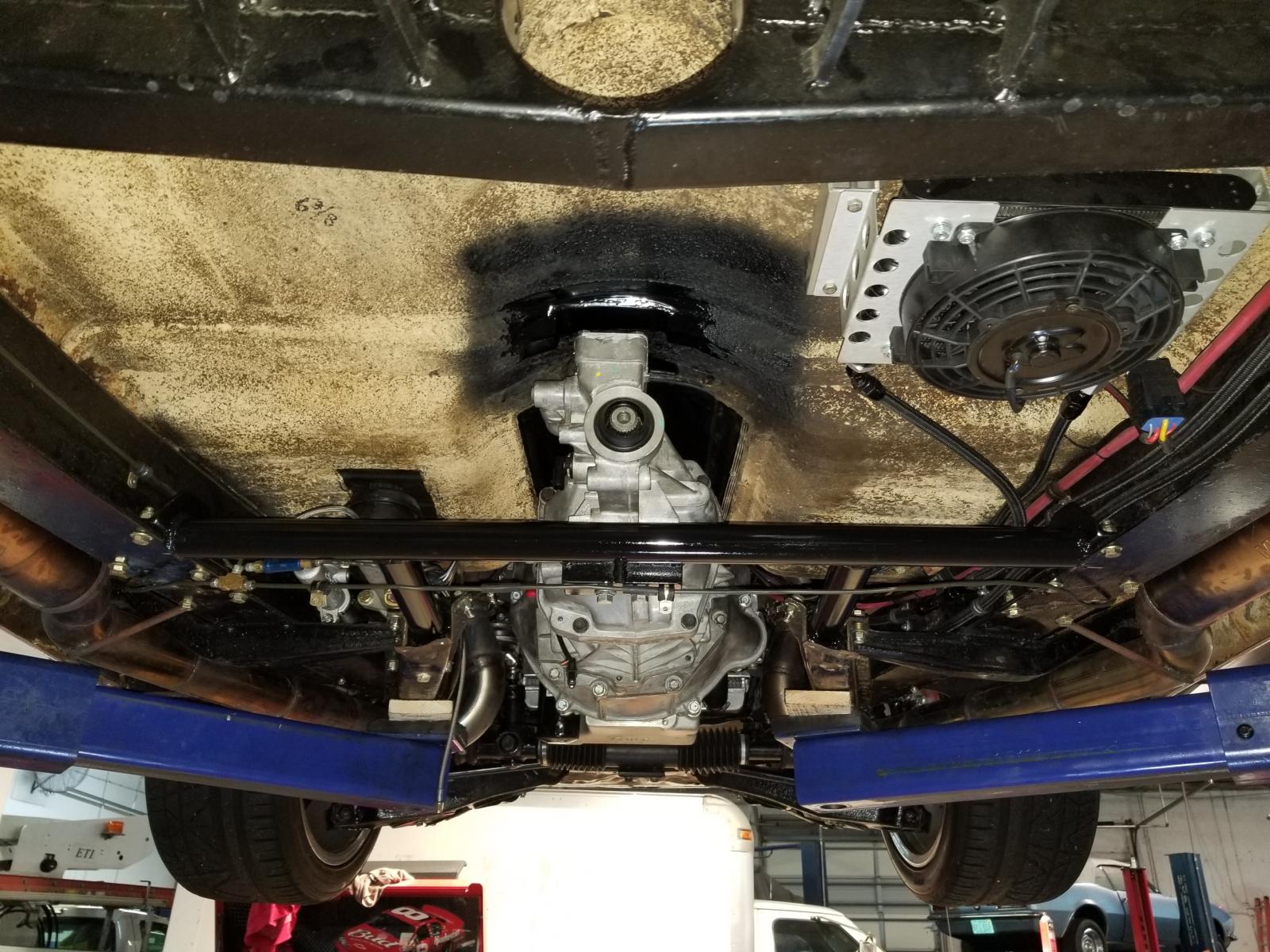

      new crossmemeber
      Decided to just build a complete new transmission cross member

    16. #136
      Mar 2013
      200
      cross member installed
      Here I have the cross member painted and installed, getting closer. NSRA Knoxville is a week away, have to get the car finished...

    17. #137
      Sep 2009
      2,996
      Very nice! Any pictures of how the MC connects to the clutch pedal?
    18. #138
      Mar 2013
      200
      Quote Originally Posted by ryeguy2006a View Post
      I used a master/clutch adapter mount from Chassisengineeringinc.com, other companies make them also. This mount allows a late model master cylinder to mount to the original swing pedals {original clutch is a mechanical rod actuation}. Then I made the mount in the pictures above to hang the cluch slave to the mastercylinder mount. In the second picture, you can see the linkage going from the original swing pedal, to the clutch slave.
