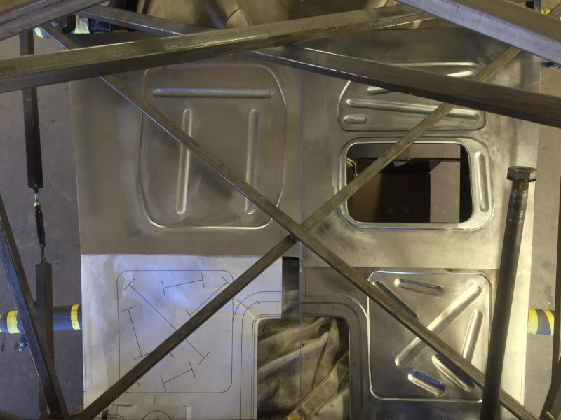

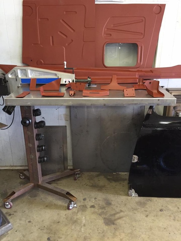

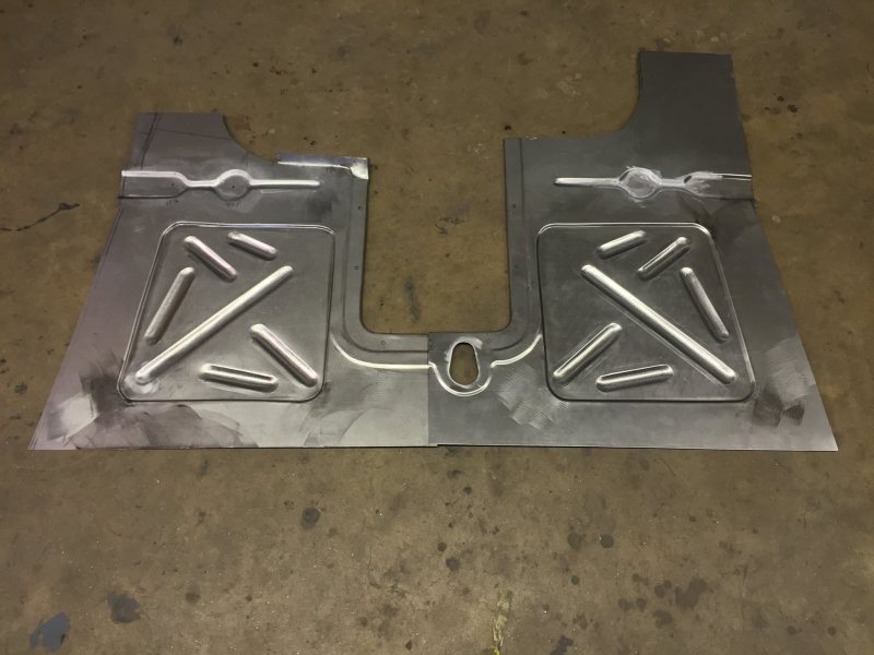

      Another vote for Mittler Brothers. We have their 24" motorized roller with 6-7 sets of dies. I've used it to accurately reproduce floors, rockers, braces, and other sheetmetal parts for a '40 Packard. Might cost more up front but it's worth the difference and it'll hold its value better. It's tough for one person to turn a crank and accurately feed the metal into it, electric is the way to go. Summit Racing had the best deal on them when we were shopping for a bead roller.

      adding a nice table or incorporating it into a bench like theastronaut has in his pic makes working solo w/ large panels much nicer & easier
