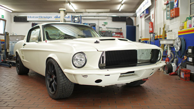

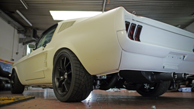

      For example, this is Udo Fink's '67. He lives in Germany and built this car to take on the Nurburgring. As such, it has the upgraded g-Link options.
