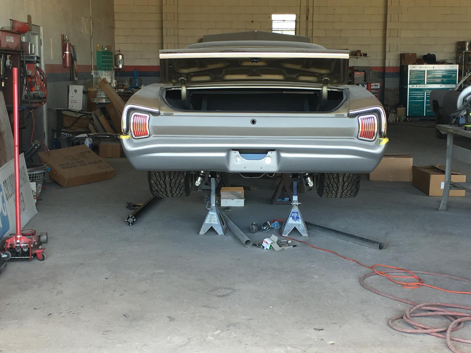

      Starting to get the pieces back on. Funny no one makes anything for a 66 Tempest/Lemans for tail light to body seals, guess I'll be making those.
      Better look at the stance. I did push it a bit with the front wheel backspace, which is huge, pushing the wheels as far out as possible. Looks like we'll have to ratchet up the coil overs a tad and roll what little lip we can on the fenders.
      I'll have to fight the brake booster issue later next year, the wallet is officially drained for this year.
