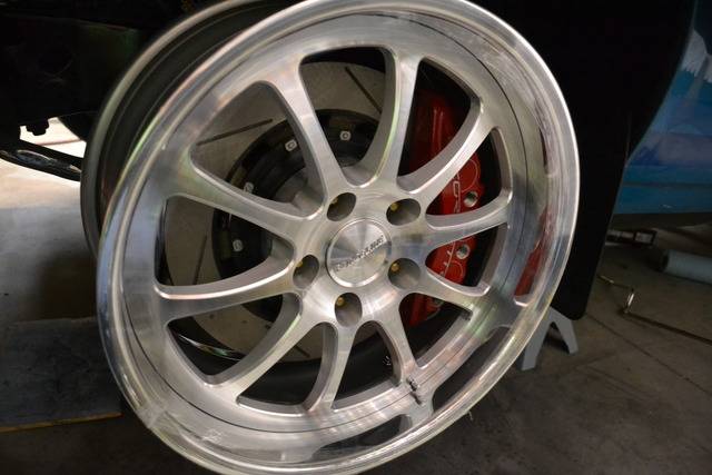

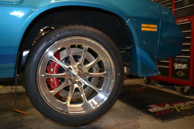

      In the Front I ,m running 5 in BS on a stock subframe wheel size here is 18in - 8.5 wide Have room yet to move inboard 1/2 so max would be 5.5 in BS before hitting tie rod ends I.m using all of Kore 3 stuff. So a 18 x9 wide with a 5,5 in BS should be good
      Which Forgeline wheel style are those?
      Fond Du Lac,Wisconsin
      190
      Its The Premier series ZX3P With polished outer hoop and HTM Brushed finish center section With hidden bolts ,I hate cleaning around bolts If you order from them make sure use ask for the longer center caps the short ones will hit the center dust caps

      Differant shot of the rim
