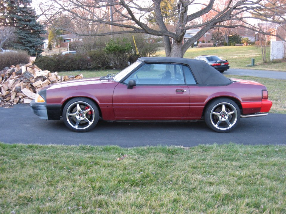

      My most recent project. 1989 Ford Mustang Convertible, pro-touring/ track day car.

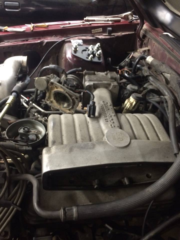

      The initial plan was to go full Maximum Motorsports SN95 and 8.8 suspension. I had all the parts then realized that I always likes how the 1999-2001 Cobra's IRS felt. I then decided to sell off the SRA 8.8 parts and bought a 2003 Cobra IRS. It was delivered to my garage by the seller, a great guy to say the least.

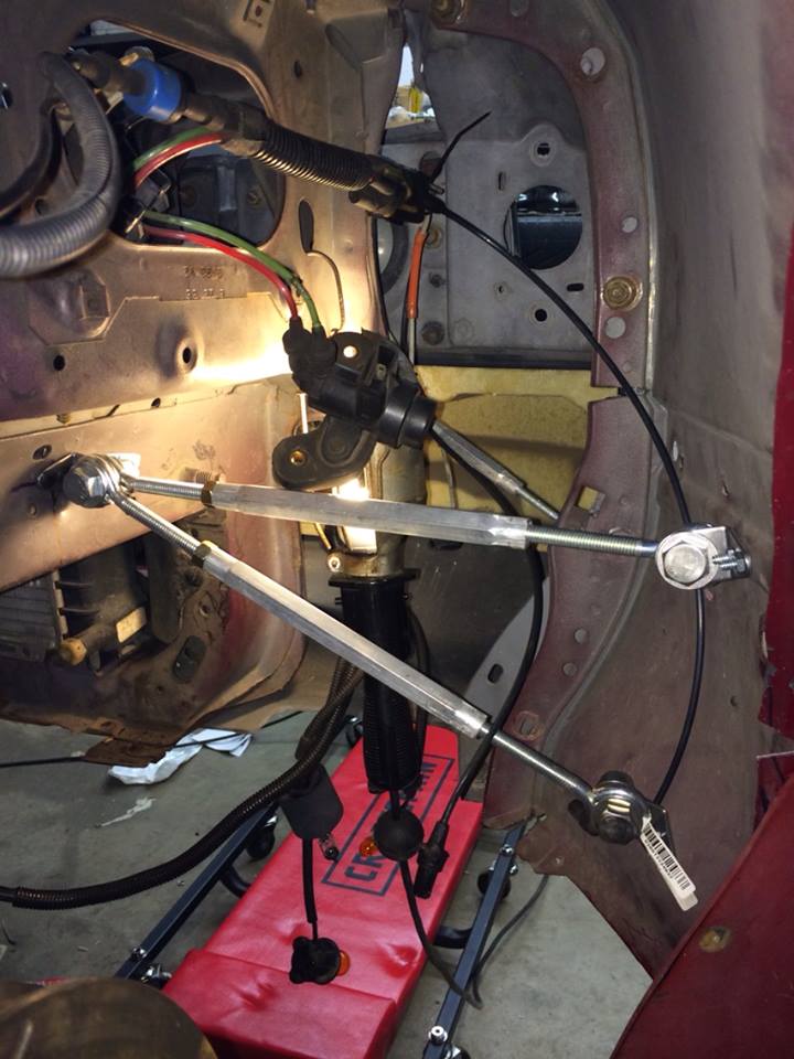

      The coolest part of an IRS is the negative camber, here is a picture of 0 negative camber, then -1 degree camber. It was discovered that the 1991-1993 Mustang Convertible frame sat 4" lower. A complete top and frame was sourced from Chicago and delivered by a good guy. A 1993 Saleen Spyder Tonneau Cover was located and should cover the top when down as well as the rear seats. 1993 Mustang Leather seat skins were swapped. 1993 Mustang rear inner panels, front and rear seatbelts were installed. In 1989 there was only a lap belt in the rear.

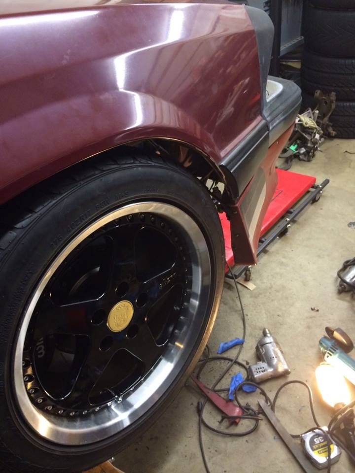

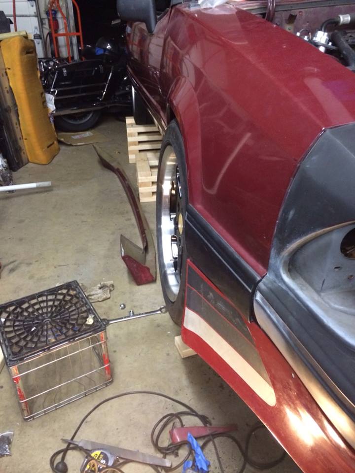

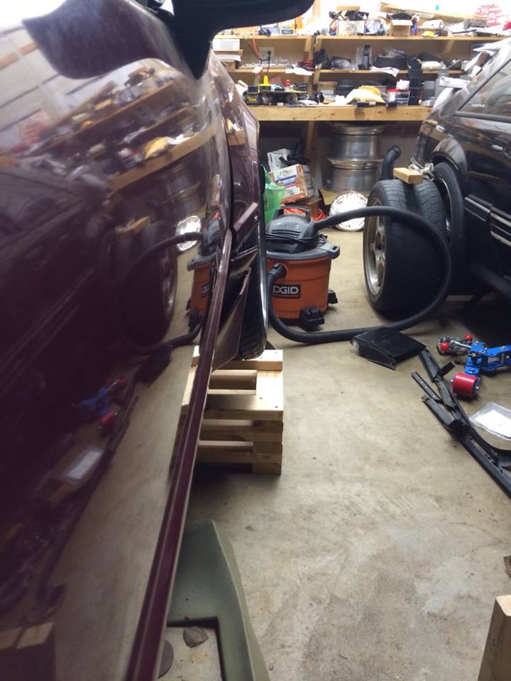

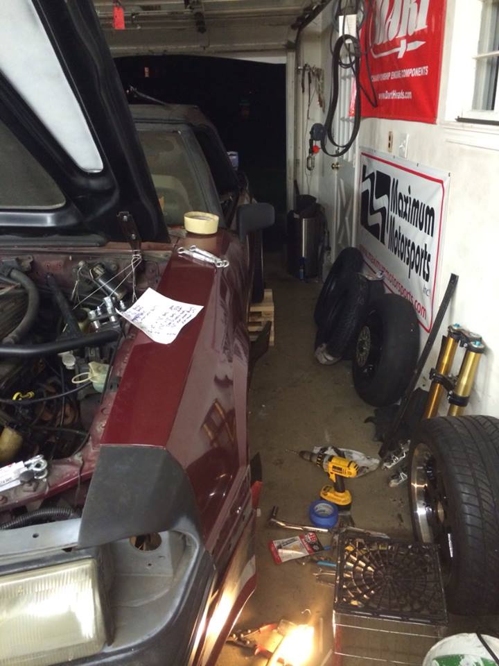

      SN95 Maximum Motorsports forward offset control arms with 17 x 9.5" Stern Face II wheels with 275/40R17 tires. They stuck out 3/4" with full negative caster and camber. Having been able to fit the same wheels before, the 1.5" wider and 1.5" added wheelbase added a learning curve. Before stretching with just a baseball bat.
      During

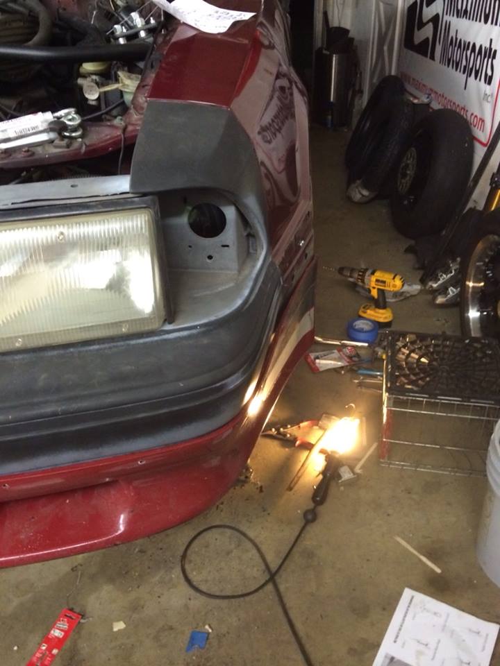

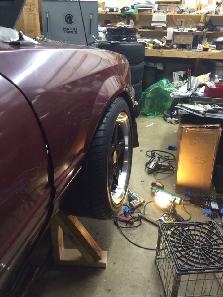

      After final metal pulling and stretching.

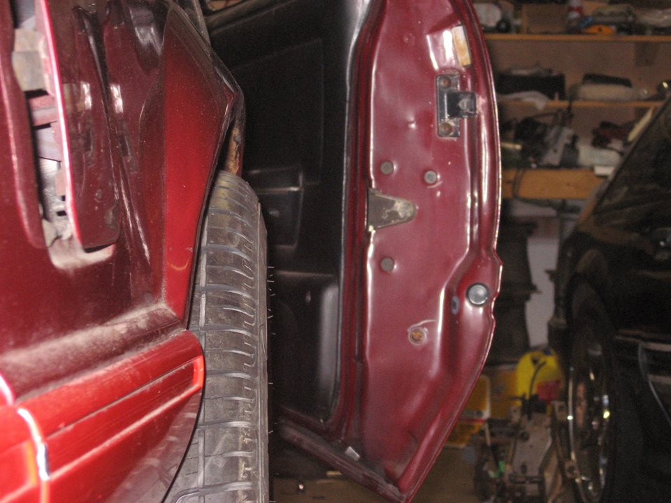

      At this point there was still rubbing on the front valence and the rear section of the front wheels were exposed and that was not what I believed to be safe with a convertible top. Further turnbuckling the fenders from the frame rails helped clear everything.

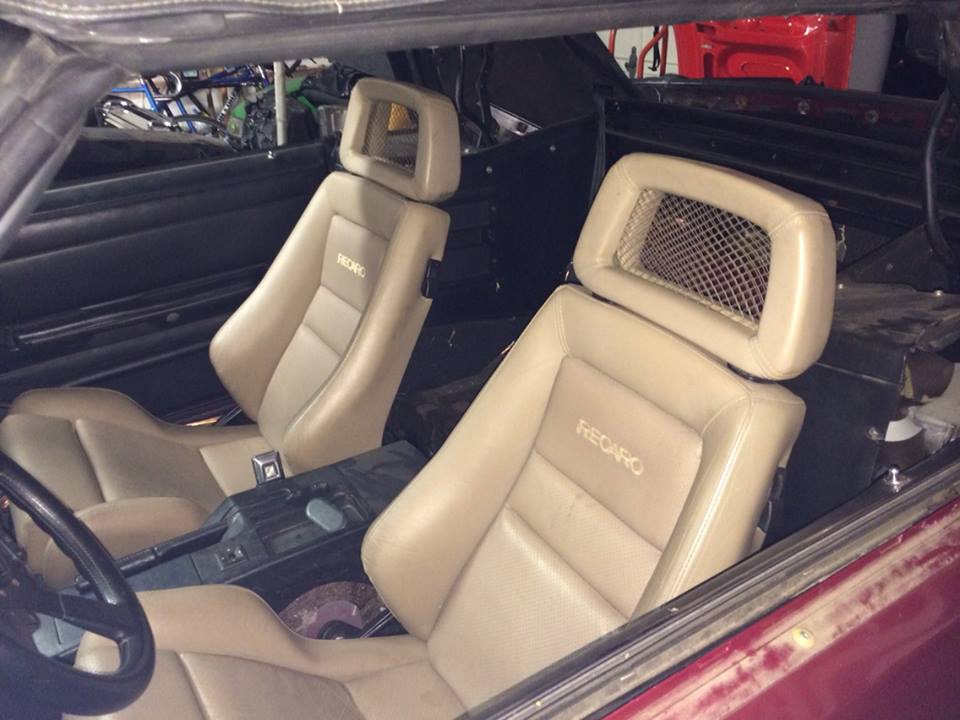

      Having spent 6 months with the cloth Recaro seats I wanted to find leather and convert the interior to Saleen SC spec. The closest seats I could find were brown, from a Porsche, but I could dye them. Driving at night and evenings with the black gauges became a little boring and a choice to go all white face gauges was made.

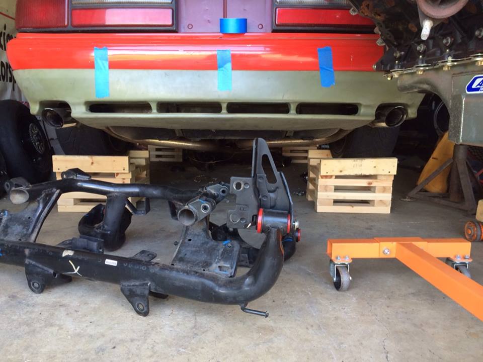

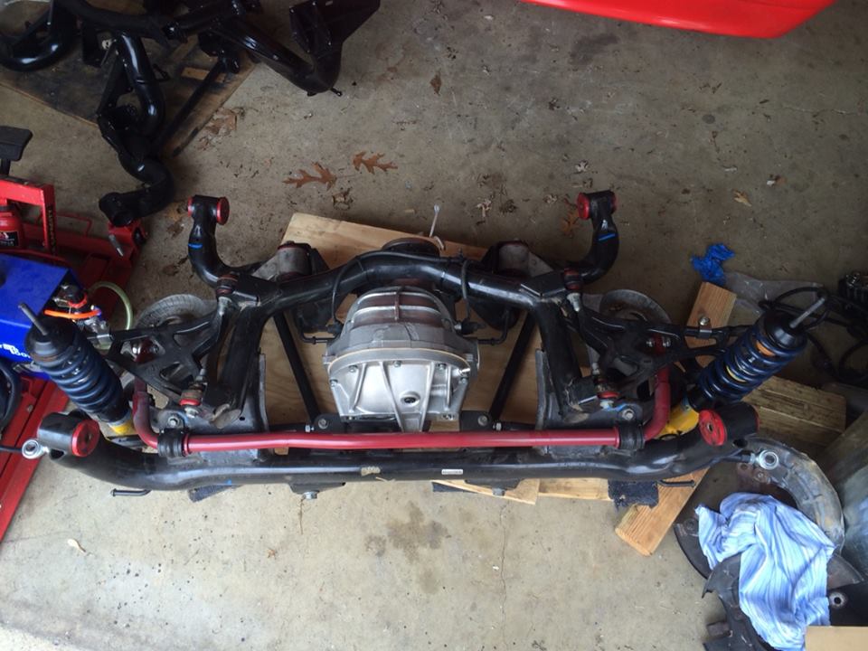

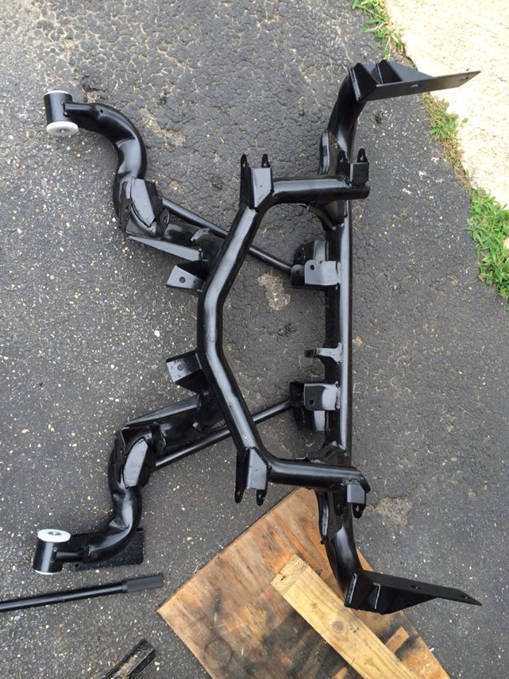

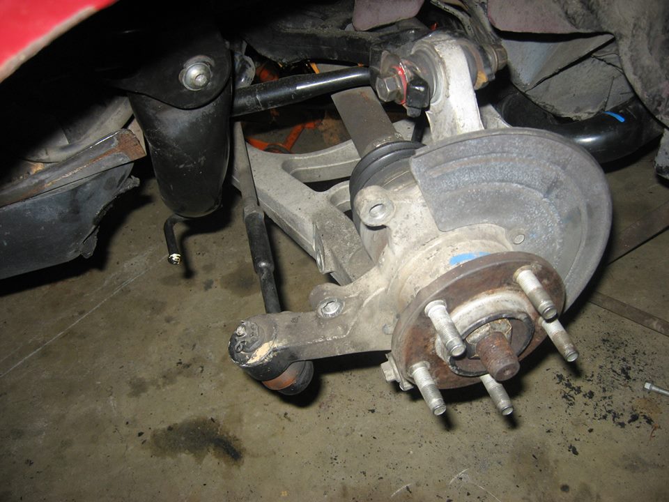

      The IRS was pulled and upgraded to where I could live with it I thought.

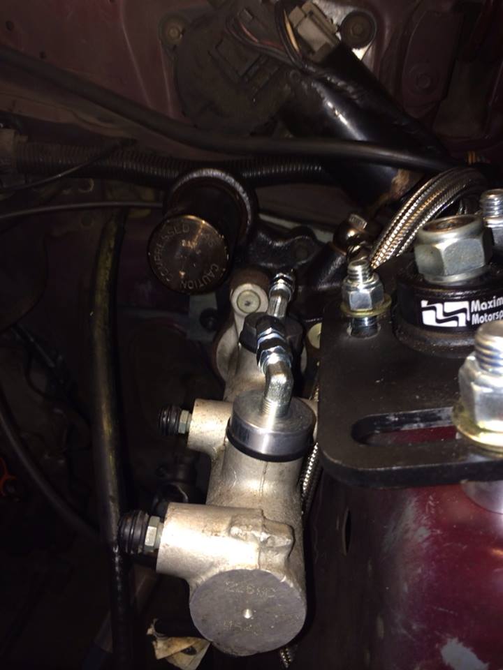

      It was at this point that things started to become apparent. Having an IRS with ABS, why not retain the 4 channel ABS, Hydroboost S281 Saleen Pedals and steering. With the IRS, the apparent issue became the lack of rear wheel space. I measured and discovered that I could gain almost 1" if I had a hard mount. I called Kenny Brown and spoke to Rich Cotrell and the rest is history. I originally asked for the steel parts in order to fabricate a hard mount myself. It was apparent that they would not sell them to me. After trading emails with Rich he made me an offer. Kenny Brown used to make geometry corrections for the 1999-2001 IRS subframes but had stopped with Heidt's and never restarted the project. So I offered to send Rich and Kenny Brown a subframe. Rich offered to restart the program and build a jig off this modification. The work was completed and badass to say the least. I had previously installed a Detroit Locker, Eiback Sway bar and all urethane bushings in addition to a FTBR rear differential that was modified cover with a FTBR delrin differential bushing. The IRS came out again and Delrin lower subframe bushings from Drop Engineering were installed as well as a rear differential lowering bushing that is clearance for an IRS cooler. Front FTBR aluminum differential bushings were installed and the subframe was clearance for the 2003 Cobra front differential brace.

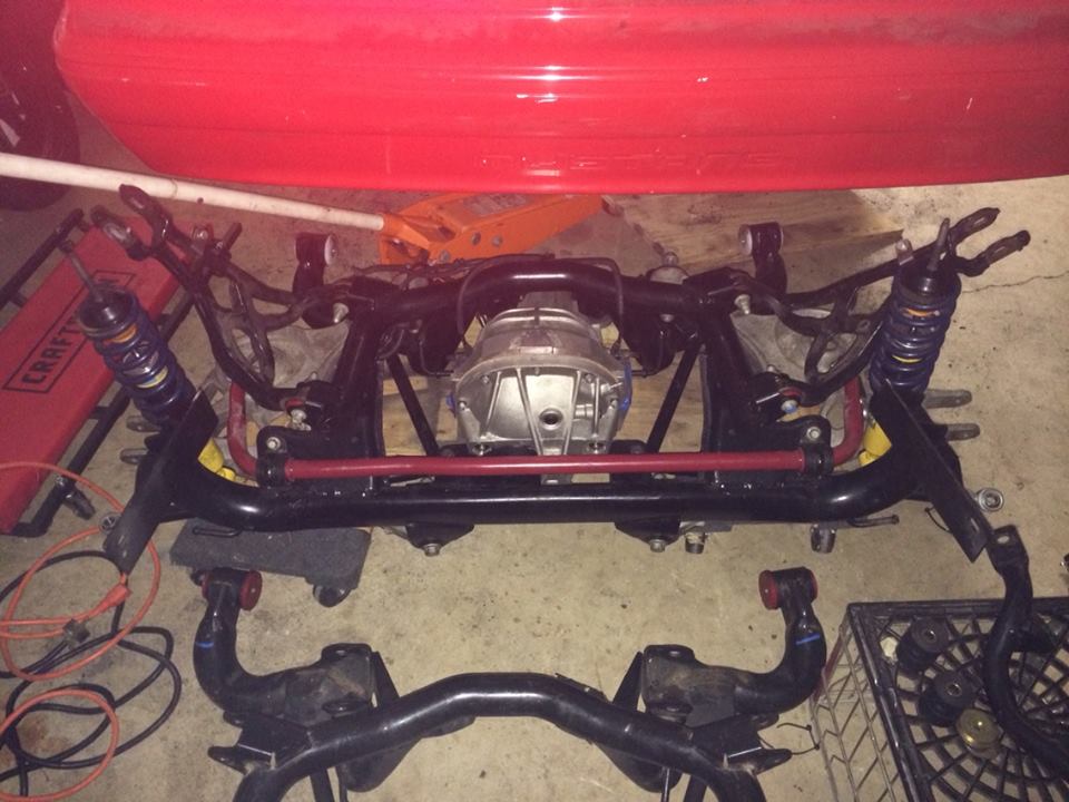

      IRS ready to go back in. I have to admit I have had no help on this project as the previous owner, a good friend, left for New Hampshire. Installing an IRS three times is a hard work but rewarding.

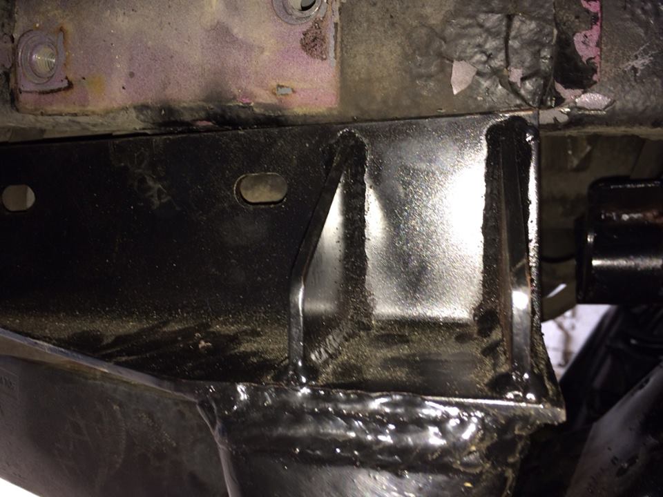

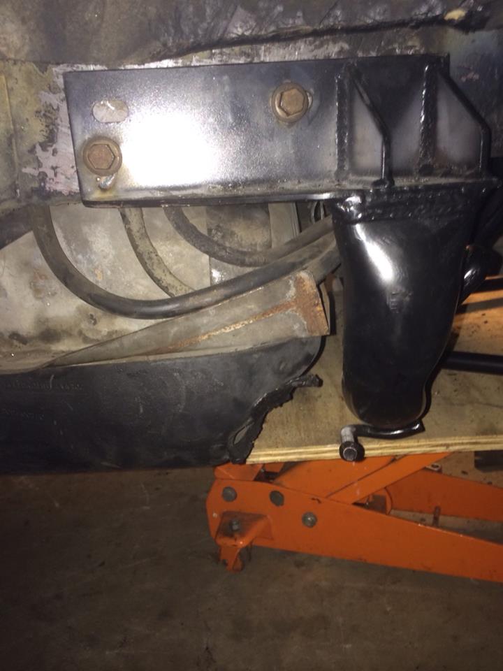

      The hardmount had clearancing issues with the rear shock braces. I did not know that removing the rear mount was needed. But a call to Rich at Kenny Brown was made and it was affirmed. So out came the plasma cutter from a good friend. The mounting points for the hard mount are also different for Fox body mustangs and SN95. Those were also plasma cut out and it bolted in easily.

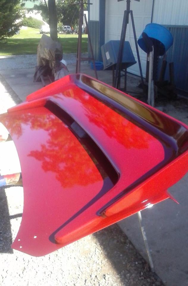

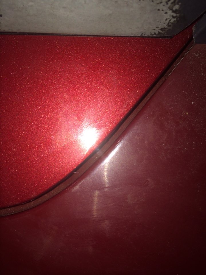

      A custom metallic red paint was made up. Lighter than the factory plain burgundy, this one has metallic's. It is called fire engine red and the wife likes it so it passes inspection. Originally I wanted to convert to Vibrant Red, 1993 Cobra Red. A factory Saleen spoiler was located.

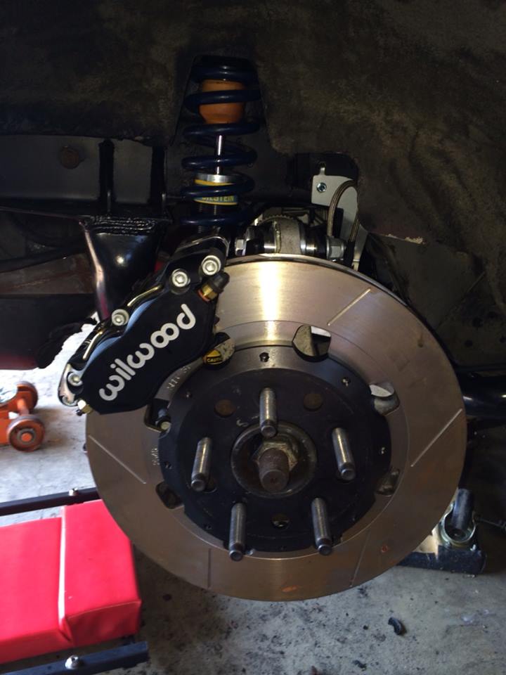

      I installed longer rear wheel studs and liked the two sets of 13" Wilwood on both cars so I opted for the Maximum Motorsport Wilwood 13" 4 piston rears for a close match to the 6 piston fronts. ABS sensors were purchased and installed. ABS sensor lines to mate to the ABS unit were fabricated. Factory 2003 Cobra ABS module, hard brake lines and Wilwood Stainless Steel brake lines were installed. Steeda made up the front wheel hubs with longer wheel studs. Spring rates are starting at 300# front and 500# rear per Maximum Motorsport recommendation. Through the floor subframe connectors were installed after purchasing the car. AutoFab RaceCars installed them. The car will go back for a roll bar, matrix bracing and strut tower funny car cage bars. I have discovered putting the convertible on jack stands the car is very flexible even with the through the floors installed. Mainly from the firewall forward.

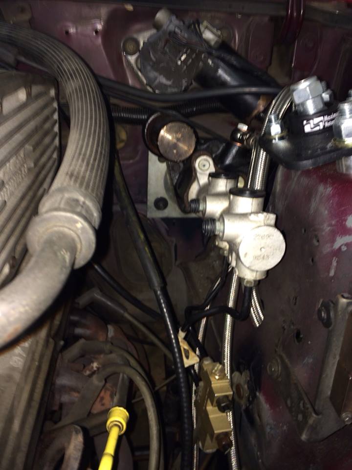

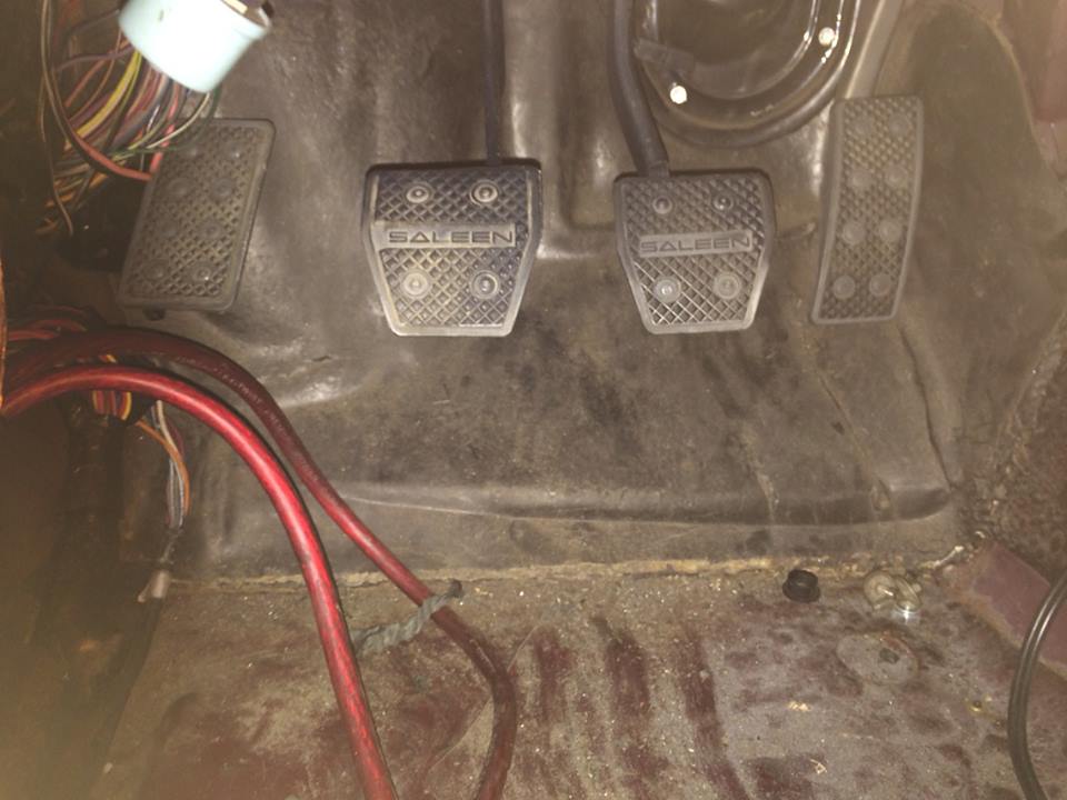

      2003 Cobra Hydroboost assembly as well as S281 Saleen pedal assembly grafted onto the Foxbody pedal box. 2000 Cobra R steering rack and Maximum Motorsport bolt through bump steering kit installed. Maximum Motorsports front sway bar and forward offset sway bar mounts installed. FR500 power steering cooler as well as 2000 Cobra R front mount oil cooler and 1995 Cobra R oil filter adaptor installed. The front bumper was cut to clearance the coolers. Stainless Steel braided lines throughout.

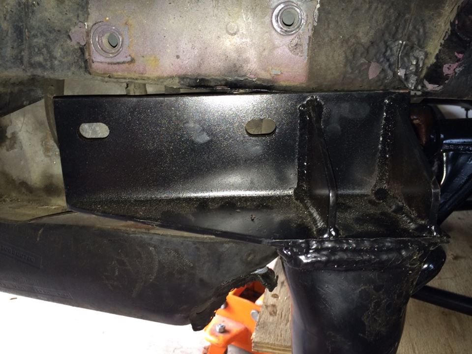

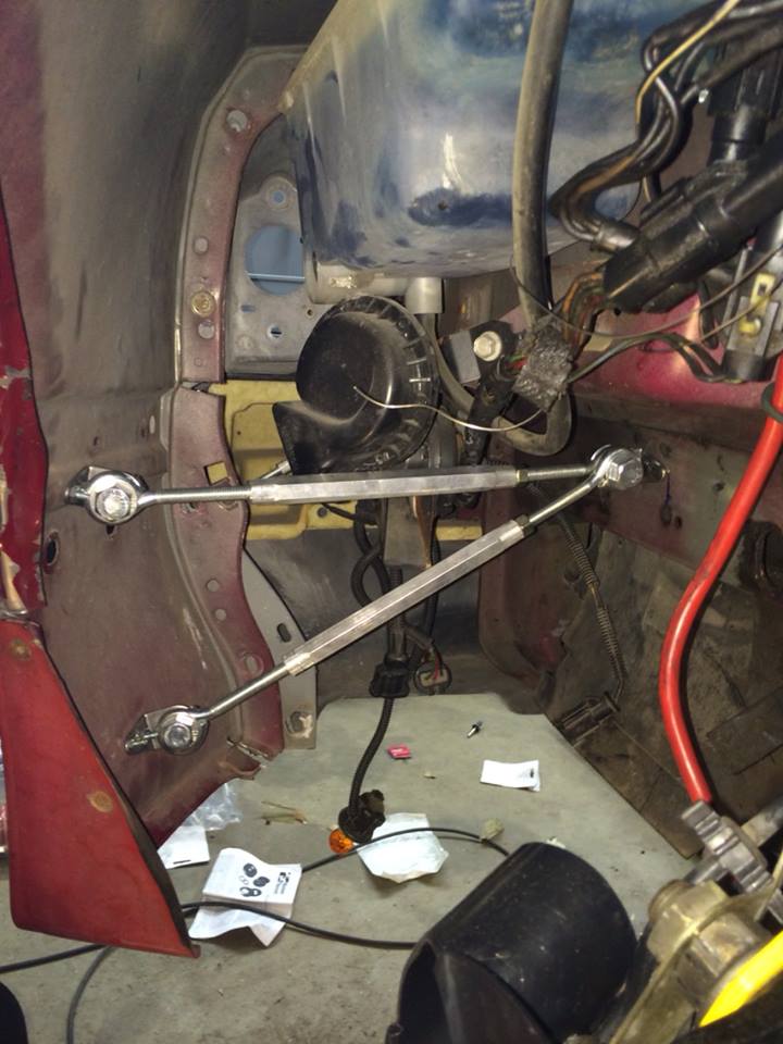

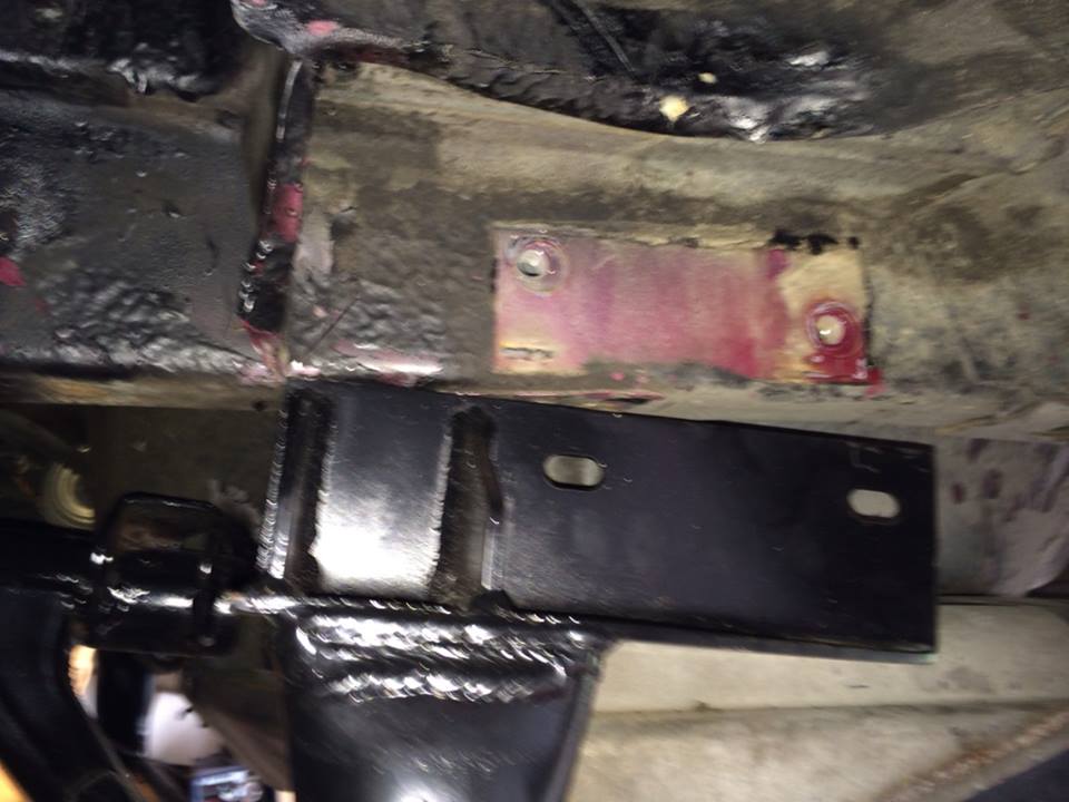

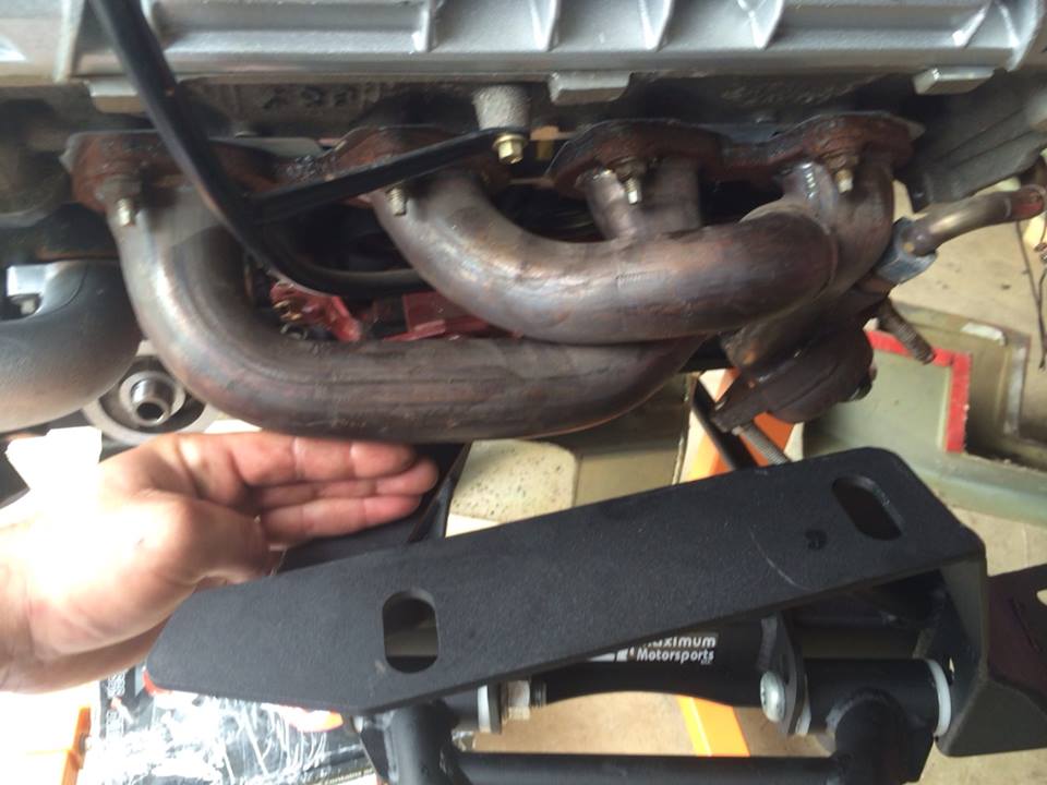

      Maximum Motorsports Caster Camber plates with full negative caster and camber presented a clearance problem as you can see from this picture. I removed the 2003 Cobra master cylinder reservoir as it was in the way. I might add at this point I was going to fabricate a remote reservoir when I found Rick Stevens at Lodestone Billetworks. I measured my reservoir bungs and thank god Rick was there. Without a lathe I was unable to fabricate the parts. It took a while for him to find a dependable company to make the parts but he came through.

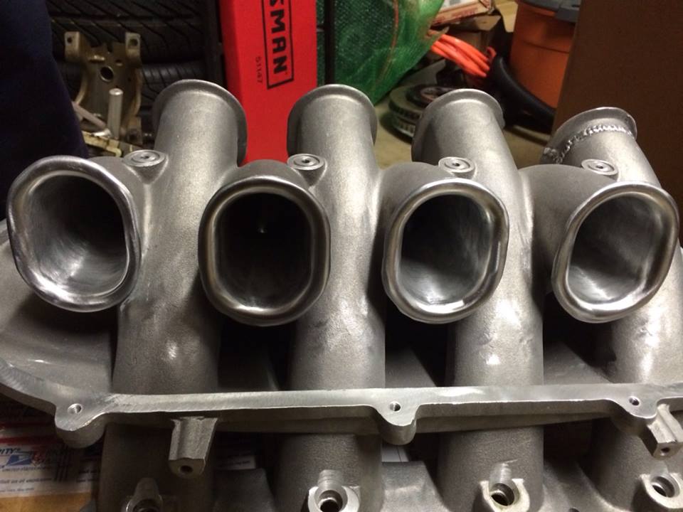

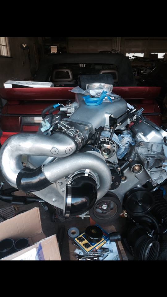

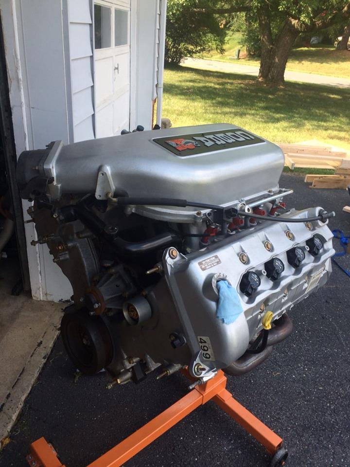

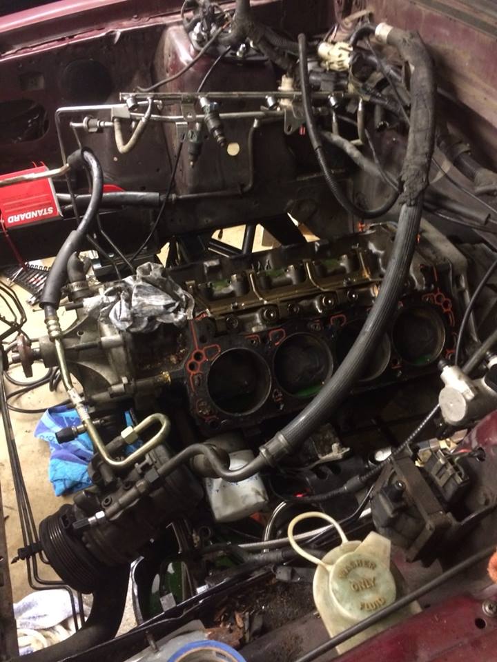

      I had originally bought the 2000 Cobra R engines for a future father son build. The more I thought about it, the more sense it made to install the 2000 Cobra R 5.4L DOHC motor. The car would now be in effect a Saleen SC Spyder bodied, 2000 Cobra R suspended car which makes sense now. Having already installed a 2000 Cobra R T56 for pushrod motors, the original plan was a 369ci 302 stroker with TFS R heads and a Vortech Aftercooled Novi2000 making 750-800fwhp. Needless to say the plan changed for the better.

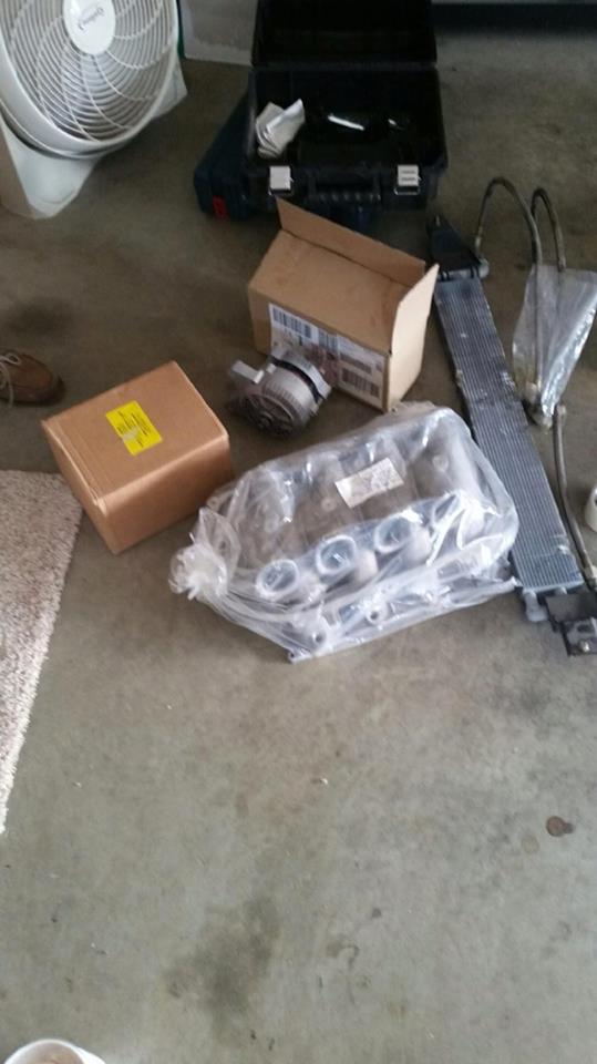

      The engine came bare, but the seller, truly a great guy, sold me the supporting pieces I needed to get the ball rolling.
      I had always sourced my engines locally or built them for other people. I have never shipped anything larger than a hood or engine block perhaps transmission personally. How cool is this, the owner of the engine and how he shipped it to me. Motorheads rock.

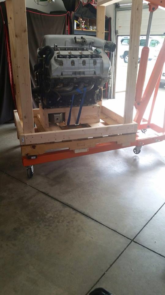

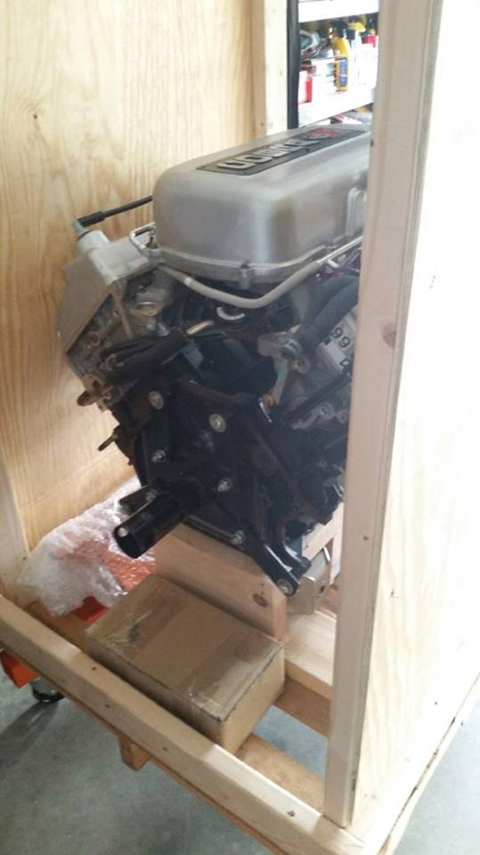

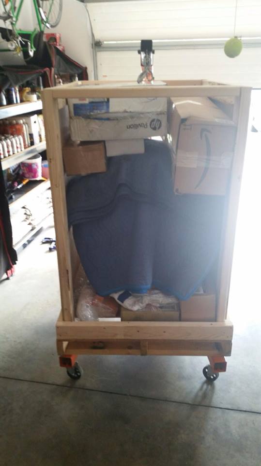

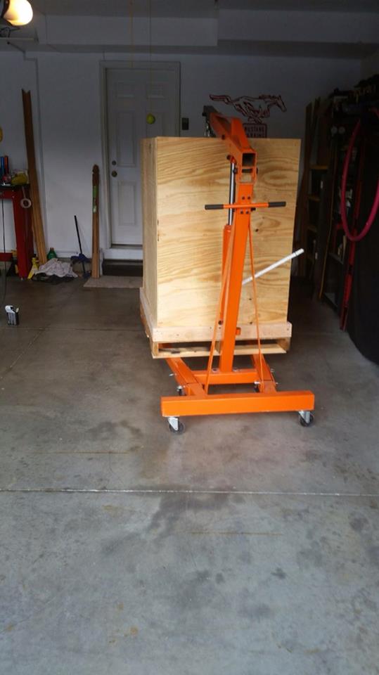

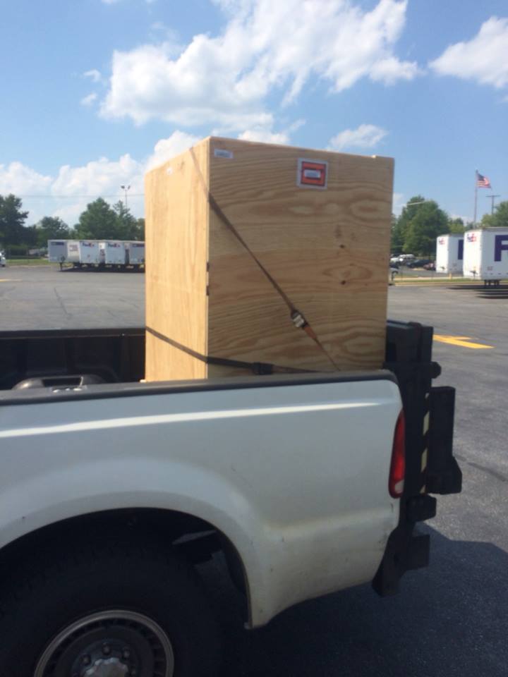

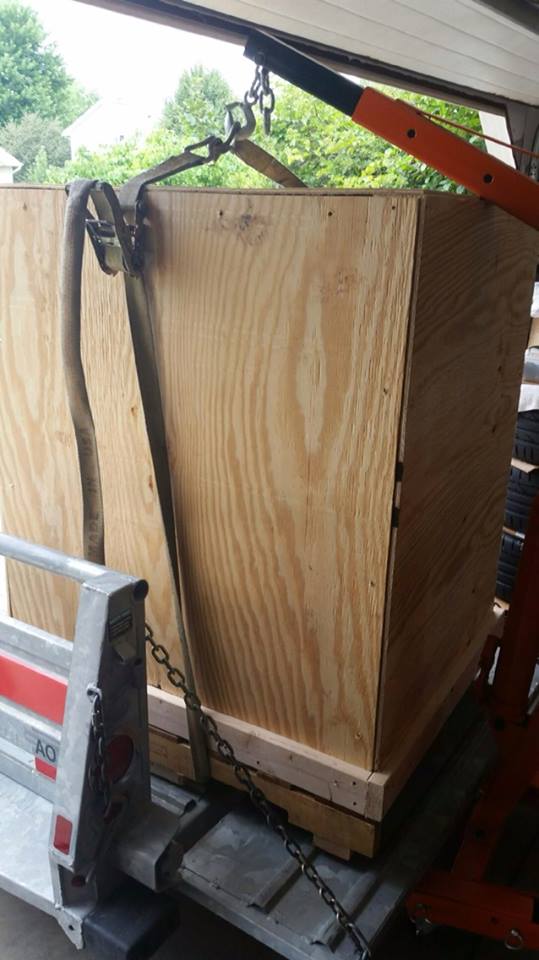

      Now how to hell do you get the 600lb box home? Jan Norris, the man at Precision Engine Machine leant me his self loading F150. It would have been a mess otherwise.

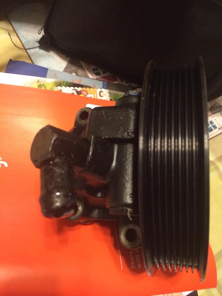

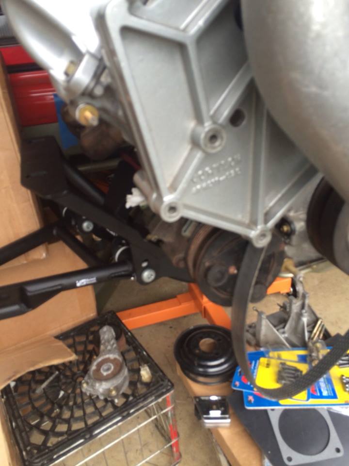

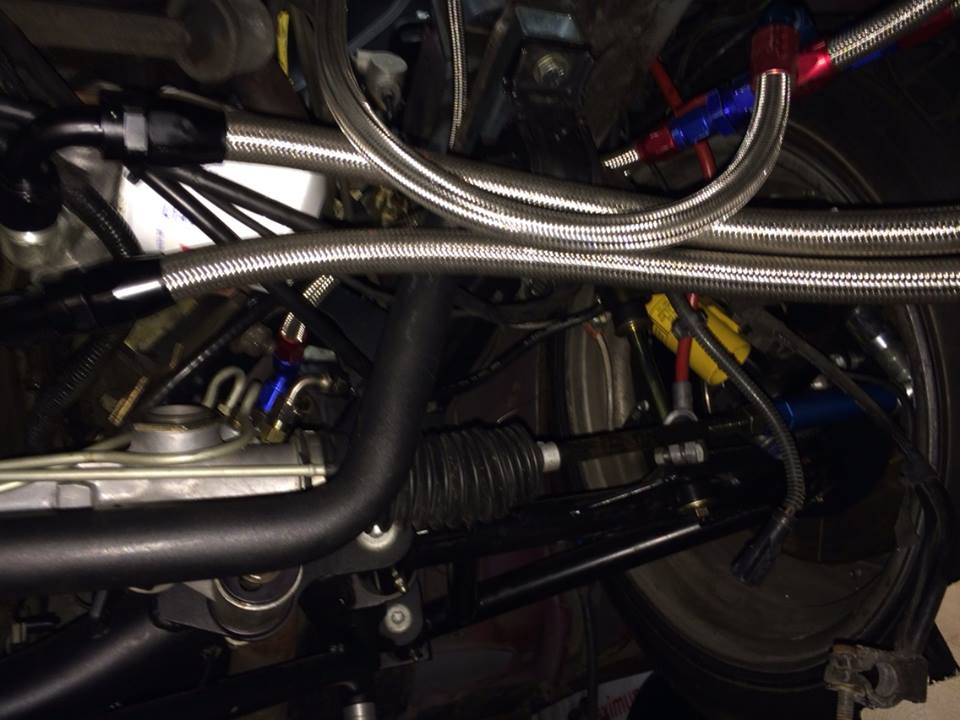

      A full 6 rib serpentine was added power steering and all. Keeping the AC was the plan so a tensioner was taken from another 5.4L Navigator engine.

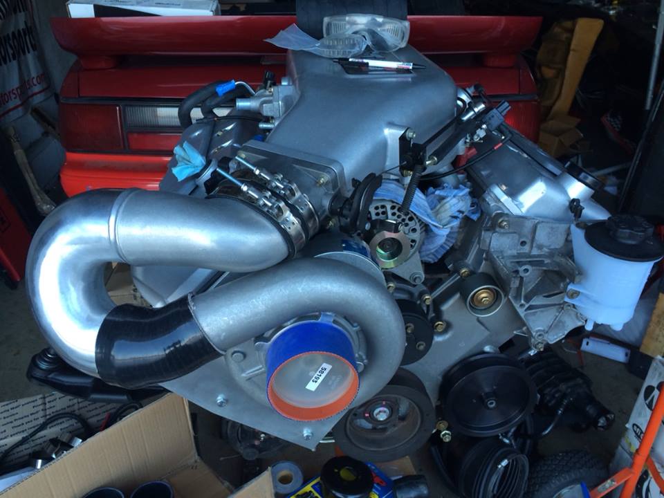

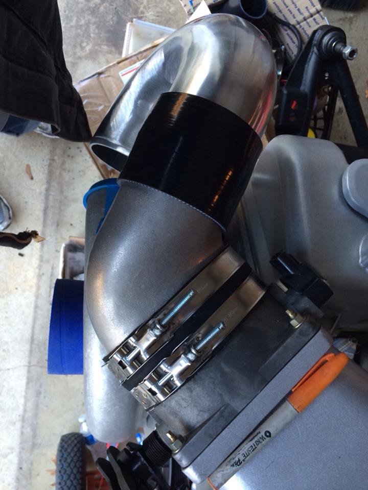

      Staying with the 750-800hp goal, a Vortech YSI was located at a great price.

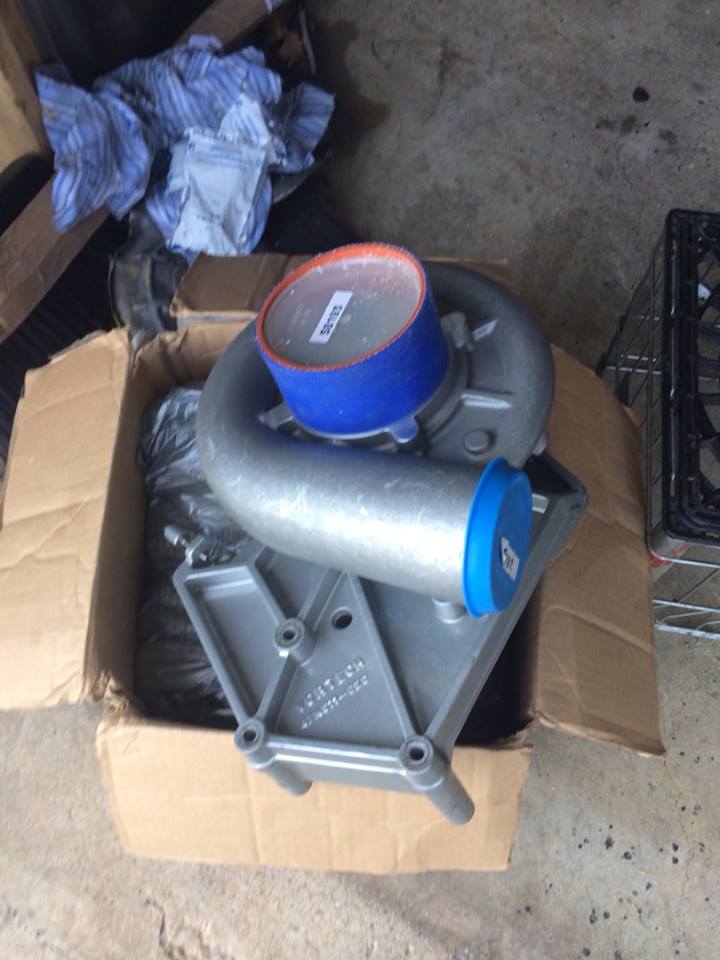

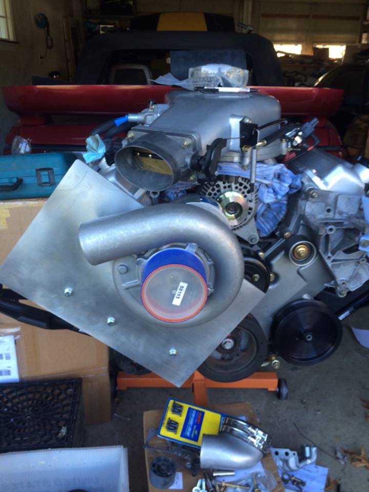

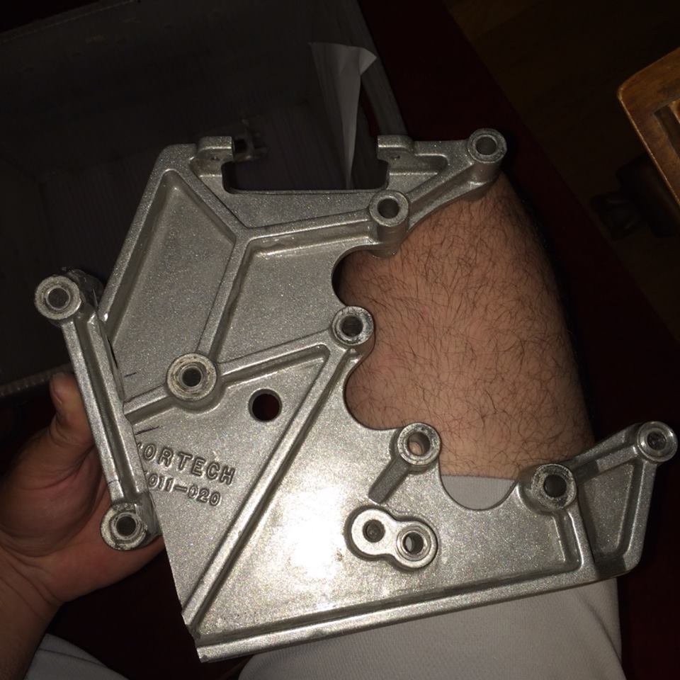

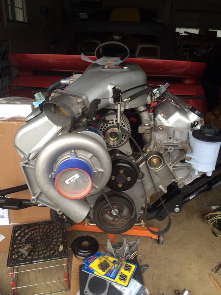

      The major problem with the Vortech is that Vortech never made a kit for the car. A fellow by the name of Bill Anderson in Georgia as well as one other fellow have made a successful install with S and T Trim's with the factory bracket I was told. Here is a pic of how far off the 4.6 bracket is.

      Having had an ATI Procharger on a 347 in 2003, I knew that belt slip was going to be an issue with the 6 rib factory configuration. As the build progressed 8 rib serpentine pullies were sourced in an attempt to facilitate a conversion. A custom underdrive 2000 Cobra R power steering pulley is currently being made by ASP pullies. An 8 rib AC compressor clutch and the rest of the 8 rib parts are all readily available for other Ford 5.4 engines. The 2000 Cobra R drop motor mounts were also purchased and installed. A Maximum Motorsports Modular swap K Member was also purchased. Stock 2000 Cobra R Shorty headers will have to do for now. There is no swap header made for a Modular 5.4L engine into a Foxbody mustang. Long tube headers will have to be a custom deal.

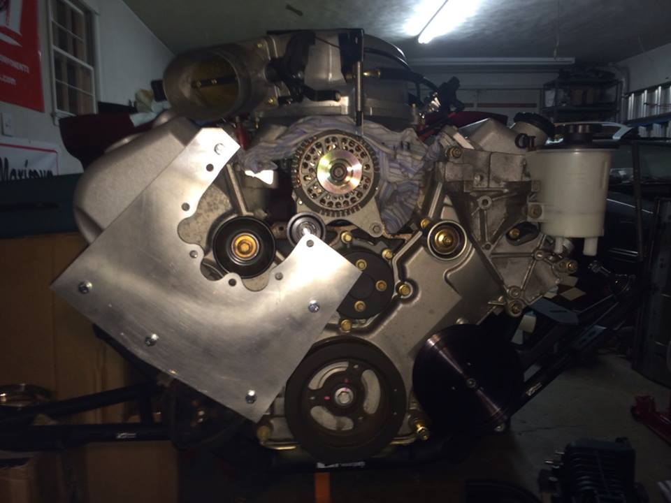

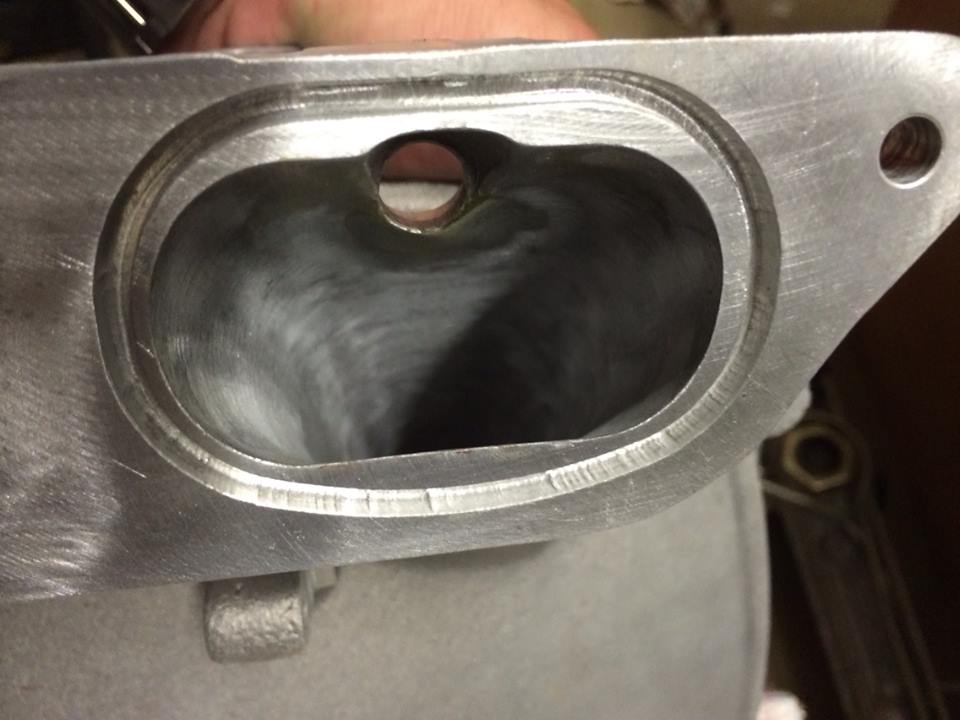

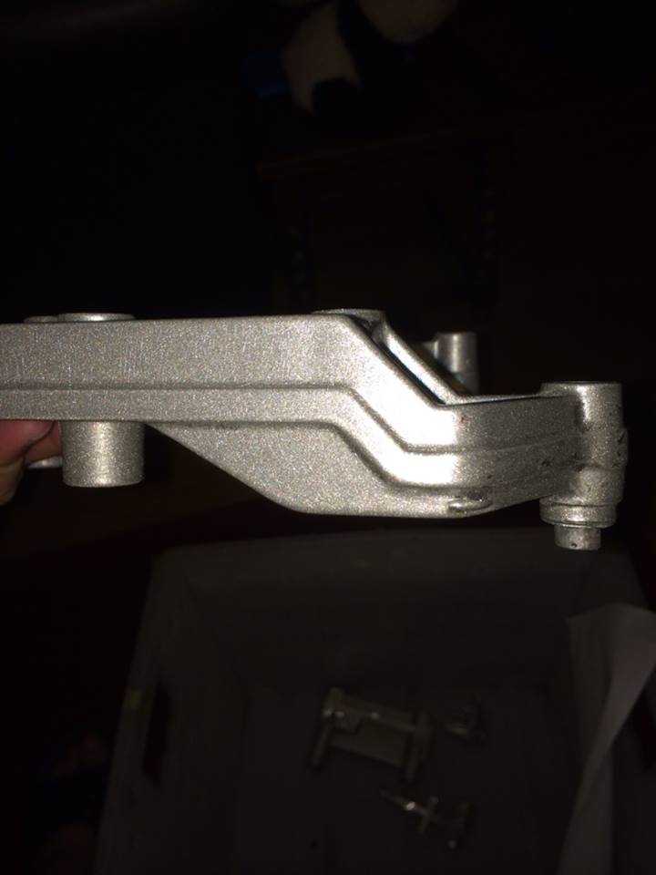

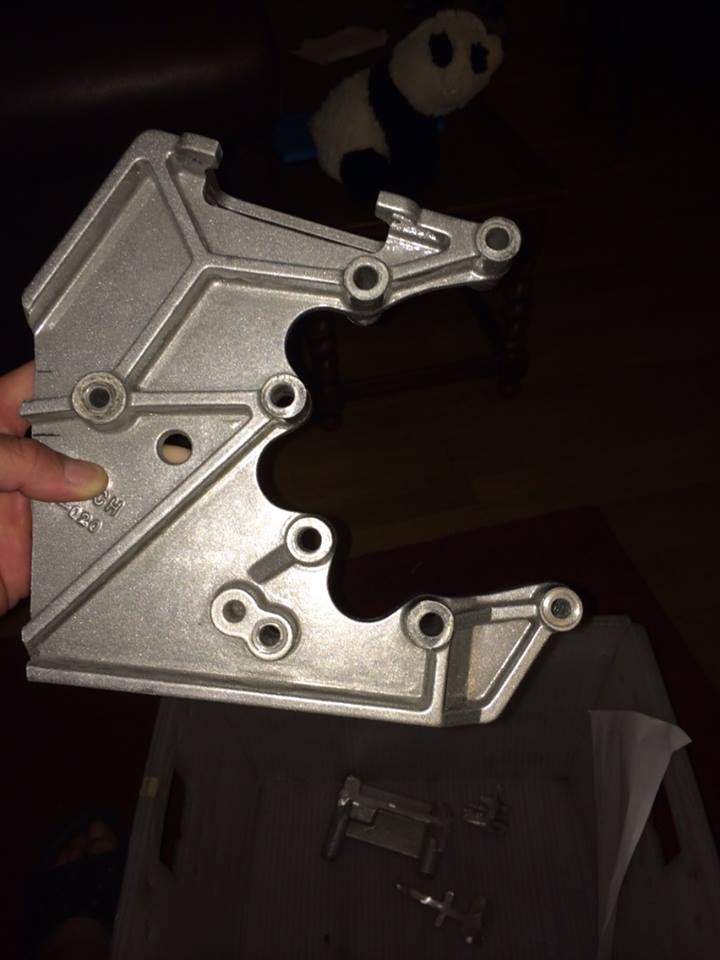

      The current state of affairs is the blower bracket. I cut up the Vortech unit and made measurements. I then found emachineshop.com whom sent me free CAD software where I designed a new blower bracket. The problem arose when I could not get the program to go 3D. I then eventually heard back from them and was told that they could not CNC me one or two brackets, that it would cost a lot. Never got a price from them. I had already started buying aluminum bar stock and a Custom Vortech mounting bracket for a V7 Vortech YSI. The plan is to fabricate my own bracket.
      The T56 as is will not work with a Modular 5.4L motor, only a pushrod engine. I have purchased all the needed parts including a front intermediate plate in order to convert the T56 over to Modular spec. I have also managed to source a McLeod clutch and Aluminum Flywheel. The project is slowly coming together.
      The old 302 was going to get a Paxton Novi2000, Edelbrock Heads and Saleen Holy Grail intake manifold. That plan was started and abandoned. The deciding progress started as an oil leak that the factory valve covers had. Let's just say that I decided to tear apart the top end and an end to justify the means of installing the 2000 Cobra R engine.

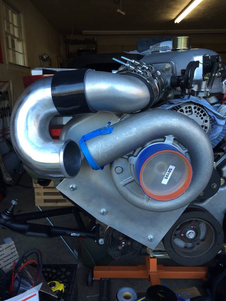

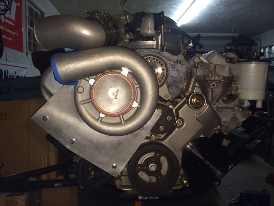

      The universal blower mounting plate showed up Thursday. I'll post pics once I get my mounting points marked and drilled.
      Know anyone in MD, DC or VA with a CNC machine? I am going to need the plate to be trimmed down to size.

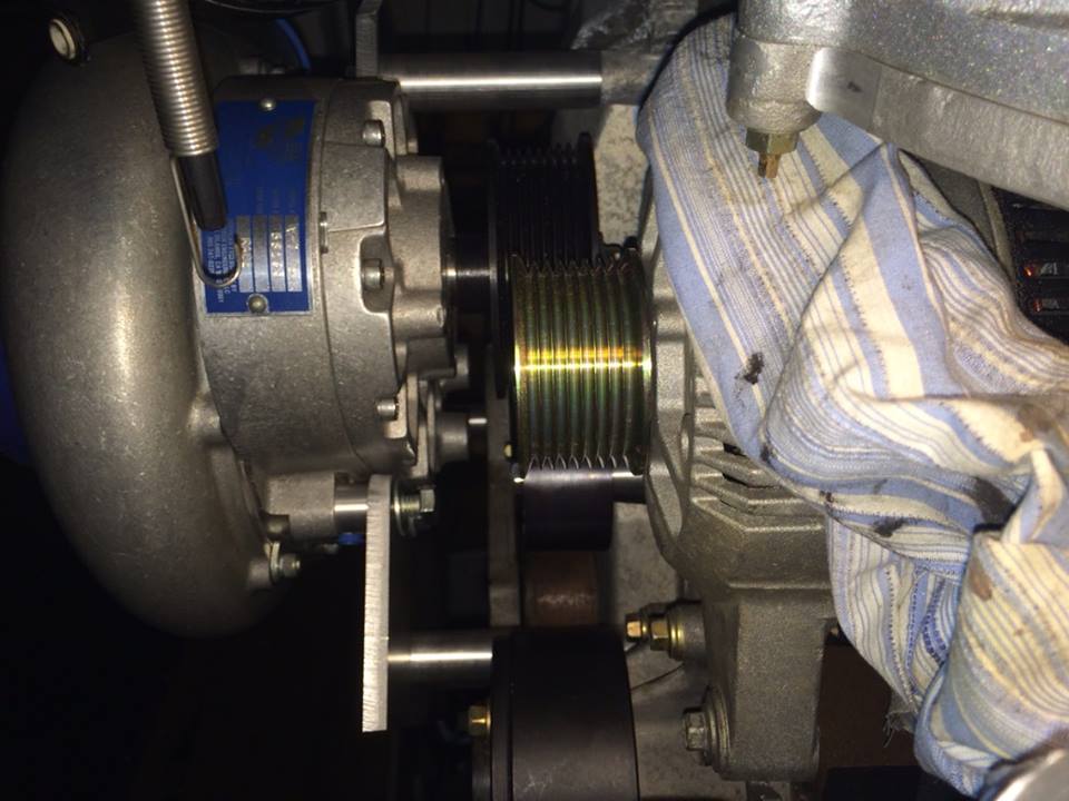

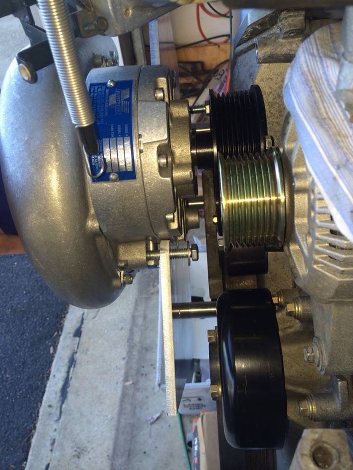

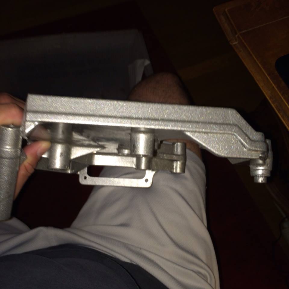

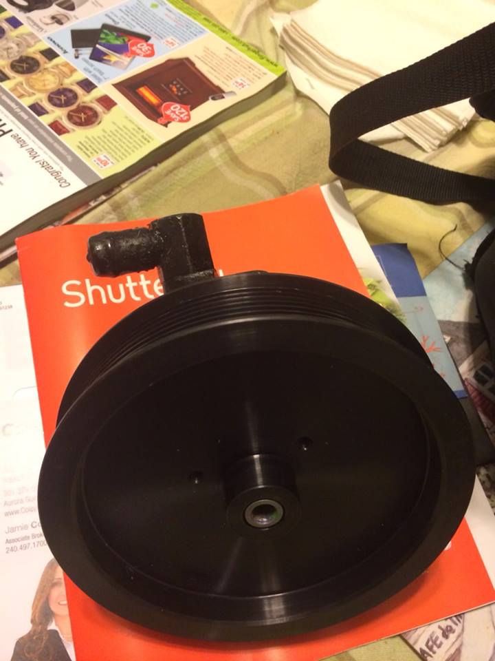

      Got the custom ASP 8 rib asp pulley back installed

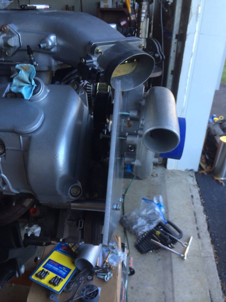

      Before and during pictures of the custom 00R YSI bracket that I am building.

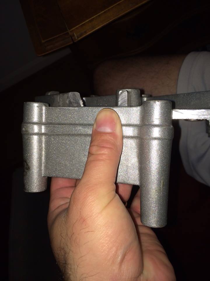

      I am going to have to have 1/2 spacers made to space the blower from the plate due to the feed line. I also had a custom spacer made to make the Vortech 8 rib idler pulley freestanding and not sandwiched like the Vortech bracket.

      A few updates. YSI bracket is almost complete, just got to drill one more mounting bracket hole. Custom ASP water pump pulley came in as well. Plans for wheels has changed, going with 10.5" front and 12" rear wheels with Toyo Proxes R888 295/355 series 18" tires. To do this I needed more fender. Bought the Tiger Racing flares. 18" rolled lips and barrels are in and centers need painting. McLeod SFI Bellhousing came in as well. Going to finish install the blower and check serpentine belt clearances/ tolerances.

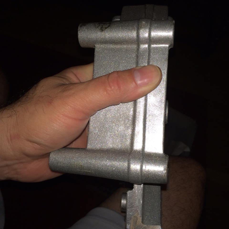

      Belt alignment is off 1/4", this can be turned down. Custom 1" smaller ASP water pump pulley installed. Looking for rubber hose and aluminum tubing now. Need 8 rib crank pulley, Thump rrr 8 rib tensioner and 8 rib AC pulley before I can measure and buy a serpentine belt. If anyone has Mondo BOV I need one too. Thinking of going E85 instead of intercooler or methanol injection.

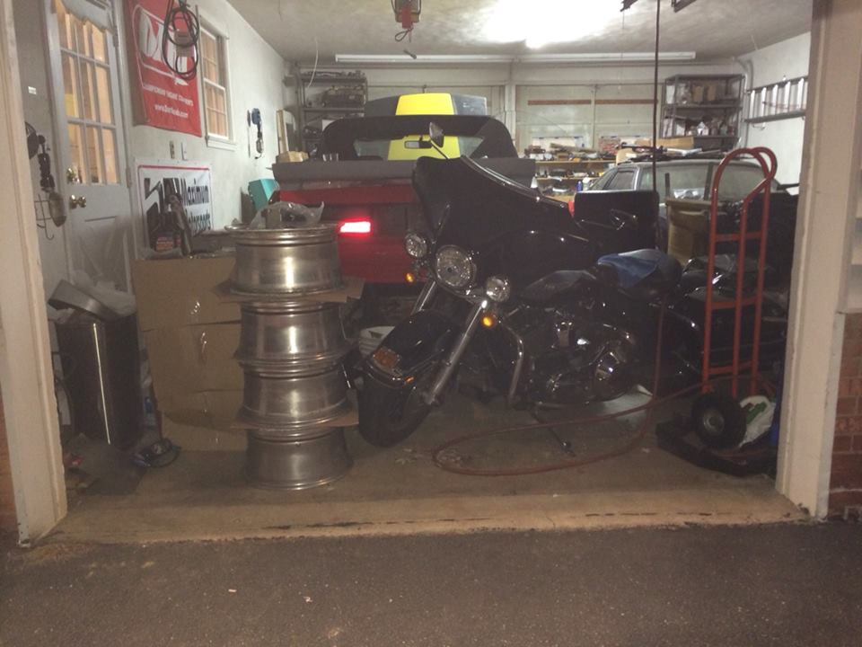

      Wheels are at the wheel shop getting painted and assembled.
      Jun 2013
      99
      Country Flag: Greece
      First update in a while. Wheel centers, lips, barrels, hardware, center caps and 90 degree valves are at a local wheel restoration shop. Having the
      centers media blasted and painted. They are going to do the assembly as well.
      I managed to get the blower intake tube/TB elbow closer to welding. In order to reduce the number of silicone tubes and hose clamps to 2 hoses and 4
      clamps.
      I have reached an area that requires certain silicone reducers that are not made, namely 30 degree 3.5" to 3" silicone reducers. The intake tubes to
      the TB are 3.5".
      At the same time I have an interesting debate, while I wait for a silicone reducer to show from CXracing. As you can see from the pictures, from above,the blower and intake 180 degree tube have a 30 degree angle. If you look from the front, the blower and the 180 degree intake tube also have a 30
      degree angle. In a nutshell, the silicone reducer is a single plain 45 degree silicone tube. The angles invovled are in two plains, vertical and
      horizontal.
      This is where I wish I would have studied more in College, in my Statics and Dynamics class. Would the corresponding angle be 30 or 45 degrees?
      Here is the kicker, only 45 degree reducer silicone tubes are available to go from 3.5" to 3". Now plan B is, a 30 degree 3.5" silicone tube with
      a 3" section clamped underneath the 3.5" tube to the 3" YSI discharge tube.

      Waiting for the welder to weld and smooth the 180 and elbow together. Twin methanol injectiors will go in next. Working on fabricating the blower
      intake tube as well.

      Elbow welded, methanol injection locations revised, not pictured. Methanol nozzle locations and Vortech Race bypass valve welded/flange/bung locations are next.
      This will complete the blower to throttle body section. 4" tube stock for the blower intake is on its way, still need to buy K & N filter and fabricate cold air mounting area. Once the intake pipe is finished, the motor will be that much closer for install.
