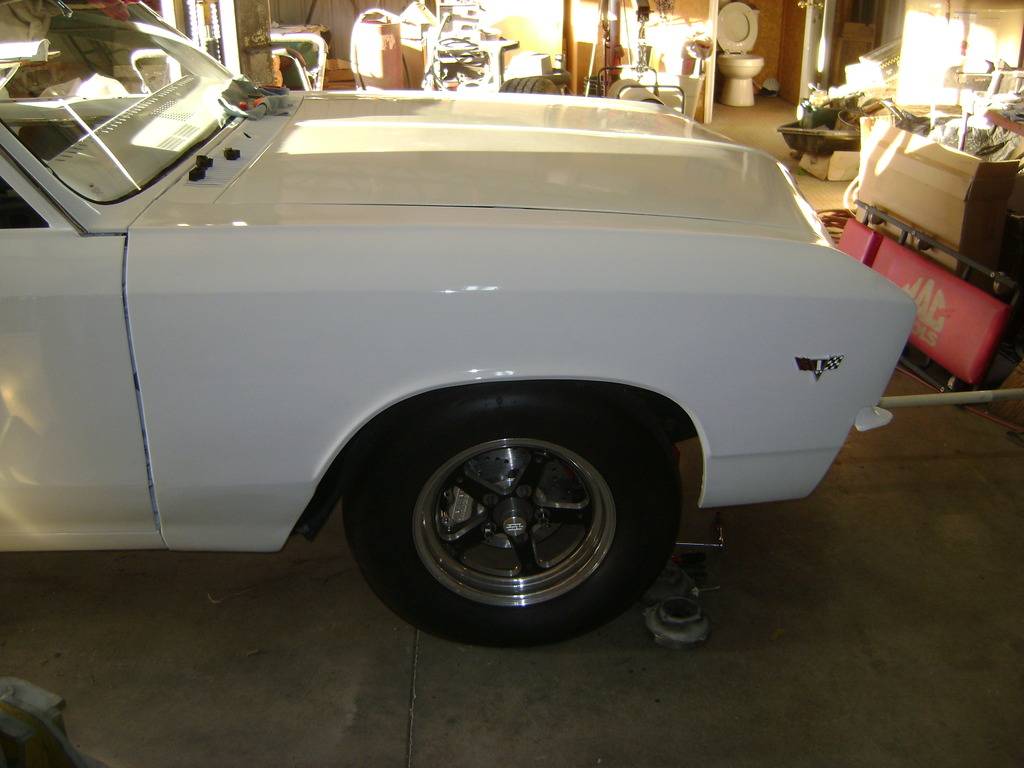

      Thanks guys - Don't know if I mentioned it earlier, but the rear-end was off center of the body by a 1/4" to 1/2". I was able to shift the rear into place evening up the gap in the wheel house's by loosening the body mounts.

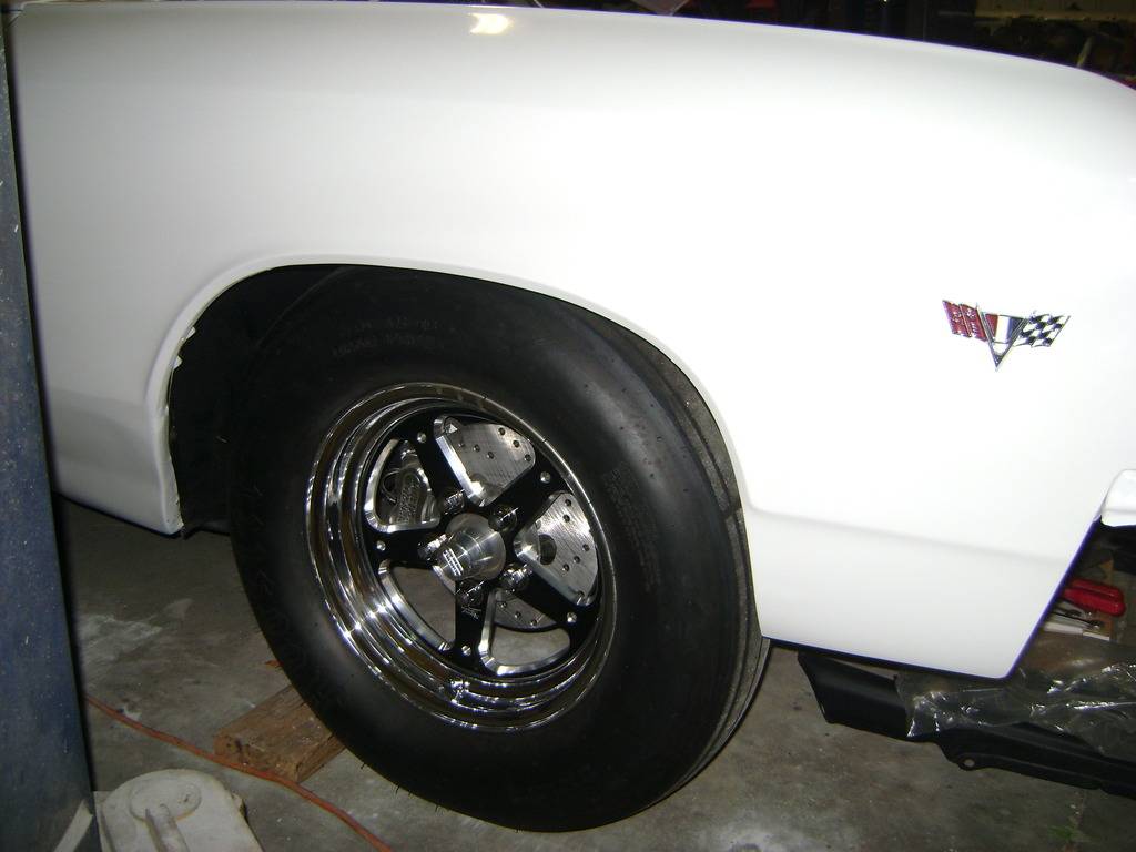

      Peets - You will be in the sweet spot with 255 or 275 tires on the rear if you can source a 6" BS wheel...my 255's will be close on the outside lips with my 5.75" BS wheels. I'm speaking only for the '67...other years I can't swear to.

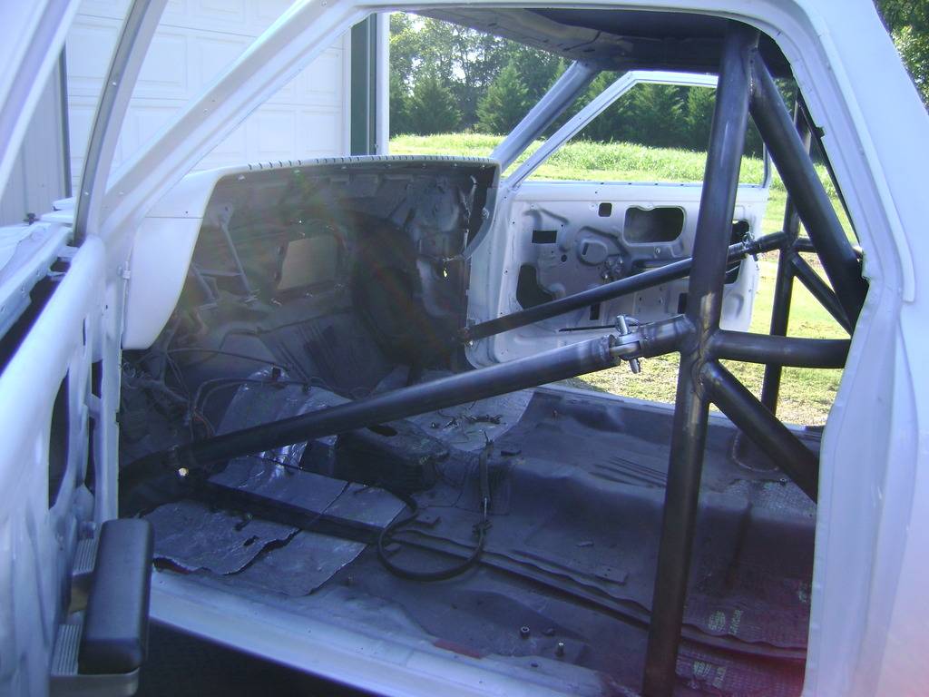

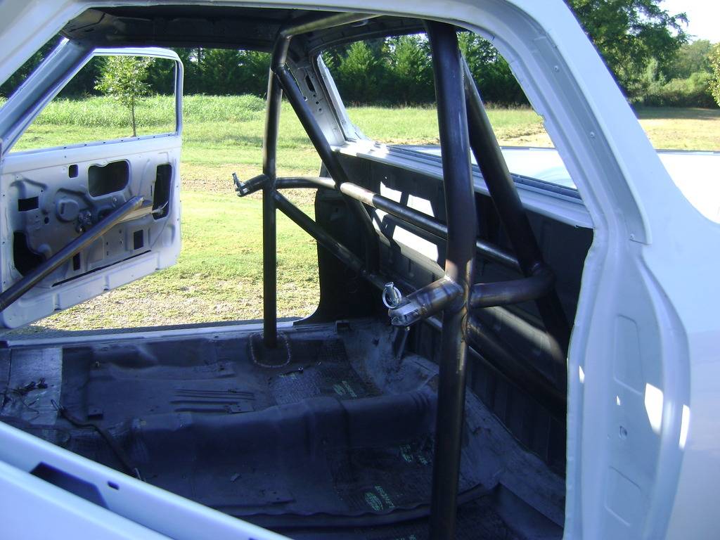

      Street plans on hold for a bit...this one is going NHRA Stock Eliminator racing first. Street items previously installed are being removed and suitable track replacements taking their place. CM roll bar install is imminent...

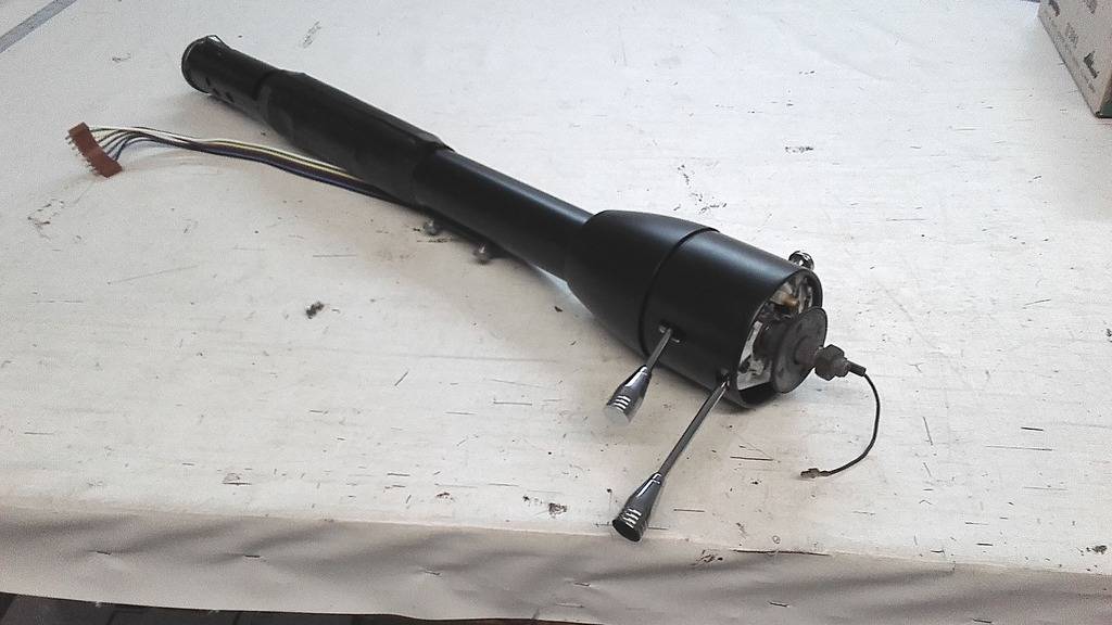

    3. #83
      Sep 2015
      Rockvale TN
      402
    4. #84
      Sep 2015
      Rockvale TN
      402

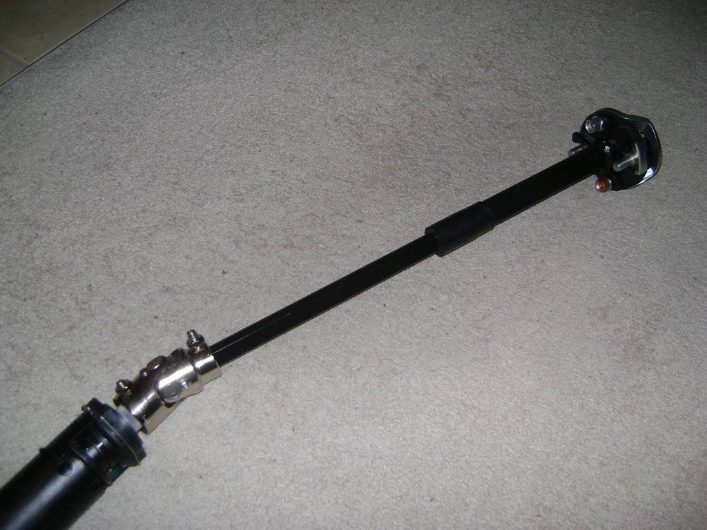

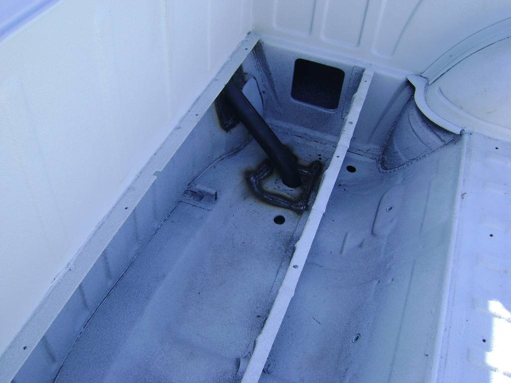

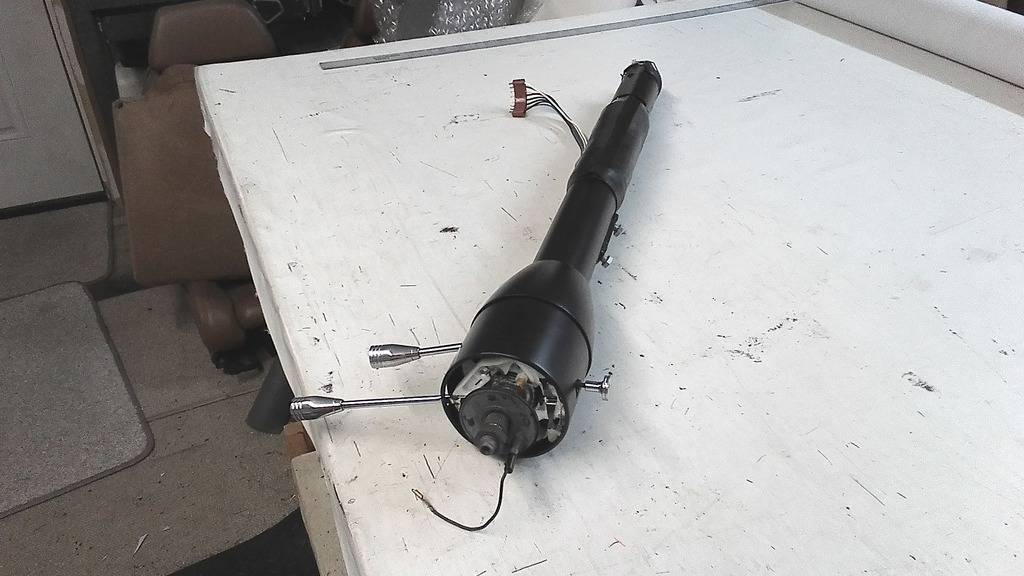

      Roll bar installation should be completed this weekend. Tilt steering column from Jim at BirdsandBowties will be a nice addition...

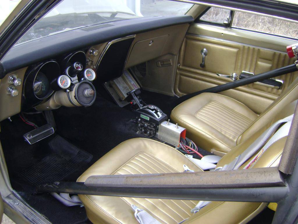

    5. #85
      Sep 2015
      Rockvale TN
      402

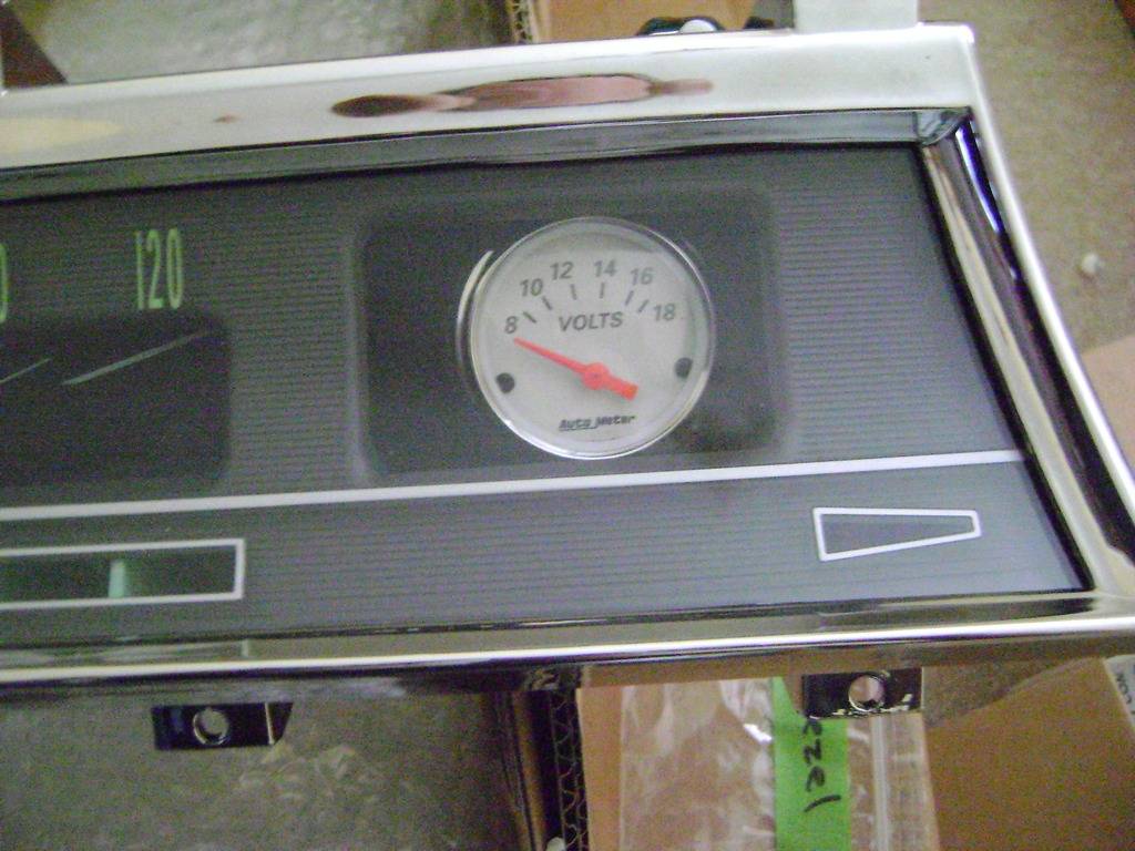

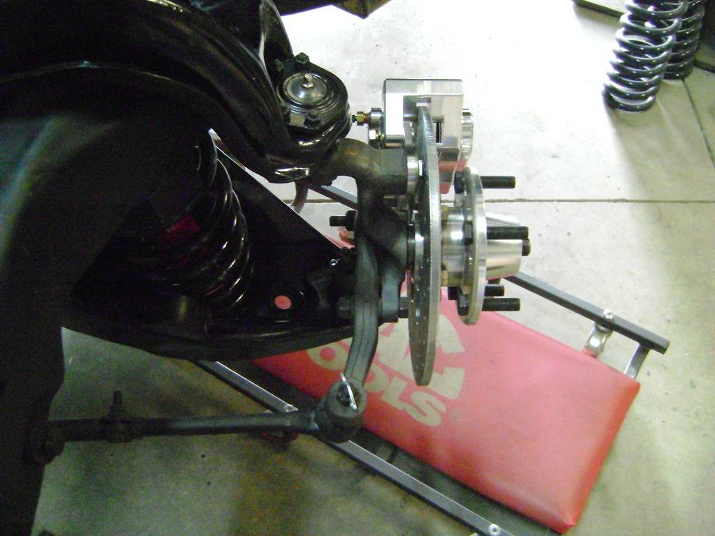

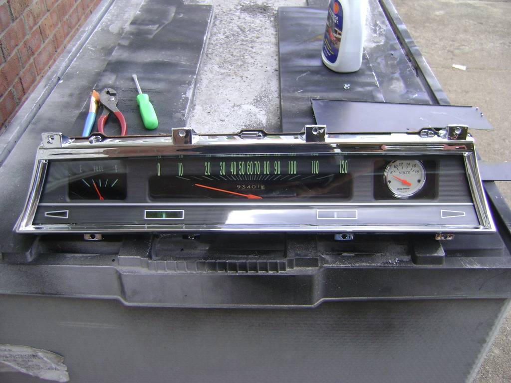

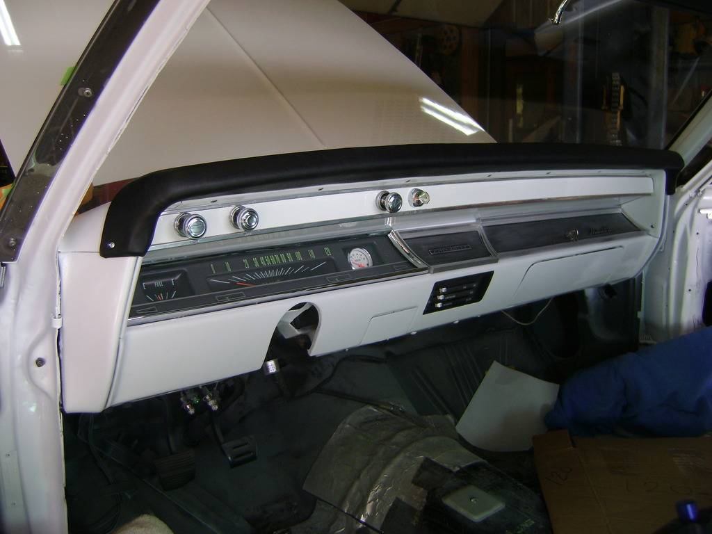

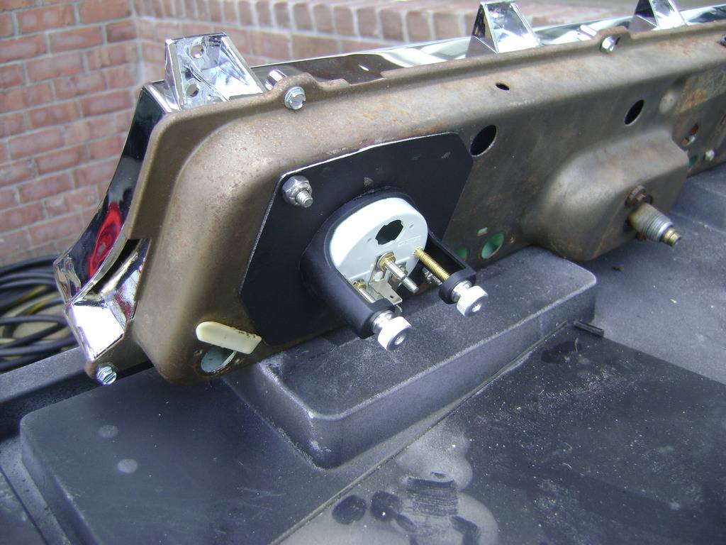

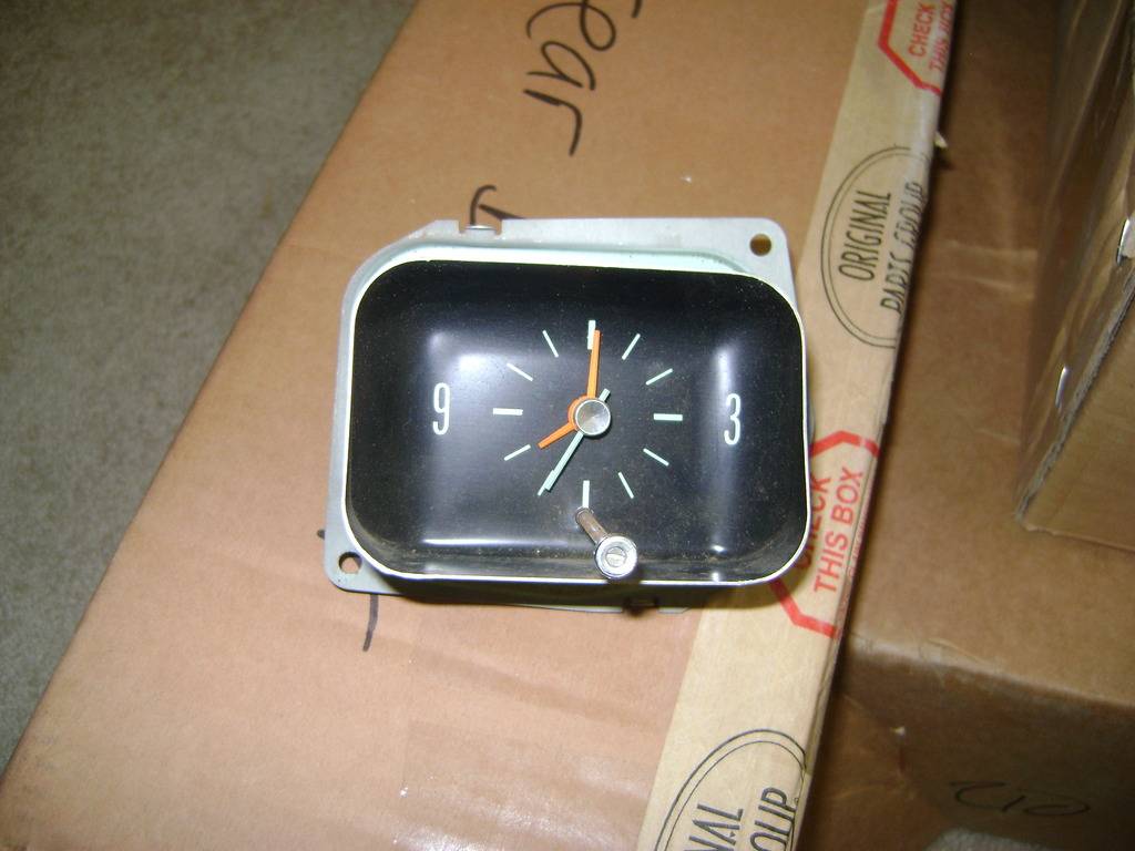

      I removed the electric clock in the dash cluster and replaced it with a voltmeter today.
      The mechanical water temp and oil pressure gauges will be going on the column as it is in the Camaro...

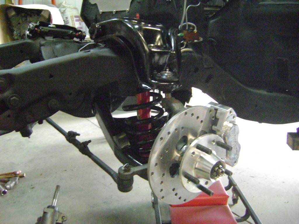

      why did you remove the ls1 brakes?
    7. #87
      Sep 2015
      Rockvale TN
      402
      Quote Originally Posted by camarodude87 View Post
      Too large and too heavy...the Aerospace units weigh next to nothing even tho they are 4-piston.

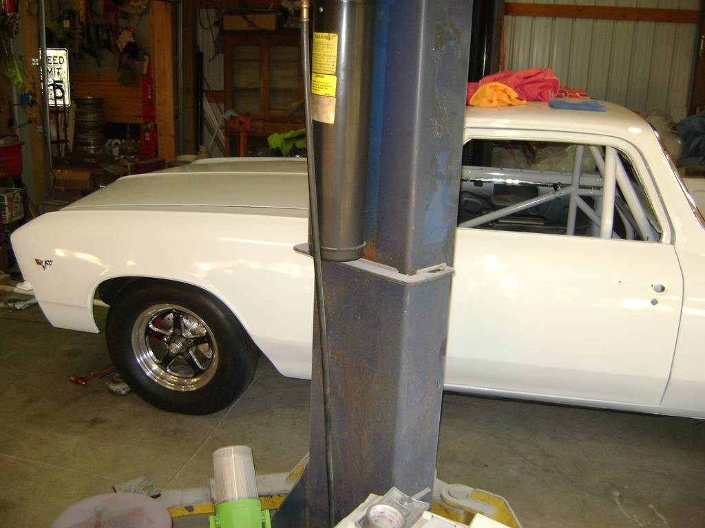

    8. #88
      Sep 2015
      Rockvale TN
      402
    9. #89
      Sep 2015
      Rockvale TN
      402

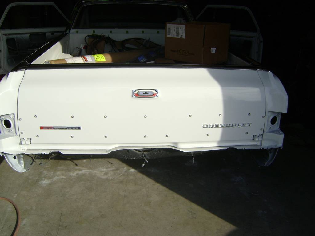

    11. #91
      Sep 2015
      Rockvale TN
      402

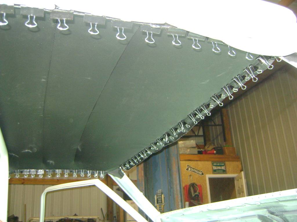

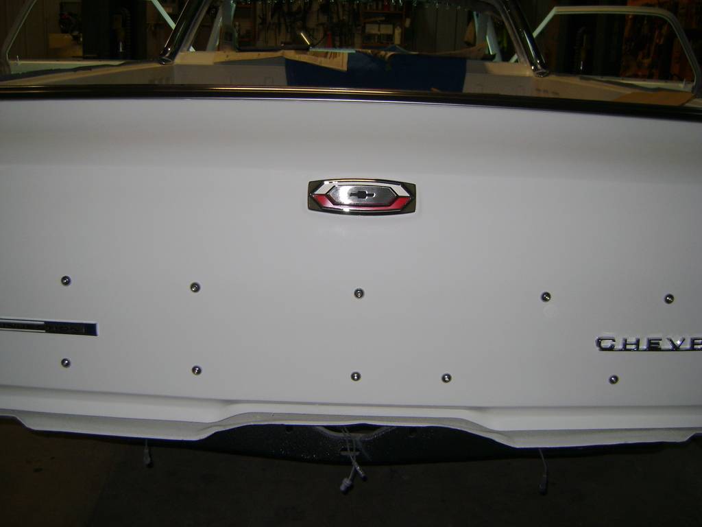

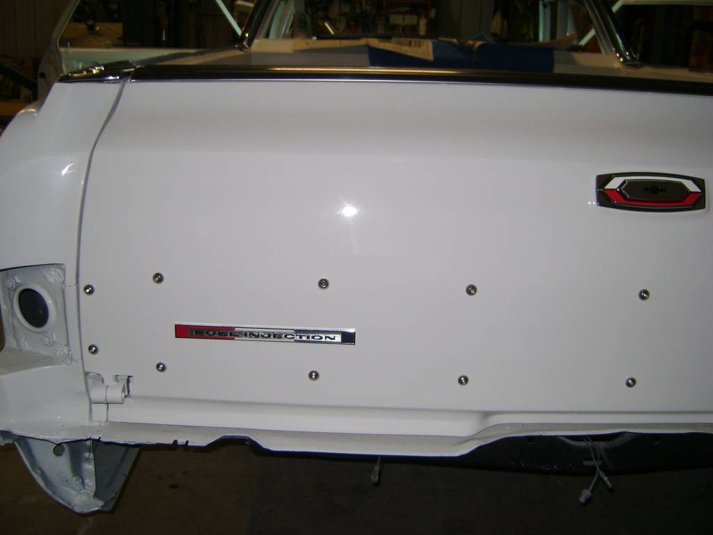

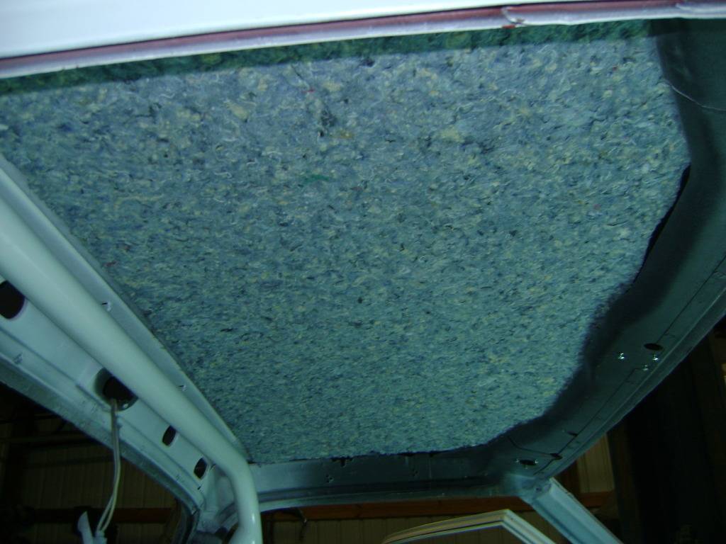

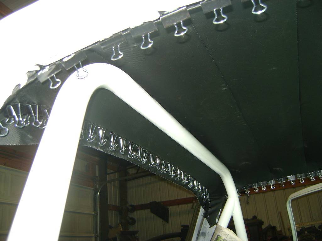

      Self inflicted headliner install and filled the tailgate trim holes with stainless button head bolts w/nylon washers.
    12. #92
      Sep 2015
      Rockvale TN
      402

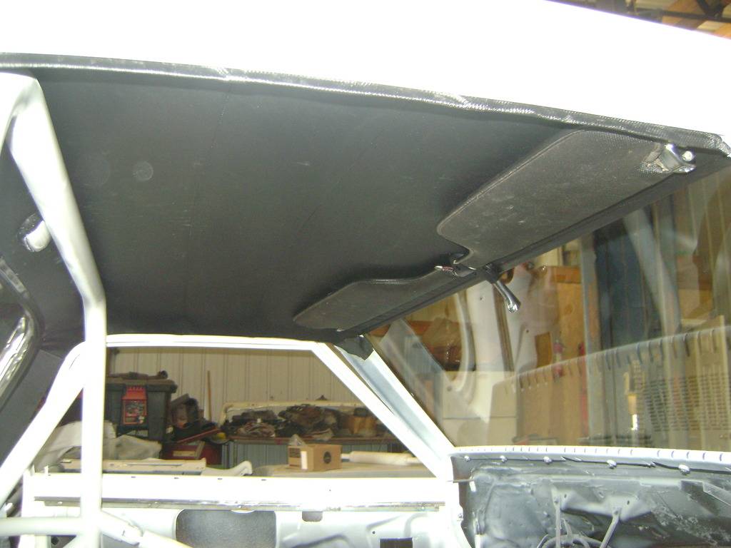

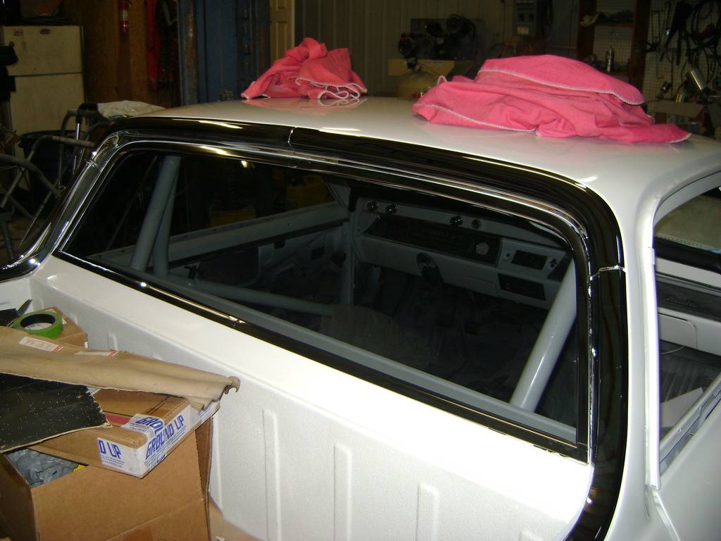

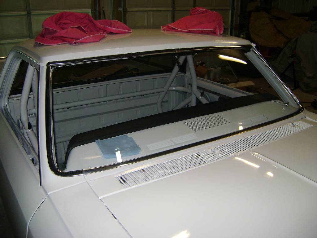

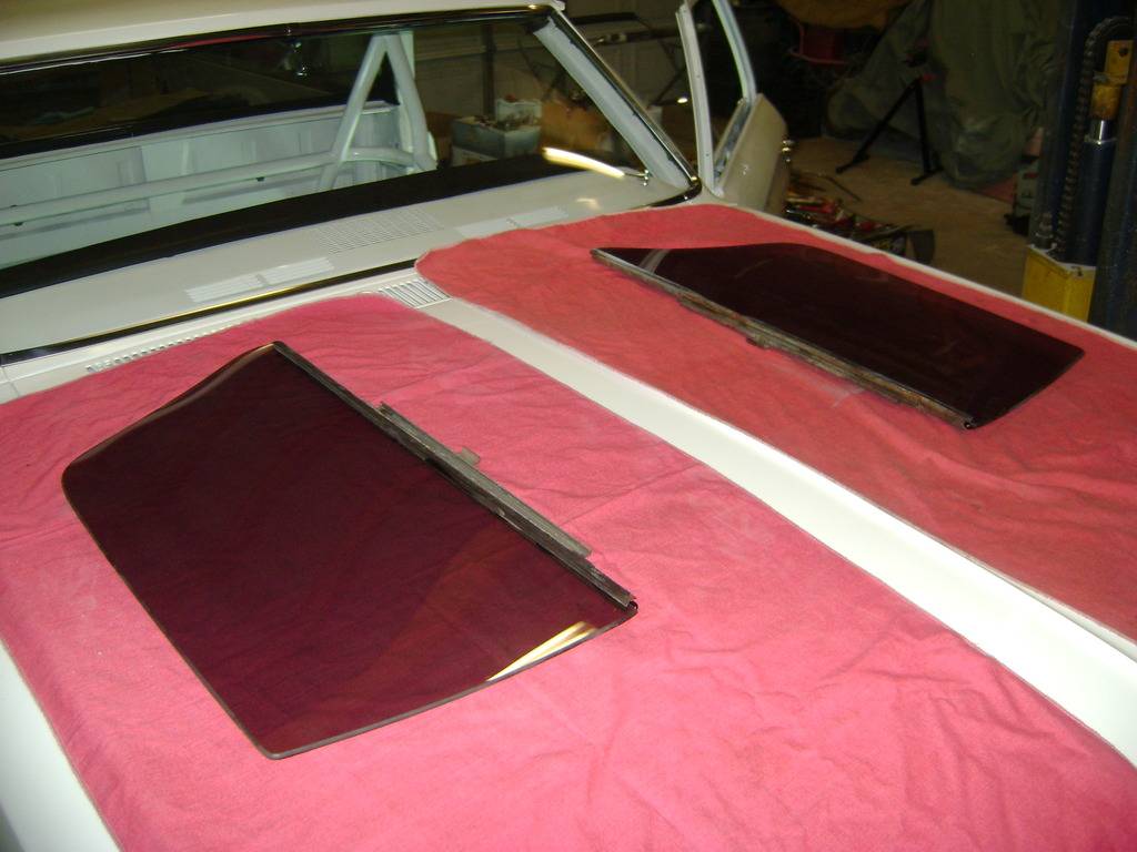

      Front/rear glass installed and headliner finished.

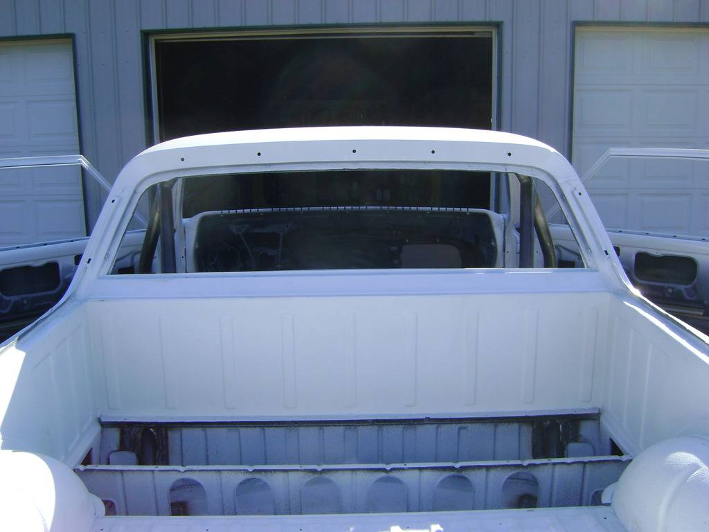

    13. #93
      Sep 2015
      Rockvale TN
      402

      Wow a lot of nice work sinse I checked in last time. Nice job on the roll bar.

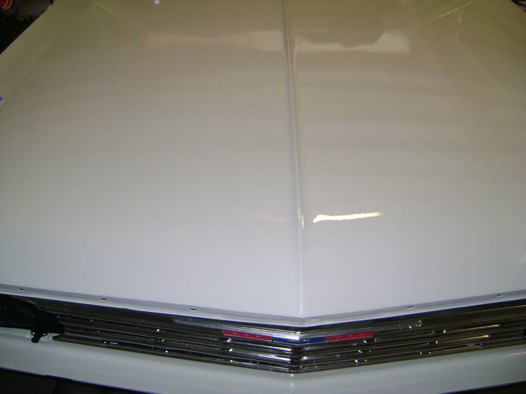

      Dadgummit...I had to go and try a little wet sanding this morning. It's such an improvement now I see I will have to do the entire vehicle...I'm tired already lol.

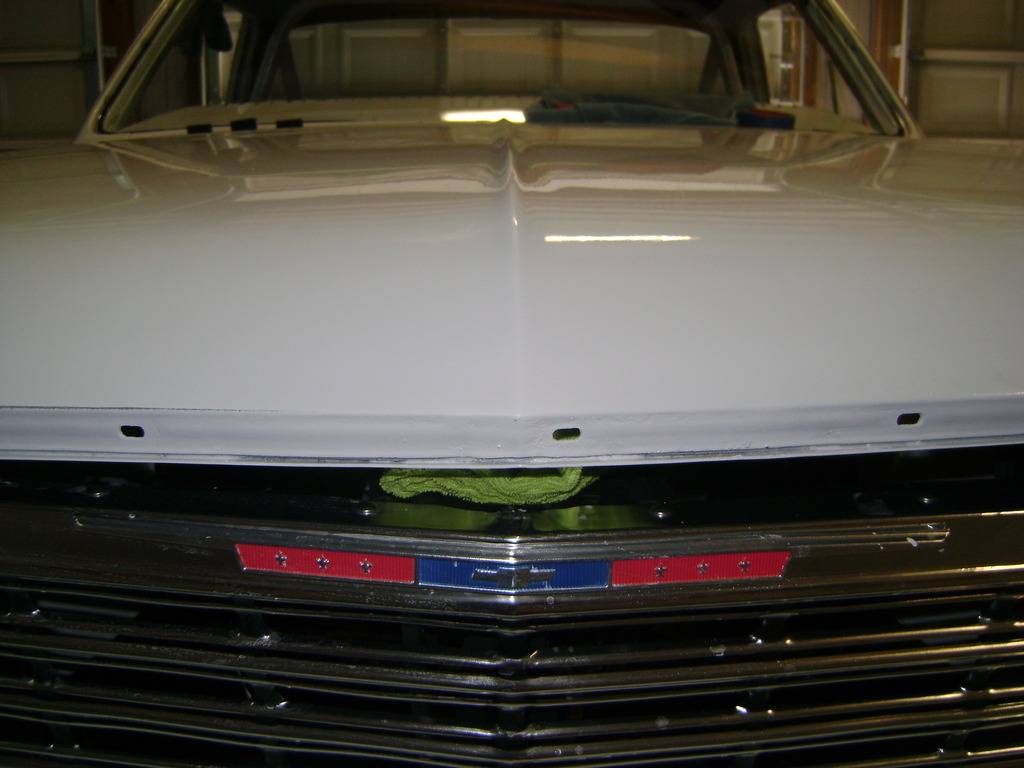

      Having difficulties with the reveal moulding...got a pro coming tm to check it out. Slowly adding parts...

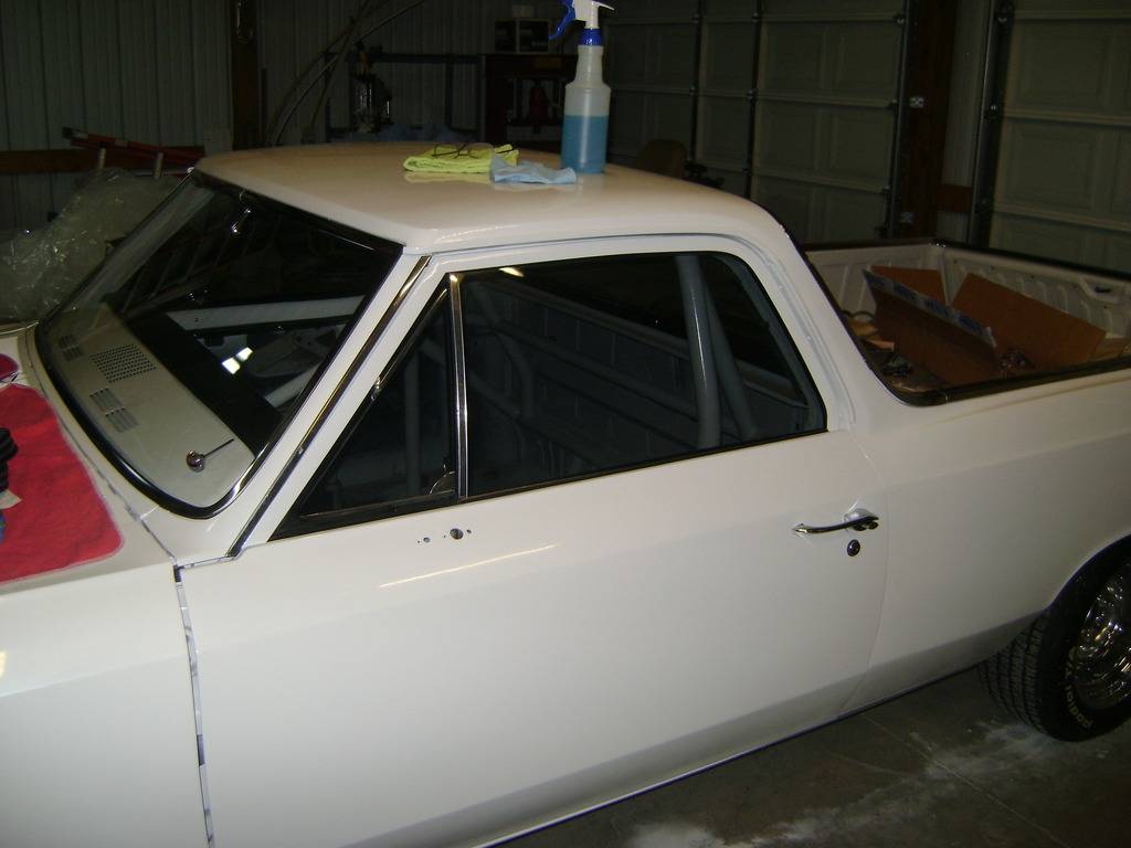

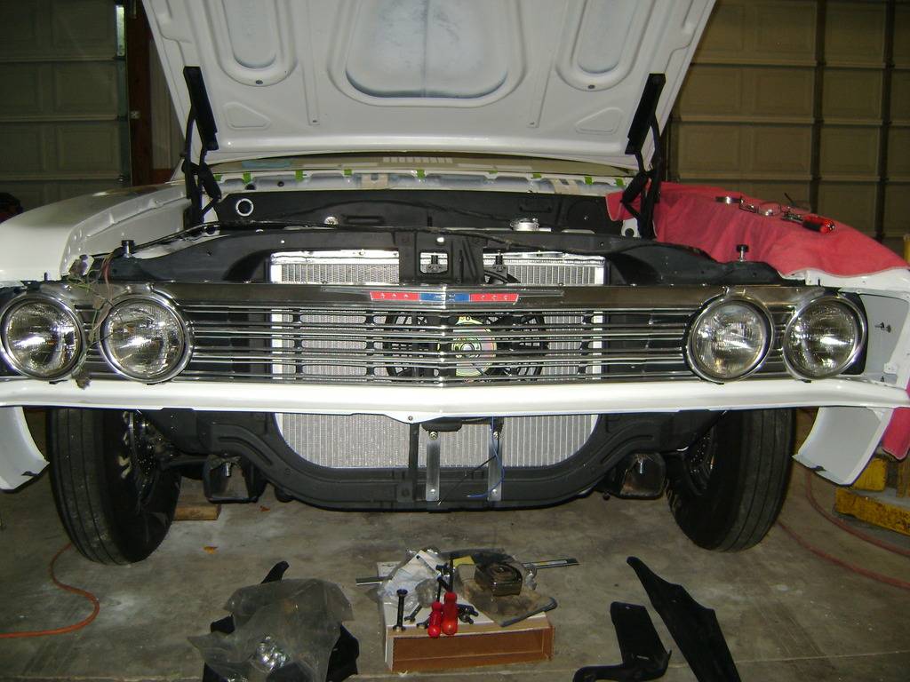

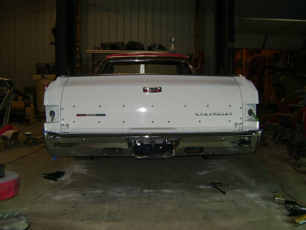

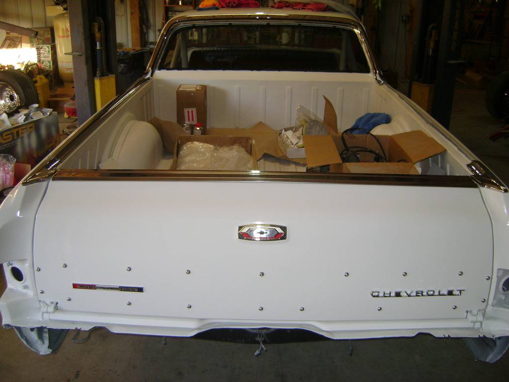

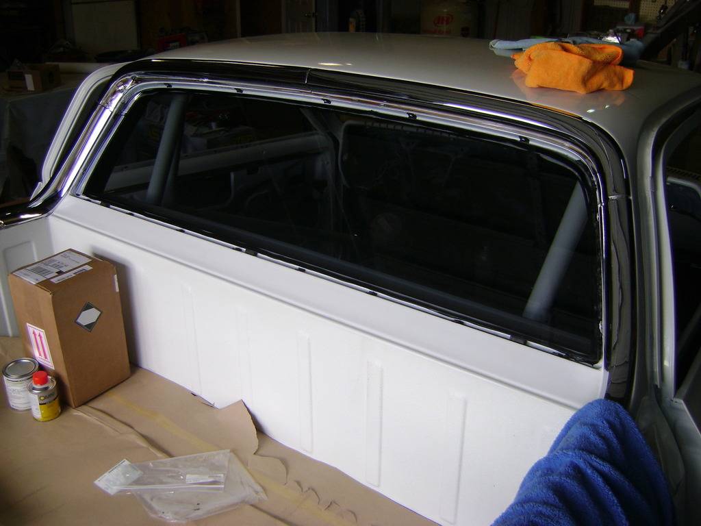

      All glass, trim and bumpers installed finally.

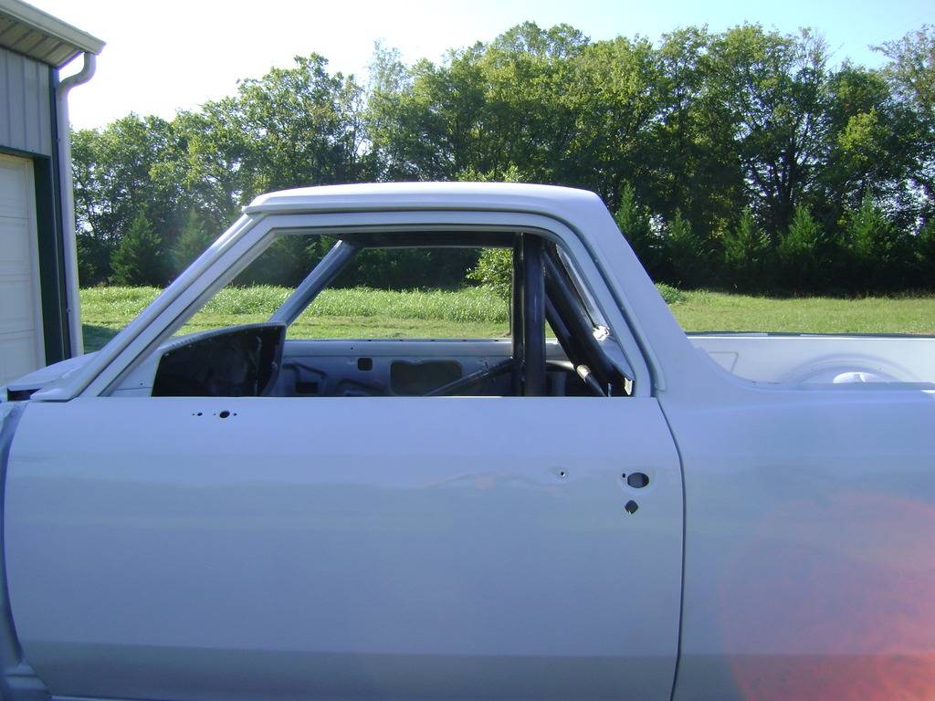

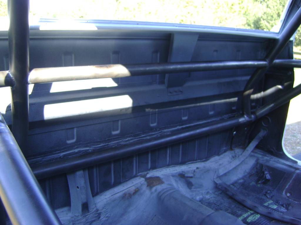

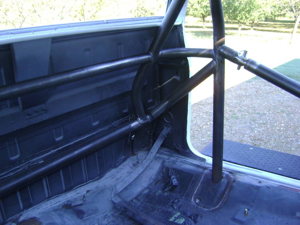

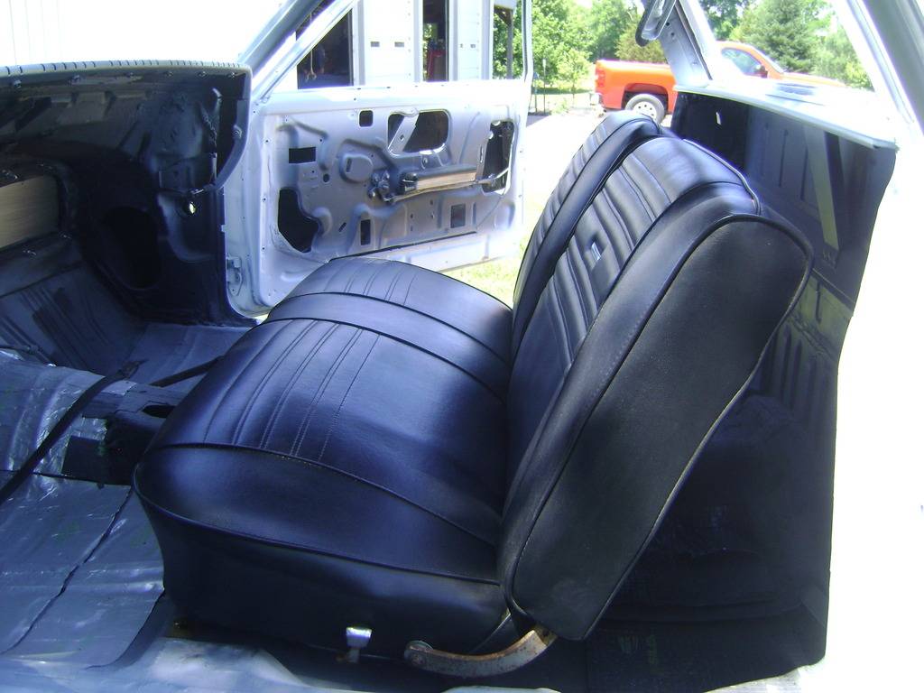

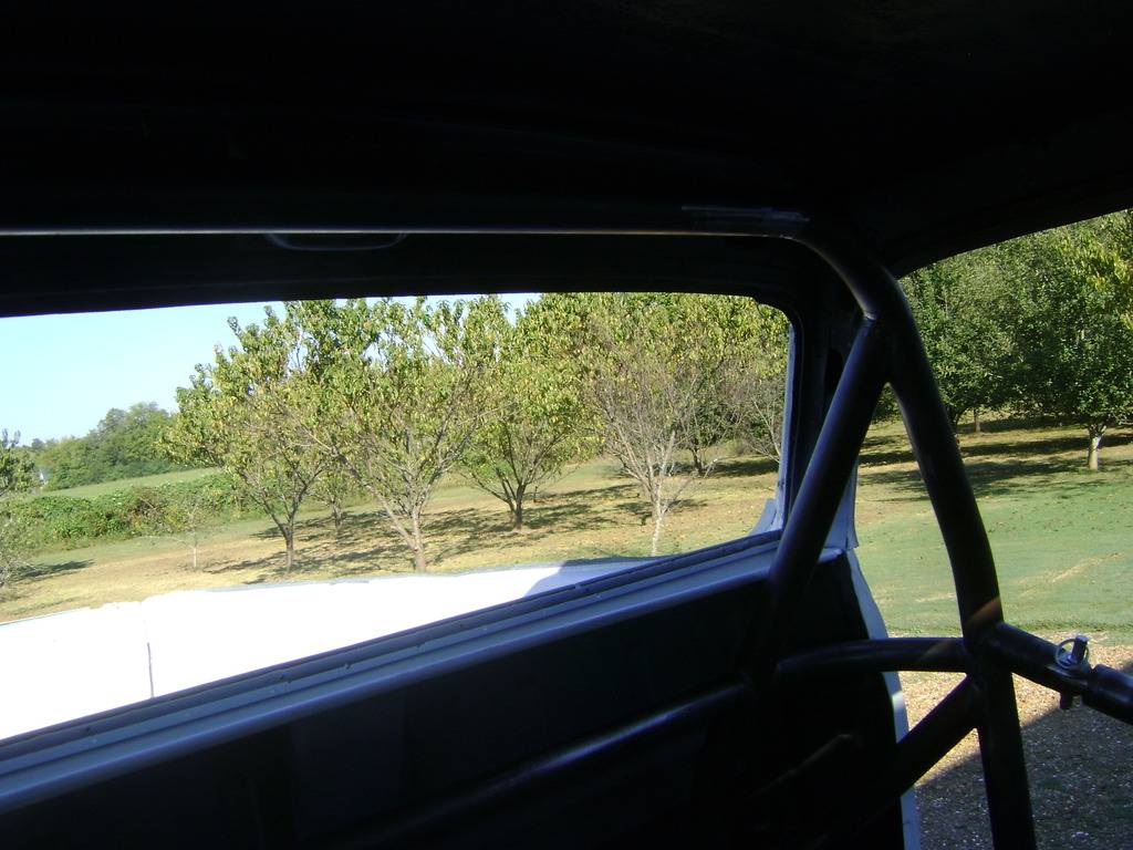

      Looking good! How much shoulder room do you have with you roll bar? Just curious, I have a 67 Elky and have pondered a bar, but never liked the rear downbar out the rear window look. Never thought to move the hoop forward because of shoulder clearance.

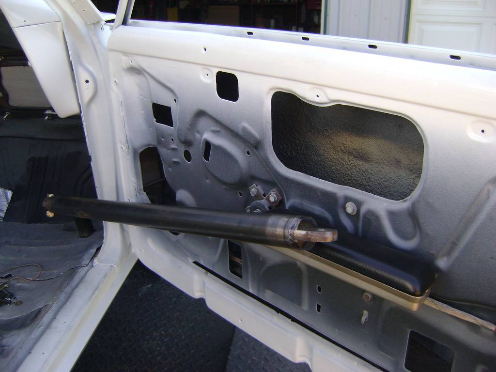

      Quote Originally Posted by bmbrzmn101 View Post
      Chris

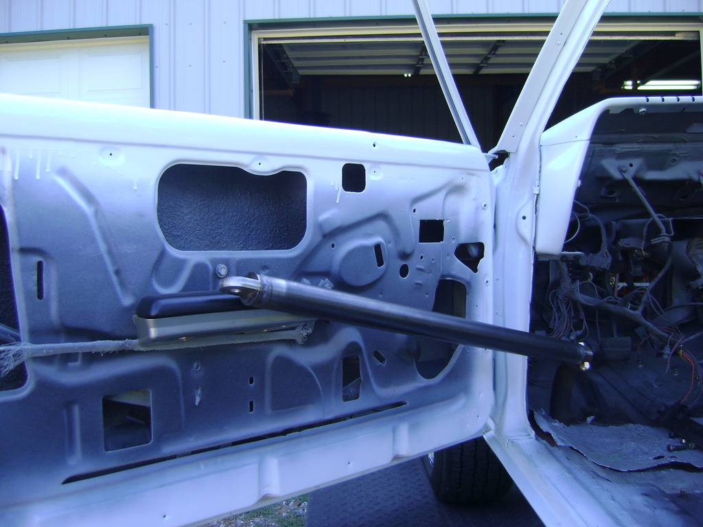

      I don't have an image on this pc Chris of the seat in after the roll bar install, but I'll post one next weekend for sure. There's at least an inch of clearance between the hoop sides and the sides of the bench seat. The swing-out door bar stubs will be killer if you arent used to them being there lol.
