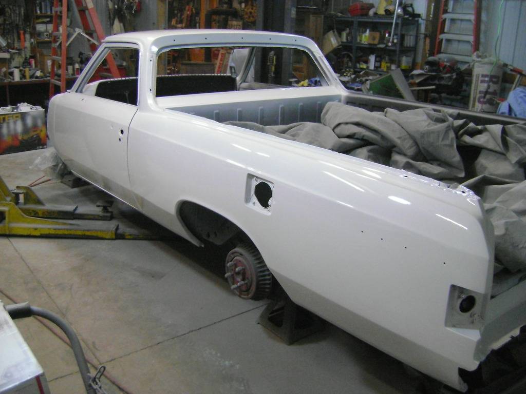

    1. #41
      Dec 2012
      Sugar Land , Texas
      55
      That was obviously the correct color choice. Keep on truckin'.

    3. #43
      Sep 2015

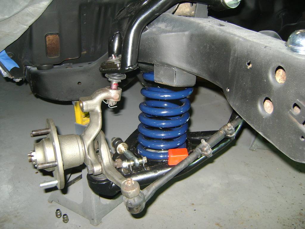

      ridetech progressive springs installed and working on LS1 brake upgrade.

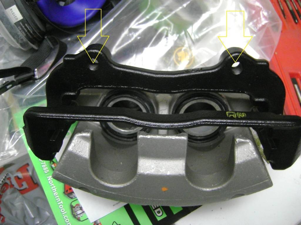

      Anyone here know what size bolts are used in the LS1 caliper brackets?
      Edit: Bolts are M12 - 1.75
    7. #47
      Jan 2014
      Seattle WA
      288
      LS1 brakes? Not sure why that ever became a thing. What are the brakes off of? What year?
      1967 El Camino 408ci LSx....and the build begins!
      1967 Turbocharged 408ci LSx Chevelle - 1012 rwhp, 959 rwtq 67 Chevelle
      2009 Supercharged Silverado - On the Dyno
    8. #48
      Sep 2015
      Rockvale TN
      402
      Quote Originally Posted by Bonehead View Post
      Calipers and rotors used on 1998-2002 Camaro. You can use the factory drum spindles and hubs along with factory disc brake lines using the appropriate banjo bolts. All that is needed is a simple 1/4" steel bracket that bolts to the spindle for the caliper mounting. Can't see a way to upgrade from drum brakes to 12" disc's any cheaper than this, can you?

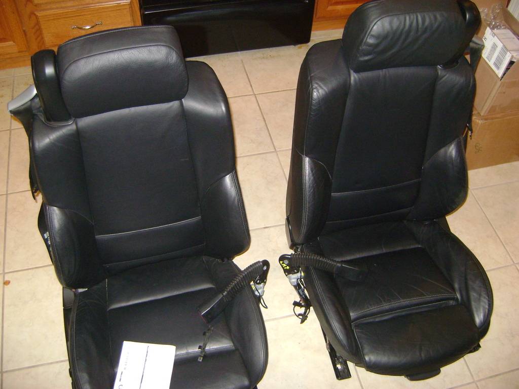

      No matter...just bought some black leather BMW full power convertible buckets. She's going to be killer in White.

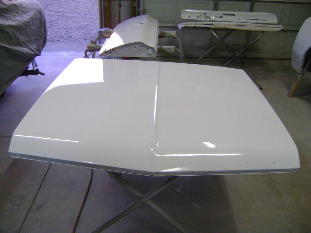

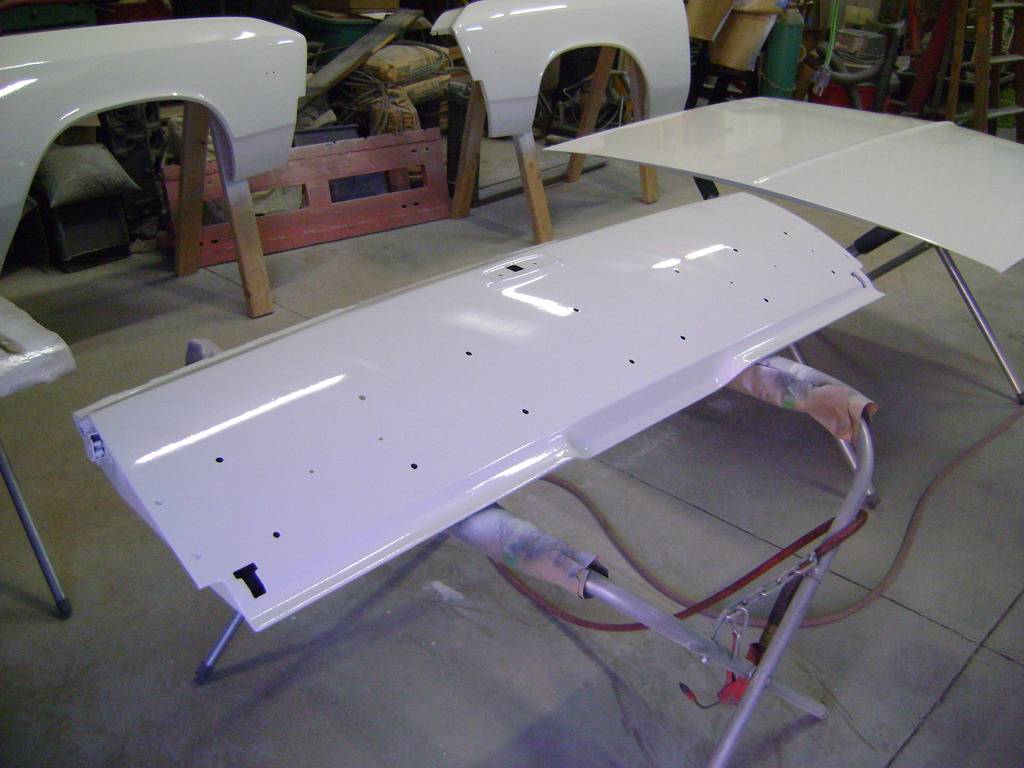

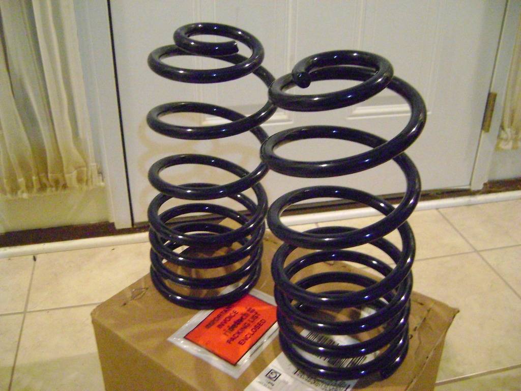

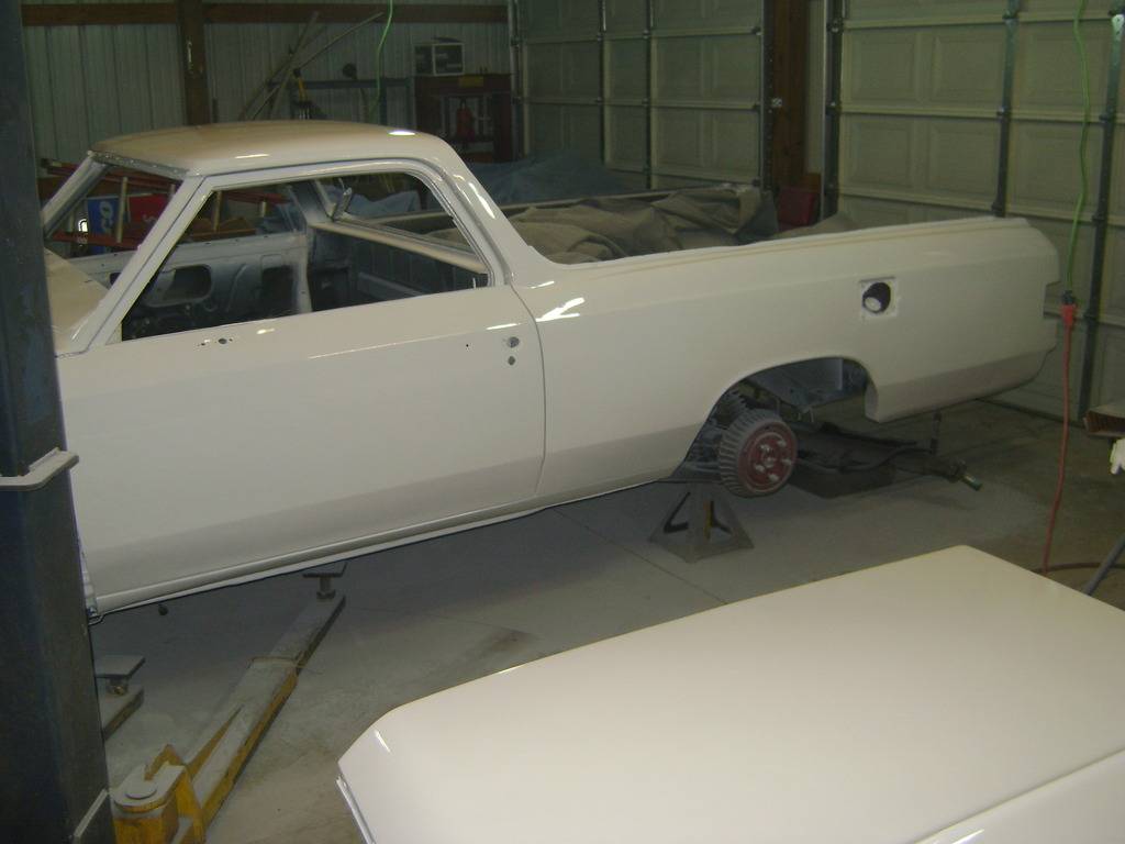

      Brakes finished...
      Matching rear ridetech springs arrived today.
      More painting today...going to try to wrap this up this weekend, weather permitting.

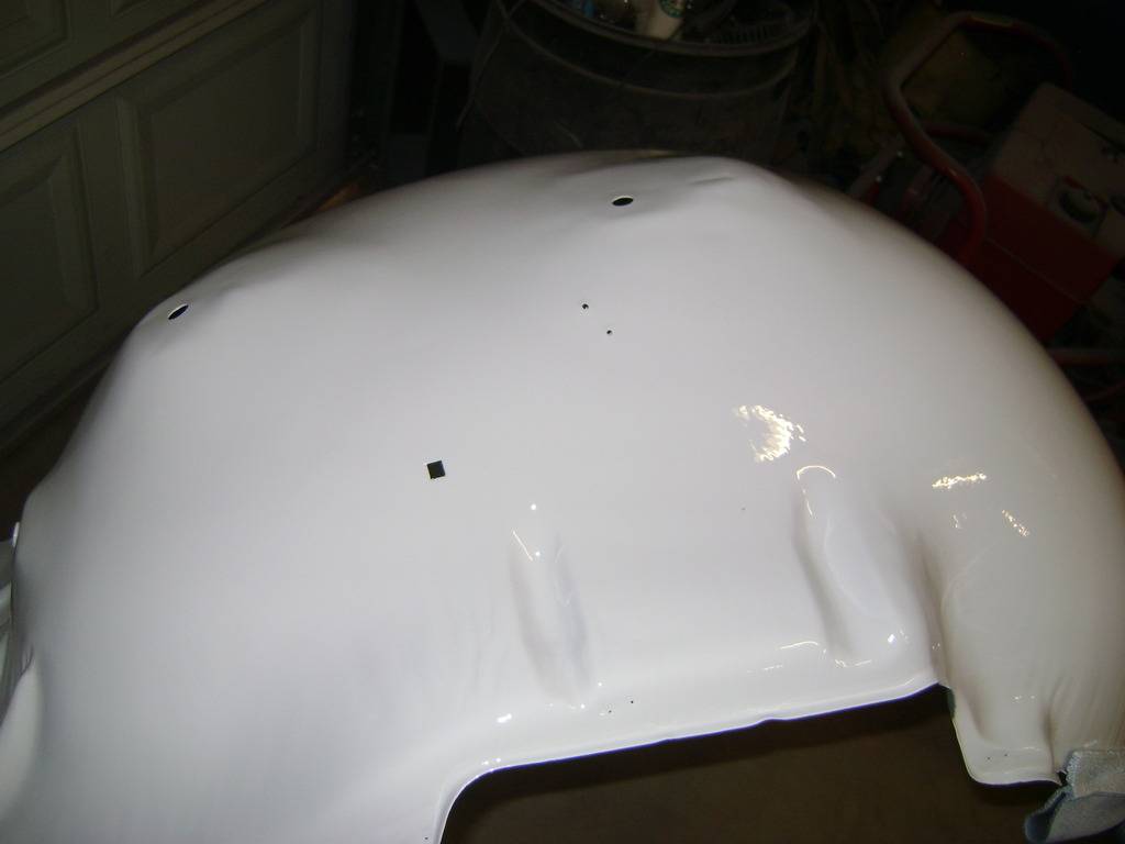

    15. #55
      Sep 2015
      Rockvale TN
      402

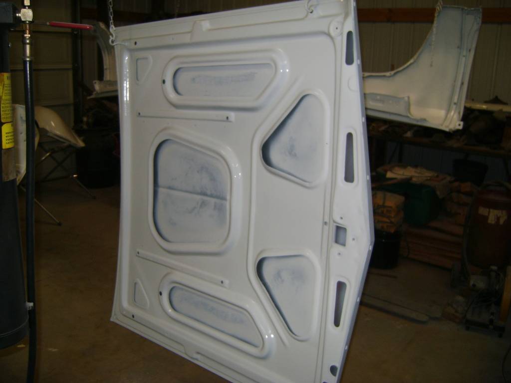

    16. #56
      Sep 2015
      Rockvale TN
      402

      Looking really good! I picked up some seats out of a wrecked low mileage bmw 4 series coupe for my next project. Really like the idea of integrated belts for cars without b pillars.

      Sep 2015
      Rockvale TN
      402

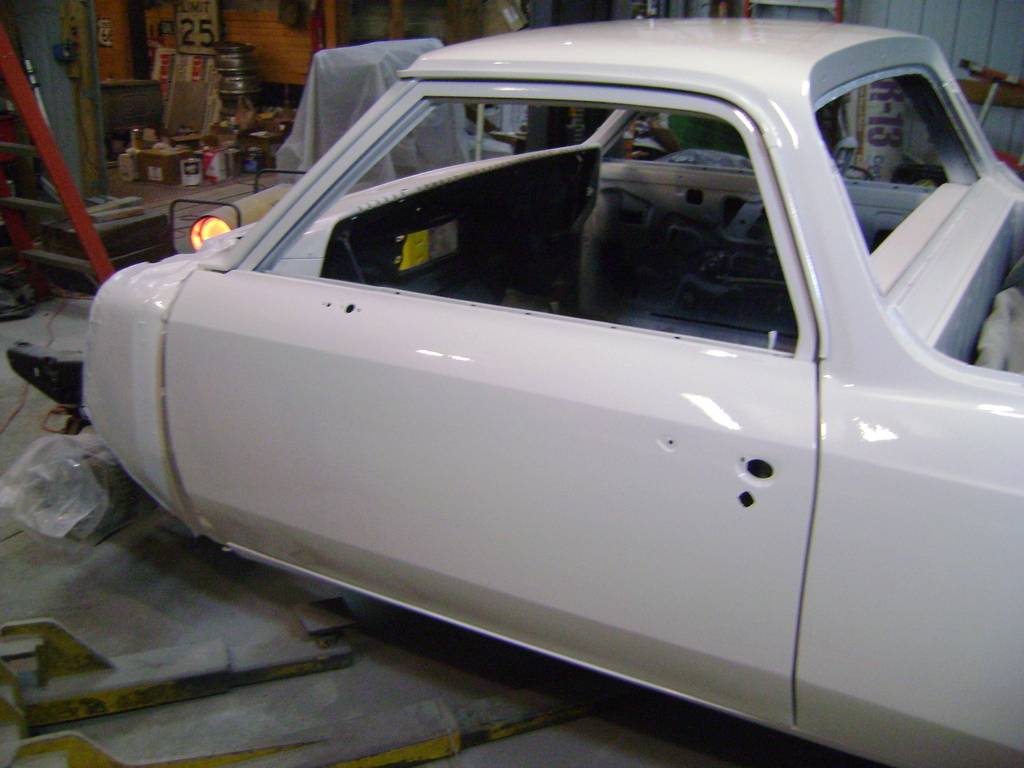

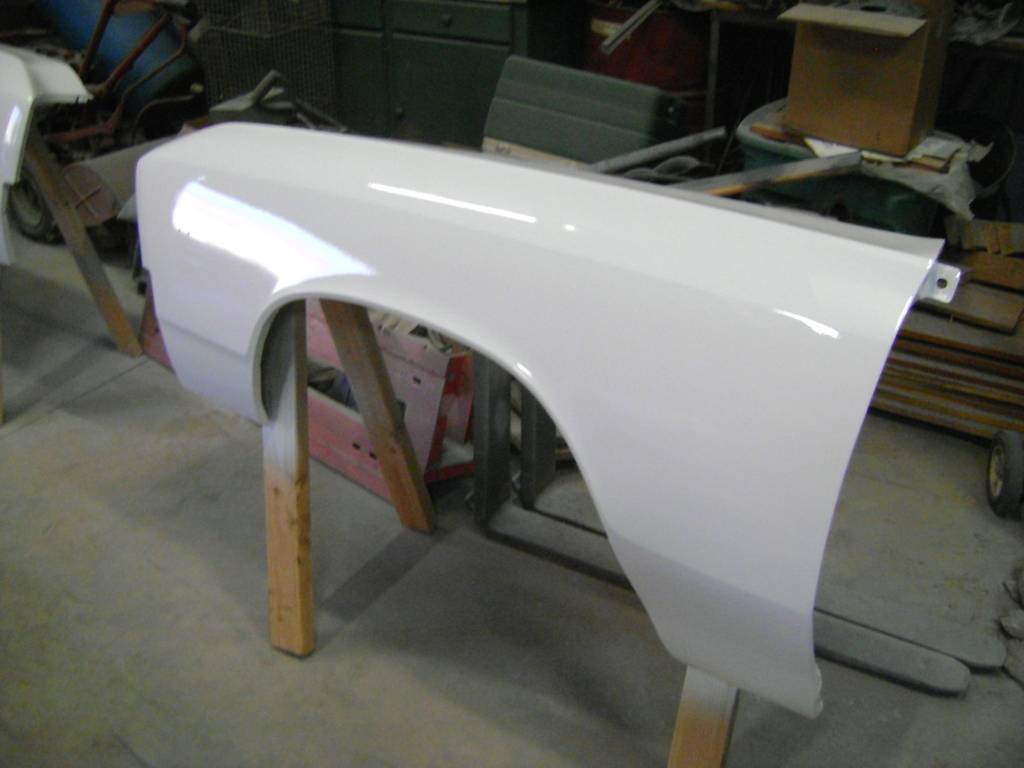

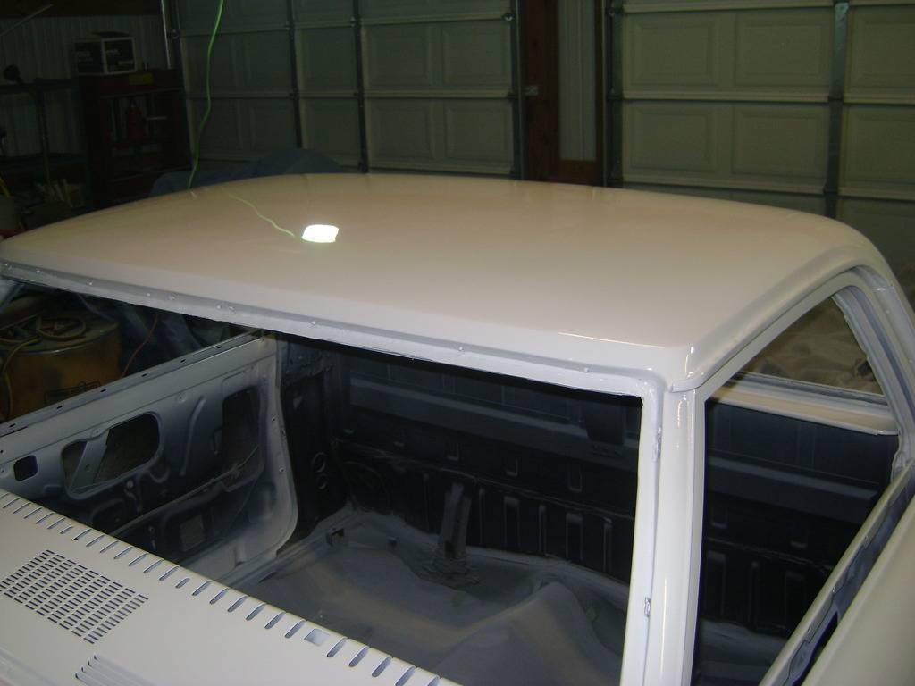

      Not sure I like this shade of white...may have to re-paint it again. I joke....

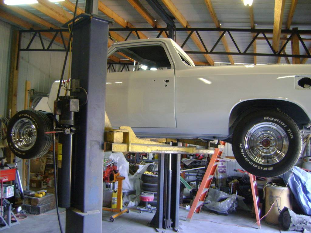

      Up in the air for some cleaning underneath...
