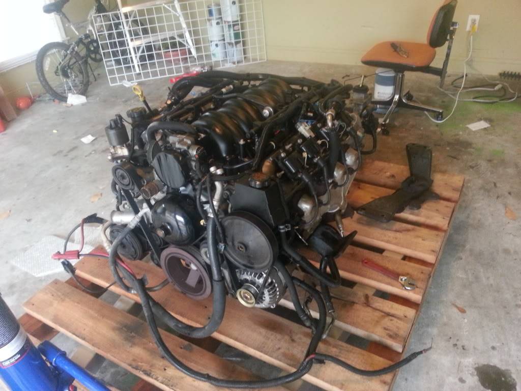

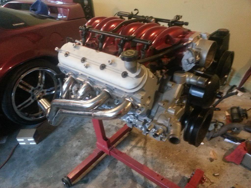

      I bought a LS1 with a T56 transmission. I rebuilt both completley with upgraded parts so that I knew what I had, and so that I can beat on it with no worries for many miles to come.
      -Over View
      -Rebuilt LS1, now with LS6 Heads, Huge Cam, New Valve Train, Longtube Headers. Roughly 470 HP to the wheels. Essentially an LS6 now.
      -Rebuilt T56
      -Rebuiilt Rear end with 4.10 Gears, Stronger Axles, Girdle.

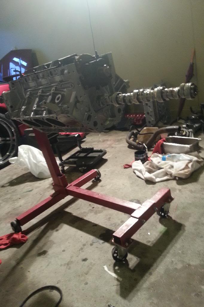

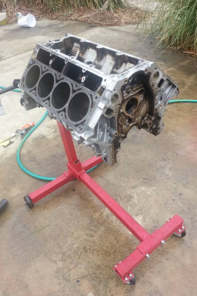

      Here is the motor compleltley torn down.
      Putting the new "Go Fast" stuff back in
      Assembled
      Refreshed Internals
      HUGE Cam
      Dual Valve Springs
      LS6 Heads
      High Flow Oil Pump
      ARP Bolts
      Tons More

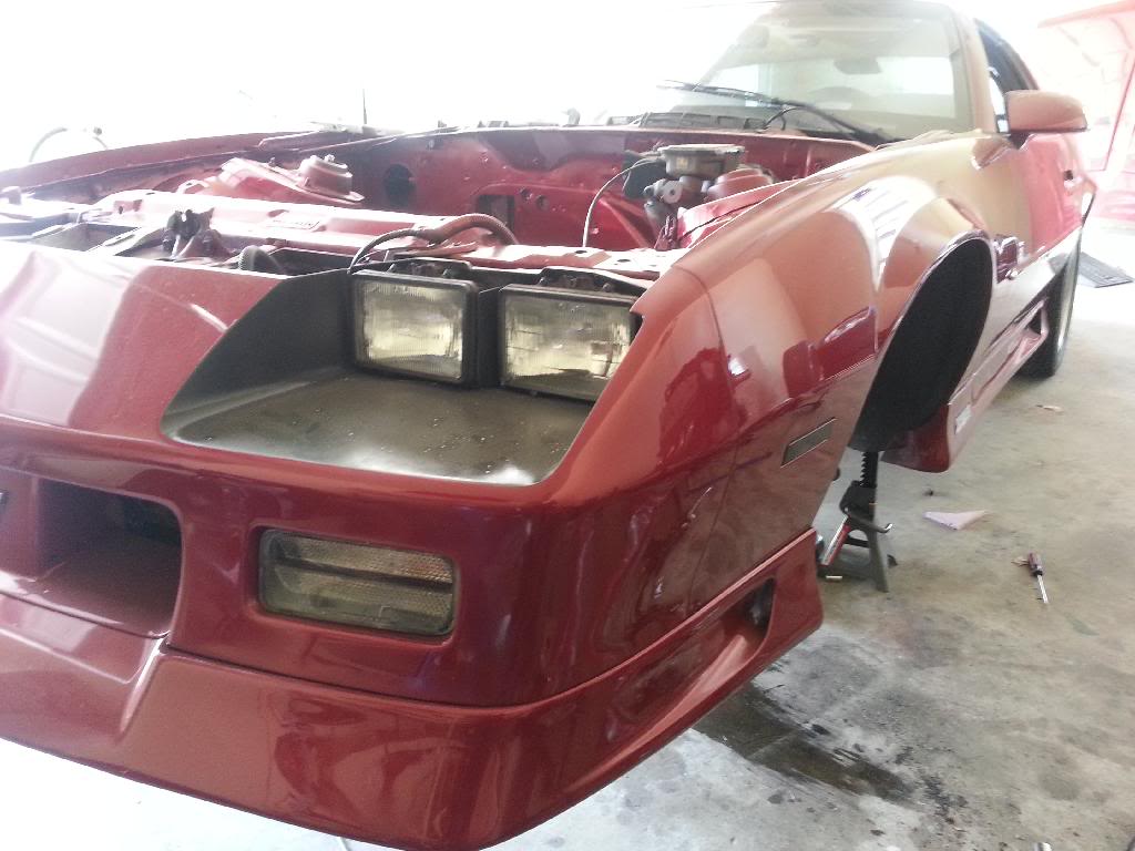

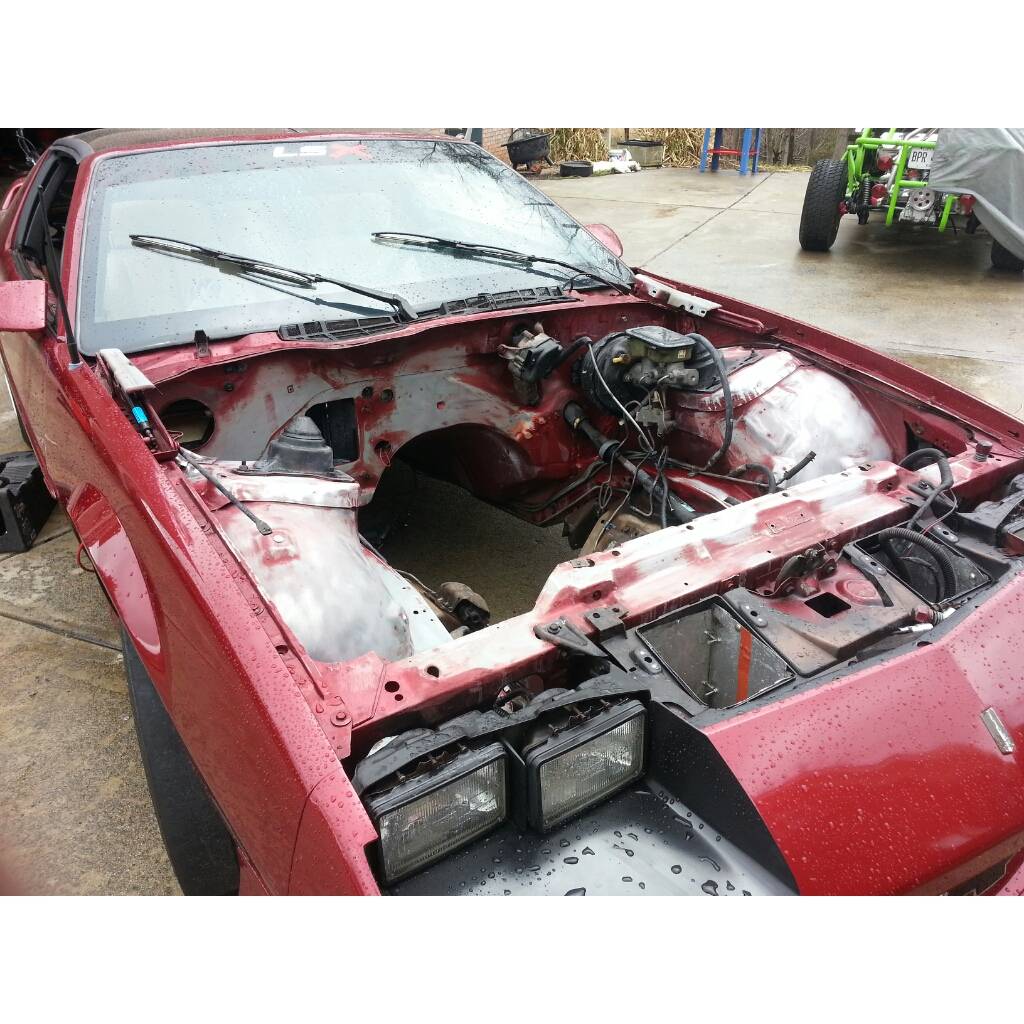

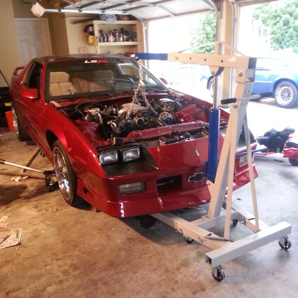

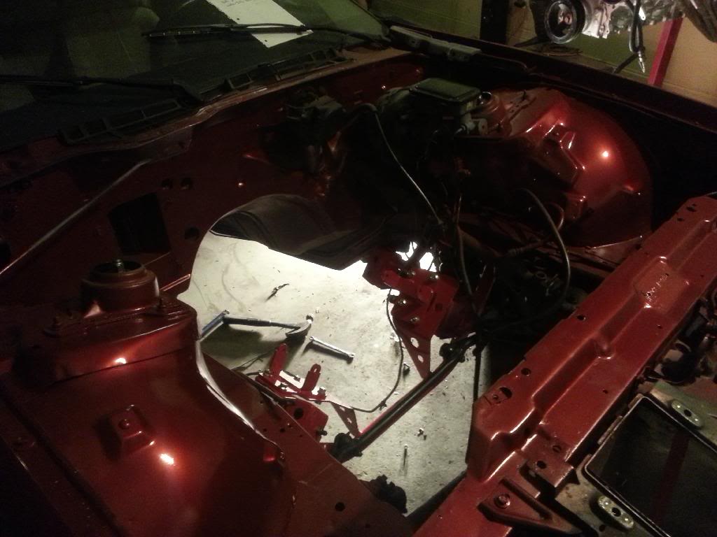

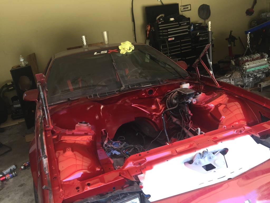

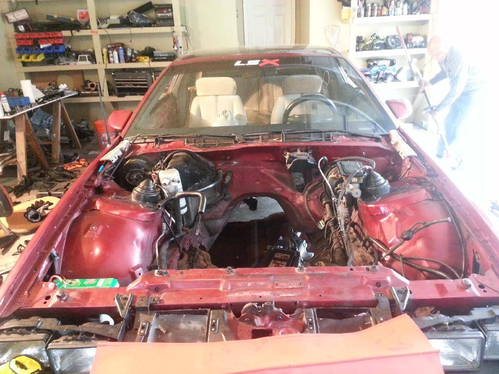

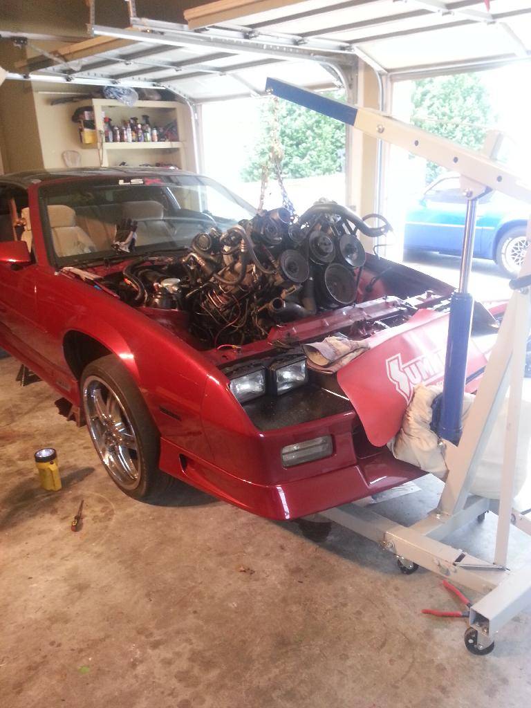

      Out With the Old, In With the New
      The lift was about 8" away from the nose, the pillow was there just for peace of mind.

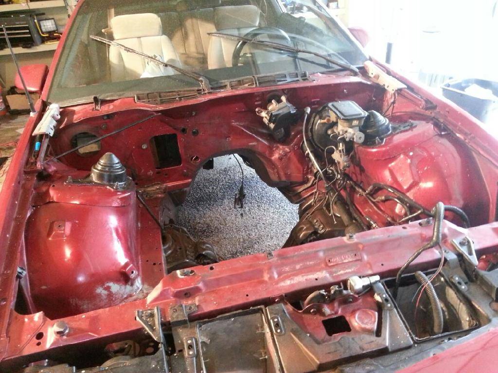

      Removed "clutter"

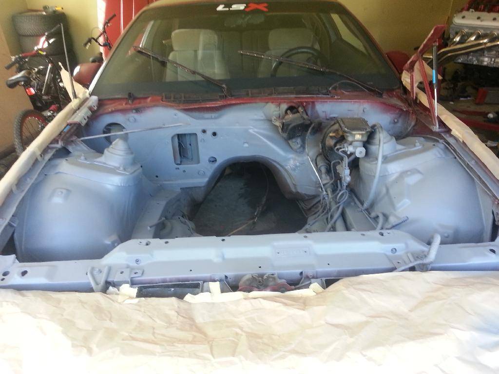

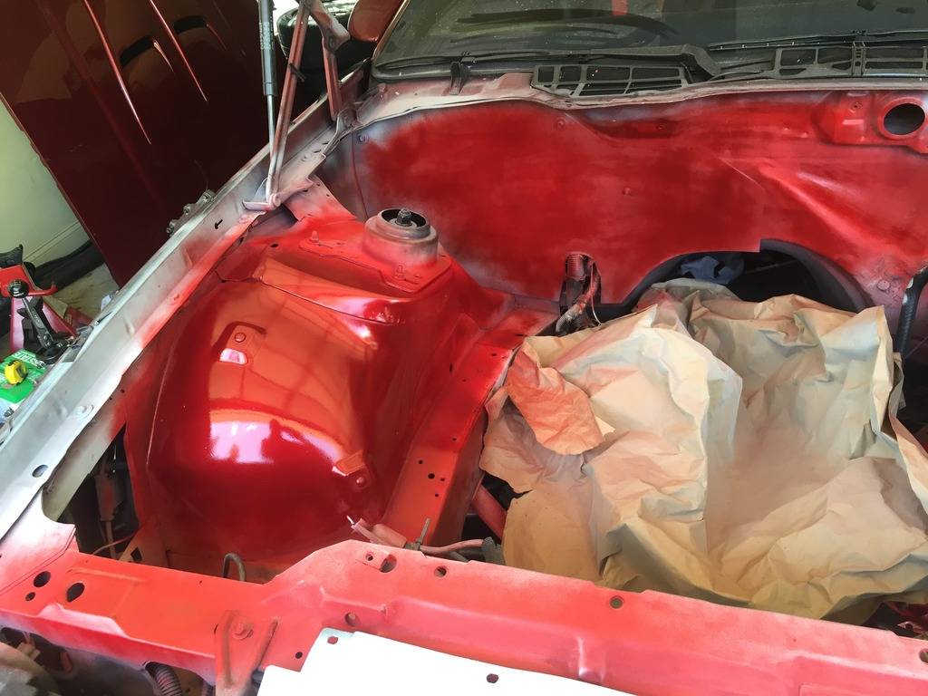

      After alot of sanding, grinding, deagreasing. Oh, and did I say sanding and degreasing?
      Etching Primer
      Next is a little sanding, then the top coat.

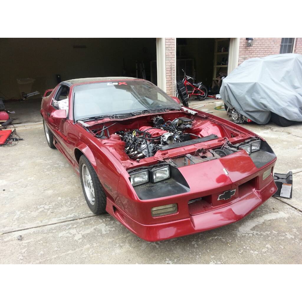

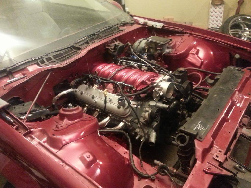

      Many, Many more hours later. It is in
      She sees light for the first time in about two months

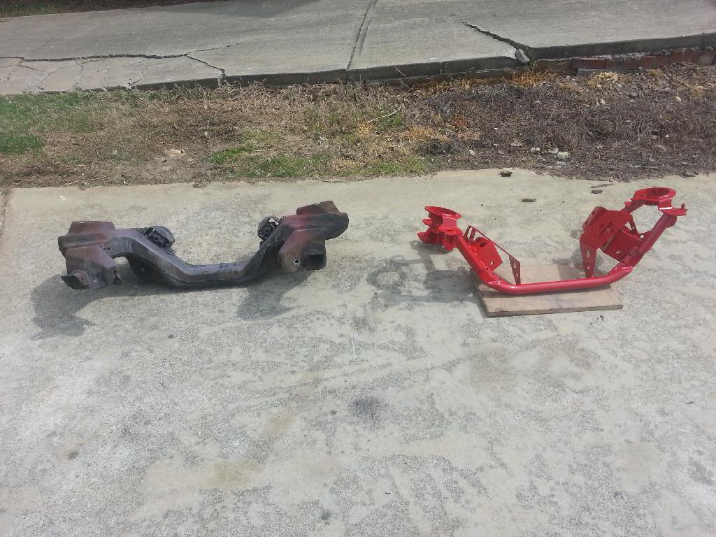

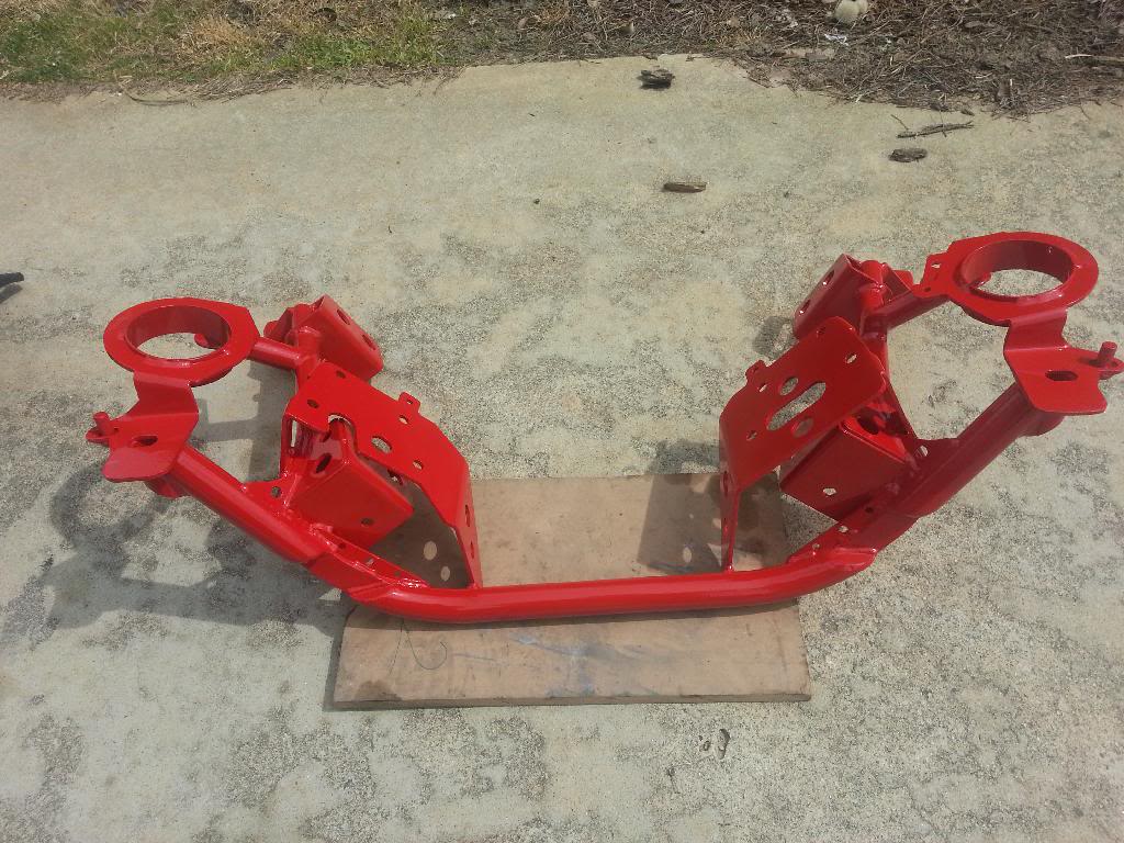

      I rebuilt the entire suspension. Then Installed a light weight tubular K member. Along with subframe connectors, custom lowering springs, new shocks/struts. I also installed a strengthened rear end with a tubular torque arm that attaches to the body of the car as opposed to the tail shaft.
      Here are pictures of the K member install/suspension build.
      k member installed

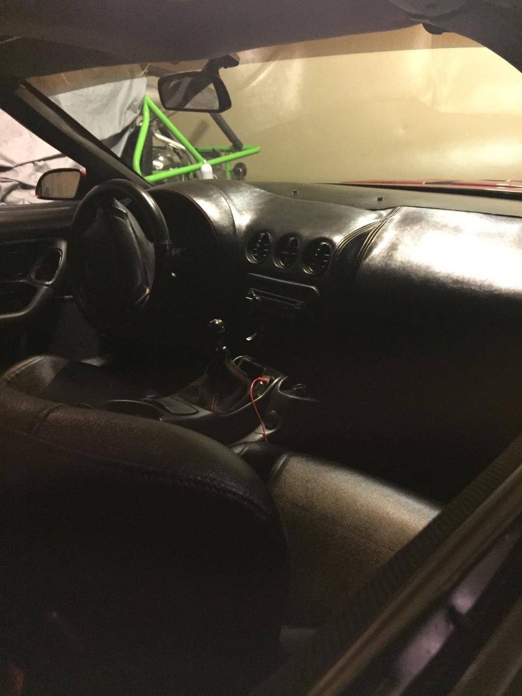

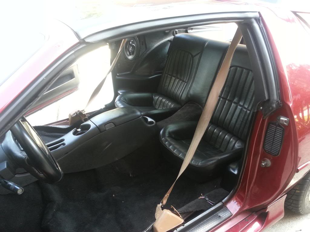

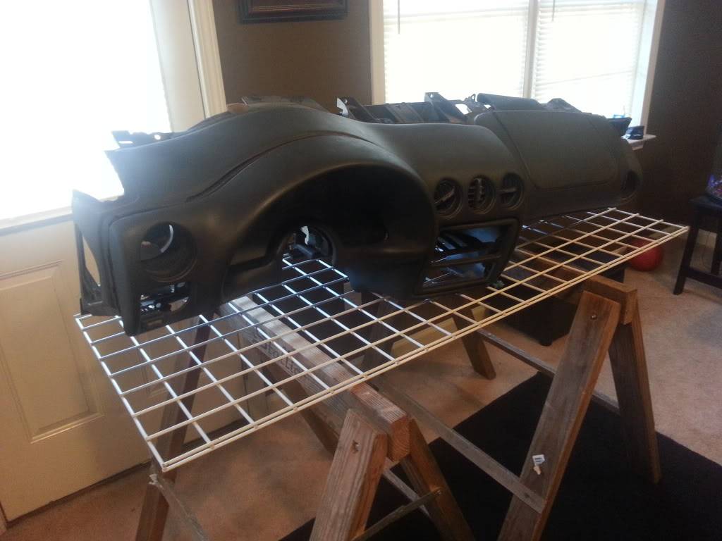

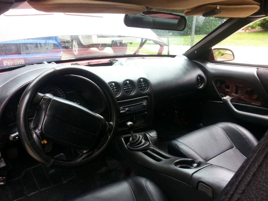

      I wanted a modern feel for my interior. I also wanted my car to be different. Therefore I got a dash board from a 2002 Trans Am. I then sent it to the upholster to have it wrapped in black leather, and red stitching. This improves the looks, and gets rid of the notorious chevy plasticy feel. The interior now has a more quality feel, similiar to newer highend cars. I grabbed a set of 4th gen camaro door panels to match the dash board. New leather seats and black carpet were installed too.

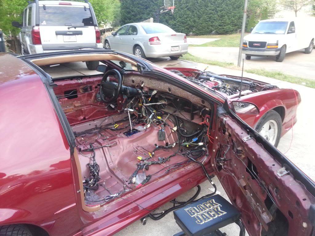

      So out with the old. This picture was taken as I was wiring the car with the 4th gen camaro harness. Tons of hours went into this. This was before the wiring was completed. Interior went in after.
      Some of the new installed after wiring was finished.
      Racing seats in
      Dash board before leather
      Dash installed after leather and stitching. At that point it still needed 6 speed console, dash pad, and door panels finished.
      A little more completed

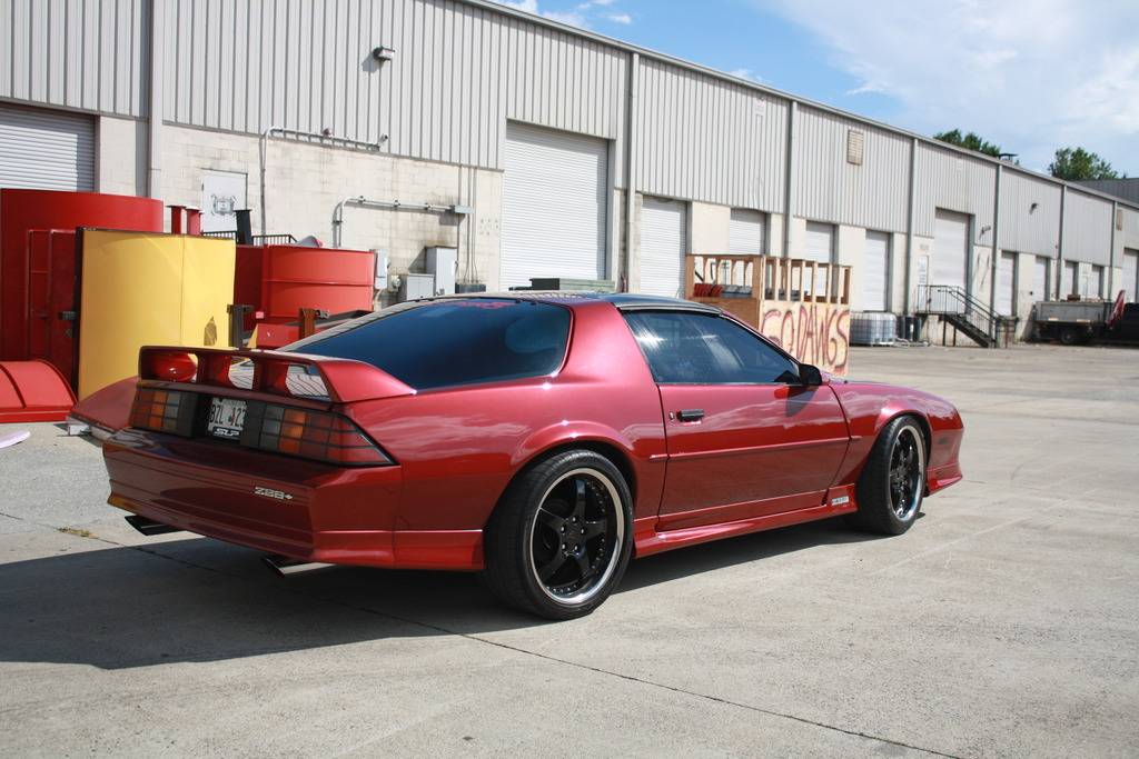

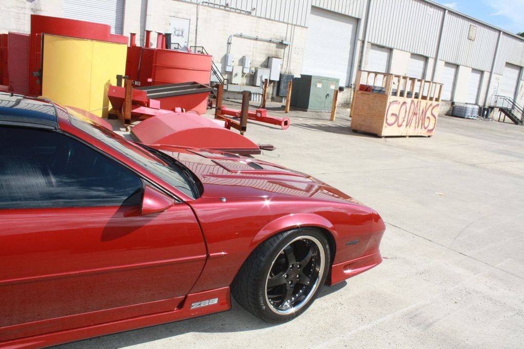

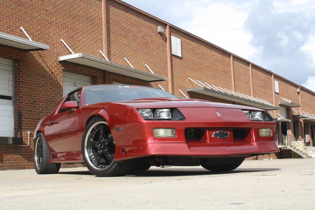

      So after the LSX/T56, suspension, and finally interior I have created a car that I can drive. I have used the car as my daily driver for about 30,000 miles after the build. The car has been great. This upcoming year the car will see alot more autox and it will visit the road course at Road Atlanta frequently.
      Here are some recent pictures.
      This one was taken on the Hot Rod Power Tour 2015. I drove it roughly 800 miles on the trip.
