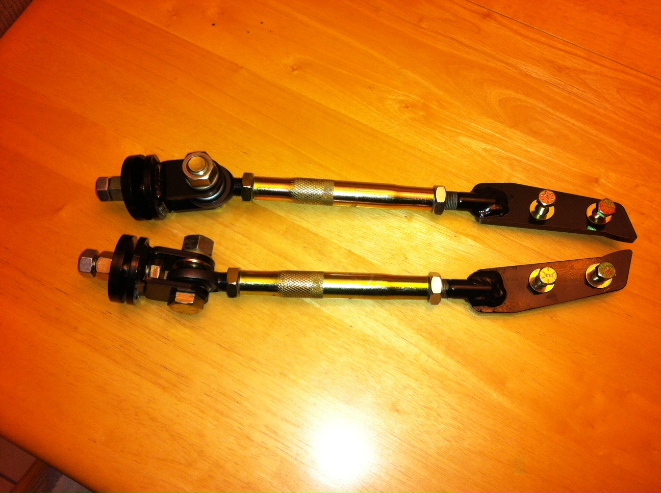

      The lower bushing is a jj ball and urethane bushing cut to fit a custom outer shell welded in the arm. The jj application is the jeep track bar. The camber adjuster bolt is 9/16.
      The strut rod is a chrysler small ball joint in place of the bushing. I machined an adjuster and threaded the old strut rod.

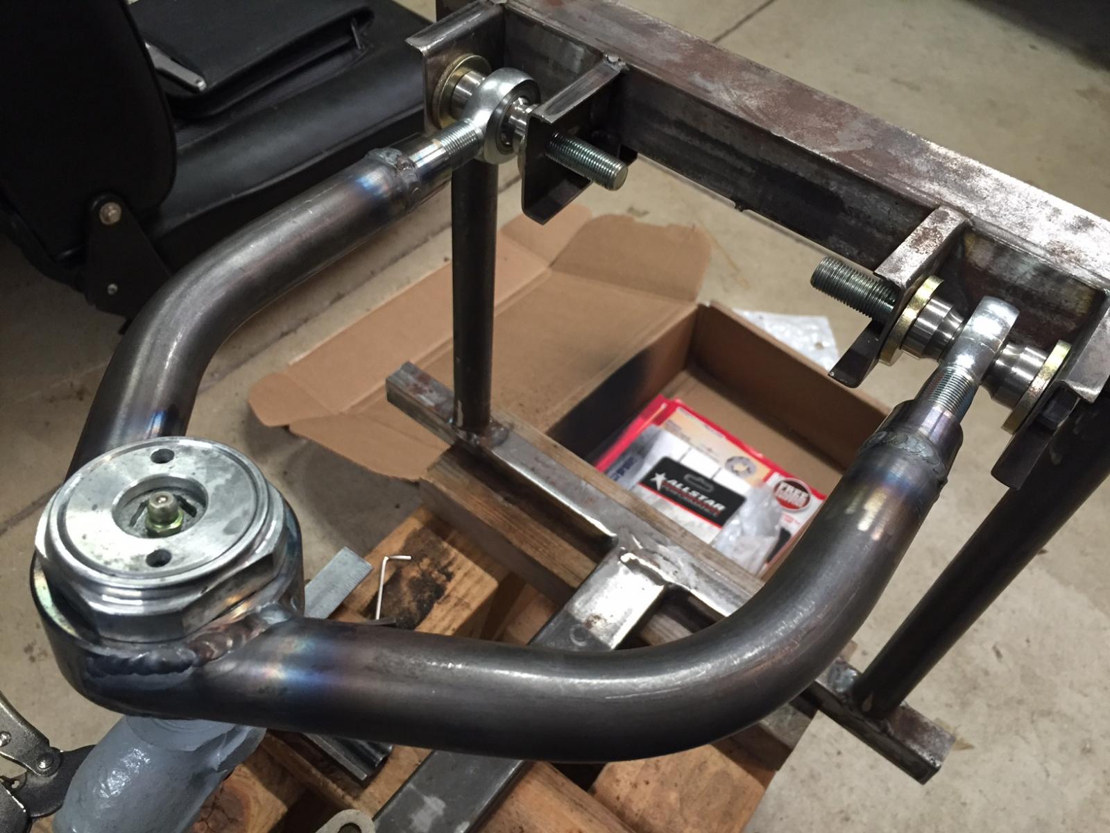

      Finally had some time to work on this, first one fabricated, and tacked together.

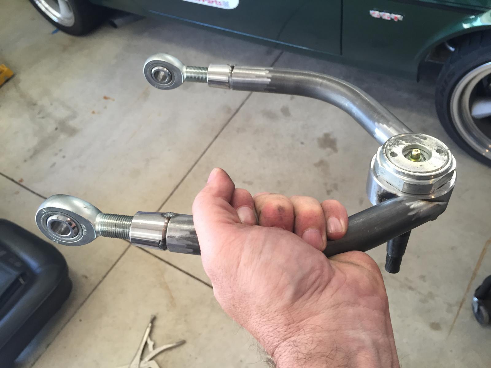

      Upper Arms Done, Now to focus on how to mount the coil-over.

      Hey all, just following up here. I have the completed front suspension on my car and it's even better than expected.
      I've been working on this on-and-off for a long time, but I didn't want to say anything until I had something interesting to report.
      I've had the car on the road for a few weeks now, and it's so much fun to drive. Interesting the ride quality is better now with rod-ends in the upper control arms, than With the trunion suspension in place with Poly bushings.
      I'm setting a few things up so I can sell them to other who may be interested, I'll post more when I have that ready.
      Smiley, To answer a few questions. The hood was made from the original mold used by Ronnie Kaplan for the '69 TA Javelins. The current owner of that mold was gracious enough to make one for me. Unlikely he will make any more unfortunately, He is a busy guy, and fortunately he lives near by and I drove over to get it. He doesn't do shipping and all that.
      I'm using the QA1 Ball joint with a longer stud, this raises the a-arms on the ball-joint end. This will give better geometry at ride height, and a more aggressive camber curve. I can also dial in high caster angles as well, this is a significant improvement. I've checked every conceivable clearance for full suspension travel, lock to lock steering, etc. All is well and I can fit a 245/45-17 and perhaps even larger now.
      With the coil-over in place, I can adjust suspension damping, ride height, and change out spring rates easily and inexpensively.
