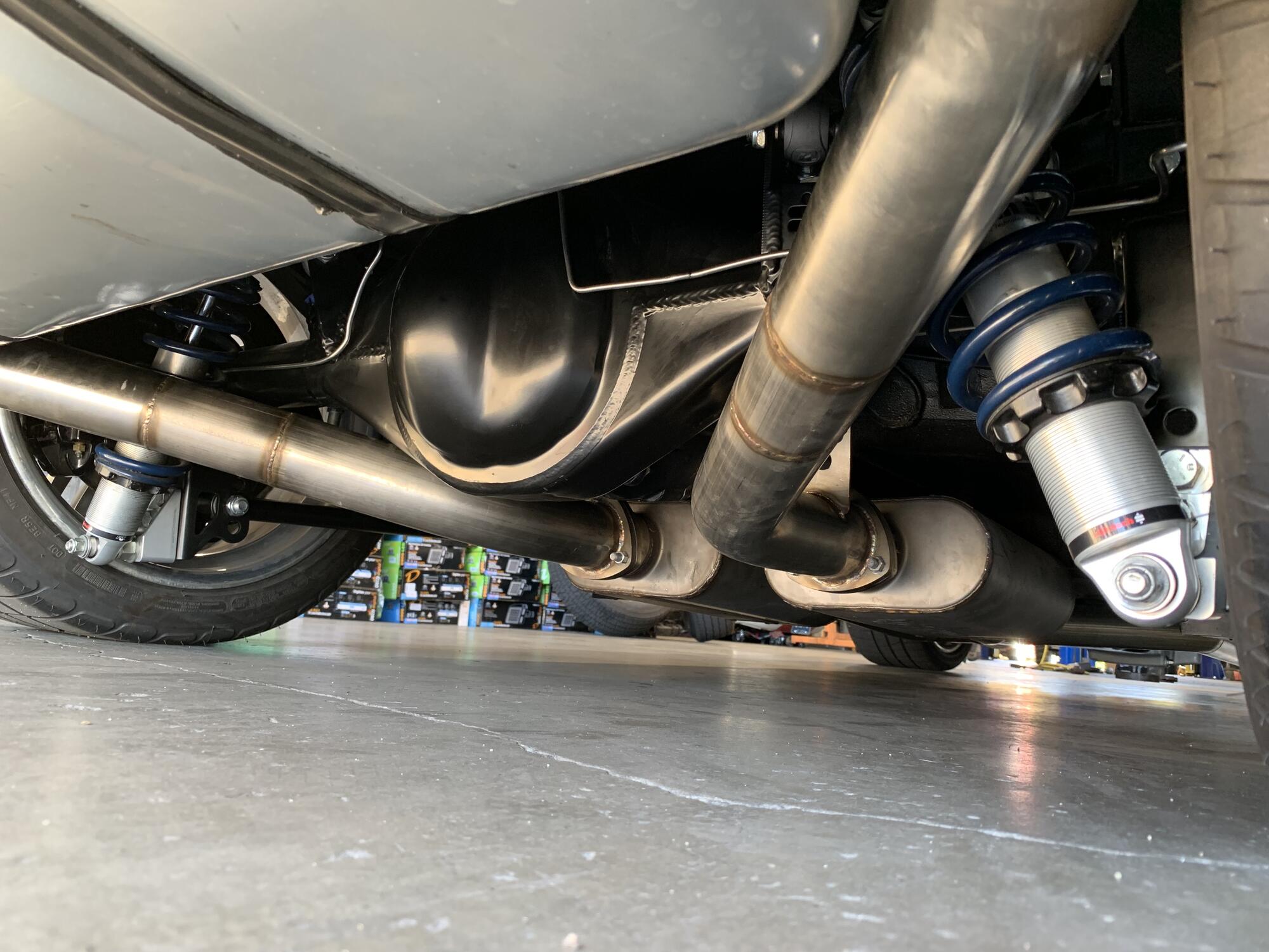

      Some updated pics of the underside showing the stainless steel fuel tank, ridetech suspension, and 3" exhaust getting installed.

      The list of remaining items is getting shorter. 3" exhaust with DynoMax Ultra Flo mufflers installed and LT4 engine is running. Tire alignment, mounting seat belts, and running AC/heater lines are among the final things left to complete.

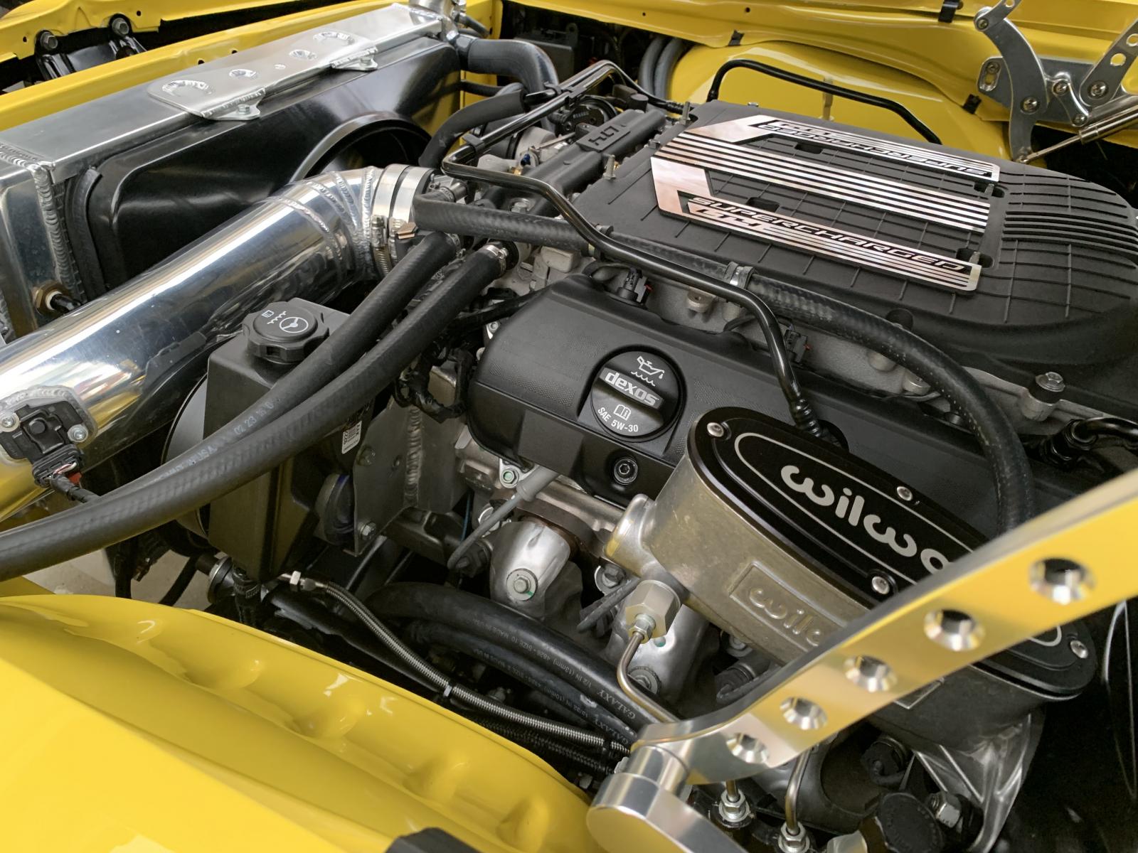

      Fitting the AC compressor in with the LT4 engine took some fabrication as well:

      Here are current photos and a video of the LT4 motor starting.

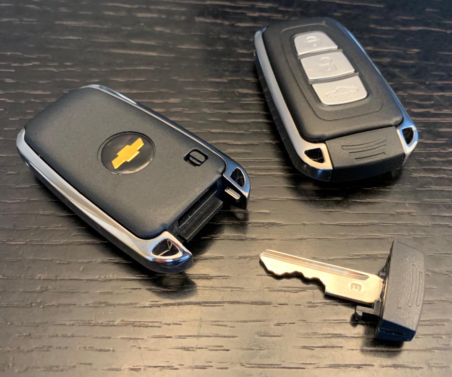

      Here is a picture of the Advanced Keys fob where I cut down a key to fit inside the fob (if needed for emergency). The Advanced Keys setup is nice, just walk up to the car and it unlocks, push the button to start, just like a new car.

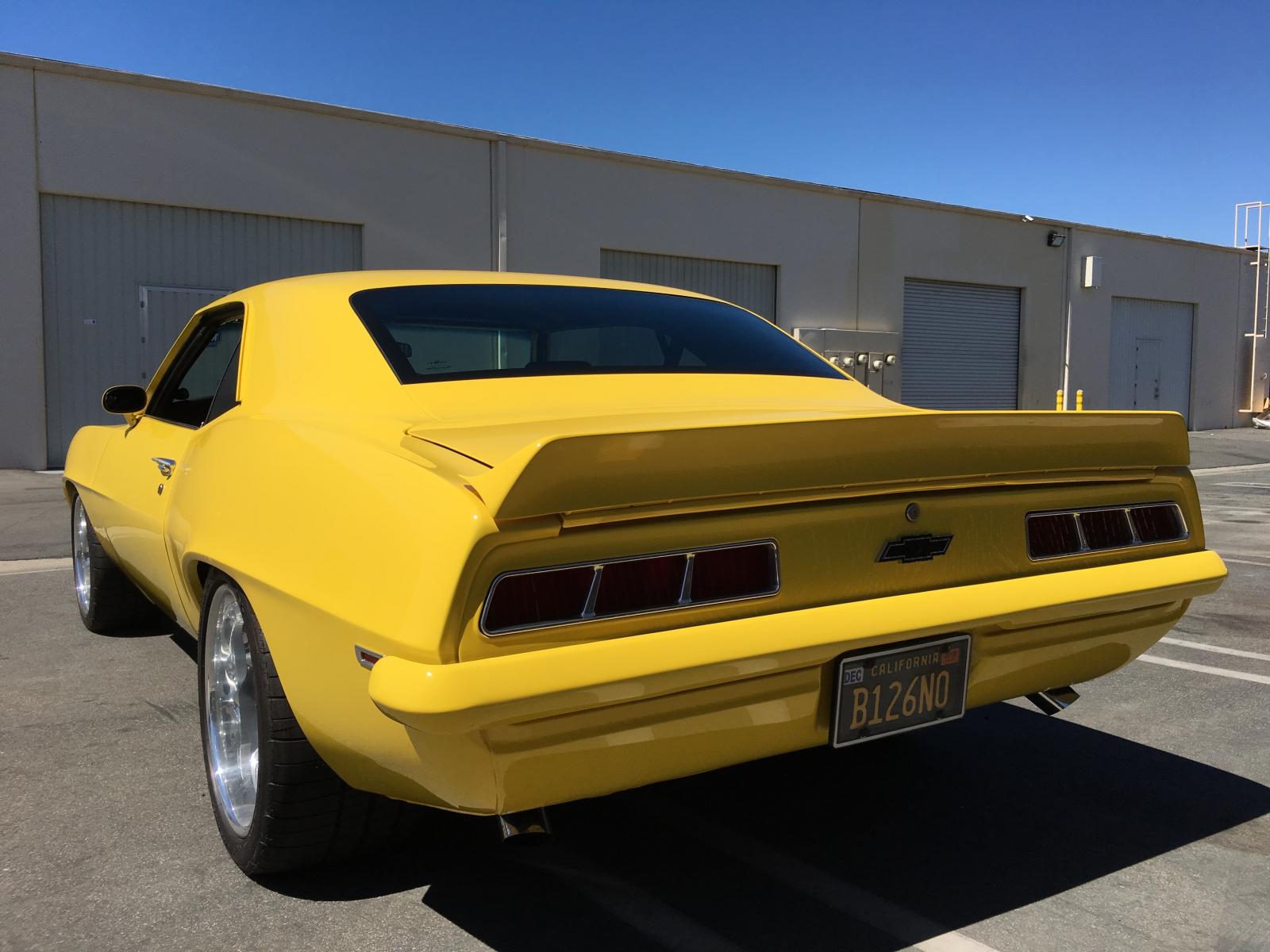

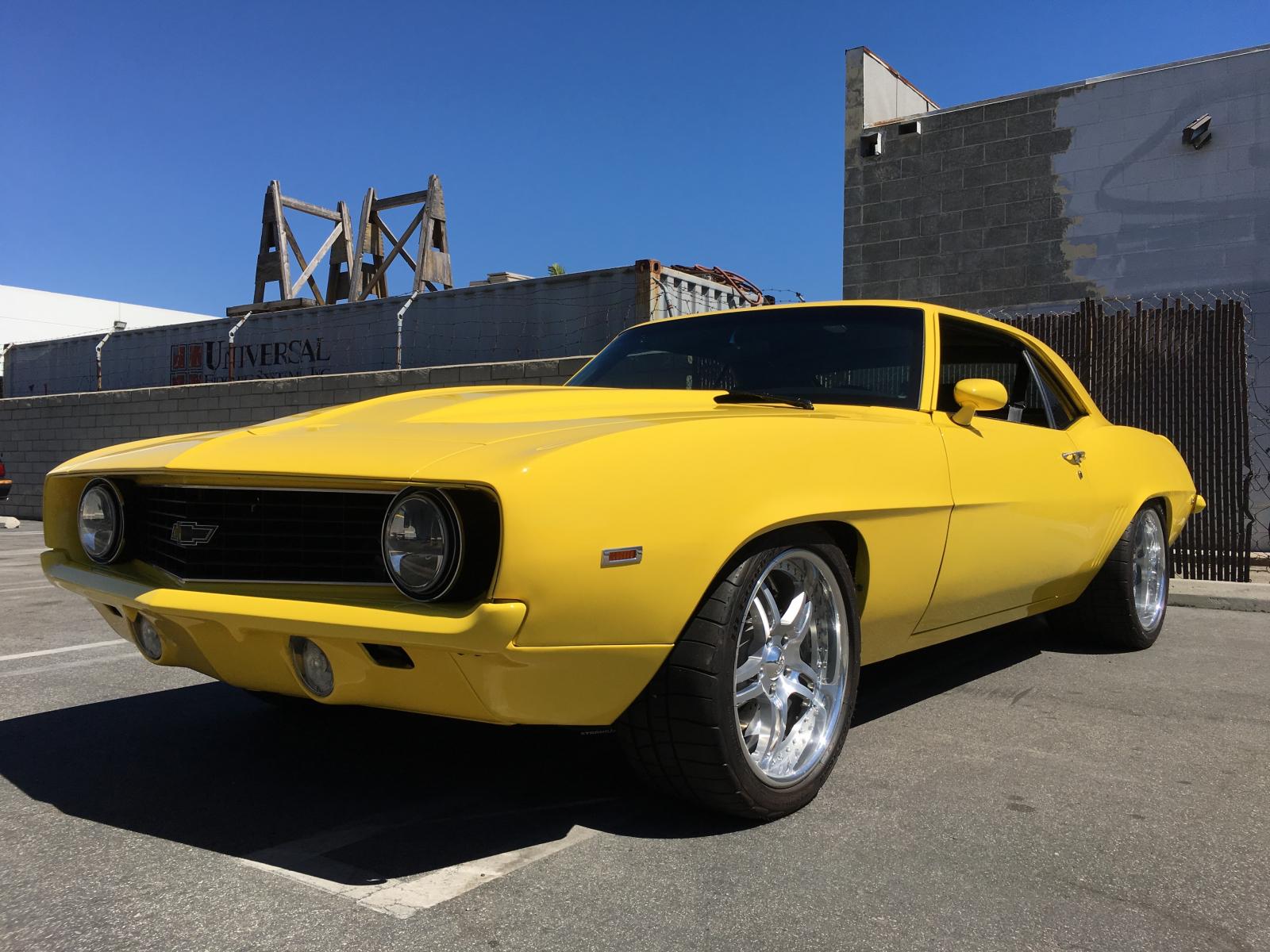

      Below are some recent pictures of the car.

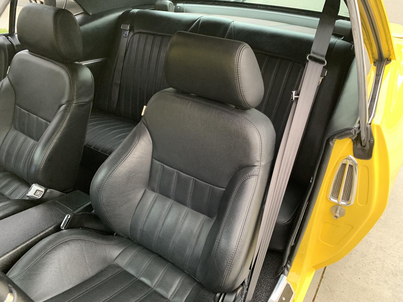

      Amazing build! I have a 68 RS/SS and I purchased those specific seats in xl, and the morris classic 3 point seat belts. I currently have 295 Outback, 335 would awesome, did you install the Detroit speed mini tubs? adding the ride tech 4 link with the tubs you were able to get the 335 to fit with no rub? I also want to do the double din and back up camera. I read in one of your posts you installed a modified Detroit speed adapter/bracket/mount in the dash? Why was this needed? The console is great also, the whole car is amazing. Thanks for your time, Mike

      Thanks, Mike. Yes, it has DSE mini tubs with ridetech 4-link. No rubbing at all with 335s. In the summer of 2019 I replaced the 12 bolt rear end with a Ford 9 inch. With this setup it could fit slightly wider tires.

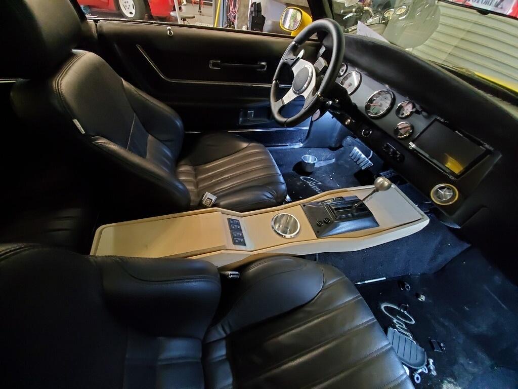

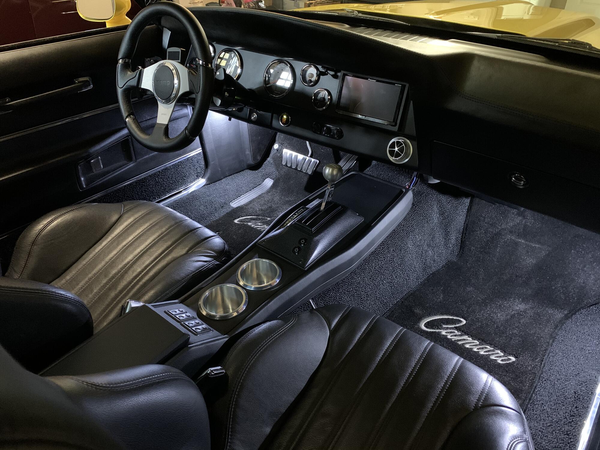

      In regards to the dash, I had purchased the DSE dash insert but later decided I wanted the double DIN stereo as high as possible (to keep eyes on road) so that's why we modified the dash. In hindsight we could have just built a custom dash rather than modifying the DSE one.
      Thanks for the compliment on the console. I had a custom console built in 2020 to get cup holders and a bin to hold/charge phone for use with Apple CarPlay. I also installed a Banks Power 66760 iDash 1.8 DataMonster (OBDII connection) which has been a wonderful digital gauge, data logger, and simple way to view or clear engine codes.
