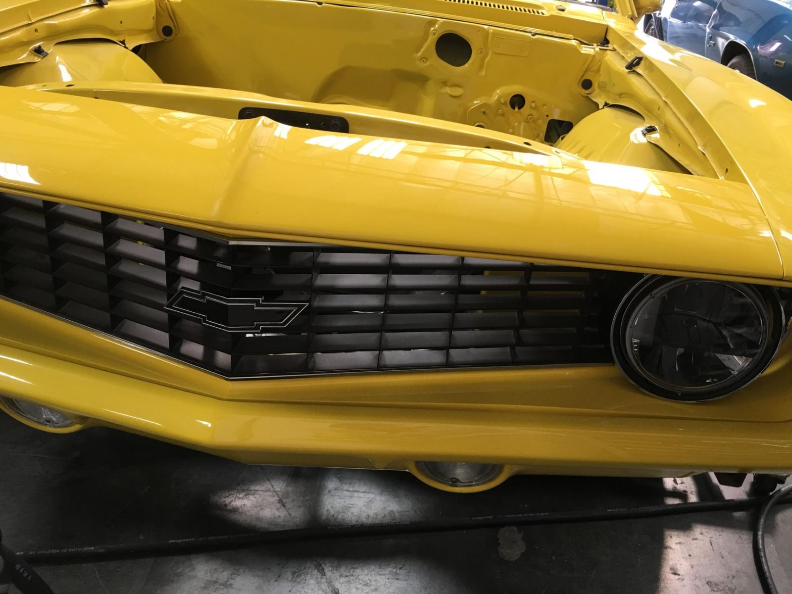

      Front view with the grille, Truck-lite 27270C LED headlights, and painted front bumper installed.

      Nice, How did you get the truck lights to sit a little further back. Mine stick out a little further.

      Thanks camarodude87. I think the headlights are mounted in the stock housings.

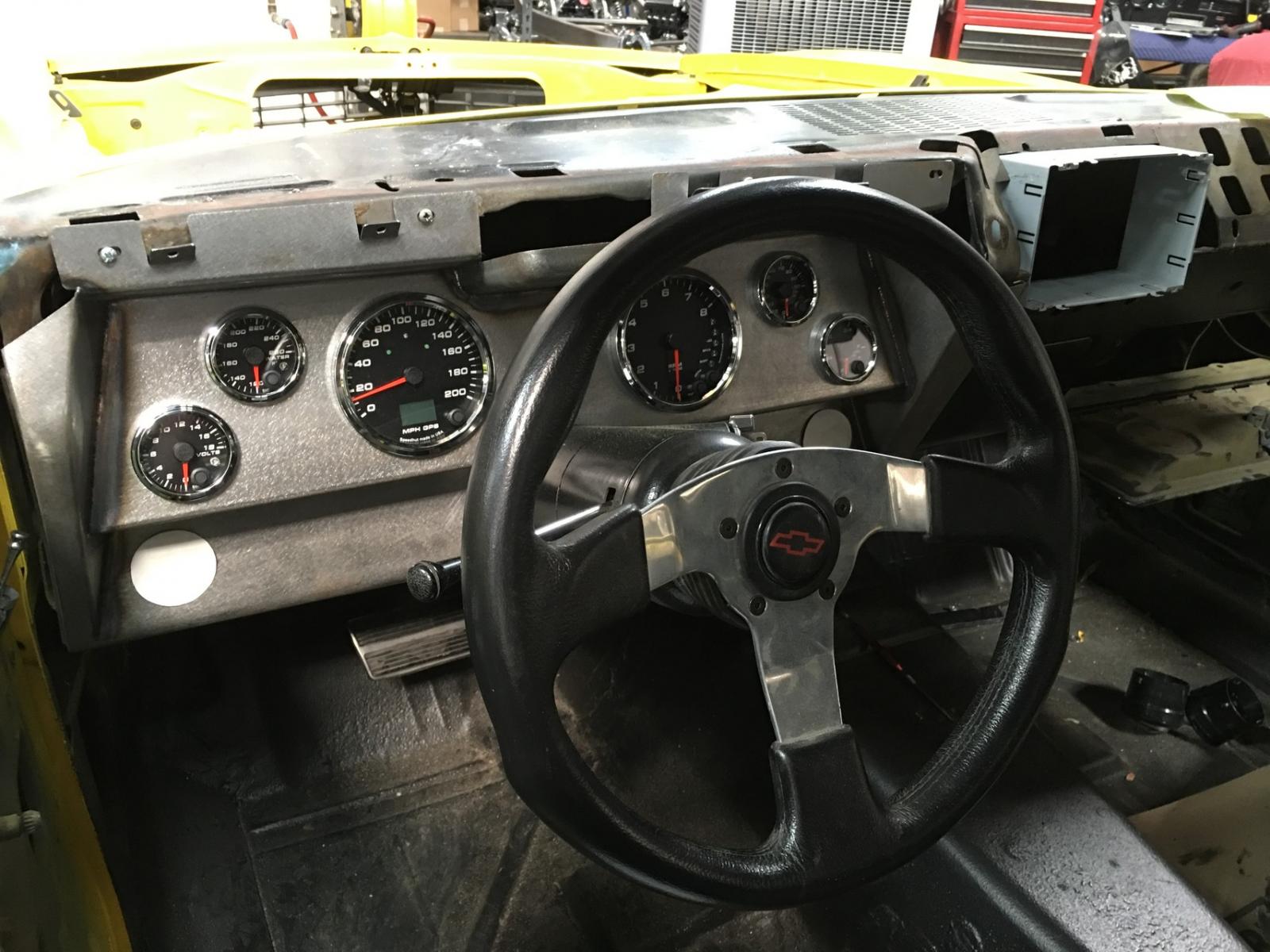

      Modifying the dash to fit the double din head unit.

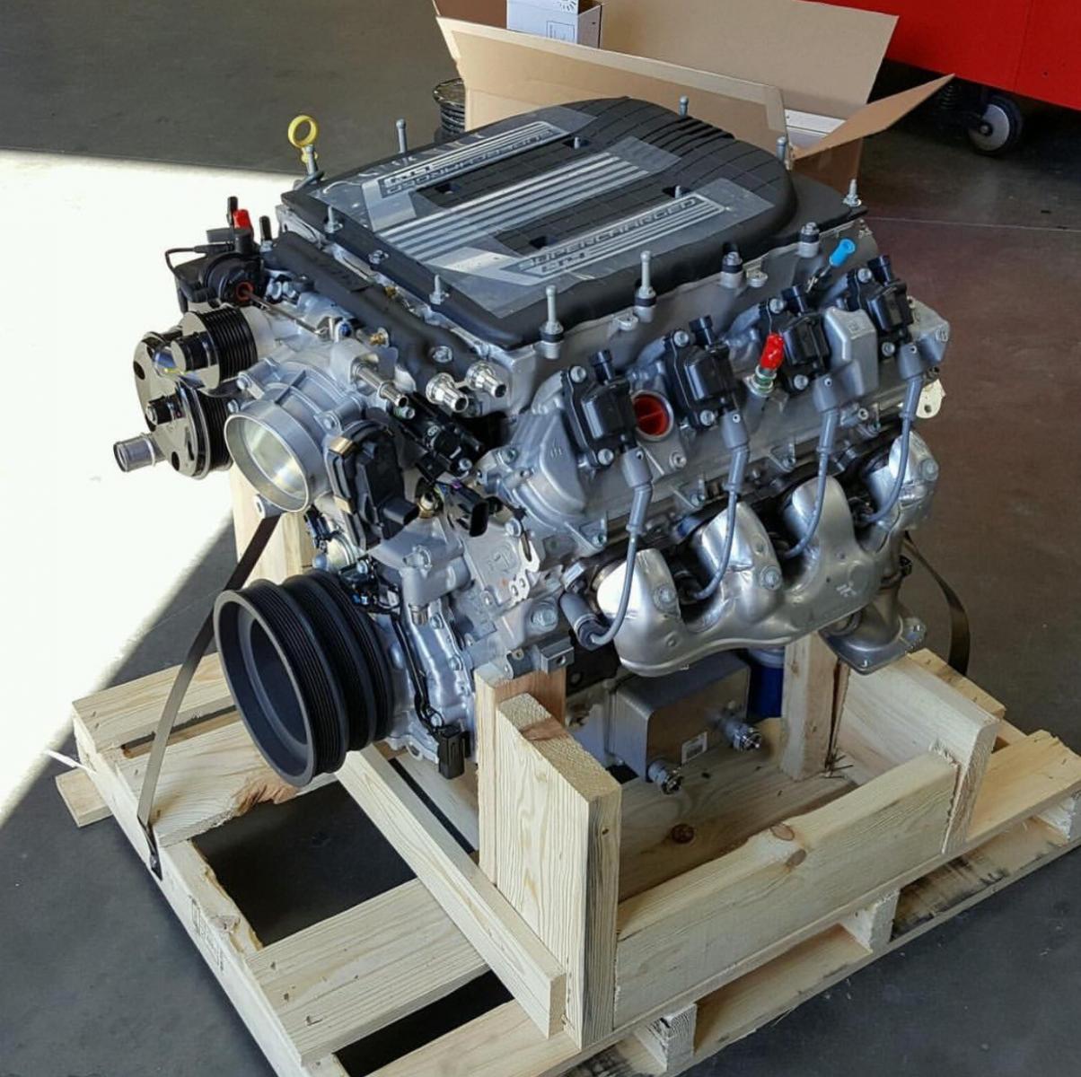

      The 650 hp supercharged LT4 engine from Chevrolet Performance has arrived.
      Nathan

      What accessory drive are you going to use?
      _______________
      1969 Camaro
      1966 Skylark
      1964 Lemans
      1960 Biscayne
      Steve

      Quote Originally Posted by camaro69boy View Post
      Front view with the grille, Truck-lite 27270C LED 7" headlights, and painted front bumper installed.
      love the build ... did you have any problems with installing the lights?

      Steve, thank you! We went with the Chevrolet Performance LT4 wet sump accessory drive system, part number 19332590.

      Randal, my understanding from the shop is that the headlights basically dropped right in. Here is a closer picture of the front with the Camaro Central black bowtie emblem and Illumin8s parking / daytime running lights installed:

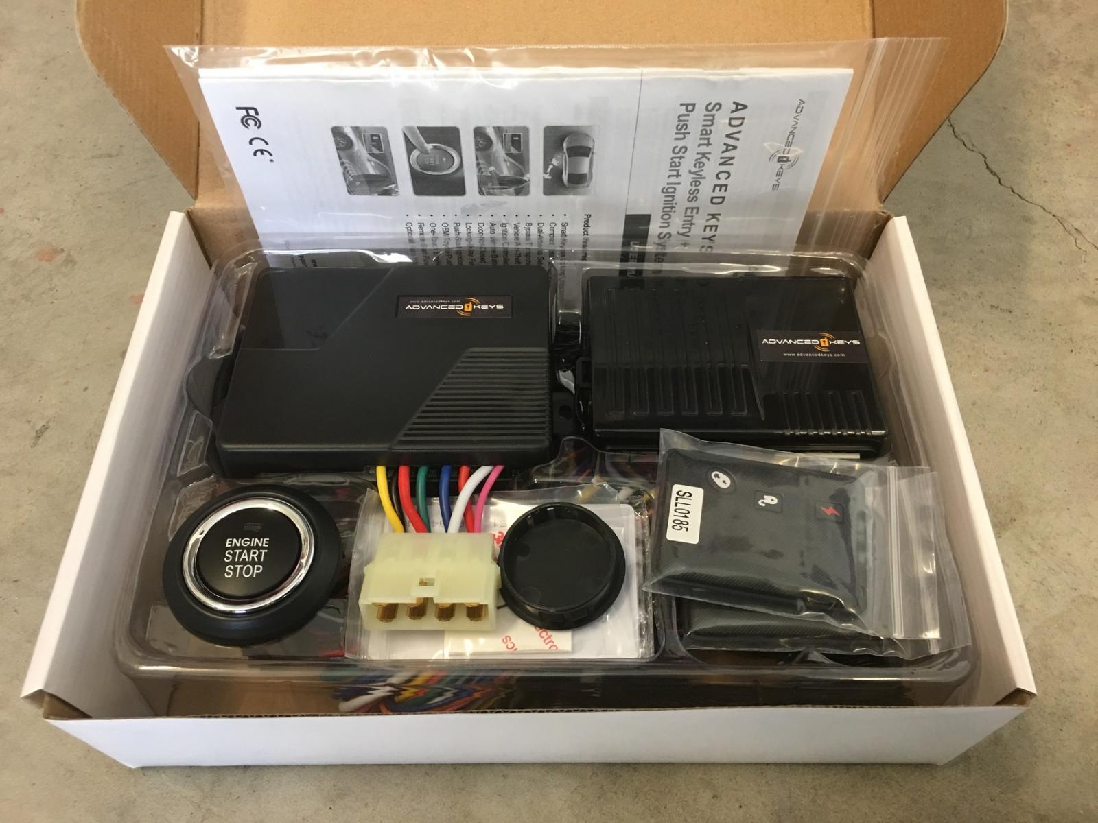

      Advanced Keys AK-105B to push start this '69 Camaro's LT4 supercharged engine.
      Nathan
