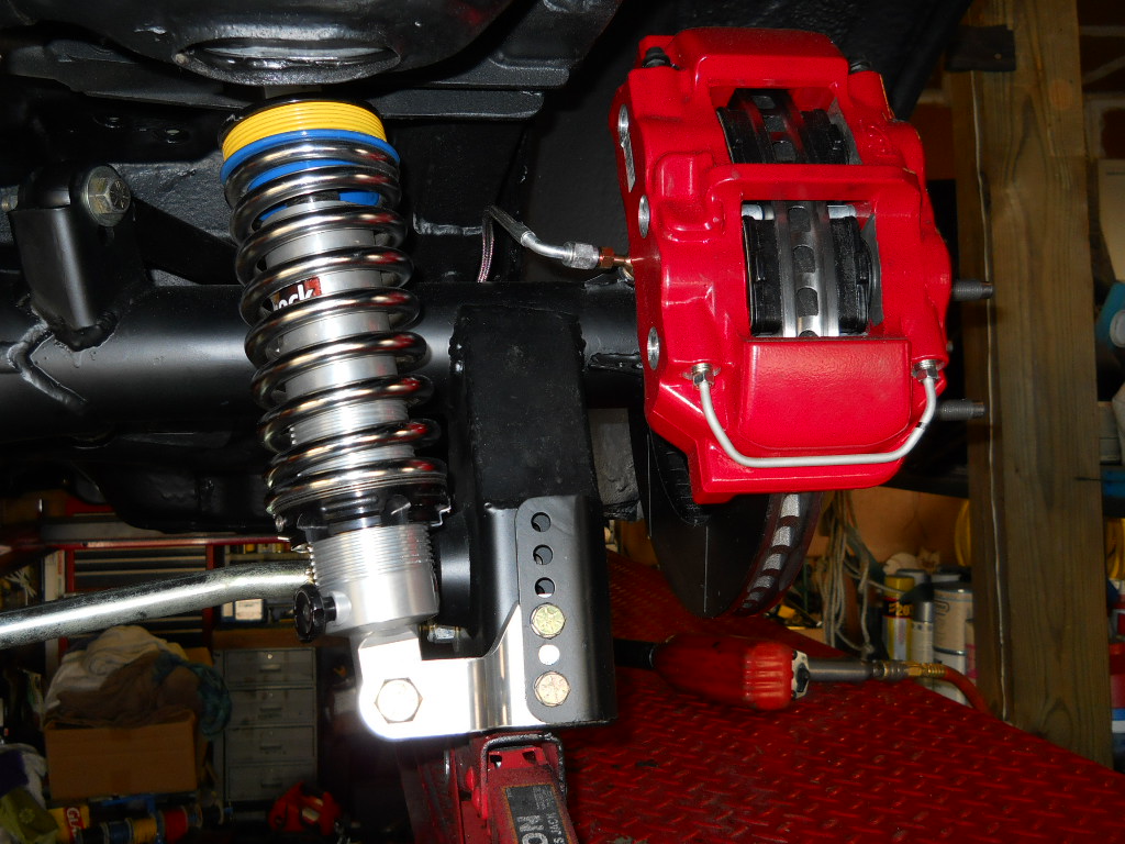

      I have pbr 4 pod rears with the flex core lines. The question is Should i mount the retainer clip where the flex line attaches to the hard line on the rear axel inside or outside the frame rail??? Thanks

      Here is a picture that shows my rear chassis brake hard line at the point where it attaches to the bracket and connects the to the single drop flex hose up to the "T" fitting. You can't see the "T" fitting which is mounted on top of the axle housing, but you can see the RH wheel hard line as it comes out from behind the axle housing toward the RH caliper. The second picture shows the RH wheel flex hose where it is connected to the RH caliper and disappears over the axle housing to the RH hard line bracket which is welded on the front side of the axle housing almost directly in front of where the shock is. The primary concern is that there is no possibility of the brake line coming in contact with anything.
