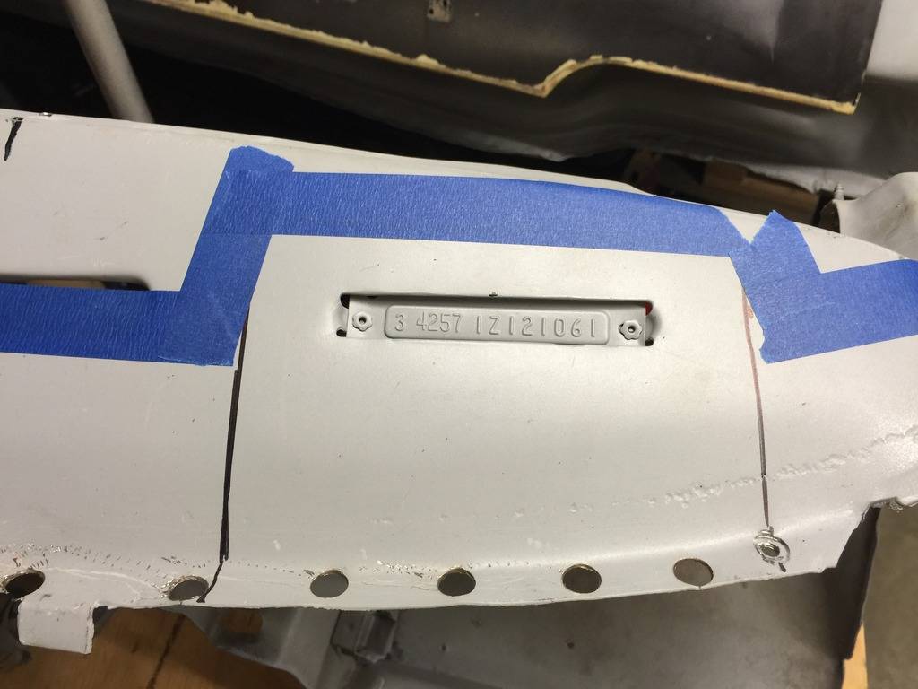

      This is marked where I "might" cut a section from the original dash and re-attach to the windshield cowl area.

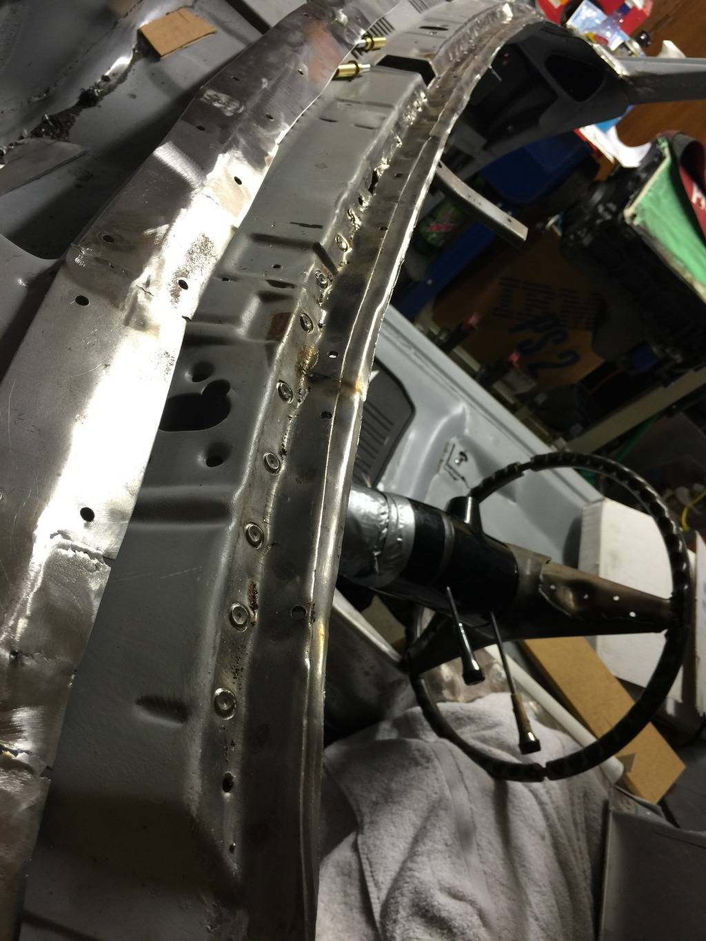

      This the area where spot welds from the original dash that I need to clean regardless of what I do.

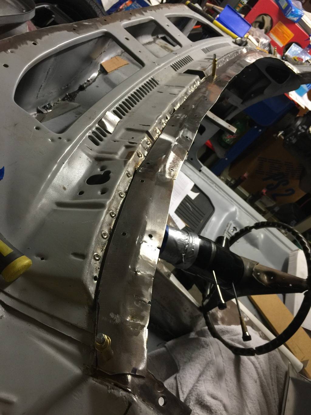

      This the custom piece (still needs cleaned up) that I would just plug weld to the windshield cowl area and my new custom dash will attach at several point along the front (before windshield installation of course).

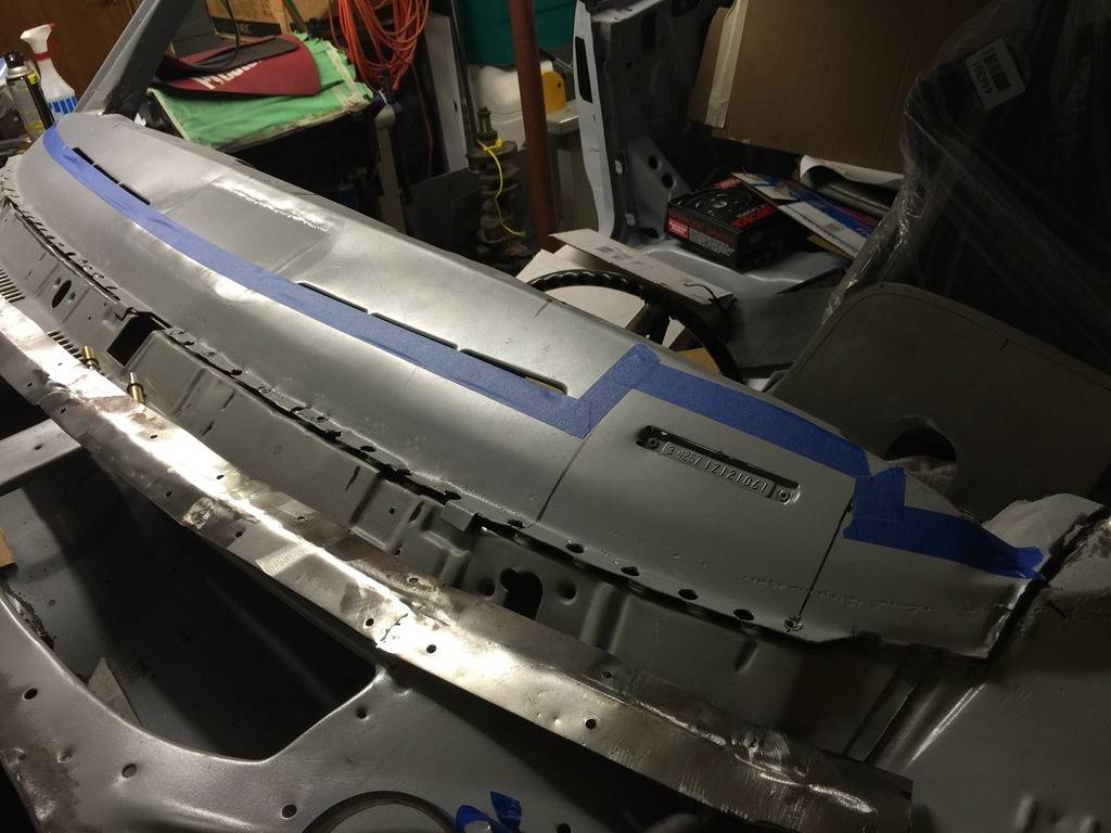

      This the area around the VIN that I need to put back on the car. The question is do I section just the area around it (will cut reveal window in new custom dash to make it visible) or section it along the entire length also cutting around the VIN area?
