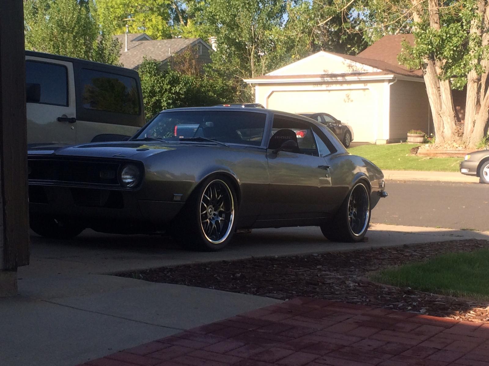

      I don't have a 20x10 up front but an 18x9 with a 265 tire and am running the truturn. I can tell you that I barely clear the outside fender (but it clears) on full lock when I turn the tire will kiss the frame on the back side, it can really mess you up when doing donuts but that's about it. Here is a pic for reference.....

      are you running all ride tech with the coil overs and 4 link? Looks awesome man really does perfect stance and tuck on the wheels and tires.... can't wait to finish mine. Left to the service in 2008 and left it with the shell complete, came back home to the LS frenzy and now I am cashed out! lol

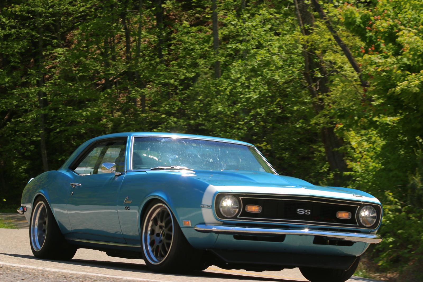

      I don't know of anyone here running a 20x10 front wheel on a 1st gen Camaro. A 20" wheel is not optimum for performance and most here are more performance oriented than that. I'm running 18x10, 275's front and 18x12, 335's rear on my 68.

      Stance is so clean on that too man. Whats the BS on the 18x10's? Agree on the performance and I will probably end up running 18's up front, I've sat on this project for too long and really want to hit the streets with it.

      The rear are 18x12 5.6" bs on a 57" WMS to WMS rear end width. Up front 18x10 6.6" bs but I'm running .250" spacers. I should mention that I'm running a DSE subframe. However, the ridetech 48 hour Camaro is running 18x10 wheels up front with a stock subframe and complete ridetech suspension but you would have to contact Bret to find out the bs of his wheels.
