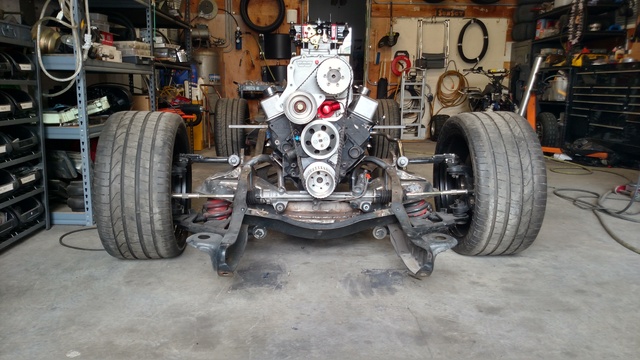

      I ended up parting out most of the truck to friends, and i got a rolling chassis and nice body to start over with. The frame i had wouldn't have been condusive to try and modify to what i wanted to do. So after researching and reading everything i could find on making a c10 handle i went to work.
      I went to work on the crossmember, and notched it 3" to raise it up around the frame.
      I sectioned part of it to clear for a Rack and pinion from an 88 Tbird.
      I used Mcgaughy's drop spindles with 13" disc brake kit and 2 piston calipers.
      The control arms i ended up using were a set of DJM Drop arms that i got for $100. The coils are an unknown amount of drop.

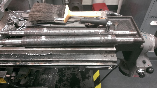

      I did the caster mod with the lower control arms and pushed the lowers forward 3/4" and drilled out the pins and replaced them with 7/16-20 allen cap bolts in grade B16 for strength with a set of toplock nuts.
      Giving me a total of about 10" drop in the front.
      I bought a Longacre caster/camber gauge and have been setting up all the front geometry, and have been working on my Instant centers and roll centers, and am getting it close to were it shouldn't handle like an old truck anymore.

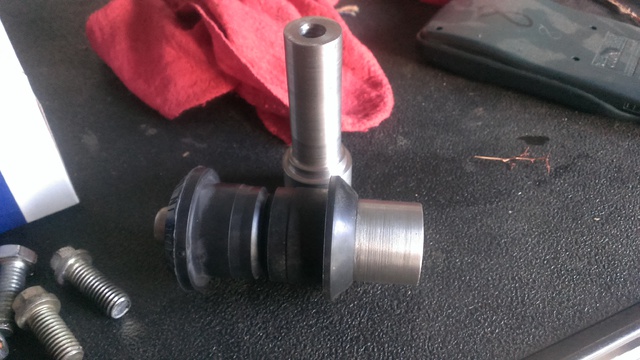

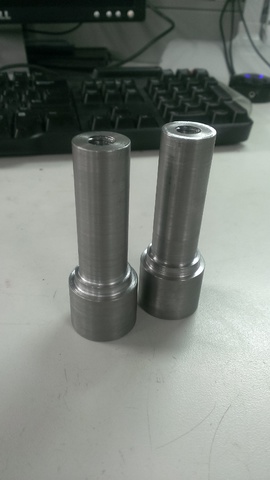

      I built a set of Bumpsteer adjusters to fit the C10 spindles.

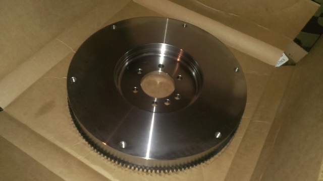

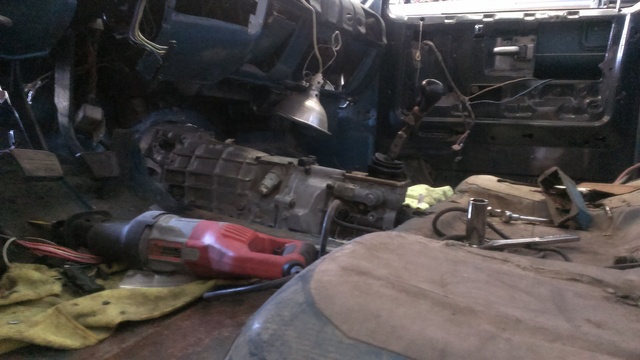

      Transmission was replaced with a T56 from a 95 Camaro, and clutch and billet flywheel are from local place here in san diego.

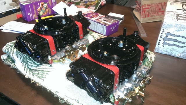

      So i did a few upgrades on the engine this time around. I upgraded to a set of Holley 750 Dp that are boost referenced.

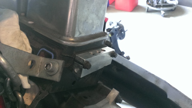

      I also had an issue with headers, i had a set of block huggers that i hated and they created a tremendous amount of heat due to the bends required to clear the last frame. So this time i wanted to go with long tubes that are off the shelf. And an issue C10's have is ground clearence with long tubes, so a few modifications and i am good to go.

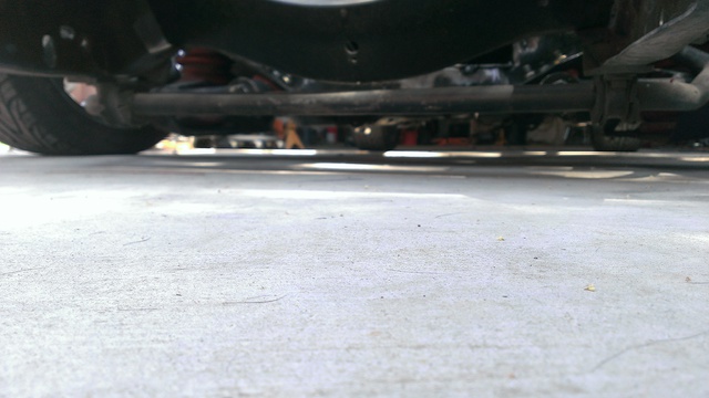

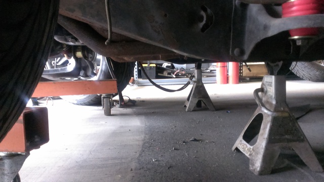

      SO my final geometry came out to 8* caster, -1* camber, wheels centered in wheel wells, and 11" drop in the front, 7" in the rear(for now). I/C and Roll Center came out pretty close. Still think i am gonna add a +.5" upper balljoint to improve R/C a little bit.Name:  IMG_20160109_135325468_HDR.jpg

      Thanks for the good words. Traffic is slow on alot of the forums. damn social media.. The truck is far from finished, as is my center bracing section. So far, jack tests show the frame to be pretty rigid. Plus i have a 10 point cage im building into it, so that should help strengthen everything. My biggest problem being that i am deploying next month, so the truck is gonna sit till i get home.. As for the tires, Im not sure i can fit much bigger up front with as low as i am. I will see where i end up with this setup, as i bought all my tires used for pennies on the dollar. If i can fit some 325 or 335's would be awesome. as of right now, i have some sidewall, but would like more. As for the purpose of the truck, i dont really know. i just want a fun truck, that is a blast to drive. I may race it, but im mostly just calling it a street fighter/road racer.
