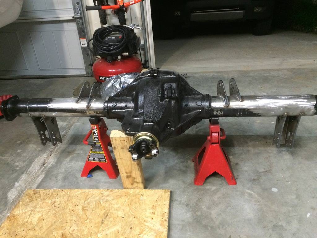

      I decided to put an ford explorer 8.8 in the rear. They are cheap, plentiful and good rear ends plus I feel like I have alot of experience with them. This is probably my 5th one. The width is almost the same, has 31 spline shafts, disk brakes and most were 3.55 or 3.73 and easy to find with a limited slip. They have 3.25 axle tubes. I got a 3.73 limited slip. One thing that might be an issue is the pinion offset. We will see.

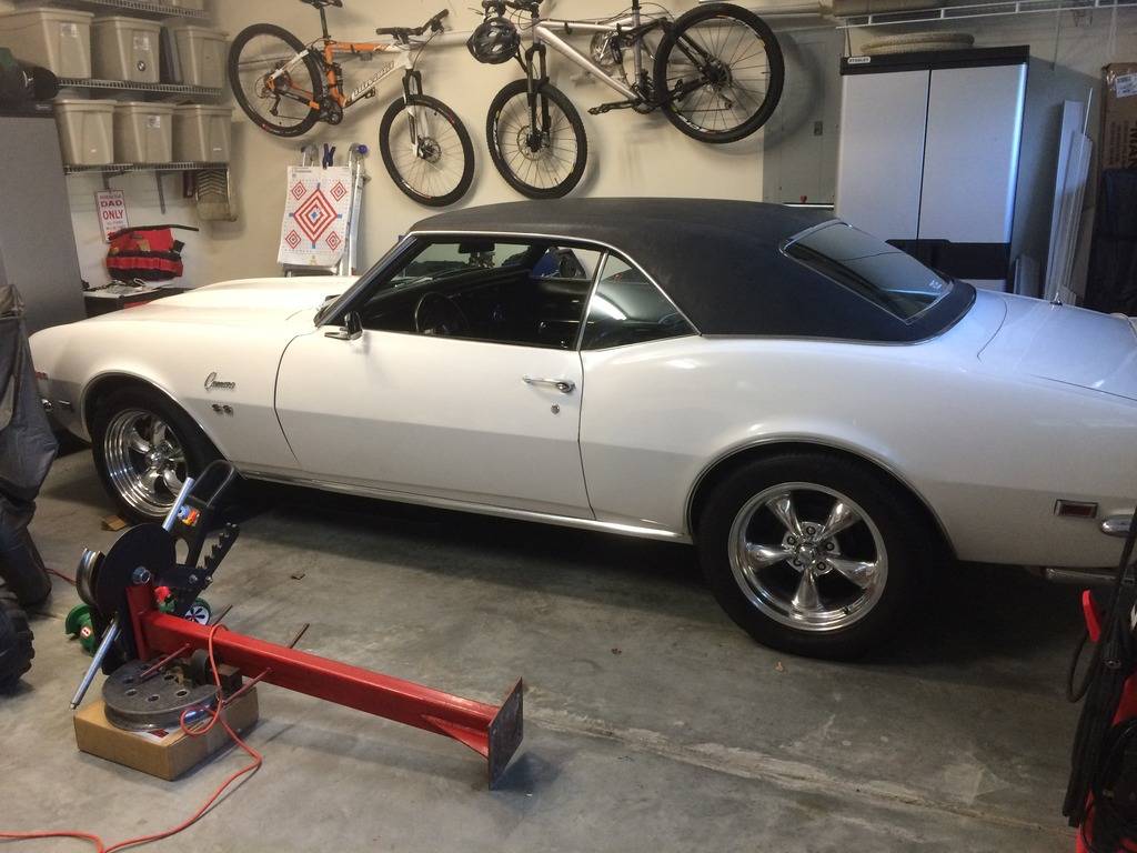

      As I got it.

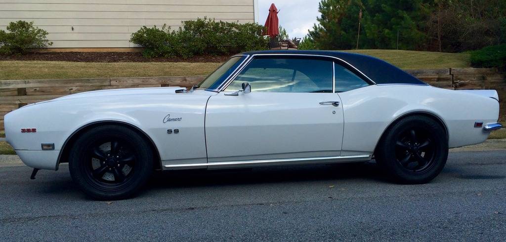

      Here it is after I lowered it.

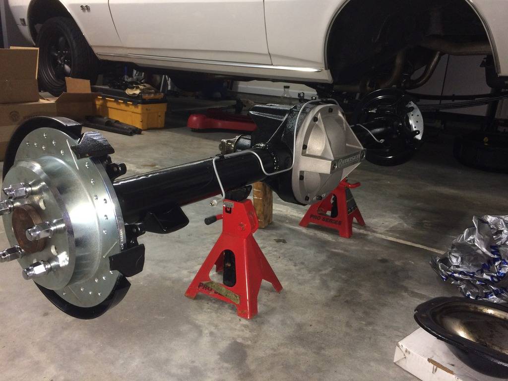

      My 8.8
      I got new rotors, bearings, seals installed. I drilled the stock axles and new rotors to 5x4.75.

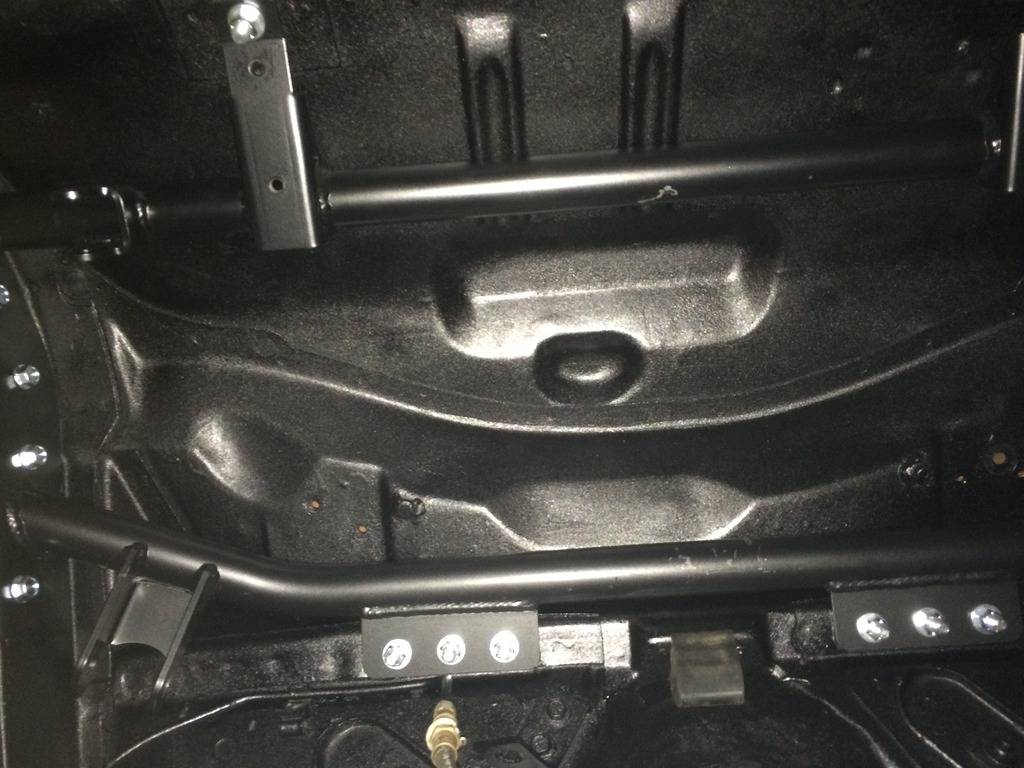

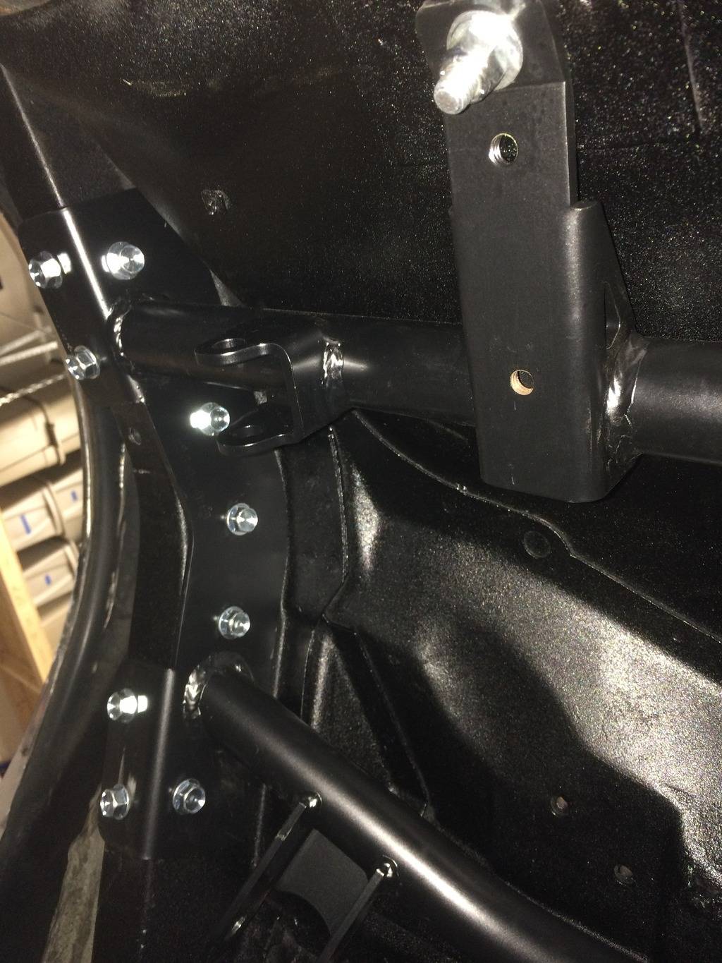

      Some slow progress. I cleaned underneath where the ridetech cradle will go. 47 years worth of crud.

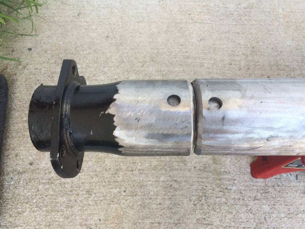

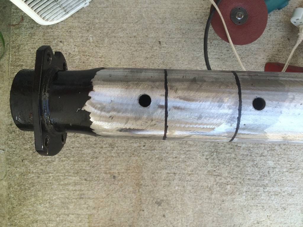

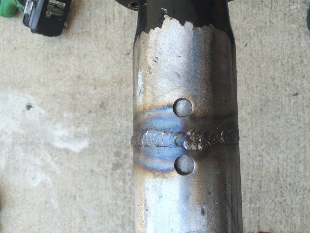

      The pinion in the 8.8 rear out of an explorer is 4 inches offset to the passenger side. The stock 10 bolt is 1 inch. This offset put one of my upper control arm brackets about 1/2 inch on the cast part of the differential. The axles are different lengths. the driver side is 2 7/8 longer than the passenger side. My solution was to cut 2 7/8 out of the driver's side tube, sleeve it, plug weld it and use a passenger side shaft. So now my pinion is 1 inch to the passenger side like stock and the overall width is 3 inches narrower actually 4 inches narrower than the stock 10 bolt. I am going to use 5x4.5 to 5x4.75 wheel adapters 1.25 inches thick. This will make my rear 1/2 narrower on each side compared to stock.

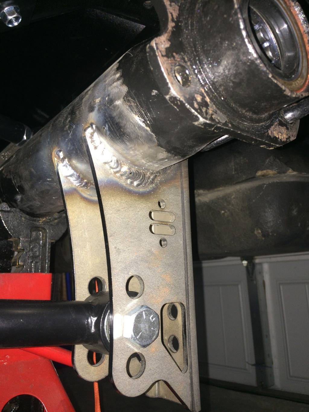

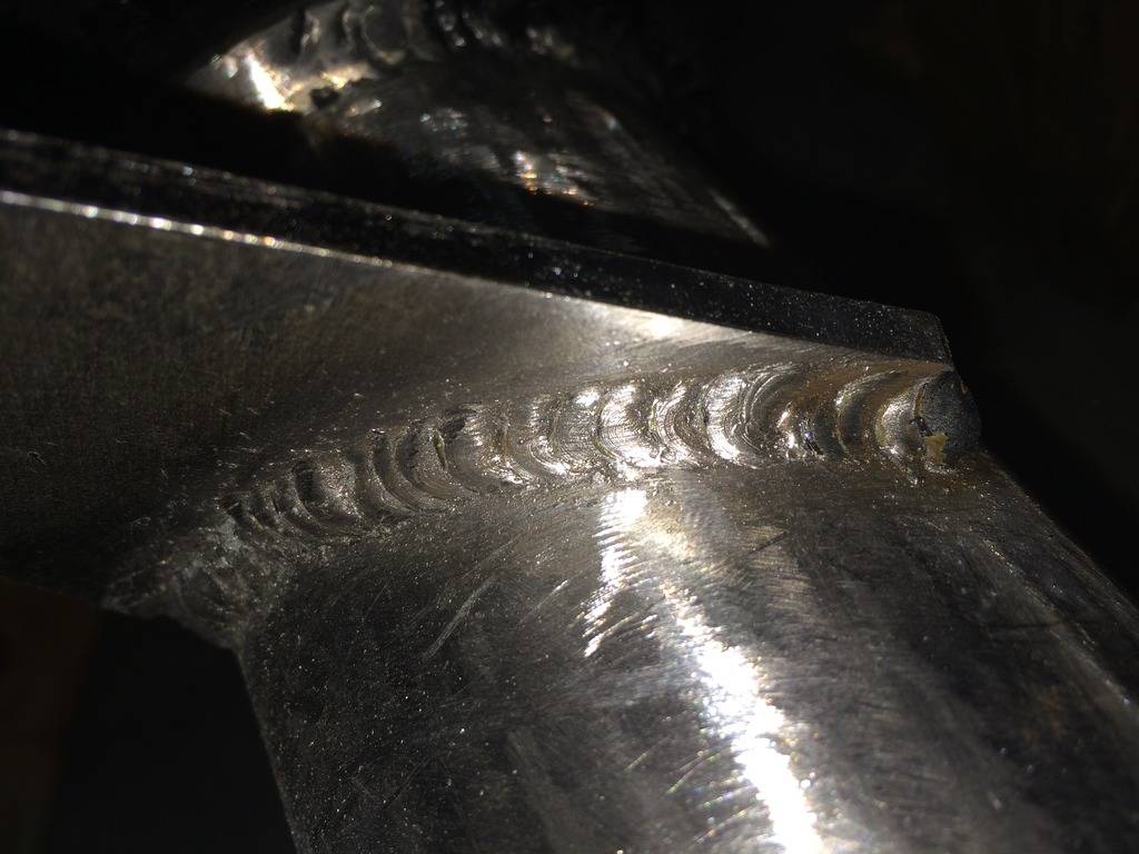

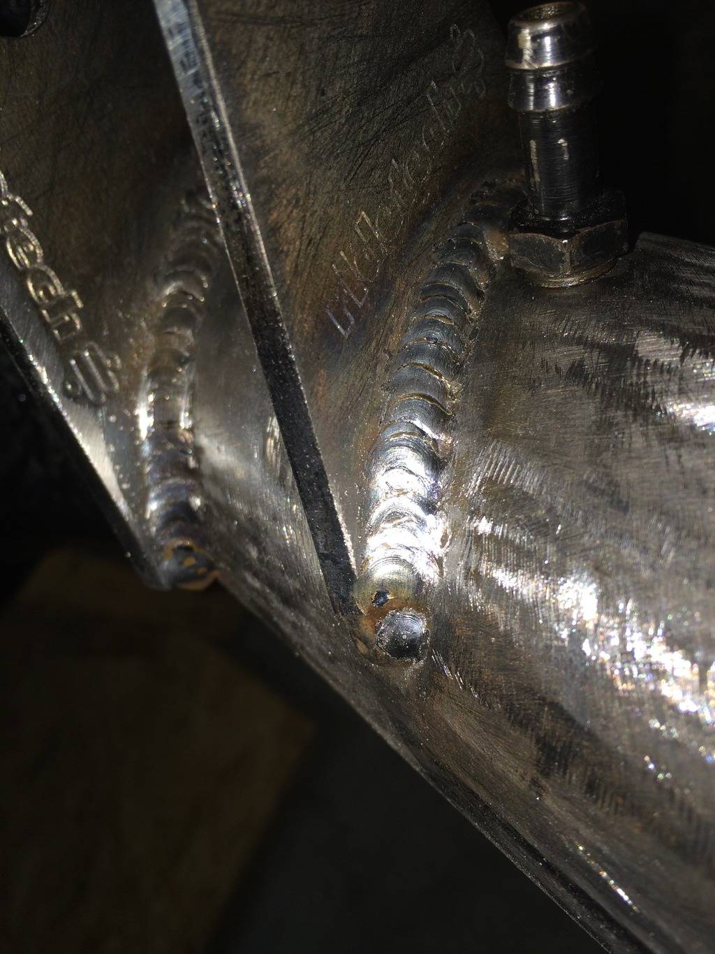

      Then I welded on my lower control arm brackets.
      And upper brackets.
      I used my eastwood 135 welder for this. I turned it all the way up. I am rusty at welding and not super happy with my welds as far as looks but I don't think these brackets are coming off. Good thing they are under the car.
