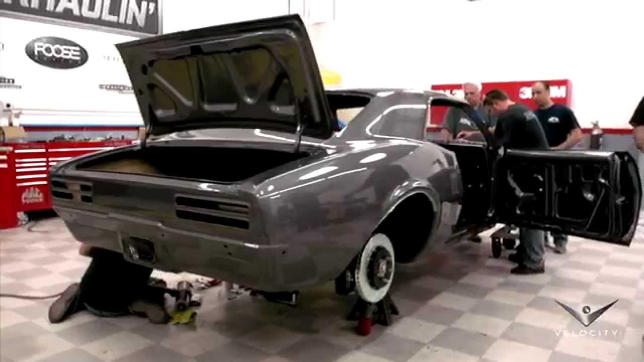

      Pretty sure they do work, I recall Foose using a 69 tank on a 67-68 in the last season just for that reason.

      Don't know if OP was planning a bolt in deal or not, but yeah, like most things it might take some custom work. But you'd be in the area filling the original filler hole anyways. Can't the filler neck on the 69 unit be dropped or modified at all?
      The car I remember on Overhaulin was Dan's 67 Firebird from the last season, maybe you can find it on youtube or something.
