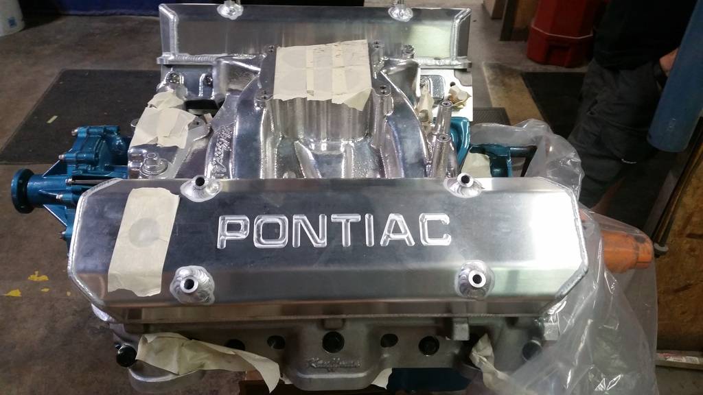

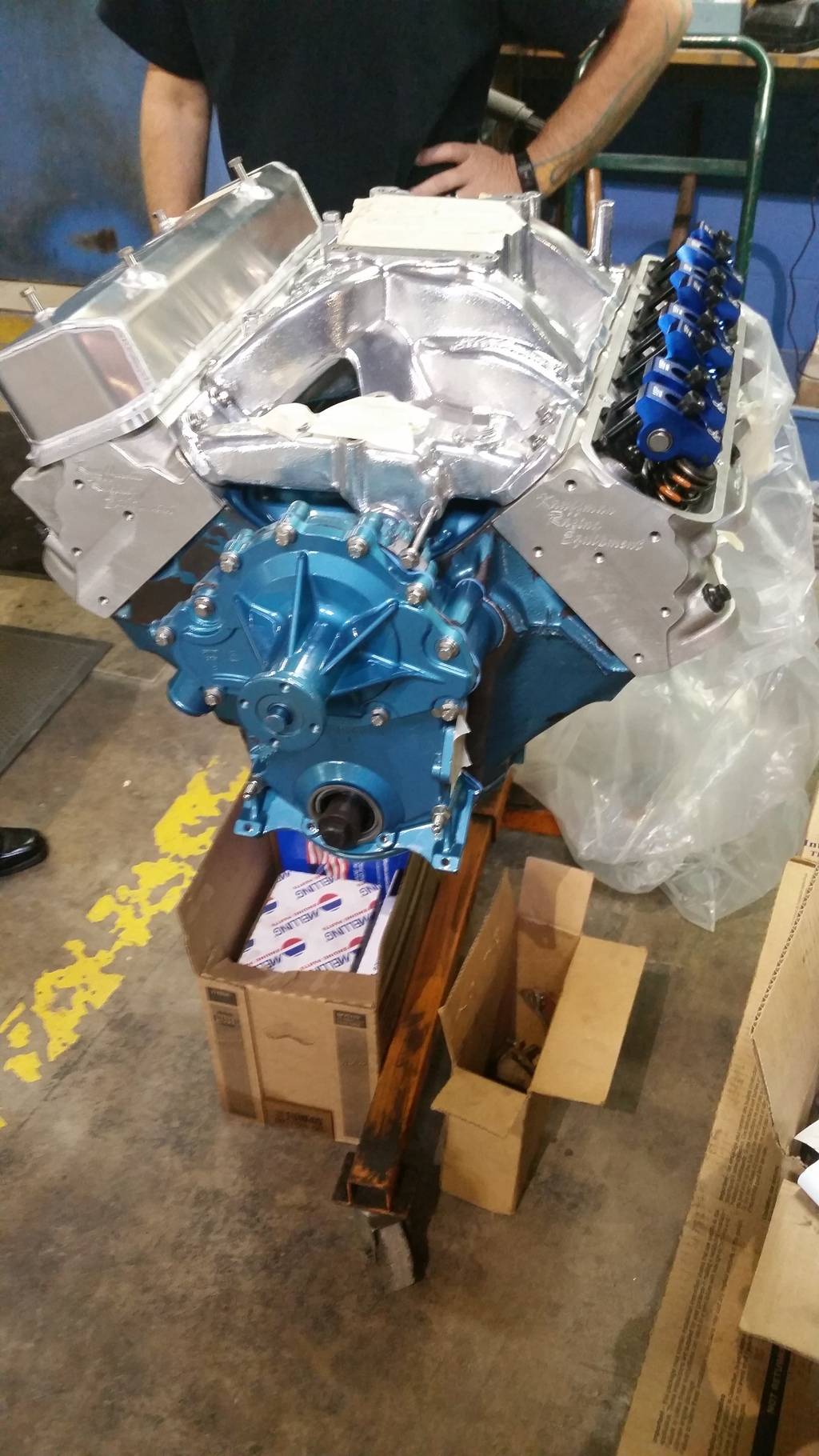

      Stopped off at the shop to see my engine and car. The engine needs the accessories put on and dropped in and will be ready to enjoy.

      Sweet! Glad you started a build thread!

      Very nice!

      nice! cool that you're staying pontiac powered.

      Thanks, I just couldn't get myself to swap to an LS after I blew the previous build so I decided to bore it more and keep it stroked.

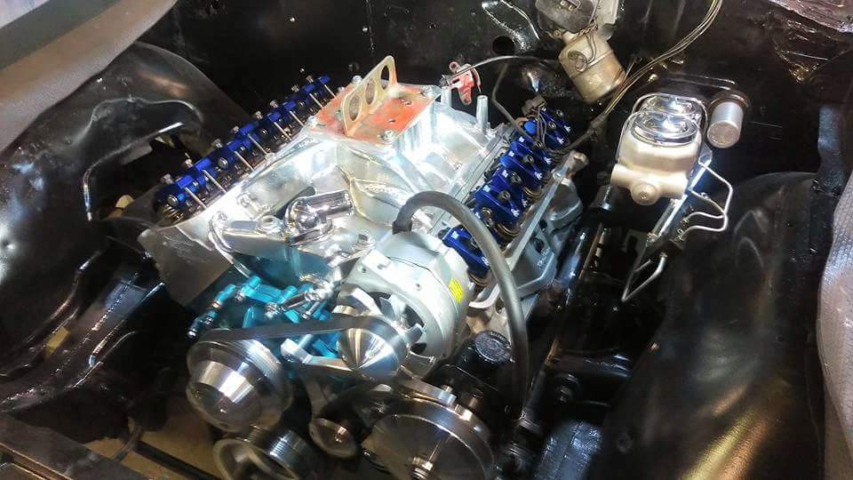

      Quick update: Engine is getting dropped in this week!

      Sweet engine setup!

      Thanks, it was red before. Had new thinking it was a Chevy engine for a minute till I looked at the casting codes.

      Thanks, it was red before. Had new thinking it was a Chevy engine for a minute till I looked at the casting codes. Installed the March Performance serpentine belt conversion on today. One step closer!

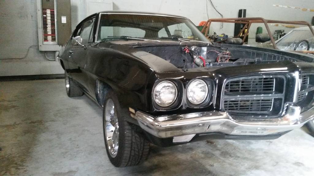

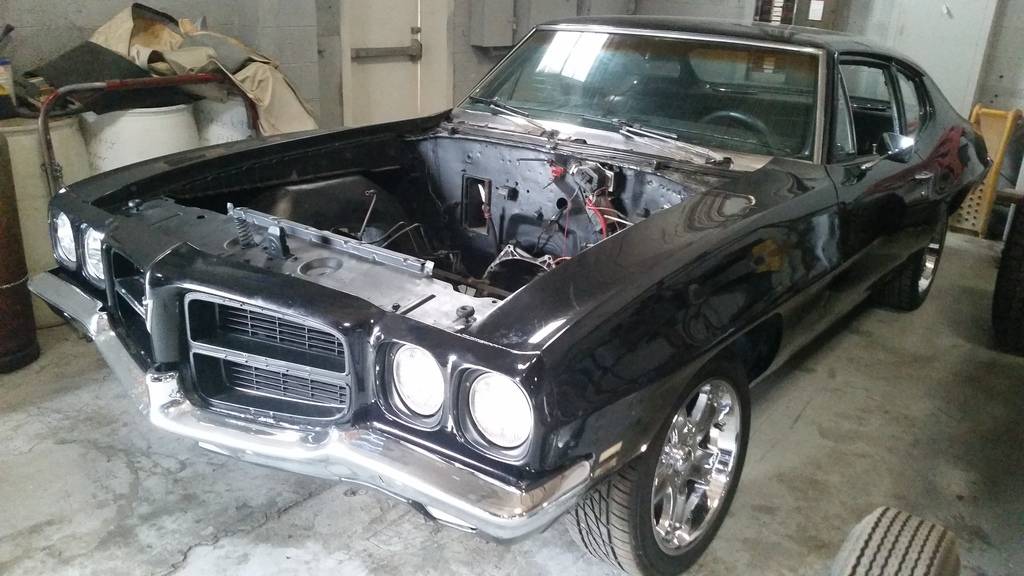

      The engine is dropped in and close to running again.

      man thats sounds good, make me miss my pontiac

      Thanks, I'm really looking forward to cruising in it. Sin very soon.
