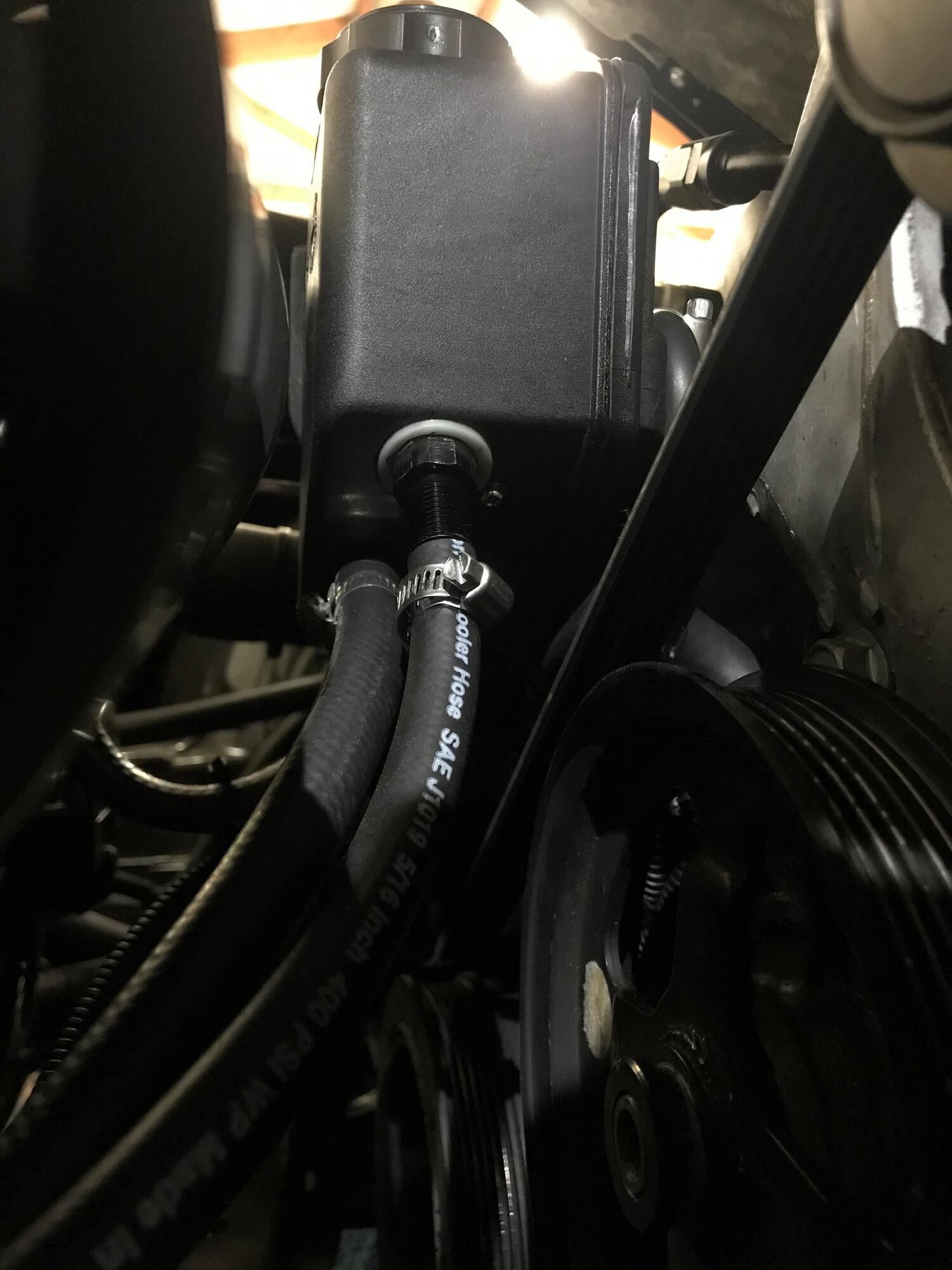

      After quite a bit of work I got my 69 Firebird (LS3) back on the road. One of the modifications I did while she was down was to try and fix this RIDICULOUSLY ANNOYING power steering whine cause by the hydraboost / pump setup. Using a factory LS3 reservoir, I did away with the T-fitting and plumbed a separate return back to the reservoir and installed a new vented cap just in case (after a few hours of running, it hasn't leaked yet). Unfortunately after spending over $100+ on basic hose (thanks Biden & Co.), $20 in fittings and $20 on a new cap, this had absolutely no effect. Since this thread appears to be one of the more comprehensive ones on the topic, I'm just posting this update here in hopes this will help someone. I also had a conversation with the Hydraboost guys a few months back, and am posting my notes below, as I don't really see them posting here anymore. At this point in time, I am still without a fix, but need to resolve this one as the whine is ATROCIOUS.
      Notes from convo with Hydraboost - things to check if you have this issue. Note that these are just notes of my conversation - not necessarily solutions:
      --If you have a remove reservoir, make sure your cap is vented. I believe most factory ones are. My old one appeared to not be, so I replaced it just in case.
      --Some aftermarket pumps flow at 3 GPM, which churn/aerate the fluid and create pump noise.
      ----As mentioned herein, unscrew the pump outlet fitting on your pump and you'll see a hole in the venturi at the discharge of the pump, which regulates the outlet flow. Ideally the size of this hole should be between 1/8" and 9/64" OD (you can use a drill bit to check the size). If the reservoir is a 1/2 quart, the hole can be 1/8"; if it's a 3/4 quart, the hole can be as large as 9/64".
      ----You can procure a different fitting (I don't recall from where) if you feel you need to change the size.
      --They recommend a synthetic fluid (red line, royal purple, valvoline).
      --Temperatures - you can check the temp if you're inclined. The temp should roughly match the water temp.
      FYI, after this convo, I measured the size of the hole in my fitting and it was 1/8".
      I guess my next steps in order of cost are:
      --Change to a synthetic fluid (as of right now I just have a hodge podge of Oreily's stuff in there from over the years). What's the easiest method to drain the fluid? Is there a drain on the gear box?
      --Send the pump off to be modded with a different (smaller?) pulley. To me, this seems counter-intuitive relative to HydraBoost's comments, as a smaller pulley will result in a higher RPM = more flow. I have a lathe, so I might consider whipping up a new fitting if I think this would help. Larger hole would yield less flow (at higher pressure?).
      --Install a larger reservoir.
      Pic of modified reservoir for reference (apologies for size):
      Name:  Power Steering Reservoir.jpg

      With both of those return lines beside each other I’m not sure you will get the desired result. CVF Racing has a remote reservoir with separated returns.

      Just to clarify Dons post. The CVF Racing reservoir is a steaming pile of garbage. https://support.cvfracing.com/hc/en-...kaAu0ZEALw_wcB
      The Concept 1 reservoir Don linked is a much better design, just be sure to use the lower return for the steering and the upper for the Hydroboost.
      I have had good results with the Holley Reservoir and it is far better engineered than both but not as pretty as the concept 1.
      I vacuum bleed every power steering system, hydroboost or not.

      I may have to try and Concept 1 reservoir. What issues could there be with my current reservoir? The Concept 1 just looks like it has both returns in the same proximity with no baffling in between.
