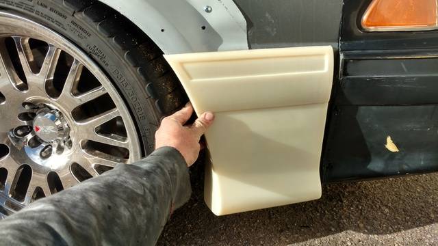

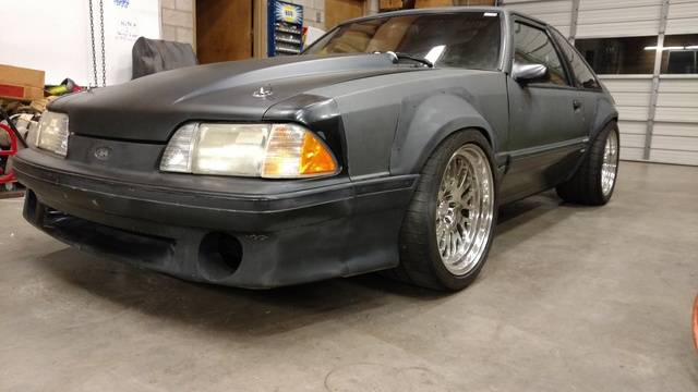

      So, I had plenty of other things I should have been doing... but I had received the "93 Cobra" style bumper extensions from Cervinis, and couldn't stand knowing that they were in a box.

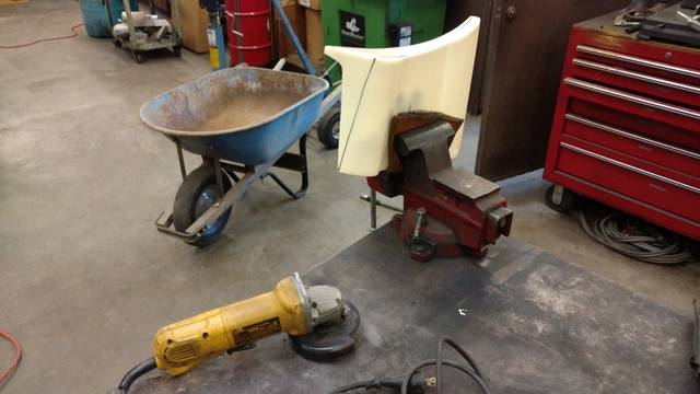

      Due to the fenders being pulled and the fiberglass flares, these were not at all a direct fit. I had to take a cutoff wheel to these BRAND NEW bumper extensions, and I can honestly say I was more reluctant to make the first cut than I was when I cut the rear quarter panels. (ridiculous I know.)
      Surgery required to fit the extensions.
      The official point when I couldn't stand how many colors I was seeing on this poor turd. The bolts visible on the bumper extensions were necessary because of how the pieces needed to twist. They come from Cervini's with adhesive tape that was not going to cut it. I'll look at doing some more tidy options for finial mounting, but the less than tidy bolts will at least keep me moving.
      When I called it quits for the night, I was down to 3 colors on the car... 4 if you count the rust!

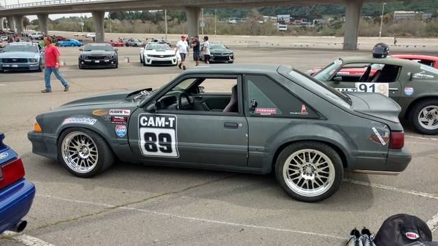

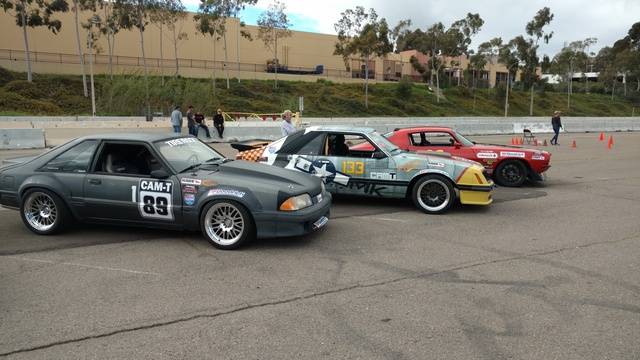

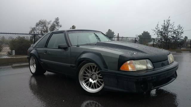

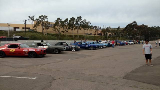

      Poser pic (really cool to me since this is exactly what I pictured when I thought, " fox mustang autocross " from the start.) from a little rainy day shake down run before CAM Challenge:

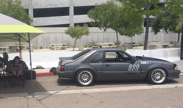

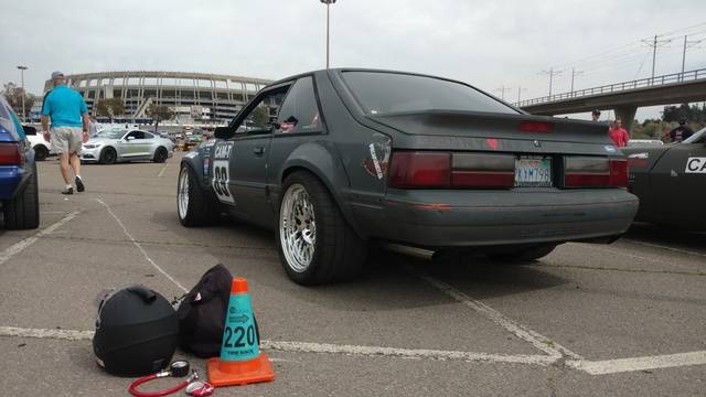

      All "mandatory" stickered up for the 2017 CAM Challenge West. (ok ok... and a couple that I thought were bitchin.)

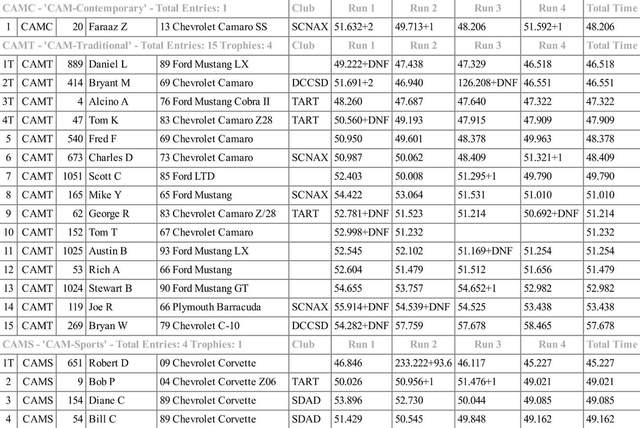

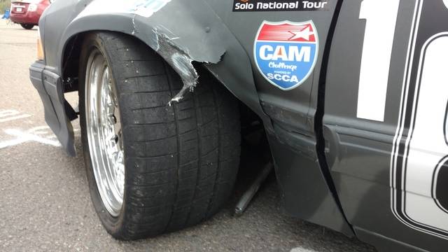

      The event was awesome. Fun course was plenty fast. I think there were 28 drivers in CAM-T alone. AWESOME turnout. I was running well even. I was well into the top 10 in class most the weekend. I was feeling pretty damn proud of my little beater.

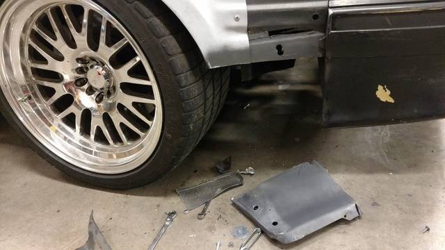

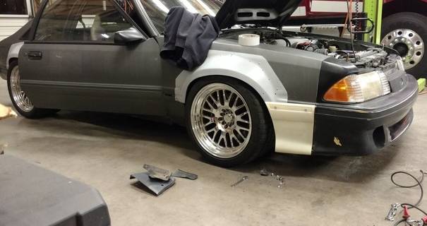

      Naturally, this self-esteem high could not last long. I got paired up against Mary Pozzi in the second round of brackets for the "Challenge". I was excited... but apparently my car was not. I was about 1/3 of the way through my run, feeling great when the car dropped the drivers side lower A-arm up front. An adjustable clevis on the two piece arm broke. Skewered the tire, and took a bite out of my fender and flare. BUMMER.
      So, i'll be revisiting the adjustment in the arm. I'm going to look into replacing the clevis with something more robust, Pics of that whole operation to follow. I'll have a look about for a junkyard fender... so it looks like we'll be adding one more color.

      Damn, that's no bueno! Looking good though
      What wheels are those?
      Feb 2013
      1,557
      Dang man. I bet that was a nice surprise when it happened! If you were closer I have a fender that you could have!

      That sucks- this car was really coming together
      - - - Updated - - -
      Hope you can find another or fix the flare as they really give the car attitude

      It was definitely a less than bitchin' way to end the weekend. The wheels are just cheepo' XXR 531's. 18x11 on all 4.
      Quote Originally Posted by Josh@ridetech View Post
      Thanks Josh. It was a "OH @#$%!!!" moment for sure. I have a fender actually, and I think the flare will be fixable. If I lived closer do you have a set of adjustable resivior coilovers laying around too?

      Thanks for the kind words. I'm actually glad it happened now. I would have been 10x more bummed if I had spent all the time blending flares for this to happen! I was already considering making molds of the finished flares to create one piece fiberglass fenders and quarter panels. Its making even more sense to do so now.

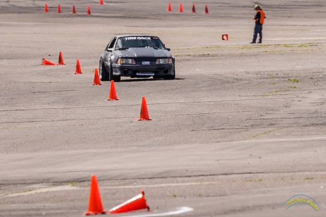

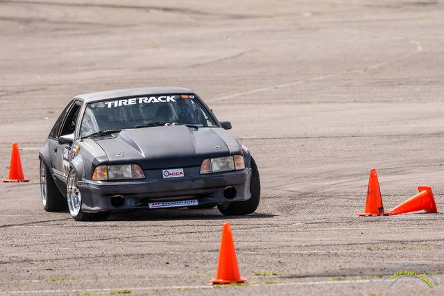

      Lateapexphoto.com posted some pretty damn cool action shots. (none of the car eating itself unfortunately!)

      Love this shot!
      lol, I can't say that I do... but I know a place that does!!

      Love this shot!
      ME TOO! Looks tough as could be.

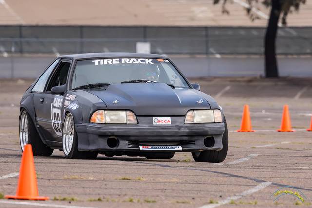

      I finally got the car back together and made it out for some racing... and was rewarded with my first win! 1st place in class out of 15 cars! I think its heading in the right direction. I'll be getting back to pecking at the body/paint idea next as long as this thing stays raceable.

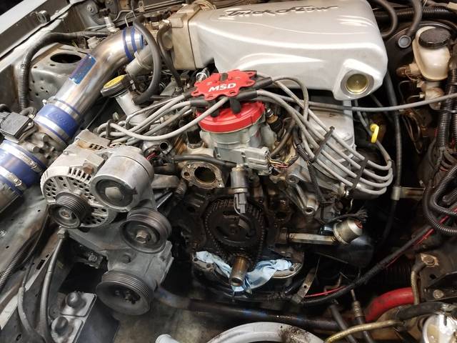

      I went to unload the car from the trailer after racing to find a puddle. I've had a slowly worsening leak from the timing chain cover that I had been putting off. It was more of a "wetness" than a leak, and well... its not fun to wrench when its not making anything faster or cooler looking.
      The puddle was enough. Don't wanna be "that guy" who's car leaks everywhere...
      I'm going to do some more clean up while i'm in here. Install some mechanical autometers that I scored a few weeks back. Maybe i'll even paint up what I can reach and add some fancy pants stainless hardware?

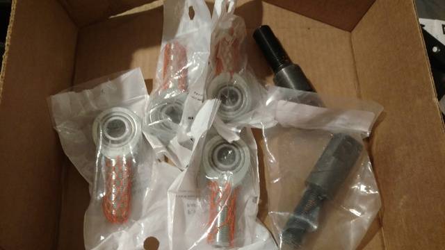

      More than a month later... have not TOUCHED the poor thing. I did get some goodies in the mail a few days ago.
      Some of FK's finest heims, and the most beefy clevis joints I could find. I was hoping for 4130, but could not find them anywhere. These clevis joints are at least bigger than what I broke.
      Hoping to be racing again June 4... cross your fingers for me.

      Bummer on the fender and broken parts. That fender looks like it would straighten out pretty easily if you took it off of the car. The car is looking great!
