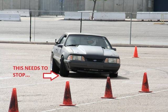

      My buddy stuck a camera on the side of my last weekend too. He just sent me the footage... I decided to share it even if its totally self incriminating. NEW. GUY. DRIVER. The video has been very helpful to me actually.

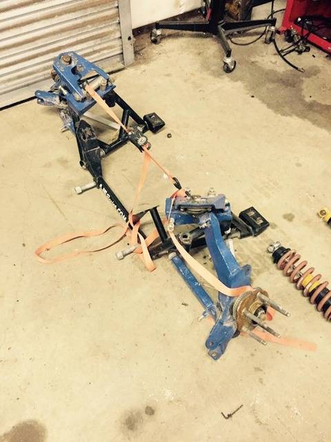

      I should wait until its acutally on the floor of my shop, but I can't contain myself. My turd of a go-fast car has some parts enroute. For all that are unfamiliar, the fox mustang is based on a VERY outdated strut design that does this:
      under hard cornering.

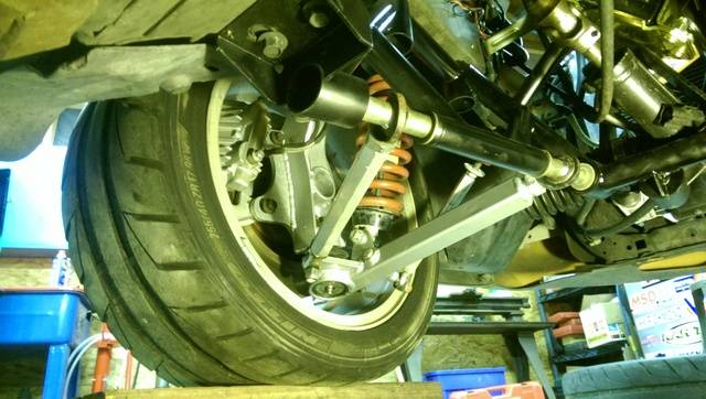

      For a VERY fair price, i've just aquired a BartsWorks SLA front end with coilovers for the front of this rustang. Fixed Camber curve, lower roll center, etc...
      Can't Fing WAIT.

      I had the opportunity to bounce a bunch of questions off the designer of this suspension. He was a huge help. The K member (the only part that is not of his design) he actually warned against. The SLA parts were meant for the factory geometry K member. If the AJE one does not measure up I may be skipping it. As far as the Griggs stuff being certified for street, I dunno honestly. I haven't seen any of the major manufactures toting their stuff as "certified for the street" though. I would have been ecstatic to get ahold of ANY of the available SLA front ends for my car be it Barts Works, Griggs, Agent 47 or other. This one just happened to fit my budget.

      Out of curiosity, what brake set up are you going to be able to or have to run with the SLA? I guess, specifically what size rotor and what calipers fit the spindles?

      Luckily, this kit uses a, sn95 hub. So, all my sn95 cobra brake parts are a direct fit.

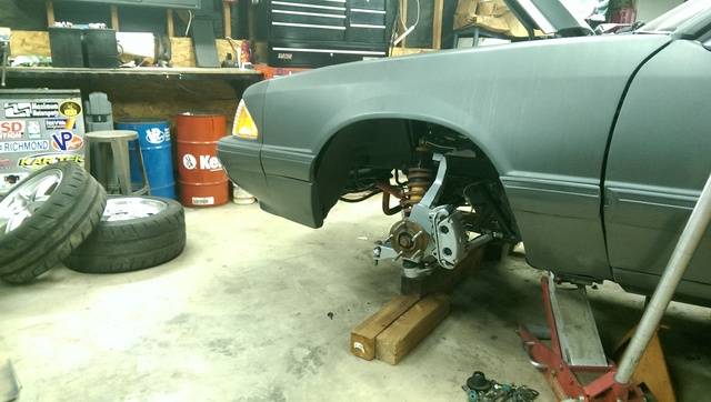

      Quick question, I picked up a 89 crossmember from pick a parts the last 50% off day and grabbed some 94 spindles too, I was going to go with the 89 LCA but was looking at the later arms and noticed they were a bit longer, did you have any trouble getting enough adjustment from the struts to make them work? On my Mullet Truck the Mustang front end is already 10 inches wider than stock but was wondering if you felt a big difference with the arm swap?
      Were you able to go wider on the wheels too? Im hoping to go with the Cobra knockoff 9 inch on the front, Think its possible?
      Also, where will the autocross be on the 31st?
      Thanks!

      Its hard to say if I felt a difference in the wider front as I changed just about everything else at the same time. I did have to use Maximum Motorsports CC plates to get the alignment in check though.
      I'm running 17x8's in the front but only cause I got them for free. My rear wheels are 17x9 with 275s. I tried them up front today just for grins. They'd fit just fine if I pulled my fenders a bit more.
      The autocross i'm shooting for is at Qualcomm stadium.

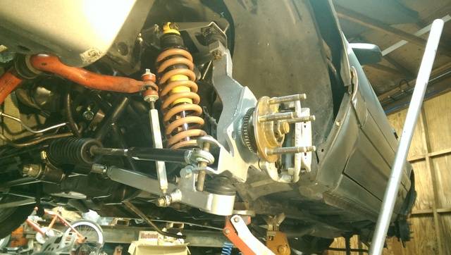

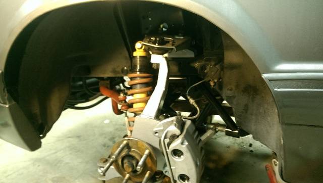

      I got the front end all bolted up today. I found some small hangups.
      *Driveshaft will need cut down a bit.
      *I'll need to move the swaybar mounting brackets forward a bit.
      *Exhaust will need shortened to accommodate engine setback.
      *My heim joint rod ends are the wrong size for the new spindles.
      Here's where I left off today:

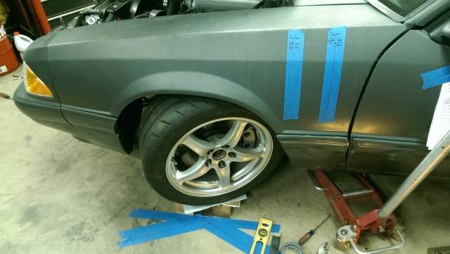

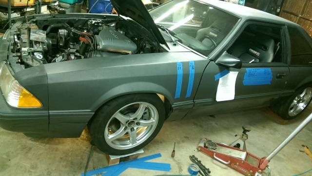

      It's back on its wheels.
      I tried the 20* in 20* out method of measuring caster, but I was getting suspicious results.
      I was getting 1* negative when it was visibly more than that?
      Luckily, there is a flat spot on the spindle upright that is damn near perfect parallel with the upper and lower ball joint at ride height. I used that to get me at least even side to side, and ballpark to the -6* I was shooting for.
      Still waiting to hear from my drive shaft shop. Cross yours fingers for me that they come through... It'll be tough to go racing if they don't.
