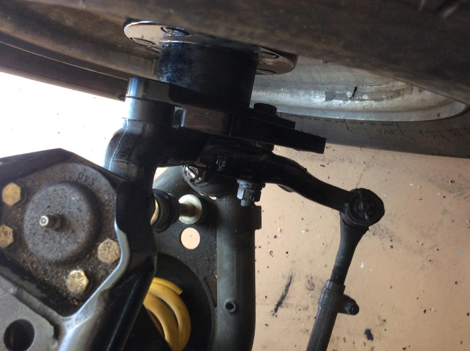

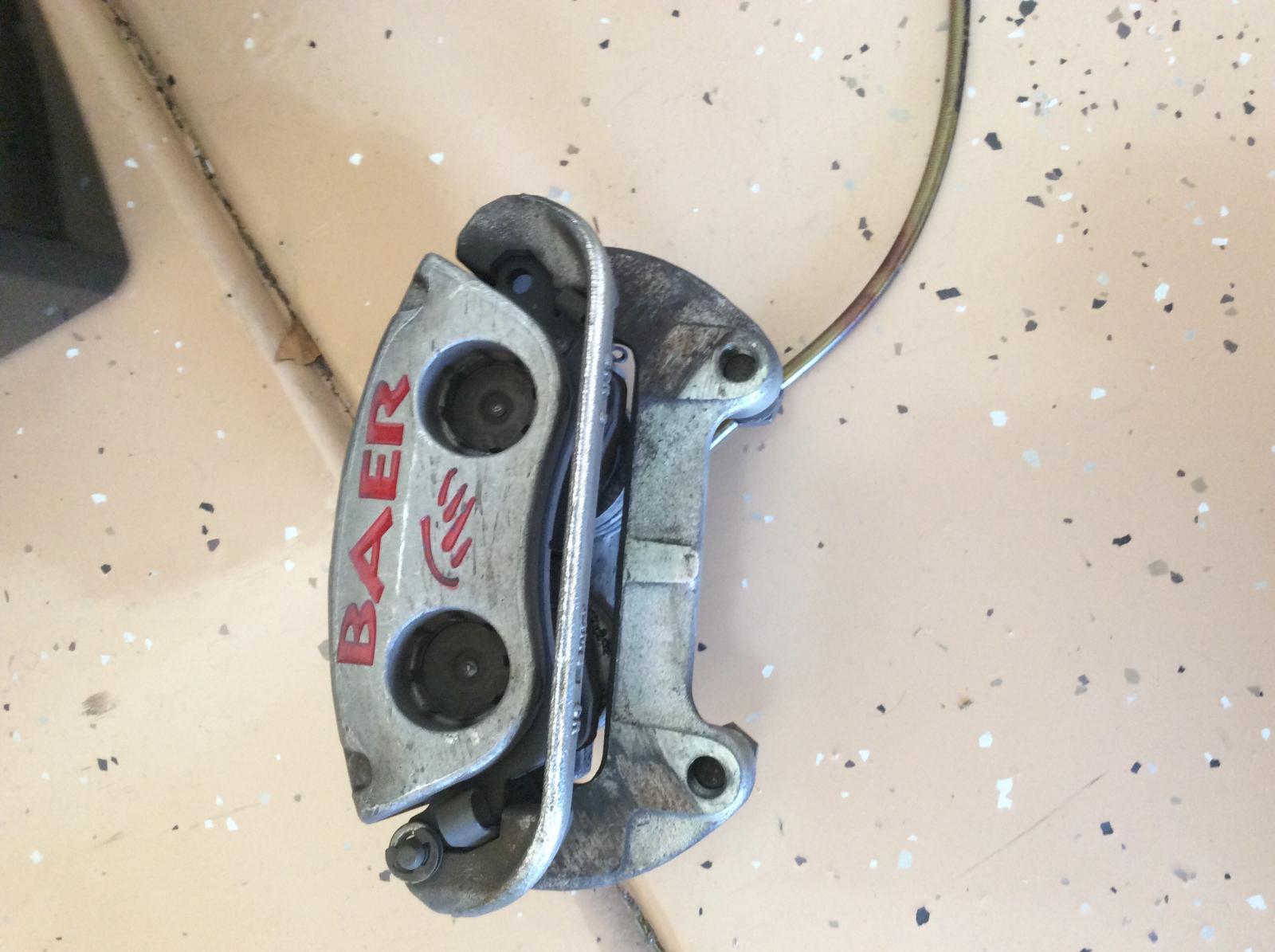

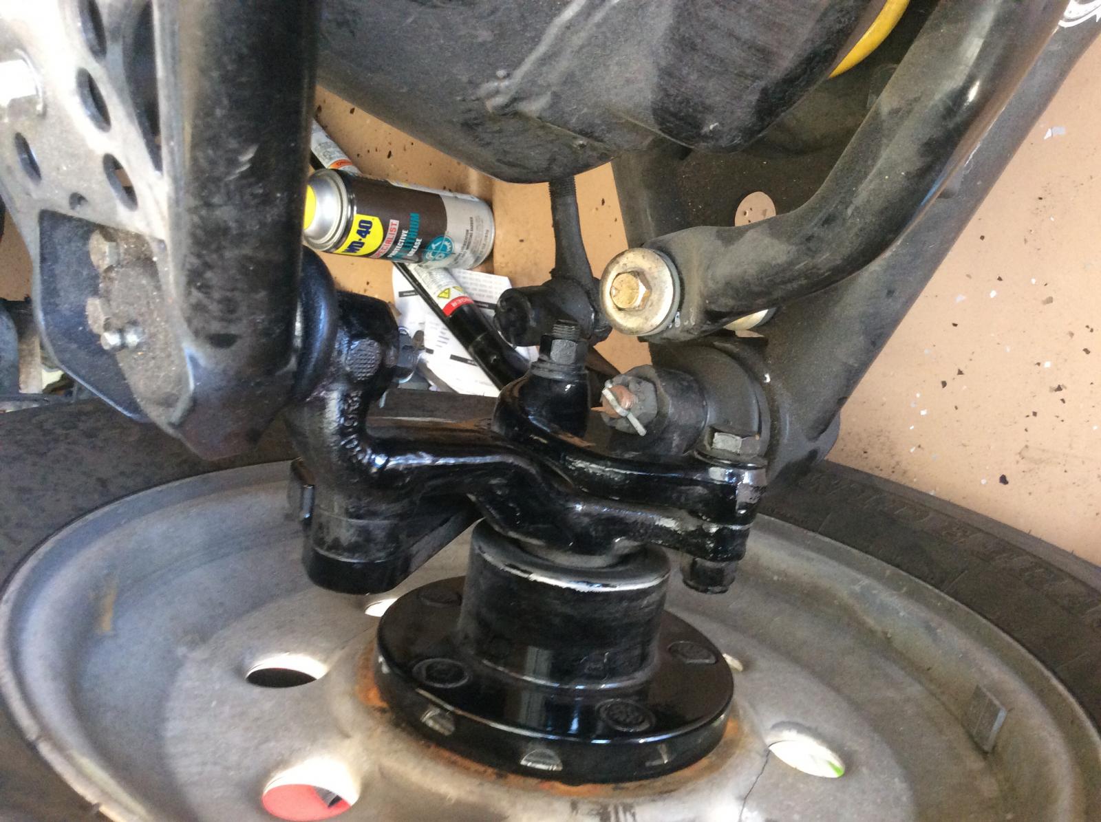

      I purchased a subframe with a DSE speed kit 3 installed on it with all the steering components and Baer brakes. My question is can anyone help me out and confirm if these are C 5/6 spindles or something different? Also which Baer brakes are these.

      Stock F body spindles it looks like.
      Baer stuff, I don't know what kit that is, but it looks like the PBR caliper.

      Those calipers look like Baer Tracker calipers, C4 corvette style.

      F-Body spindles. Does it have coil springs? Can't tell for sure in the pictures. DSE Speed Kit 2 & 3 are both coilover. Can't help you identify the Baer components.

      '68 firebird DSE speed kit
      Yes it does have coil overs. I will post pics of the rotors when I get home from work. Thanks!
