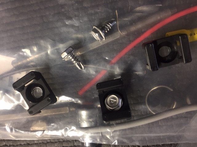

      Some terminal covers for the positive cabling, I didn't like the live wires being exposed.
      Have a cover for the junction panel that I'm going to cover up.
      https://www.summitracing.com/search/...terminal-boots

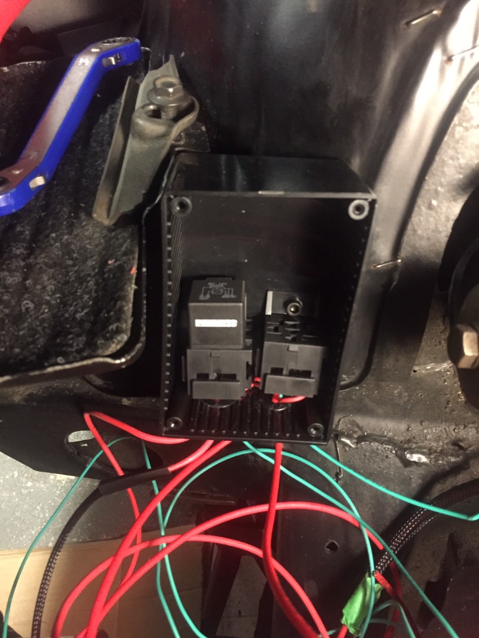

      Cheapo plastic electrical box with cover for the relays.

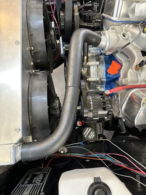

      On the hose side of things. I was going to use a 69 Bronco upper hose but it was a bit short and I didn't like the look of it stretched.
      The 2nd option turned out a bit better. It's the lower hose from a (01-07) Toyota Sequoia with a 4.7L. The length and bends were close. I had to cut the center and turn the hose about 90* to make everything line up. I've ordered some aluminum tubing from Speedway to tie the two pieces back together.
      The lower was a bit easier. It's from a 94-04 V6 Mustang.
