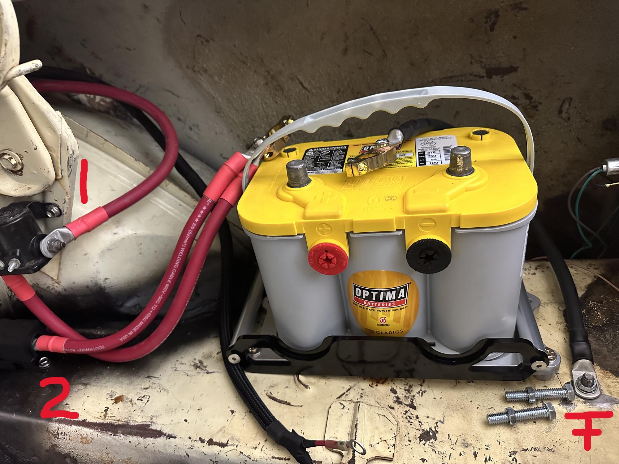

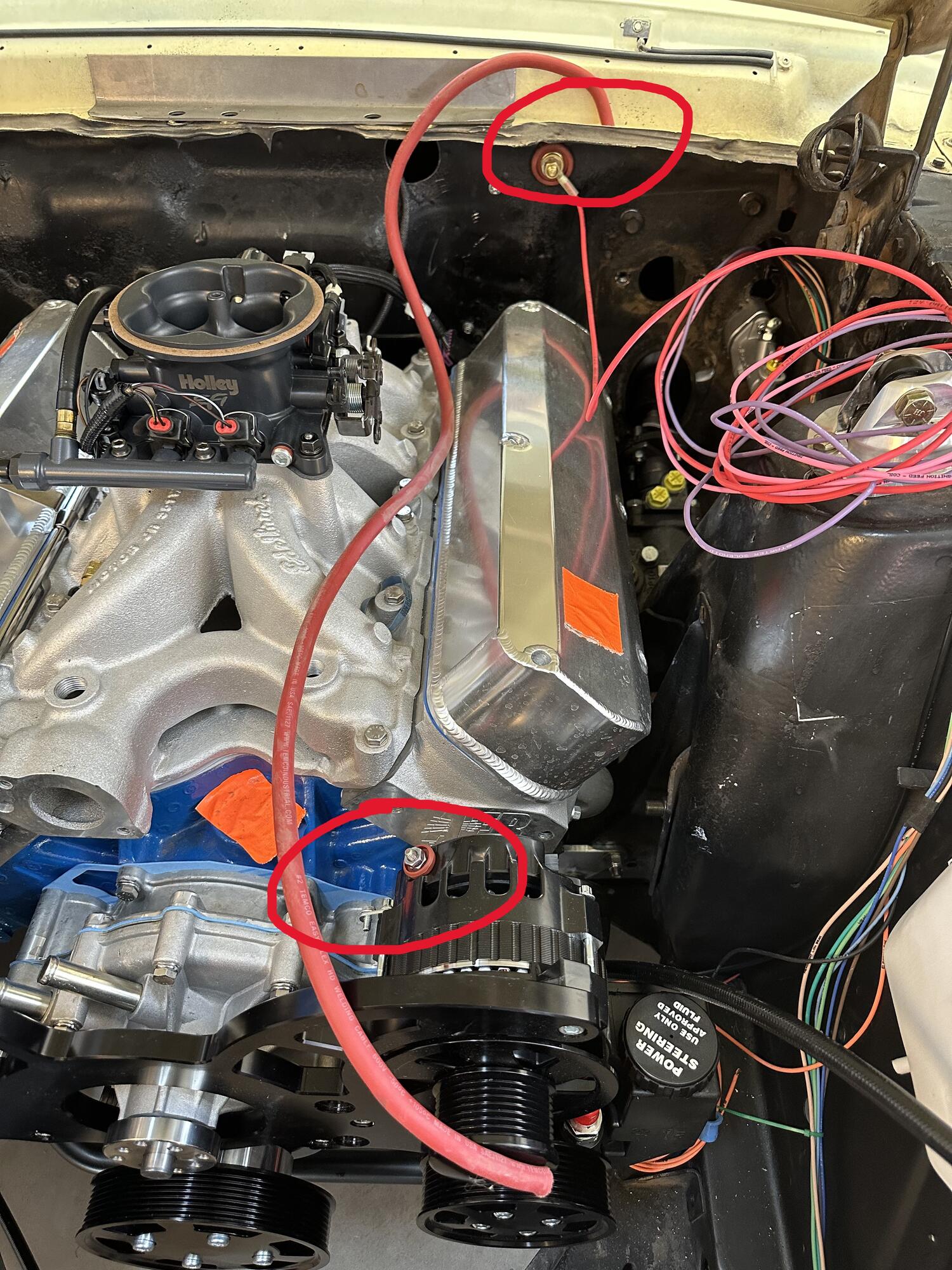

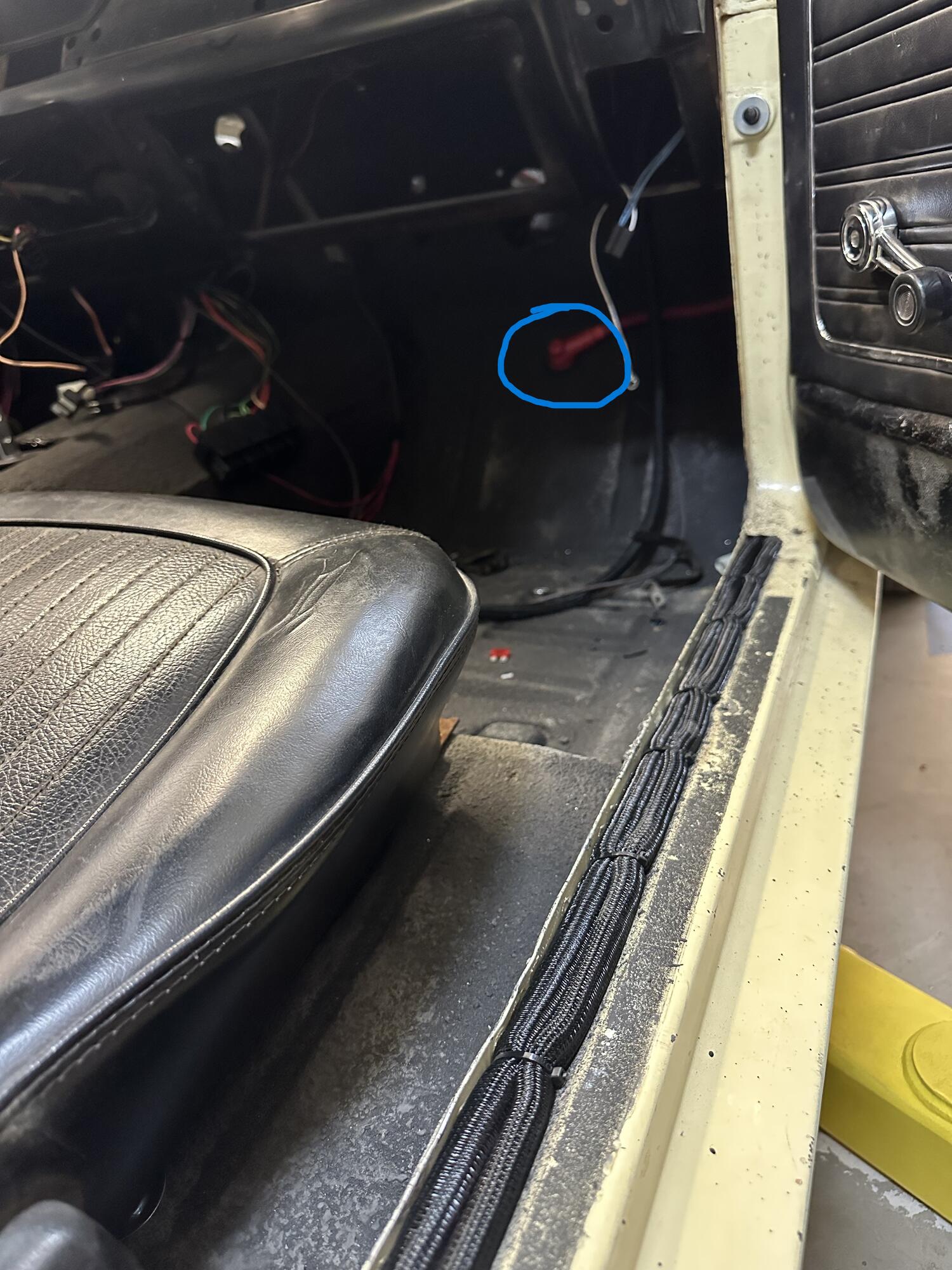

      Quote Originally Posted by chunger View Post
      Could you show more of your battery wiring? I'm thinking of also moving the battery to the trunk and I'd like to see what you did here. Did you relocate the solenoid to the trunk and extend the wires? I see two fat red cable running forward. Assume one is the charge wire from the alternator (3g?) and the other runs to the starter, is this right?
      Ok. Battery location and #1 goes to starter via a bulkhead on the passenger side of the firewall. #2 is the fused feed to the main power to the engine compartment and interior. the ground cable is attached to a weld-in stud on the trunk floor to the right of the battery. The loomed wires coming out of the quarter and sitting along the bottom of the battery are the efi feeds.
      Here you can see the 2ga wire leaving the fuse and it runs up the driver's side rocker to a bulkhead just above the master cylinder. I'm actually in the process now of running the extended starter solenoid wire. It ran down the passenger rocker and will be zip tied to the 2ga primary wire that is held in with clamps to the bottom of the package tray.
      I've circled the 'starter' bulkhead. The 2/0 starter cable and the dedicated + and - feed for the efi run along the rocker channel in the bottom of the pic.
      Here's a rough idea of how the alt wire will be ran. The bulkhead is circled on the firewall. That will be my primary feed for the alternator and anything else in the engine bay that needs 12v constant. I'll measure and put proper terminals on the wire once I get closer to cleaning up all of the other wiring.
      Kris - Building the poor man's '68 Mustang.
