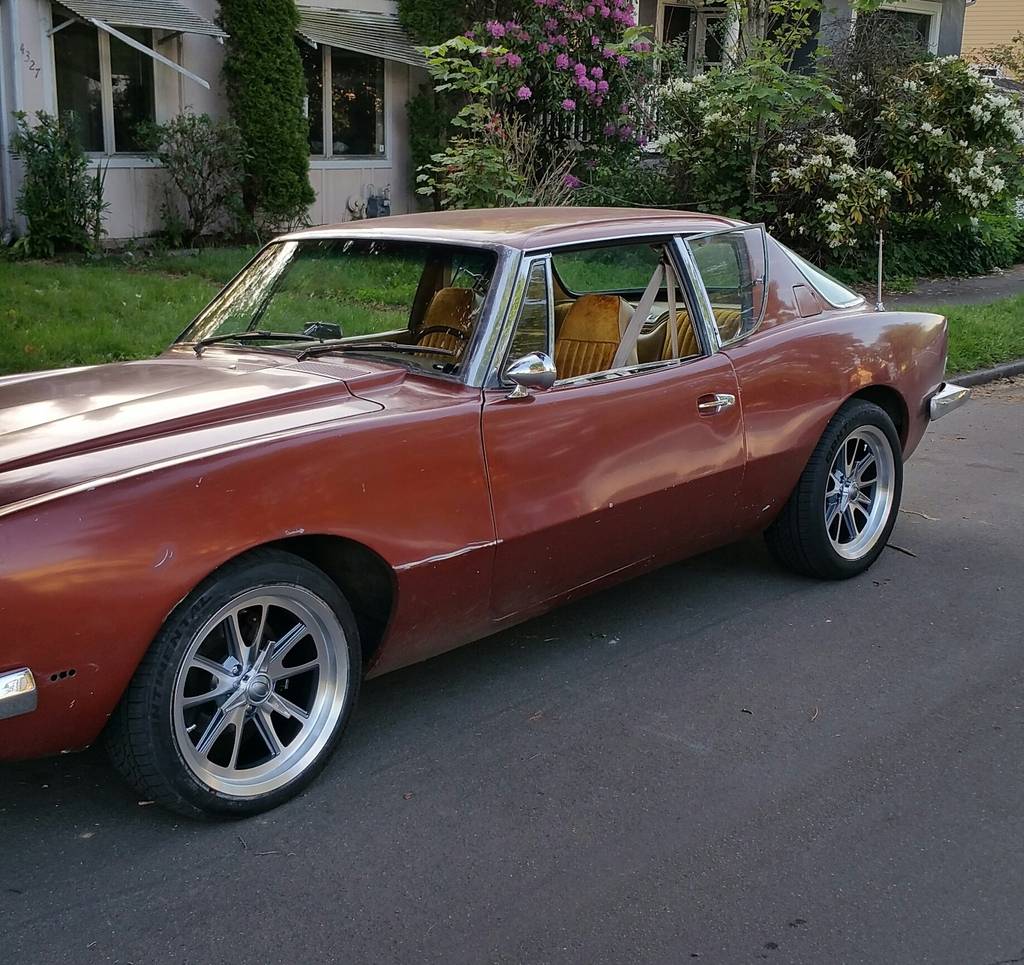

      So after shaving 1/4inch of the inner fender lip, and rasing the car an inch up front and rear i was able to fit 18x8 with 4.75 back space up front and 18x8 and 5 inch back space Out back (which required milling the rears 1/4 inch of mounting face) .. really wanted 18x9 out back but without serious investment it wasnt possible.

      I like it. Not sure how much it moves on the suspension but that is waaay more clearance than several late model cars have off the showroom floor. Not sure whether you are chasing a specific look where the rears stay within the body line or why you had to "tweak" the rears as you describe.
      To me, to get the look I like, I'd go two sizes wider tire on the front, and a small spacer behind the front wheels... get the relationship to the front fender lip and to the rear tire width right.

      I had the car an inch lower But I had to raise it and shave a 1/8th off the inner fender lip to get from and rear to clear with the spring rates i have and not hit the front of the front fender when turning. I would love both to tuck more and have a little more tire too, but this was a compromise.
      The studebaker chasis is hard to get stuff to fit for sure
      The car is overall an inch and a have lower than stock. If i get it lower with stiffer springs front and leafs in rear i.may be able to get it a little closer, i am also considering flairing the fenders...
      It does ride and handle 10 times better with with ive done suspension and tire/wheel wise. So im pretty happy!
