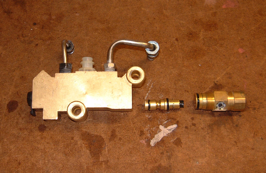

      Sorry guys, I think I am overthinking this way too much. I've looked up a valve that I had laying around my garage and it is listed as disc/drum, but used in popular disc/disc kits. So I undid the plug on the rear of the valve to dissect it, and it looks like this picture except not taken apart. So should I just put this valve in, and if needed add an adjustable down the road?

      Is that a prop valve built in or just the plunger for the brake warning switch?

      Its just the plunger and that piece isn't supposed to come out like it did in the picture.
      I bought the wilwood combination valve with the adjustable for the rear but don't want to have to redo my lines for that. Unlike the older cars the gbodies have a frame mounted prop valve and the lines aren't even close to the wilwood
      Today I just bought a cheap summit unit I guess I'm going to run the valve like the picture above and plumb in this adjustable one and see what happens

      The combination valves based on the 1971-1977 GM units are available in either disc/drum or disc/disc variations. Both units have fixed proportioning valves in the rear circuit, so if that's what you're going to run, then do not run another proportioning valve. You never want two proportioning valves in any given brake circuit, as the results can be no bueno and unpredictable.
