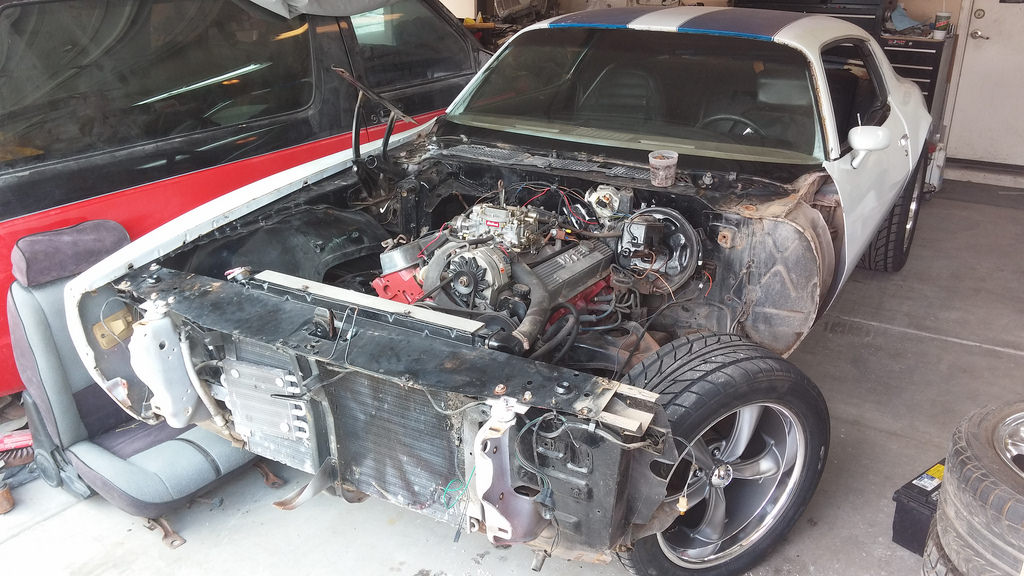

      As I drug it home. All the front end is missing is the A/C compressor. Why it sits like a 4x4, I don't know. The undersized tires don't help either.

      Anyways, the Buick GS was away getting sprayed this weekend, so I actually had time to work on other stuff. This weekend I decided I wanted to remedy the 4x4 stance situation because even with just doing bodywork, I couldn't stand the "engineless" stance this car had. My plan was to just cut a coil since a suspension upgrade will come in the future... but after this weekend, I'll need to figure out something sooner, because I don't think I even want to drive this car to the mailbox after my findings!
      Press in bushings should just fall out, should they?
      In addition, the RH rear LCA mount to frame weld was broken for a good 4 inches or so. Brakes were badly pitted. Steering slop was just horrible. On top of the rear springs that appear to be missing leaves (Thanks Alponcho for the springs btw!) which have a sharp kink where they appear to have been heated and re-arced, this car is completely unsafe to drive. The springs were way taller than any 2nd gen F-body spring I remember as well, so who knows what they are.
      So yeah, I won't be driving this car in progress. Actually I'll be researching suspension options now, and potentially buying parts in the next few weeks. I like DSE, but the ridetech is priced a little more attractively, and I'll use their coilovers either way. The rearend I'll probably leave as leaf for a bit till I do the minitubs and decide on a setup for that, but once again I like the cost of the ridetech setup. I'll have to see what others are running and what's competitive.
      Anyways, I ended up chopping 1.25 coils out. Not the ultimate stance I'd want, but I wanted to stay conservative for the 1st cut, which was pretty much on the money. The offset on these Boss 338's weren't ideal for the front, they would have hit if I went much lower. Luckily these are only borrowed from my S10.
      The car came with nice T/A fenders that I'm taking to the blasters to have stripped. They are completely rust free, so once I work the dents out they'll be perfect.
      I'm going to keep at the bodywork for a bit, assess what I need, and just make the car look better as I'm deciding on the chassis. I'll get the fenders worked, then when I take the front clip off, I'll probably get the doors stripped, and rebuild the hinges so I can work my way forward to get everything fit well. I've already determined I need at least the RH fenderwell (cut for blower motor access), and a core support. They'll work for now, but I'll be stripping the subframe down soon to reweld everything and powdercoat, before bolting on new suspension in the near future.

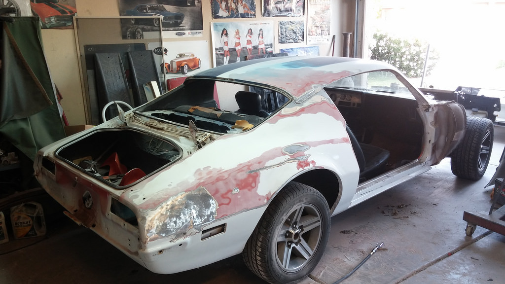

      Progress has been slow the last few months, with helping my dad on his 68 GS350, and other stuff. Finally getting back to the Bird, along with other projects (my 87 S10 Blazer V8 swap, and a newly acquired 63 Thunderbird). Right into the heat of the summer too, 108 last weekend.
      Got the fenders back a few months ago. Very nice, only needs some dent repair. I've been taking my time and learning better "metal bumping" to minimize the filler I use. They've been sitting cozy in my game room for the last few months.
      Started to disassemble the car and found this surprise. Oh well, it will allow me to build a new custom package tray with better speaker pods and a subwoofer mount.
      Also scored a nice set of black 4th gen Trans am seats at the Del Mar Goodguys for $150. I rode in them for 6 years in my 98 Trans Am, so I know they're comfortable for long trips. The driver's seat bolted in, minus a little clearance needed for the motor. I'll do that down the road.
      Disassembly has begun! The 71 fenders won't be used, and I consider them barely useable period. Inner fenderwells are weak, as well as the core support, which has an OER replacement waiting in my spare bedroom.
      Started paint removal. I knew the right quarter was weak, so I ground that down first.

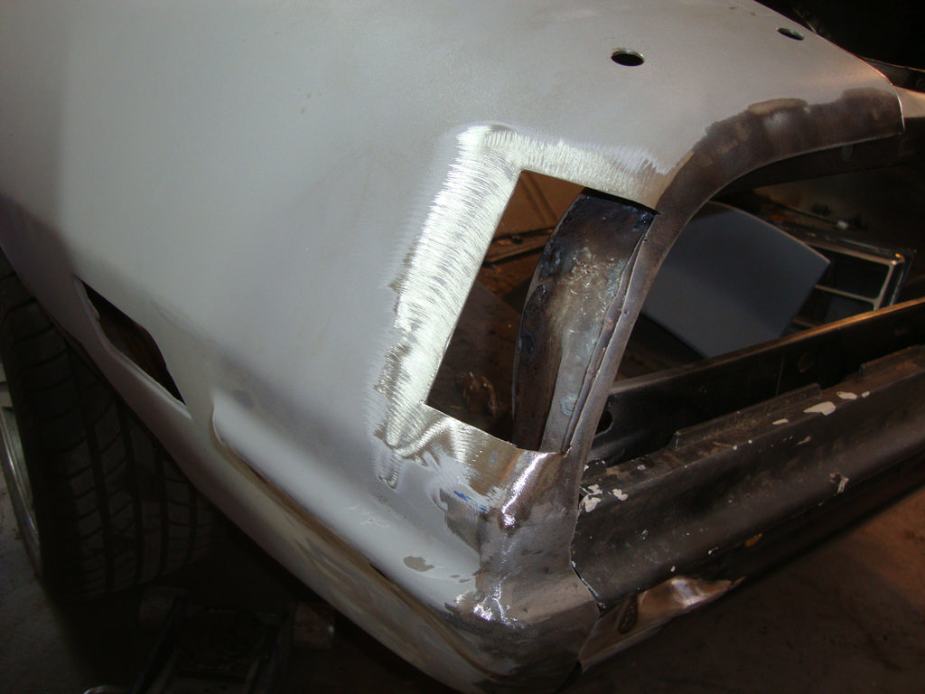

      Nothing too glamorous in shiny parts or money, but still work that needs to be done.
      Finally got the car stripped down to a shell. My neighbors love me, haha.
      Got some of my replacement sheetmetal in, which at least half this picture was a total waste of money.
      Doors are off to the blaster's. The RH door had some damage, that was drilled, and pulled, and was just generally done terribly and wasn't work resaving. So I thought I'd try my hand at re-skinning it.
      Back, and ready for self etching primer, then 2k.
      I was having one heck of a time DA'ing the paint off due to the multiple layers (I count about 9). Then I was doing something, and noticed that the paint nicely shaved off the car using a razor blade! This seems tedious, but it saved me a lot of time and money, seeing as I didn't have to spend $1500 to get it blasted. This shaved off a clearcoat, two whites, and a red layer, leaving a few layers of primer, and a yellow/white layer of paint.
      Scraping another layer of primer off. Thought this was amusing, I've never dealt with with paint that came off so easily!
      Luckily most of the body was decent. A few surprise dents above the windshield, but at least they didn't try and pull them so I can take them out with the stud gun easily. Need to fill the vinyl top holes properly and weld them up.
      Just clamping the new quarter on for grins, and test fitup.
      Found a couple free wrenches in the section I cut out in the LH quarter!
      Cheap alternative to Dynamat! All this came out of the jamb vent hole. They slacked off and only stuffed 3 bags into the RH quarter.
      LH quarter looked pretty good aside from the back edge. I don't want to buy another quarter for this section, so I think I can hammer out a new piece with these compound curves easy enough. Time I've got.
      Welded up the lock hole on the passenger's skin while it was off to make it easier. It was easier, but futile. I was unsure when I got the new skin about it seeming to be a little thin, but I figured it's worth a shot. It went on easy enough for the most part, forward and rear edges looked good, but the lower edge didn't cooperate as well and went on pretty wavy. Then I noticed the lower character line was super faint, not sure if it would have shown up on the car. Then I noticed the weight of the door and my working the edged dented the skin where the stand was. So I contemplated this for 5 minutes, and decided this door is scrap. Located a nice original paint door in Tucson, 1.5 hours from me for $200 and now have that being blasted. I decided that if the door dented that easily, the last thing I wanted was a cone flying up and making it's mark.
      So that's that. Hopefully I'll be able to get the door before the weekend, but maybe not. I have a little more primer to DA off the roof, then the jambs, then I can start getting into actual bodywork. I'm rethinking my idea of replacing the entire RH quarter, just after my experience with the Taiwan metal on the door. I may just do what I didn't want to, and cut out the damaged area and butt-weld the new section in at the back. I think the less thin Taiwanese metal I use, the better. My goal is to have the car painted and mostly done for the Goodguy's Del Mar show next April, and although I won't push the car hard to make it, it would be cool if I can make the Hot Rod Power Fest in Vegas in September. But no rush. I hope to have the main bodywork done in a month, so I can strip the interior and subframe fully, and get the underside, and firewall blasted clean, during that time I'd like to drive to Anvil and pickup a carbon fiber Formula hood. Then DSE minitubs, SFC's, and welding up the subframe, powdercoat, then ridetech suspension install!
