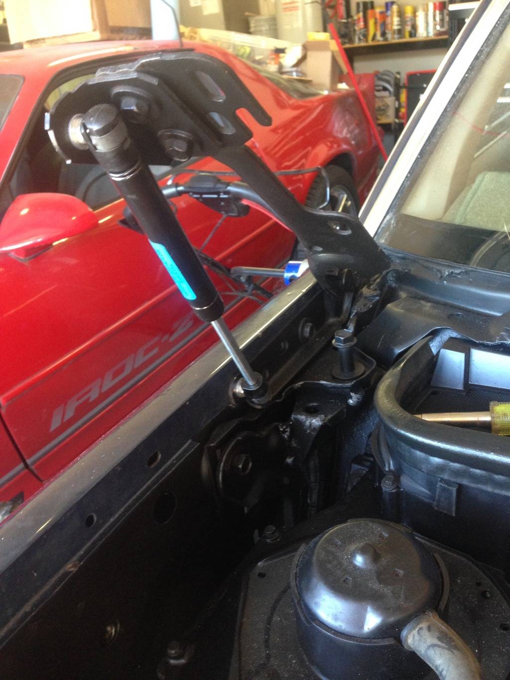

      Like this?
      Phoenix,Arizona
      1,013
      Yes, but on the older style hood hinges from first gen camaros and second gen Novas
      Quote Originally Posted by dynodanmanda79 View Post
      Like this?
      Like this?
      [/URL]
      Old style hinges are 4-bar linkages to swing the rear edge of the hood out and away from the car. You can't lift from the same pivot points because changing the arm length would change the arc of the linkage during hood opening.

      That looks like you are doing this on a G-Body? What parts are you using?

      Quote Originally Posted by JustJohn View Post
      I know it's been done on the old style hinges before. I've seen pics of it

      Quote Originally Posted by 70TWO NOVA View Post
      I didn't disagree. It just can't be done per the original picture.
