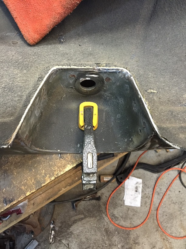

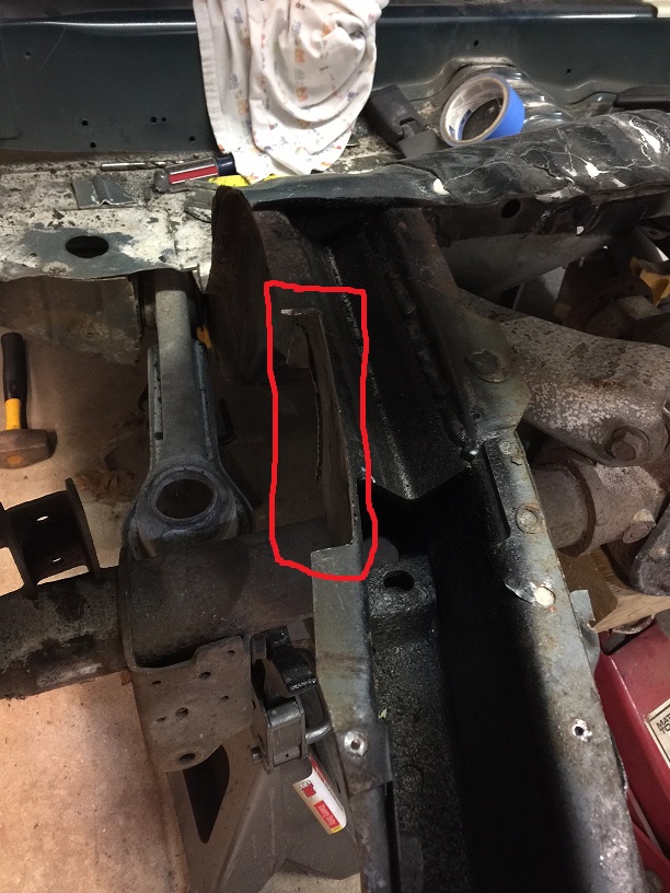

      Measure twice, cut once. Looks like I should have measured 3 times. I tried to mock up the coil overs tonight and It's a lot tighter than I thought it was going to be. I should have went with the next shorter shock. I wanted to try and keep a decent amount of travel, so went with the longer shocks. I was going to keep the shocks below the truck floor but It will need to stick above it a little. The stock shocks mounted a similar way so I am going to try and use the factory hump for some extra space.
      I cut out some of the extra bracing with a cut off wheel for more room.
      Here is the rough cut.

      I also had to cut a notch out of the frame to move the shock in to clear the wheel.
      Name:  Frame notch.jpg

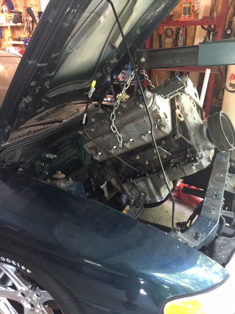

      Here was mocking up the 6.0L engine.

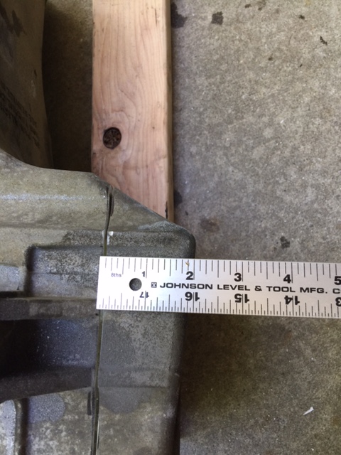

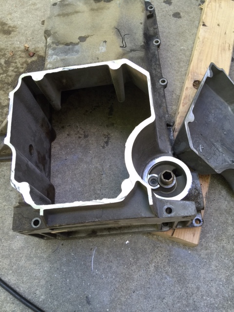

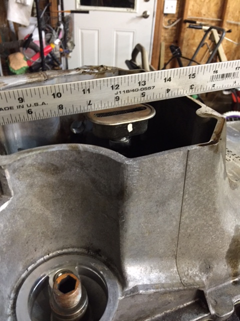

      The truck oil pan hangs way to low and this is a budget build so I chopped 2" out of the stock oil pan.
      I was trying to section the pan but because it is tapered I decided to just use a new piece for the bottom.

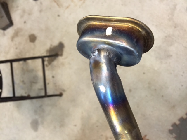

      It welded better than I thought it would for an old oil soaked cast pan, but by not means does it look very good. I will find pictures of it welded, but here is the pick up I had to shorten.
