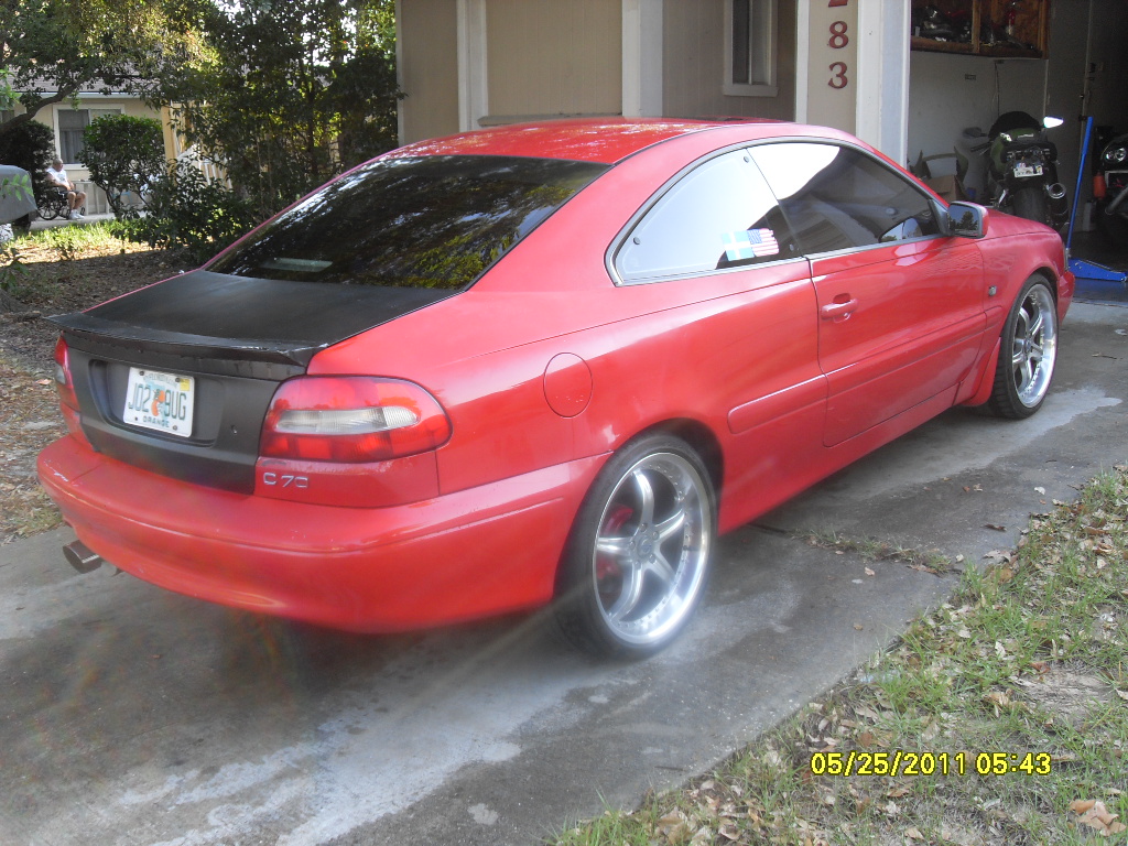

      I found my 95 mustang GT in a NY craigslist ad
      while visiting my family for the 4th of July. the guy wanted $2000 for it, so I
      contacted him and asked if he was interested in a straight up vehicle trade, his
      stang for my 2000 Volvo C70 which I had customized. I directed him to my Orlando
      craigslist ad and without even seeing the car in person he said that he wanted
      it!
