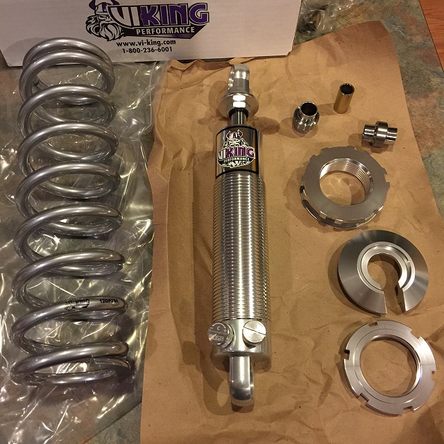

      We finally have nice weather but I haven't had any time to work on the car. My friends motorcycle engine locked up and he asked me to fix it. It was much worse than I was expecting (it sucked in a metal washer and did a number on everything), but that is done so I can get back to the mustang. I did get the wife to let me spend some money so I have plenty to do for a while. I got the Viking coilovers with 250lbs rate 12" springs. The rate was kind of a guess since I couldn't find any solid numbers to go from. It should be close for a starting point at least. I went with the larger 5/8" eye bushings since I'm not sure if I am going to use the bottom mount in single or double shear yet. I know that double is stronger but it seems like most people are using single shear without any problems. Single shear sure looks a lot cleaner but I may go with a double shear mount just for the peace of mind. I am open to input on the mounts, or better yet pictures.

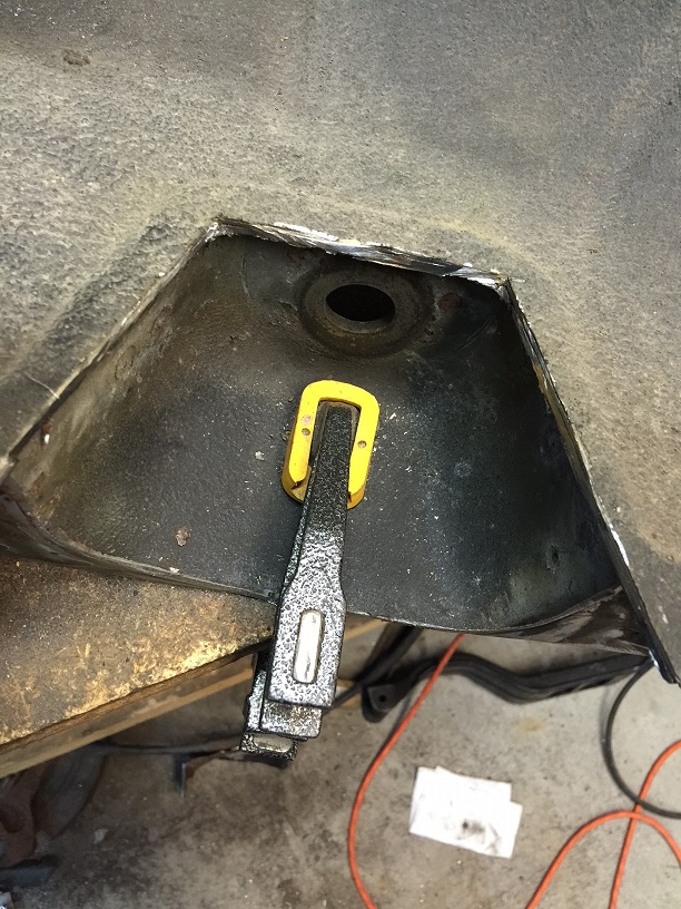

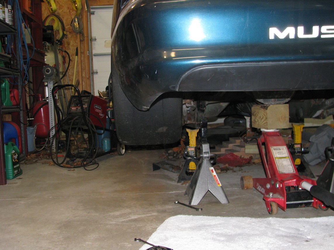

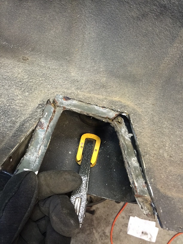

      Measure twice, cut once. Looks like I should have measured 3 times. I tried to mock up the coil overs tonight and It's a lot tighter than I thought it was going to be. I should have went with the next shorter shock. I wanted to try and keep a decent amount of travel, so went with the longer shocks. I was going to keep the shocks below the truck floor but It will need to stick above it a little. The stock shocks mounted a similar way so I am going to try and use the factory hump for some extra space.
      I cut out some of the extra bracing with a cut off wheel for more room.

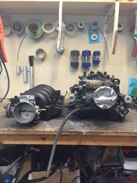

      The truck intake is to tall (and ugly) so I got an ls1.

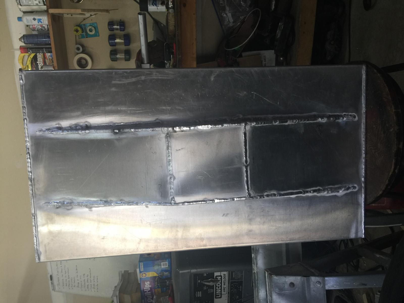

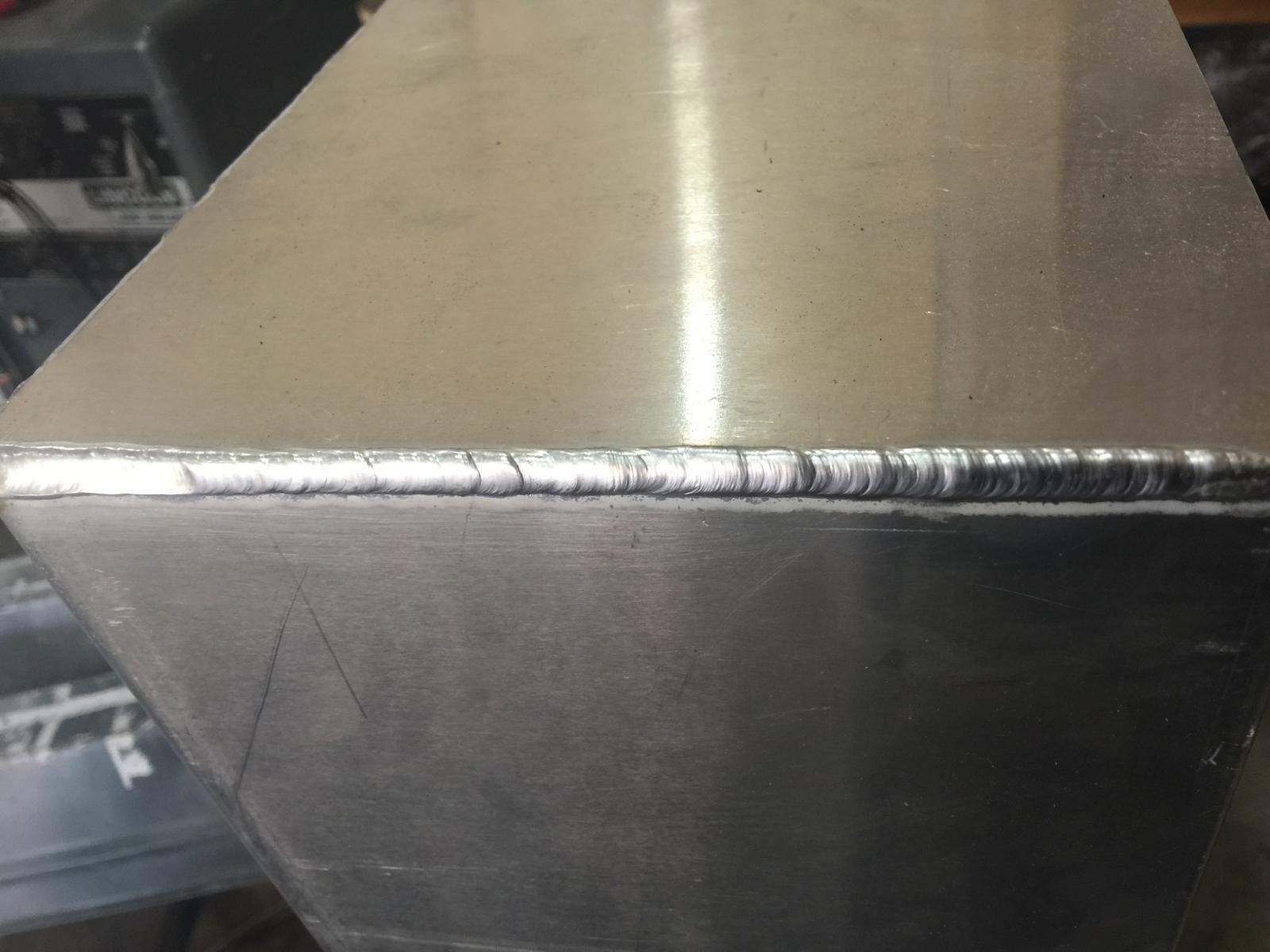

      First time I ever tried to make a fuel tank. I was concerned about fuel slosh/starvation on track days so I build a little sump inside the tank. I will be running dual internal pumps.
      The outside corner welds came out pretty good. The inside corners did not come out so great.
