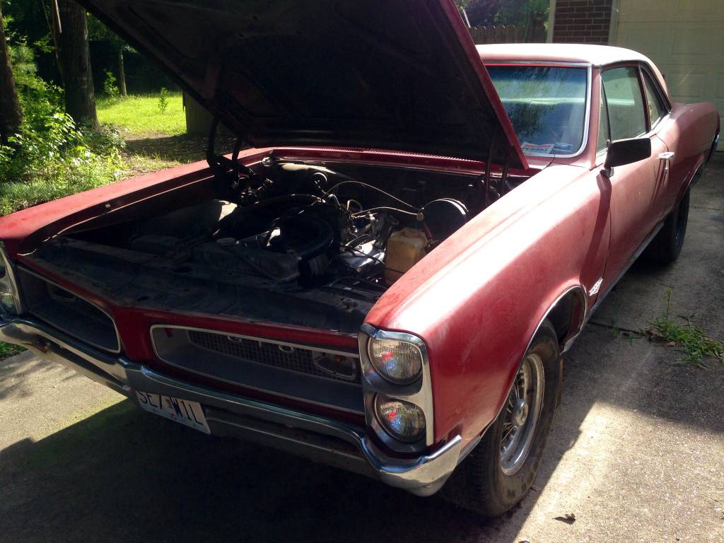

      I bought this this as a non running car last summer. Father died- left it to his daughter; her and her husband didn't have the $$ or know how to get it going. Not running, 4 flat tires (on wire wheels!) and a broken steering rag joint is how I picked it up:

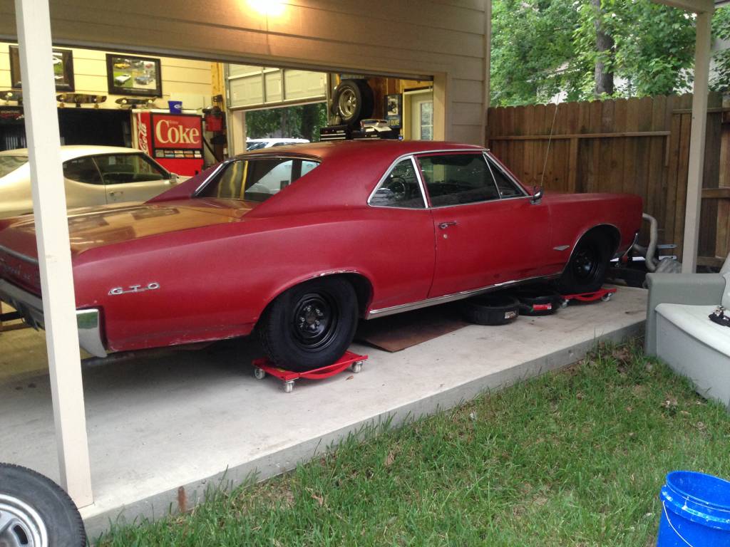

      After I got it home I cleaned it up and put it n some rollers:
