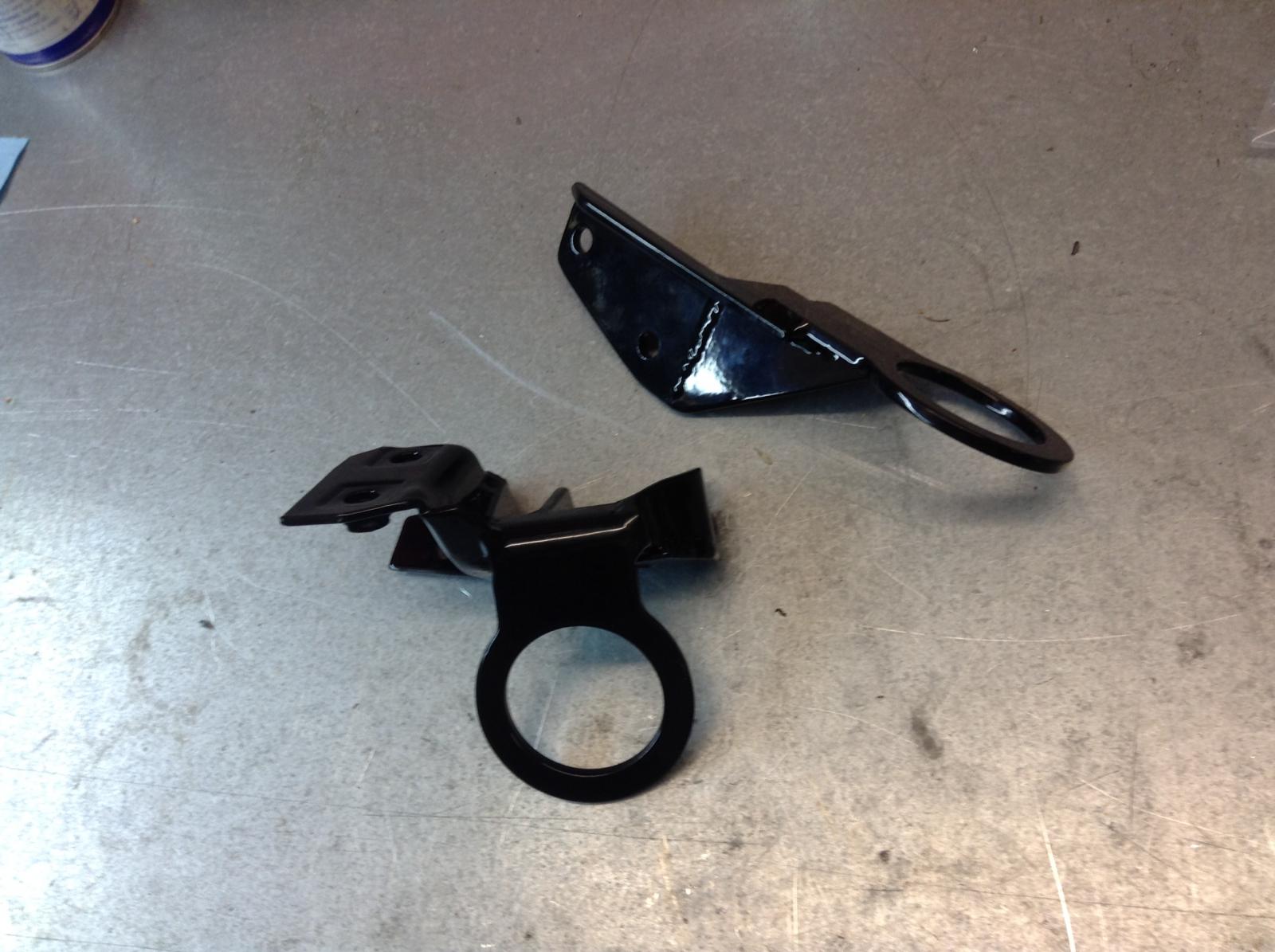

      Got these in the mail yesterday - I'm very happy with them

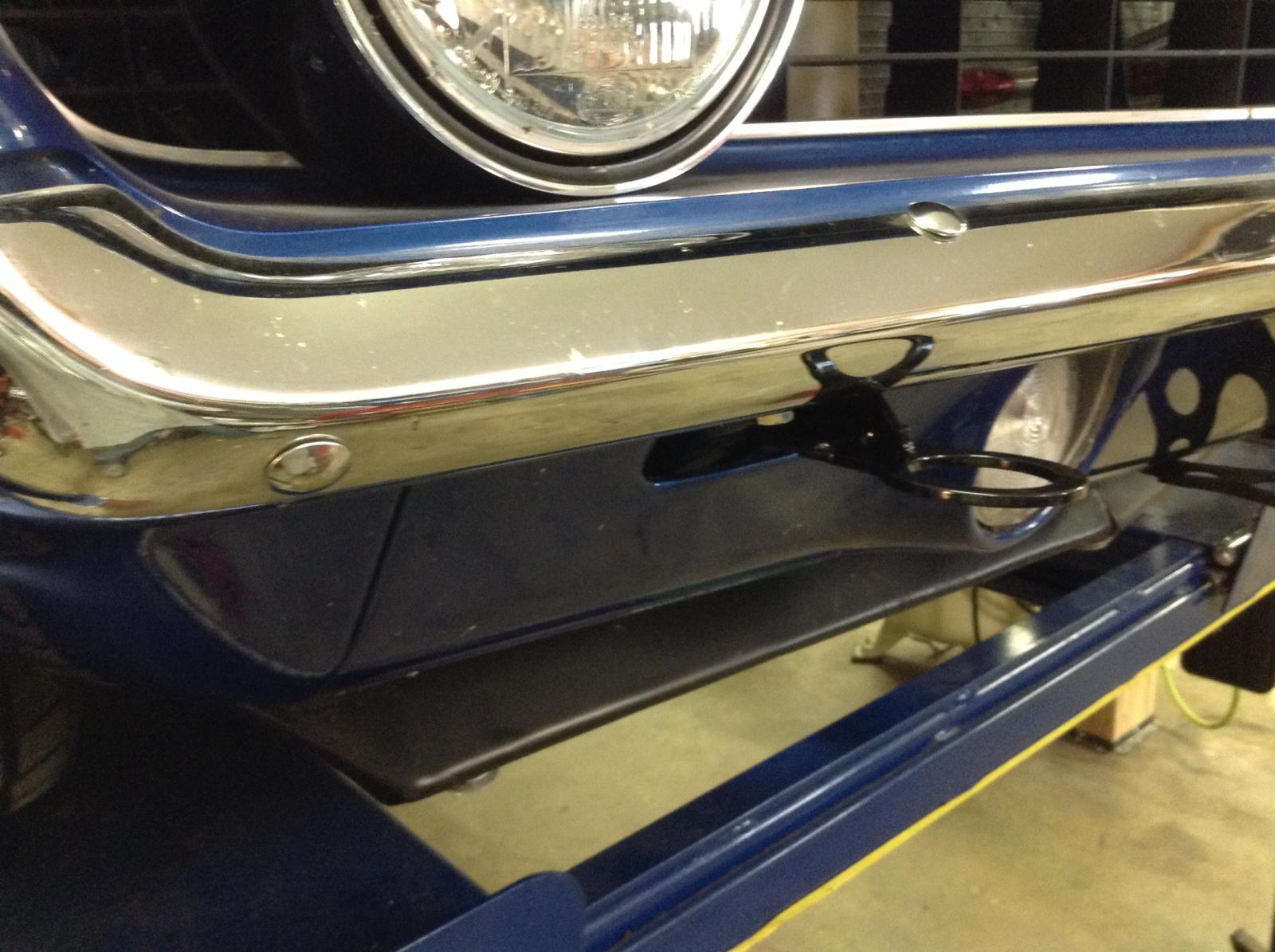

      I have not installed the rear one yet but the front was really easy. No need to pull the bumper, it bolts right to the frame bracket with longer bolts. Feels heavy duty and the welds are nice. It should be red but I like the black powdercoat.
