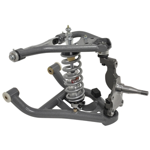

      If you need to stay under $1500 then I would track down a set of lowering springs for the stock arms and add a set of our new "VariShock SS" factory valved VariShock bolt-in shocks at all four corners. Click Here For Shocks.
      For $1740 you can lower the car a couple inches and improve the handling by installing our g-Street Coilover Suspension. It includes upper and lower control arms with polymer bearings, offset caster slugs, and a pair of QS-1 VariShock coilovers with spherical pivot-ball top mounts that bolt right in at the stock mounting point. Click Here For More Info.

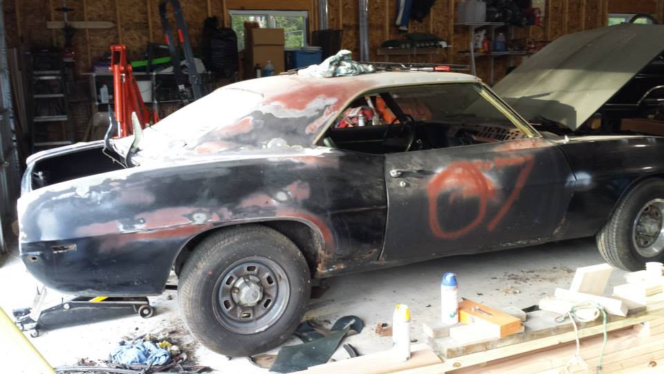

      Name:  original starting point.jpg
      Here starting with a ton of work ahead of me.

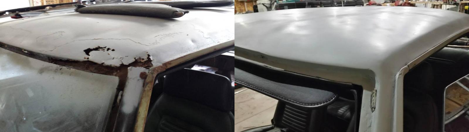

      Another really rough spot. The previous owner before my family purchased had this thing with filling holes with caulking. No joke... I literally pulled about 6 tubes of caulking from the car, this spot had a tube stuffed in there on its own. I used what was left and POR the rust to seal it after scrubbing it as much as I could get to. I then fiberglassed the shape back in with about 4 layers and later molded with body filler to shape.

      That may sound bad, but body filler alone is a problem. Body filler collects water over time, and if it accumulates long enough, you can get severe rust developing which is cancerous to the metal. By applying thin layers of fiberglass with a resin, you create an area that is impervious to water - thus sealing in any area that once had rust or was rusted. Trust me... Fiberglass, if used correctly, is a superior product to just using body filler. And a layer of fiberglass is literally paper thin. 4 layers were used just to add strength.
      I am a chemist by profession. I cringe when I see people just using body filler and then wondering why 5 years later, they are fixing the problem again or get bubbling or whatever.

      I have literally spent the last 2 years replacing panels that someone bondo'd/resined over rusted metal and every time I find a section it drives me nuts! I've cut out a TON of rust and replaced the damaged areas with fresh metal. I think a lot of people on this forum would not repair rust by hiding it. Just my two cents, at least you'll be driving your car long before mine is out of paint!
      ahhh well... I don't cover the rust. I actually have ground out a ton and then neutralized and sealed what little was left. Covering rust is never good. it's not until I have fully neutralized and sealed it do I even bother with resin and then bondo.
      There are 26 ways to do things... but only one or two that actually work. replacing body panels, and fully curing the problem. The rest is just cheap gimmicks that do not work.
      The POR system has worked for me in the past. My 81 camaro project was done up with that and after 15 years... not a single rust spot ever re-materialized again. You have to do all the steps including the sealer and painting - then you can address holes and other things.
      I now see what you are saying... and I totally agree. However, I have really taken the time to address all those issues. Things I plan to replace, I haven't touched. Since I am not replacing the rear of the car, it was important for me to do it right the first time.
