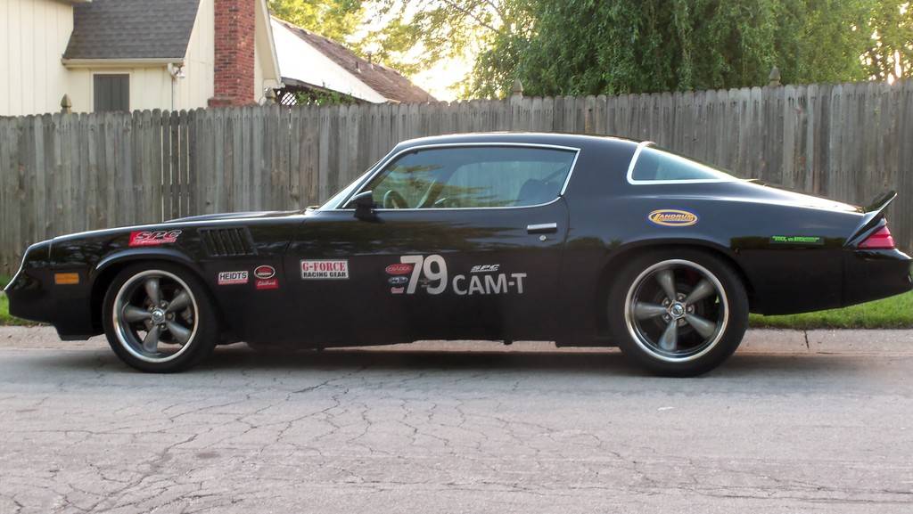

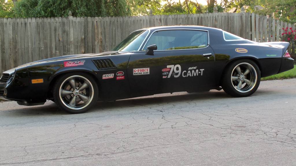

      Awesome build! Its amazing what a little TLC and some elbow grease can do to a car. Looks fantastic for a budget build!

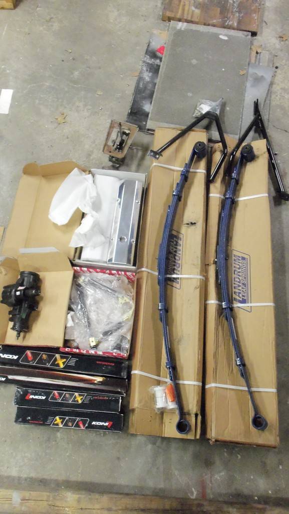

      Well, did my first autocross last weekend. It was a blast! Had some carb problems so had to quit early and miss out on Sunday's run but got the problem fixed by adjusting the float in the carb.
      The rear tires rubbed on the insides around sharp corners but I think I have a fix for that.....Here is all the goodies I have been collecting:
      200 lb rear springs
      Delrin upper shackle bushings
      Koni Red Classic shocks
      G-Braces
      SPC upper control arms
      IROC steering box
      Factory ratcheting shifter
      Aluminum Valve Covers
      Also plan to make some subframe connectors, solid body bushings and a sway bar brace
      I think I need to atleast get the rear springs, delrin bushings and the shocks installed before the next autocross to hopefully stop the rear tire rub
