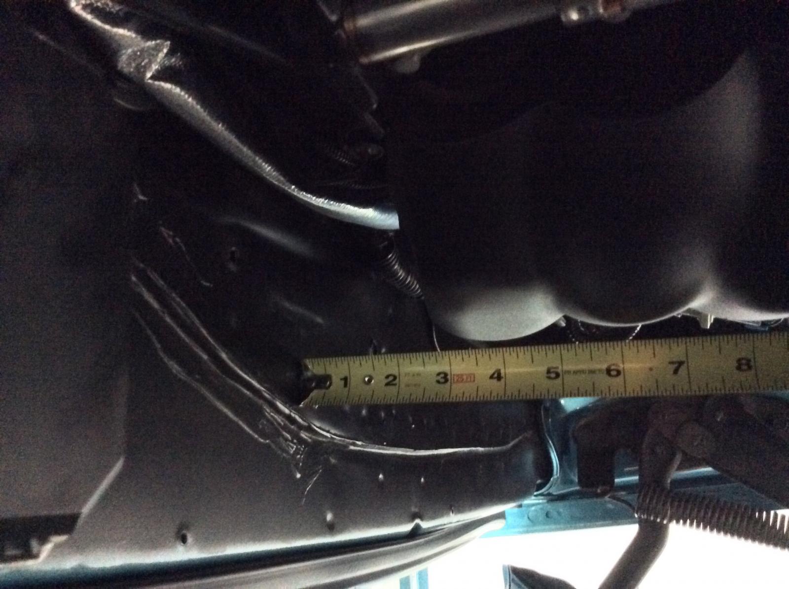

      Dec 2014
      20
      martz how far is your motor from firewall. the measurement would be nice to know. thanks again jerry
      Waunakee, WI
      154
      Sorry if it's upside down...
Size:  192.4 KBAttachment 108936
