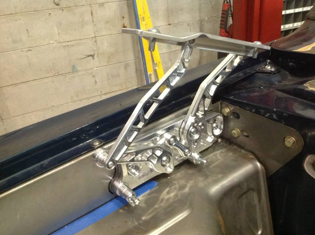

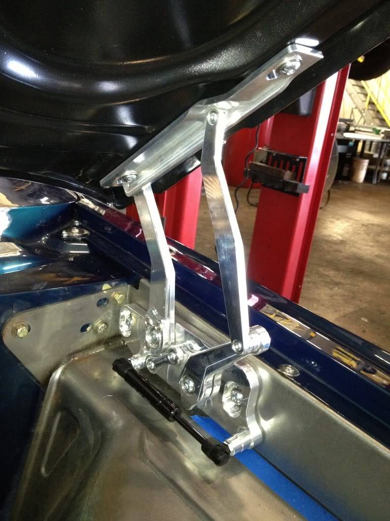

      Welcome to the site! Good to see another 65 Nova! Here is my Hood hinges I used form my 65
      There are Ring Brothers. They sent me a bunch o hinges to try free of charge when I found the right ones I ordered them in open frame. Let me check what they were from. No cutting or fabricating required.

      thanks for the help, they look right at home in your Nova. Nice rad support, did it allow some more clearance in front of the engine? Pretty tight with the stock support for me.
