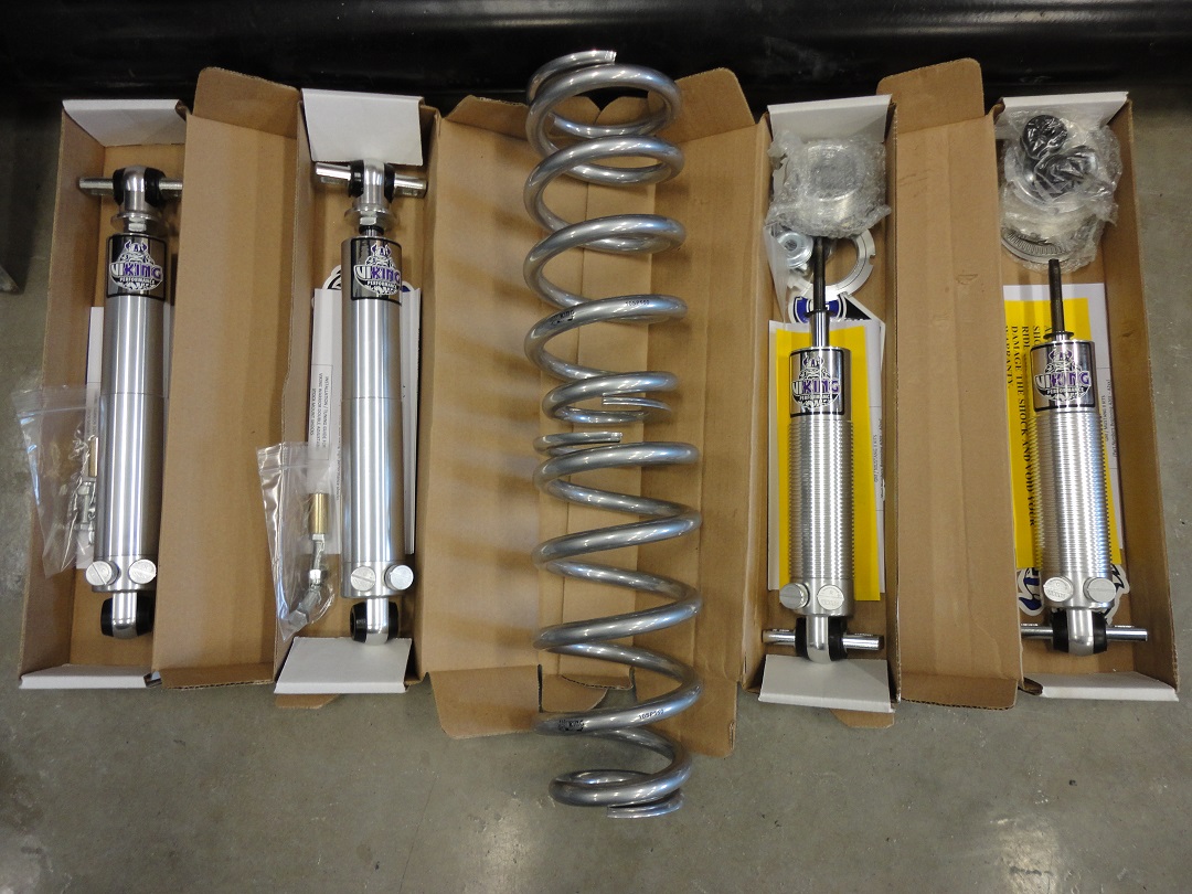

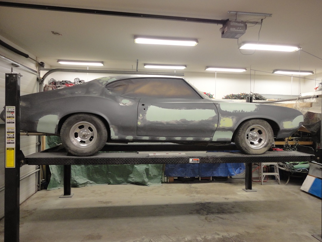

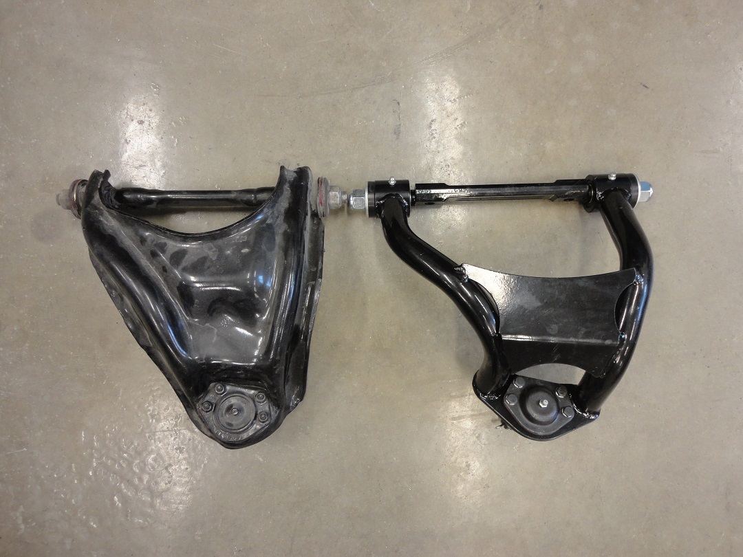

      Hey guys sorry for the wait! Glad to see some other A-body's on here.
      So I got the upper arms installed along with the Viking coil-overs on the front and the viking shocks/BMR 2 inch drop springs on the back. Everything went together easily, the toughest part I have to say is adjusting the coilovers with the stamped lower control arms, not much room to get those wrenches in there to adjust... The stance is exactly what I was looking for dropped the back about 2.5" and the front 1.5". The Viking coilovers and shocks appear to be of real good quality and I have seen lots of good feedback on them, they are not the best but for what I had for a budget and for my needs I think they will work well.
      From what I measured with my angle dial on the front brake calipers here's some numbers:
      Stock Upper/lower arms & spindle (car on jacks & some shims installed from recent alignment)
      full extension down
      -4 Left -2 Right
      almost full extension up
      0 Left +1 Right
      Tubular uppers & stock lowers/spindles (car on jacks & No shims yet)
      full extension down
      -2.5 Left -3 Right
      0 Left 0 Right
      Specs say to align to:
      -1 to -1.5 Camber
      +4 to +5 Caster
      1/16" Toe-in
      I am not by any means saying this is a perfect solution but it does seem to be correcting the camber a little, but my measuring is by no means 100% accurate but the car did not move from start to finish and there was some change. I still need to get an alignment done but that will not happen for a few months as I am in the middle of prepping for paint too.

      Bainer, unfortunately you`ve just slightly changed the static alignment not fixed the cars geometry problems. To each his own though, the cars looking good. If you`d like to get the big picture on how the geometry is affected by different components you might pick up a copy of Chassis Engineering by Herb Adams or better yet, How to Make Your Muscle Car Handle by...um...me.
      Lee, the only thing about the B spindle swap that A arms can fix is static alignment and that still leaves a lot of down sides on the table. Last I talked to Ken @ HO racing in the late `80s, shortly before they closed their doors, he was still recommending stock arms, near stock ride height and offset cross shafts from NAPA to get "the best alignment you can".
      Tom, the Vikings are passable entry level shocks (especially for drag racing) but they have limited maximum rebound dampening for handling applications, much less than we normally see in modern performance cars. It`s also MUCH less than the available range in shocks like the Varishock and ridetech. Both of these offer much more rebound control, even in a single adjustable vs. the Viking (or QA1) doubles. They also have more refined dampening curves and overall more refined construction It`s not that the Vikings are bad shocks, it`s just that (as always) you get what you pay for. FYI Viking doesn`t make a bolt in coil over for A body applications. They only make a hybrid, which is a different animal with different issues. I`m glad to hear you`ve had good luck with yours but the street reliability of all of the A body coil over/coil over hybrid conversions is much lower than the performance shock and spring format. They also have more potential tuning pitfalls. AT the end of the day regardless of true vs. hybrid format you`re still holding up the weight of the whole front end of the car with the two little plastic shock bushings. Coil over conversions are a much better choice for road race cars and hardcore auto cross cars where very high spring rates are the order of the day and increased maintenance is expected. Mark SC&C

      Here's a comparison on the stock vs lowered ride height, quite a difference.
