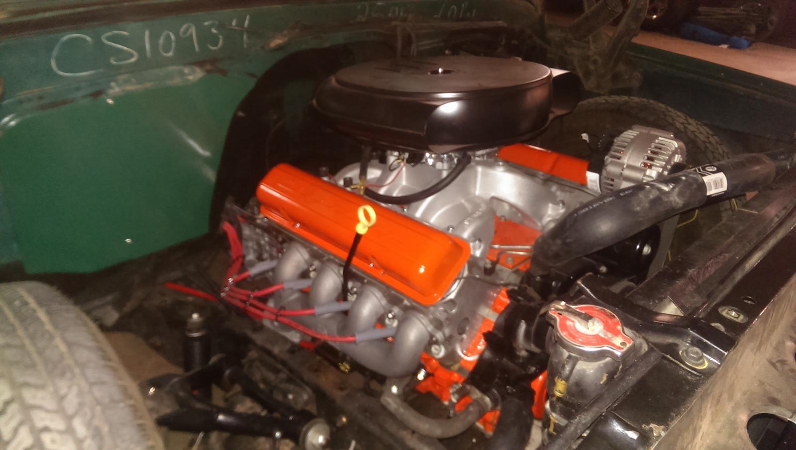

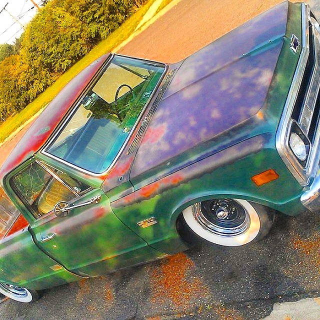

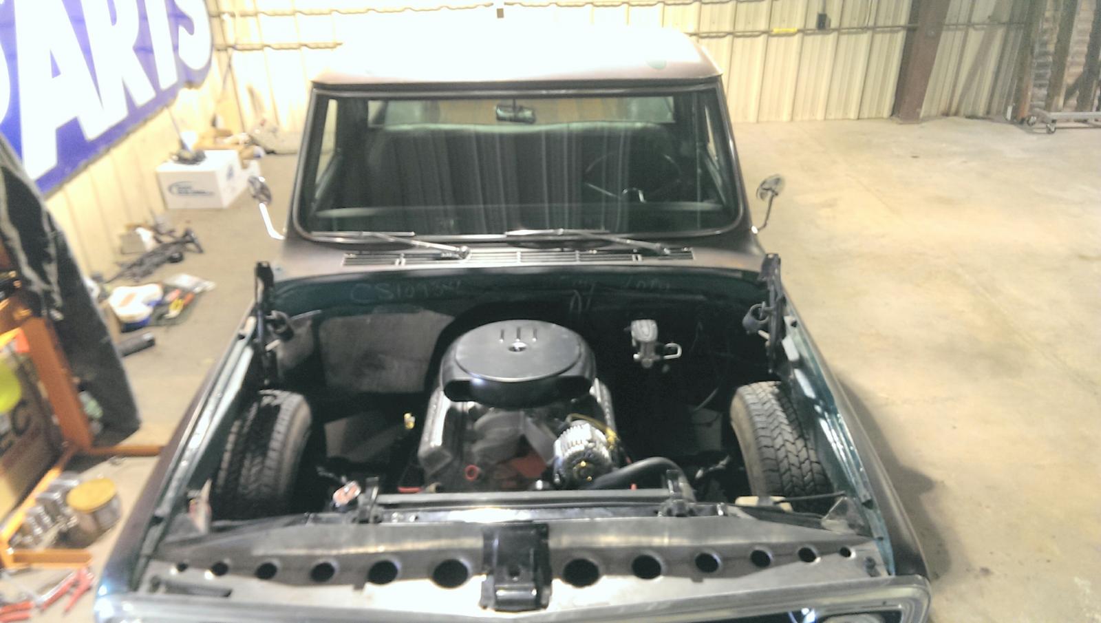

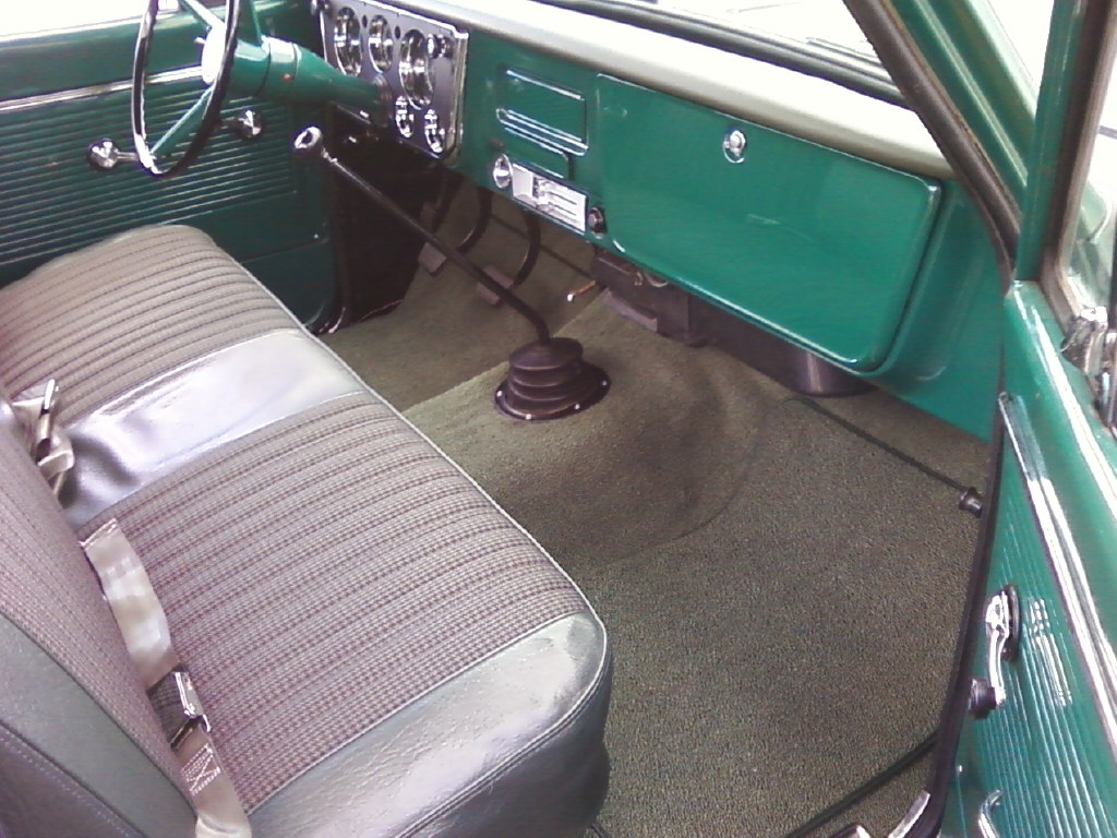

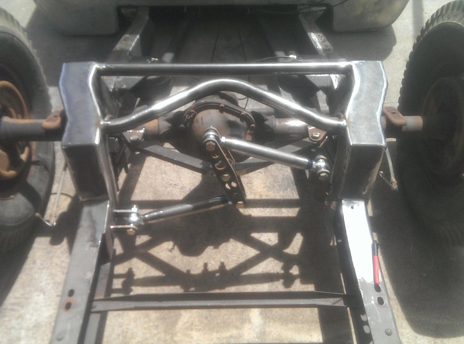

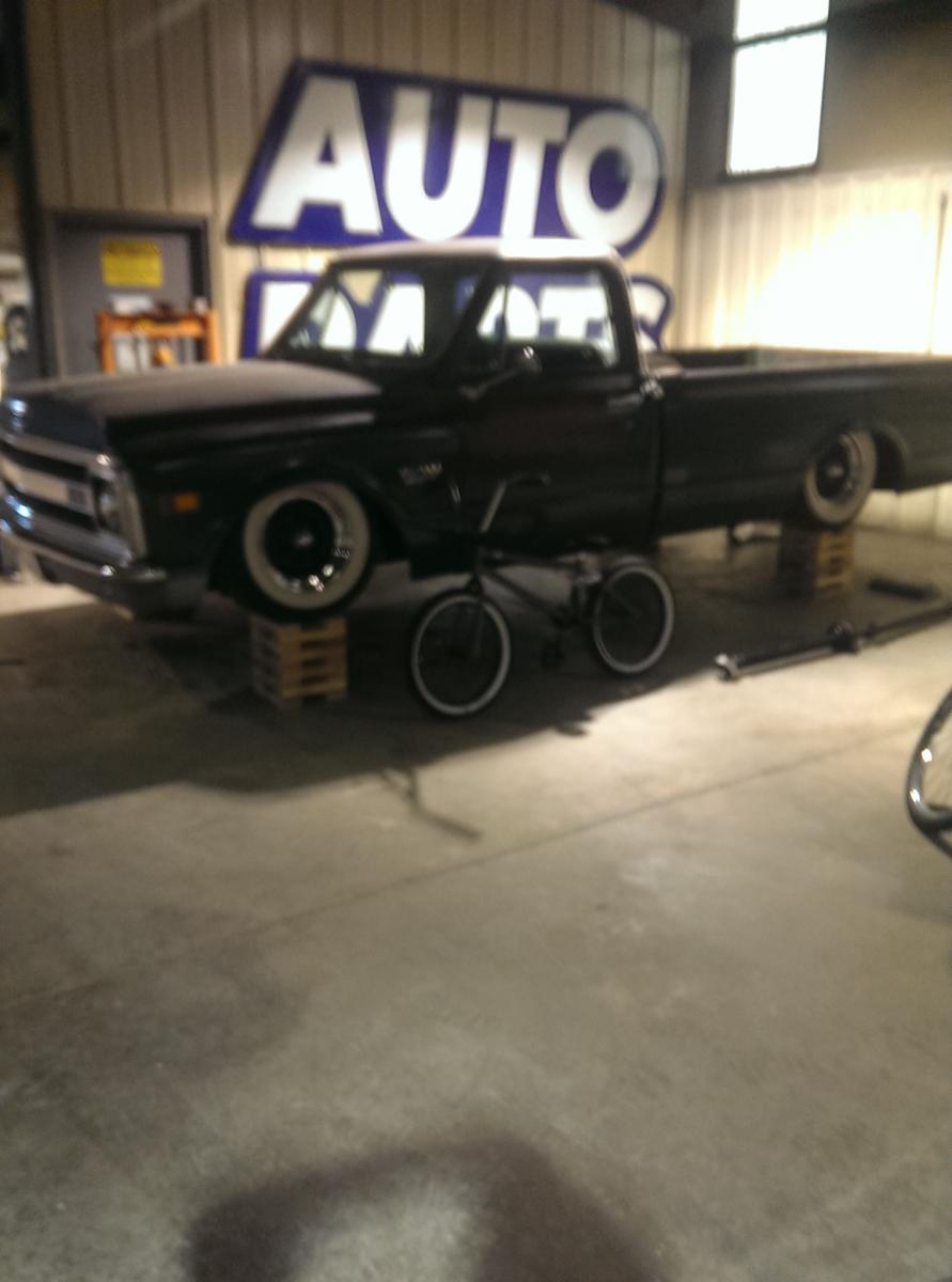

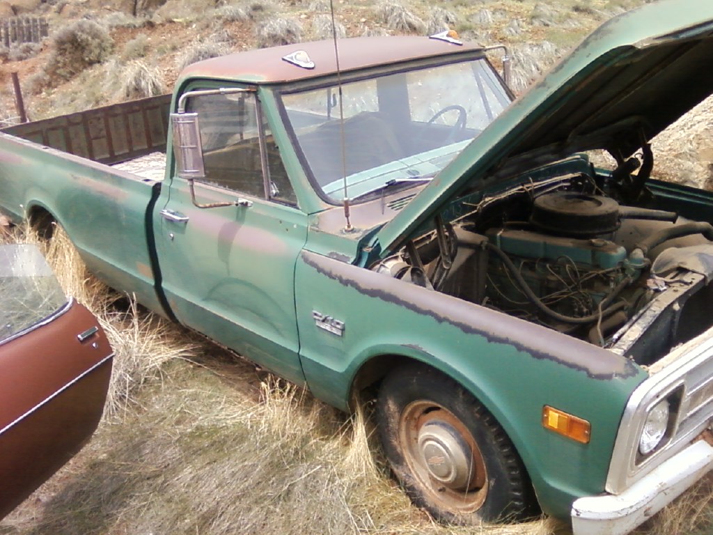

      Here's my truck, it's a 1969 c10 with a cammed 5.3 ls backed by a tremec tko and a posi rear. The suspension is ride tech front arms, dominator 2600 bags all around. The rear suspension was built by me it's a 3 inch c notch, long pan hard bar and bags in place of coils. It's all controlled by an accuair e-level system. The bed is a raised oak floor with hidden fasteners. Interior is all fresh. I know it's not a typical pro touring truck but it's built with handling in mind! And I must say it's a quick little truck!
