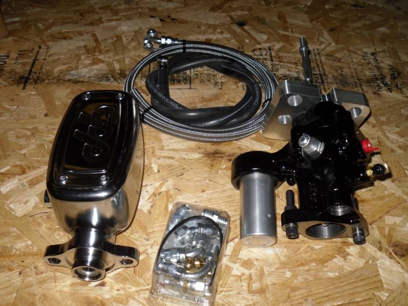

      I went with a hydraboost and I would never go back.

      I bought hydraboost not fitted yet looking forward to driving my car some day .

      I have a hydroboost unit in my '68 Camaro and really like it. It does provide substantial braking power, but it's also pretty easily modulated. It's nice knowing that I've got brakes that easily match the go pedal. Just like any other aspect of driving these cars we build, they take a little finesse.
      I had manual brakes in my prior '68 with the same front brakes and a different rear disk setup, with an S10 quick takeup master cylinder. While I never felt nervous about the manual brakes, I vastly prefer the hydoboost brakes.
      Two things:
      • I got my hydroboost through Summit Racing which sold a CPP branded Hydratech unit. When I had issues with it the guys at CPP were worthless and the guys at Hydratech were extremely helpful. If I were to buy again, I'd go direct to Hydratech.
      • Second, I tried and tried to use the "T" fitting for the return from the power rack and the hydroboost with no success - lots of kickback in both the steering and a bit with the brakes. I ended up getting an aluminum reservoir for the C5 style power steering pump I'm using and plumbing it for a second return line. All issues resolved.
