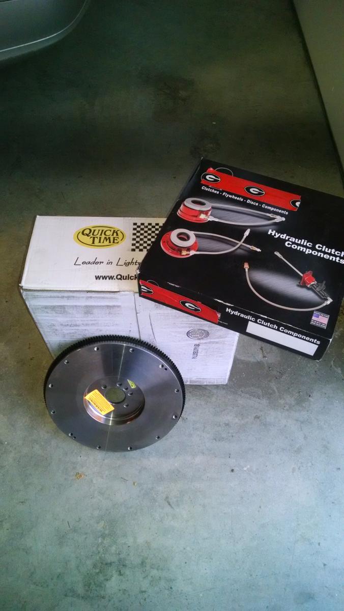

      Then I weighed the ZF (they are always talked about as much heavier than T-56. The ZF with shifter was 139#
      Flywheel 30#
      GM clutch, pressure plate,bolts and pilot bearing 32#
      Still waiting on quicktime 6039 bell housing but quicktime list it's weight as 22#
      That brings the LS/ZF and parts to a grand total of 689#
      Conclusion is this new setup will be about 185 pounds lighter than original factory style engine/auto transmission set up.

      More parts and pieces came on the big brown truck today. While I still don't have the Holley oilpan to do some test fitting for tunnel snips, I can do some accurate measuring now, and do some test set-up for engine, bellhousing, clutch, throw-out bearing fitment. Also, can tackle the clutch pedal, M/C install, in prep for that part of the equation.
