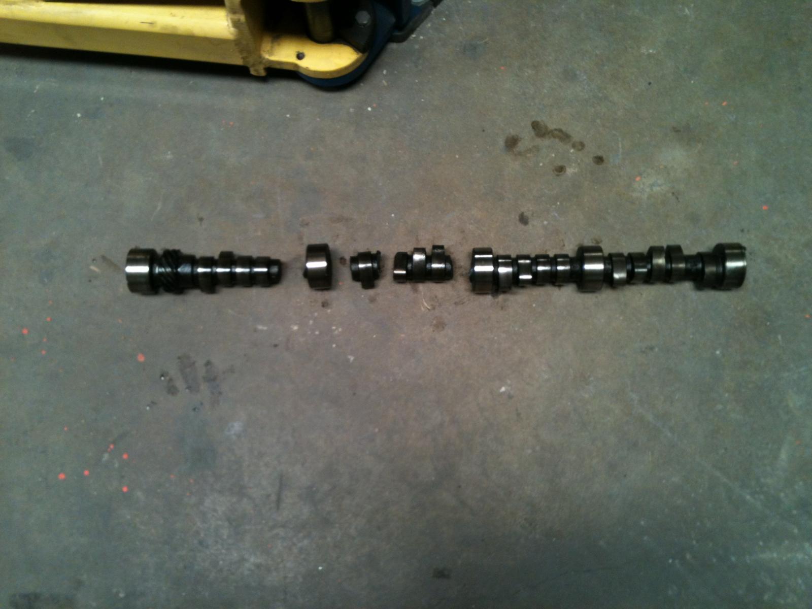

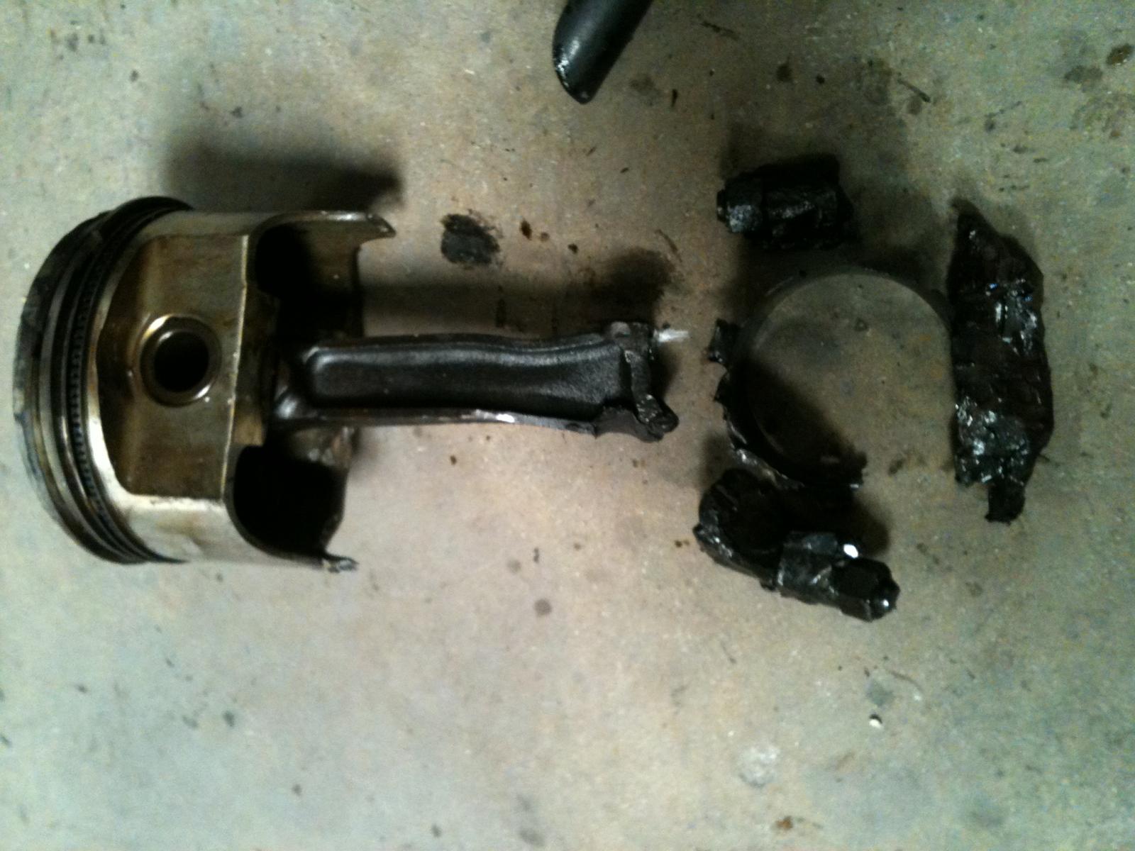

      Here was the cause of that no-start issue.

      How does that even happen?!

      So was I...
      I bet it sounded pretty spectacular though.

      That's nuts. I've worked in the service department for a quarter century, and never seen anything like that.
      and "yes".....people still bring the old ones in to the dealers. We've had a couple from the late 80's within the past couple weeks in fact.

      Looks like it was wide open throttle for a long time. The rod end is cooked!
