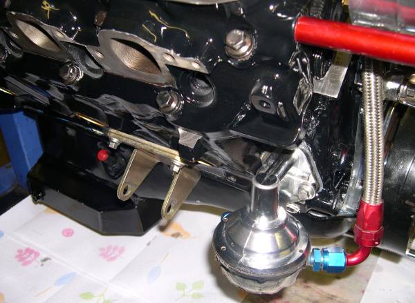

      I've been using nothing but solid motor mounts on both sides and poly trans all the time these days.
      I like the way they work, especially with a manual trans.
      69 Camaro 468
      67 Chevelle 496
