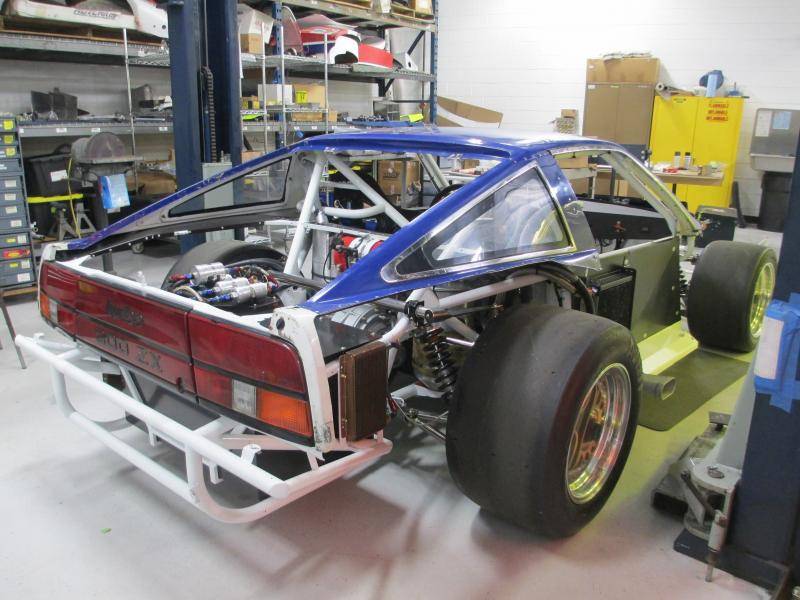

      First things first we pulled the car in. We were also doing a full Hotchkis TVS install on the Charger and on the other side of the welding curtain is a Paul Newman 300ZX Turbo car we are finishing up the restoration on for a customer.

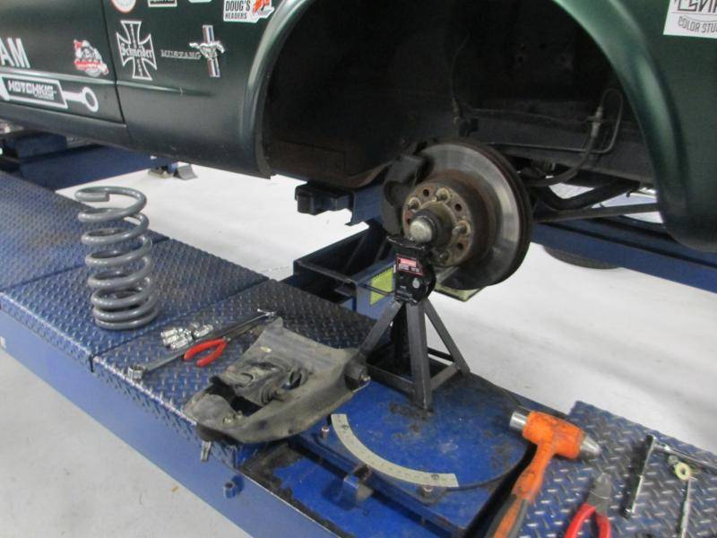

      In short order the factory uppers and Hotchkis springs are removed. The new Upper Control Arms will require the Shelby Drop Mod be performed to the car.

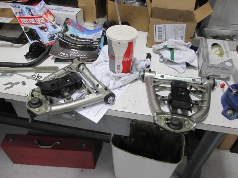

      We had to make a few more adjustments on the bench and transfer the Spring perches over to the new arms. We'll probably do the rollerbearing mod in the future.
      Cycling the suspension without the springs to check some numbers.

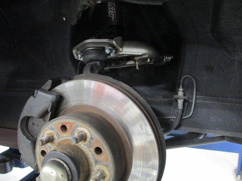

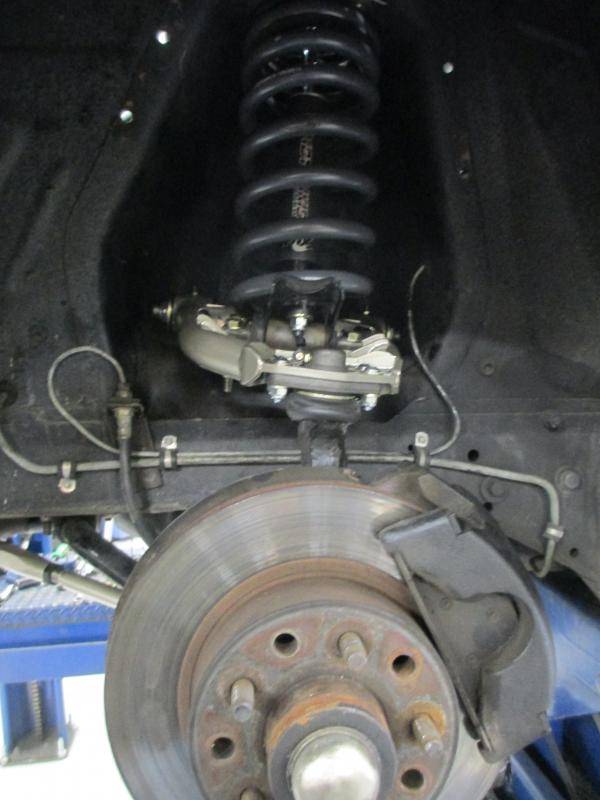

      Spring reinstalled.

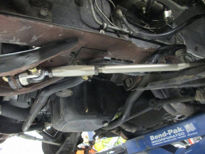

      And Adjustable Strut Rods installed.

      Paul Newman ran over my foot and broke 2 of my toes with that Nissan. I think he did it on purpose, since we were friends and were joking around a few minutes before - he wouldn't admit it!

      Without getting too far into the specifics of our design, if you look at the picture of the control arm on the bench, you can see how far back the upper ball joint was shifted to the rear. On a factory arm the upper ball joint is in alignment with with spring perch. As an example, the test car had a lot of shims with the factory arm and was able to get one degree of negative camber and 4* caster. With the new arms we were able to get the suspension exactly where we wanted it with very few shims.
      The cross shaft uses a greaseable urethane bushing. It's built very tight for minimal deflection.
